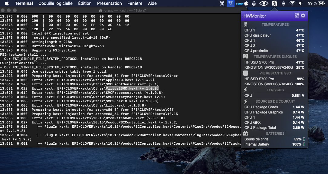

chris1111 Posted October 4, 2019 Share Posted October 4, 2019 No issue here V1.08 Catalina 10.15 and Mojave 10.14 I attach my compile package SMCBattery works Package-VSMC.zip 1 Link to comment https://www.insanelymac.com/forum/topic/335292-virtualsmc-%E2%80%94-smc-emulator/page/20/#findComment-2692213 Share on other sites More sharing options...

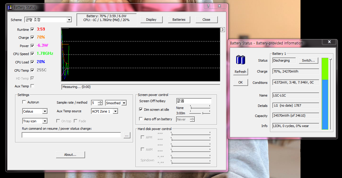

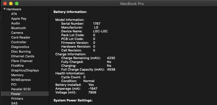

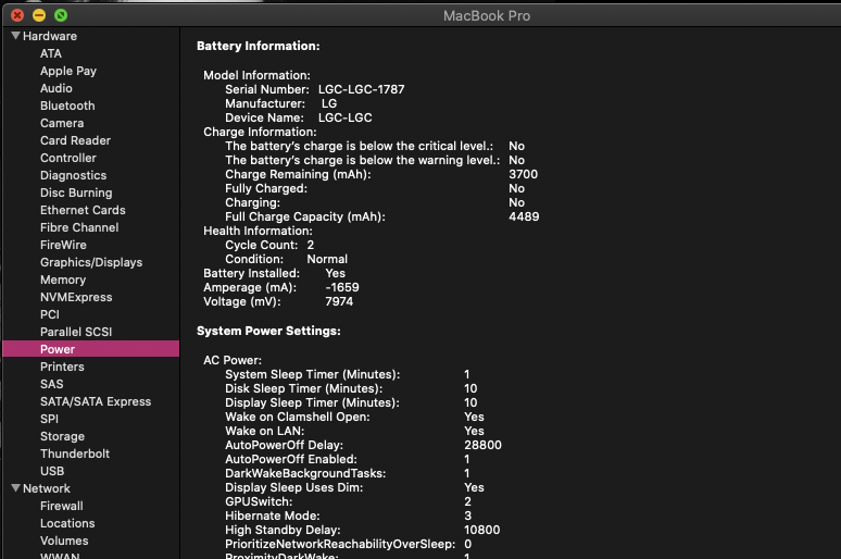

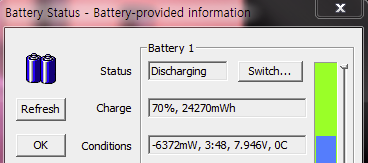

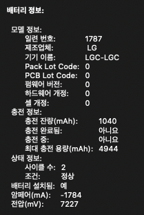

Sherlocks Posted October 13, 2019 Share Posted October 13, 2019 (edited) i want to report battery info to usrsse2. but i can't wrote in russia forum. here is my report. acpibattery info of rehabman virtualsmc smcbattery info i checked virtualsmc smcbattery close to macbook batter information. and now acpibattery kext has battery percentage issue when plugin ac connect(always 100% and after about 30secs, get correct battery info) so i determine virtualsmc smcbattery. virtual smcbattery, battery cycle count always 0. i don't know why. acpibattery always shown correct cycle count. so i think this line need more consider. https://github.com/acidanthera/VirtualSMC/blob/master/Sensors/SMCBatteryManager/ACPIBattery.cpp#L88 https://github.com/RehabMan/OS-X-ACPI-Battery-Driver/blob/master/AppleSmartBatteryManager/AppleSmartBattery.cpp#L1290 here is kernel log VirtualSMCBattery.zip ACPIBattery.zip thanks in advance EDIT1. i checked battery info in windows cycle is 0. and windows battery report 배터리:배터리 정보 배터리 ID(BATTERY ID) 1787 LG LGC-LGC 제조업체(MANUFACTURE) LG 일련 번호(SERIAL) 1787 화학적 구성 성분 LION 대용량 1 설계 용량 34610 마지막 완전 충전 34570 seems virtaulsmc smcbattery more correct than acpibattery. EDIT2. seems Virtualsmc smcbattery capacity is wrong in windows, battery capacity is about 34610 mWh. https://convert-formula.com/mwh-mah capacity is about 4400~4500. Edited October 13, 2019 by Sherlocks 1 Link to comment https://www.insanelymac.com/forum/topic/335292-virtualsmc-%E2%80%94-smc-emulator/page/20/#findComment-2693389 Share on other sites More sharing options...
vit9696 Posted October 13, 2019 Author Share Posted October 13, 2019 11 hours ago, soumaxetuirk said: Hi everyone. After upgrading to 10.15 public release, System stuck at end of lading screen with a cursor. I was using VirtualSMC with VoodooPS2 (Acidanthera's) in 10.14.6 without error. After upgrade,I can't get to login screen.While I can change brightness, login remotely. I tested a lot and I marked a strange behaviour between VirtualSMC and PS2 driver. Without PS2 driver, I can use any version of virtualSMC. OS 10.15 - VirtualSMC (V 1.0 - V 1.8) + Without VoodooPS2 : Works fine OS 10.15 - VirtualSMC (V 1.0 - V 1.8) + VoodooPS2 (rehabman's) : Kernel Panic OS 10.15 - VirtualSMC (V 1.0 - V 1.3) + VoodooPS2 (Acidanthera's) : No error OS 10.15 - VirtualSMC (V 1.4 - V 1.8) + VoodooPS2 (Acidanthera's) : black login screen with a mouse as I said earlier OS 10.15 - FakeSMC + VoodooPS2 (BOTH Developers) : No Error I have read about the issue of sharing same bus with battery plugin. So I was using only SMC kext without plugins. That's quite strange, what Lilu versions were involved during the testing? Also, does VirtualSMC 1.0.8 with our VoodooPS2 work with vsmcgen=1 boot argument added? Link to comment https://www.insanelymac.com/forum/topic/335292-virtualsmc-%E2%80%94-smc-emulator/page/20/#findComment-2693396 Share on other sites More sharing options...

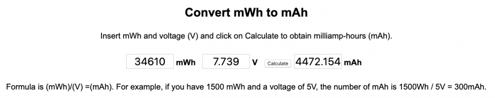

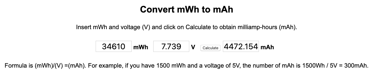

usr-sse2 Posted October 14, 2019 Share Posted October 14, 2019 On 10/13/2019 at 8:30 AM, Sherlocks said: i want to report battery info to usrsse2. but i can't wrote in russia forum. here is my report. acpibattery info of rehabman virtualsmc smcbattery info i checked virtualsmc smcbattery close to macbook batter information. and now acpibattery kext has battery percentage issue when plugin ac connect(always 100% and after about 30secs, get correct battery info) so i determine virtualsmc smcbattery. virtual smcbattery, battery cycle count always 0. i don't know why. acpibattery always shown correct cycle count. so i think this line need more consider. https://github.com/acidanthera/VirtualSMC/blob/master/Sensors/SMCBatteryManager/ACPIBattery.cpp#L88 https://github.com/RehabMan/OS-X-ACPI-Battery-Driver/blob/master/AppleSmartBatteryManager/AppleSmartBattery.cpp#L1290 here is kernel log VirtualSMCBattery.zip ACPIBattery.zip thanks in advance EDIT1. i checked battery info in windows cycle is 0. and windows battery report 배터리:배터리 정보 배터리 ID(BATTERY ID) 1787 LG LGC-LGC 제조업체(MANUFACTURE) LG 일련 번호(SERIAL) 1787 화학적 구성 성분 LION 대용량 1 설계 용량 34610 마지막 완전 충전 34570 seems virtaulsmc smcbattery more correct than acpibattery. EDIT2. seems Virtualsmc smcbattery capacity is wrong in windows, battery capacity is about 34610 mWh. https://convert-formula.com/mwh-mah capacity is about 4400~4500. About capacity: what is the designed voltage of your battery? capacity (mAh) = capacity (mWh) / designed voltage (V) 34610 mWh is the designed capacity of your battery, 34570 is the capacity that it takes when fully charged (it's less due to battery wear-out). For batteries that don't report cycle count (don't have _BIX extended information method), fake cycle count is calculated as 1000 * (design capacity - full charge capacity) / design capacity, assuming that after 1000 cycles the battery would be completely destroyed and have zero capacity. According to your data, the cycle count should be (35610 - 34570) / 35610 * 1000 = 29. On my notebook it shows 0 instead of 241 (the battery is 6 years old), I'll debug it. 1 Link to comment https://www.insanelymac.com/forum/topic/335292-virtualsmc-%E2%80%94-smc-emulator/page/20/#findComment-2693538 Share on other sites More sharing options...
Sherlocks Posted October 14, 2019 Share Posted October 14, 2019 (edited) 50 minutes ago, usr-sse2 said: About capacity: what is the designed voltage of your battery? capacity (mAh) = capacity (mWh) / designed voltage (V) 34610 mWh is the designed capacity of your battery, 34570 is the capacity that it takes when fully charged (it's less due to battery wear-out). For batteries that don't report cycle count (don't have _BIX extended information method), fake cycle count is calculated as 1000 * (design capacity - full charge capacity) / design capacity, assuming that after 1000 cycles the battery would be completely destroyed and have zero capacity. According to your data, the cycle count should be (35610 - 34570) / 35610 * 1000 = 29. On my notebook it shows 0 instead of 241 (the battery is 6 years old), I'll debug it. Q.About capacity: what is the designed voltage of your battery? capacity (mAh) = capacity (mWh) / designed voltage (V) my laptop battery was changed recently before about 1 month in dsdt Name (_BIX, Package (0x14) { Zero, Zero, Ones, Ones, One, Ones, Zero, Zero, Ones, 0x000182B8, 0x0002BF20, 0x3E80, 0xEA60, 0xEA60, 0x4B, 0x4B, "", "", "LION", " LG " }) Name (_BIF, Package (0x0D) { Zero, Ones, Ones, One, Ones, Zero, Zero, 0x64, 0x4B, "", "", "LION", " LG " }) thanks in advance EDIT i don't exactly know battery cycle formula. just find here battery cycle article https://www.idownloadblog.com/2015/06/18/how-to-macbook-battery-cycle-count/ How do you calculate a battery cycle? A battery cycle count is calculated based on the use of all the battery’s power, but not necessarily on a single charge. For example, if your MacBook is charged at 100% and you use 50% of your battery, then charge it back to 100%, then use another 50% of battery, it will equal to one battery cycle (50+50=100). Likewise, if you use 20% of your battery then charge it back to 100% five times, it will equal to one battery cycle (20+20+20+20+20=100). Edited October 14, 2019 by Sherlocks Link to comment https://www.insanelymac.com/forum/topic/335292-virtualsmc-%E2%80%94-smc-emulator/page/20/#findComment-2693545 Share on other sites More sharing options...
usr-sse2 Posted October 14, 2019 Share Posted October 14, 2019 (edited) 1 hour ago, Sherlocks said: Q.About capacity: what is the designed voltage of your battery? capacity (mAh) = capacity (mWh) / designed voltage (V) my laptop battery was changed recently before about 1 month in dsdt Name (_BIX, Package (0x14) { Zero, Zero, Ones, Ones, One, Ones, Zero, Zero, Ones, 0x000182B8, 0x0002BF20, 0x3E80, 0xEA60, 0xEA60, 0x4B, 0x4B, "", "", "LION", " LG " }) Name (_BIF, Package (0x0D) { Zero, Ones, Ones, One, Ones, Zero, Zero, 0x64, 0x4B, "", "", "LION", " LG " }) thanks in advance EDIT i don't exactly know battery cycle formula. just find here battery cycle article https://www.idownloadblog.com/2015/06/18/how-to-macbook-battery-cycle-count/ How do you calculate a battery cycle? A battery cycle count is calculated based on the use of all the battery’s power, but not necessarily on a single charge. For example, if your MacBook is charged at 100% and you use 50% of your battery, then charge it back to 100%, then use another 50% of battery, it will equal to one battery cycle (50+50=100). Likewise, if you use 20% of your battery then charge it back to 100% five times, it will equal to one battery cycle (20+20+20+20+20=100). The battery doesn’t count charges (or doesn’t report it via ACPI), so battery drivers approximate cycle count with an assumption that the battery is designed for 1000 cycles (like MacBook battery is), and its full capacity linearly decreases due to wearing out from designed capacity to zero in that 1000 cycles. It showed 0 because of issue with types (SMC key had type ui8 instead of ui16). Fixed in master. SMCBatteryManager.kext.zip Edited October 14, 2019 by usr-sse2 Link to comment https://www.insanelymac.com/forum/topic/335292-virtualsmc-%E2%80%94-smc-emulator/page/20/#findComment-2693552 Share on other sites More sharing options...
Sherlocks Posted October 14, 2019 Share Posted October 14, 2019 3 minutes ago, usr-sse2 said: The battery doesn’t count charges (or doesn’t report it via ACPI), so both battery drivers approximate cycle count with an assumption that the battery is designed for 1000 cycles (like MacBook battery is), and its full capacity linearly decreases due to wearing out from designed capacity to zero in that 1000 cycles. It showed 0 because of issue with types (SMC key had type ui8 instead of ui16). Fixed in master. SMCBatteryManager.kext.zip now i have 2 cycles. seems good my battery capacity is 4553. will be fix? Link to comment https://www.insanelymac.com/forum/topic/335292-virtualsmc-%E2%80%94-smc-emulator/page/20/#findComment-2693554 Share on other sites More sharing options...
