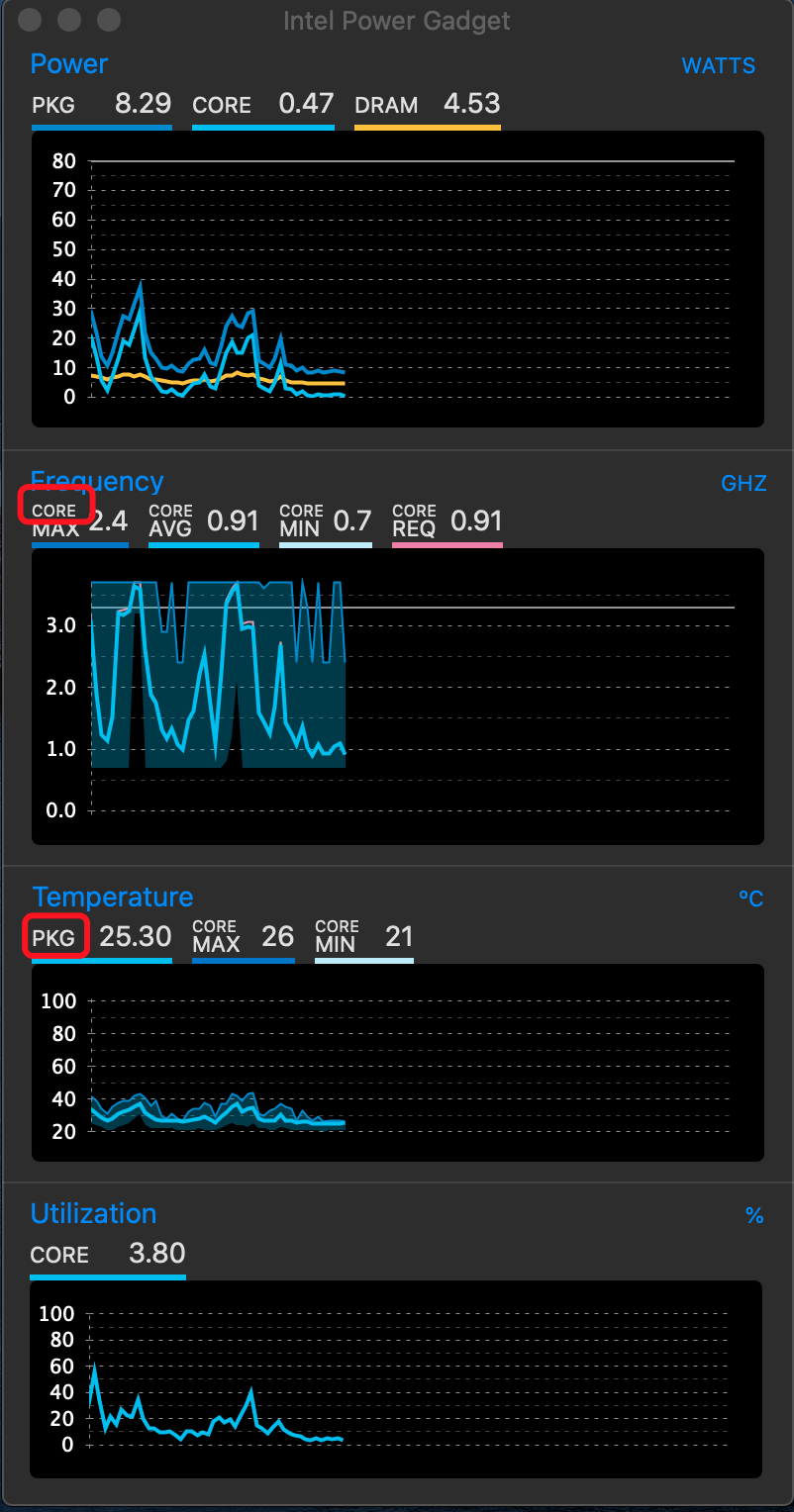

vector sigma Posted January 26, 2020 Share Posted January 26, 2020 19 minutes ago, jinbingmao said: error while the second is "Core" and not Package by mistake, the first is correct: /*@function PGSample_GetIATemperature * @abstract Get the CPU core temperature across all cores for the specified sample. * @discussion CPU temperature is constantly changing over time, and can vary by core. The method used to measure CPU temperature can vary by CPU features and configuration, and may include mutliple measurements per core per sample. This function returns 3 values that represent CPU temperature across all cores on this package: (1) the mean temperature of all measurements across all cores; (2) the minimum temperature observed in any measurement on any core for this sample; (3) the maximum temperature observed in any measurement on any core for this sample. * @param sampleID1 First sample, must precede the second sample in time. * @param sampleID2 Second sample, must follow the first sample in time. * @param mean Pointer that will be updated with mean CPU temperature across all measurements in degrees Celcius. * @param min Pointer that will be updated with minimum CPU temperature across any measurement in degrees Celcius. * @param max Pointer that will be updated with maximum CPU temperature across any measurement in degrees Celcius. * @result True on success, false on failure. */ bool PGSample_GetIATemperature(PGSampleID sampleID, double* mean, double* min, double* max); 1 Link to comment https://www.insanelymac.com/forum/topic/335292-virtualsmc-%E2%80%94-smc-emulator/page/27/#findComment-2705877 Share on other sites More sharing options...
jinbingmao Posted January 26, 2020 Share Posted January 26, 2020 46 minutes ago, vector sigma said: while the second is "Core" and not Package by mistake, the first is correct: /*@function PGSample_GetIATemperature * @abstract Get the CPU core temperature across all cores for the specified sample. * @discussion CPU temperature is constantly changing over time, and can vary by core. The method used to measure CPU temperature can vary by CPU features and configuration, and may include mutliple measurements per core per sample. This function returns 3 values that represent CPU temperature across all cores on this package: (1) the mean temperature of all measurements across all cores; (2) the minimum temperature observed in any measurement on any core for this sample; (3) the maximum temperature observed in any measurement on any core for this sample. * @param sampleID1 First sample, must precede the second sample in time. * @param sampleID2 Second sample, must follow the first sample in time. * @param mean Pointer that will be updated with mean CPU temperature across all measurements in degrees Celcius. * @param min Pointer that will be updated with minimum CPU temperature across any measurement in degrees Celcius. * @param max Pointer that will be updated with maximum CPU temperature across any measurement in degrees Celcius. * @result True on success, false on failure. */ bool PGSample_GetIATemperature(PGSampleID sampleID, double* mean, double* min, double* max); I didn't look at the source code. I thought you took the value here. Link to comment https://www.insanelymac.com/forum/topic/335292-virtualsmc-%E2%80%94-smc-emulator/page/27/#findComment-2705881 Share on other sites More sharing options...
vector sigma Posted January 26, 2020 Share Posted January 26, 2020 1 minute ago, jinbingmao said: I didn't look at the source code. I thought you took the value here. I had to take a look the public headers... otherwise no way Link to comment https://www.insanelymac.com/forum/topic/335292-virtualsmc-%E2%80%94-smc-emulator/page/27/#findComment-2705883 Share on other sites More sharing options...

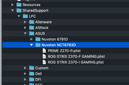

ctich Posted January 26, 2020 Share Posted January 26, 2020 4 hours ago, vector sigma said: @joedm ru i had a lot of problems in retrieve the ChipName property, until i realize that the key is published this way: \U0421hipName and even the ioreg command line refuse to show it, so I made the code this way: if (ioreg) { auto chipName = OSString::withCString(dataSource->getModelName()); const OSSymbol *cn = OSSymbol::withCString("ChipName"); ioreg->setProperty(cn, chipName); chipName->release(); } This is the fixed file SMCSuperIO.cpp.zip (please don't copy/paste from the forum) Guys, try the following app and the following SMCSuperIO.kext, otherwise wont work: HWMonitorSMC2.app_v2.5.2_Beta.zip SMCSuperIO.kext_v1.1.1.zip Help in making the configuration: use this command line: hwmlpcconfig.zip to create the right directory structure for HWMonitorSMC2.app. The program will show OEM informations and not last the LPC chip name needed to correctly place the configuration in the appropriate sub directory. ~/Desktop/LPC/Vendor/ChipName/Board.plist will be created. Of course this is not a valid configuration: you have to correct it with real values. Note: users that already posted their configurations should run hwmlpcconfig and tell me the new path to make them working again. P.S. the autodetection will work only with Clover and with very last OpenCore. In HWMonitorSMC2: But there must be Nuvoton NCT6793D. 1 Link to comment https://www.insanelymac.com/forum/topic/335292-virtualsmc-%E2%80%94-smc-emulator/page/27/#findComment-2705885 Share on other sites More sharing options...

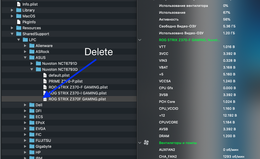

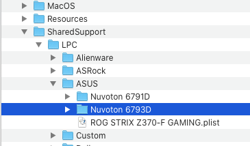

Nuacho Posted January 26, 2020 Share Posted January 26, 2020 2 minutes ago, ctich said: In HWMonitorSMC2: But there must be Nuvoton NCT6793D. you are right 1 Link to comment https://www.insanelymac.com/forum/topic/335292-virtualsmc-%E2%80%94-smc-emulator/page/27/#findComment-2705887 Share on other sites More sharing options...
vector sigma Posted January 26, 2020 Share Posted January 26, 2020 (edited) On 1/26/2020 at 10:35 PM, ctich said: But there must be Nuvoton NCT6793D. Fixed thanks. Guys, the final [REMOVED], check it one last. OT For who may be interested, here you can find all the files to translate the app. Mostly needs just some lines to be translated after latest changes. Edited February 2, 2020 by vector sigma Beta app removed 1 1 Link to comment https://www.insanelymac.com/forum/topic/335292-virtualsmc-%E2%80%94-smc-emulator/page/27/#findComment-2705890 Share on other sites More sharing options...
Nuacho Posted January 26, 2020 Share Posted January 26, 2020 5 minutes ago, vector sigma said: Fixed thanks. Guys, the final HWMonitorSMC2.app.zip, check it one last. OT For who may be interested, here you can find all the files to translate the app. Mostly needs just some lines to be translated after latest changes. all right. remove one plist Link to comment https://www.insanelymac.com/forum/topic/335292-virtualsmc-%E2%80%94-smc-emulator/page/27/#findComment-2705892 Share on other sites More sharing options...
Nuacho Posted January 26, 2020 Share Posted January 26, 2020 @vector sigma I would not delete, so that if possible I could skip Link to comment https://www.insanelymac.com/forum/topic/335292-virtualsmc-%E2%80%94-smc-emulator/page/27/#findComment-2705897 Share on other sites More sharing options...
vector sigma Posted January 26, 2020 Share Posted January 26, 2020 4 minutes ago, Nuacho said: I would not delete, so that if possible I could skip To the end I did not understand if you want to show them or not Lol Link to comment https://www.insanelymac.com/forum/topic/335292-virtualsmc-%E2%80%94-smc-emulator/page/27/#findComment-2705900 Share on other sites More sharing options...

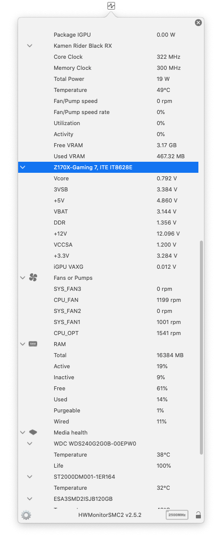

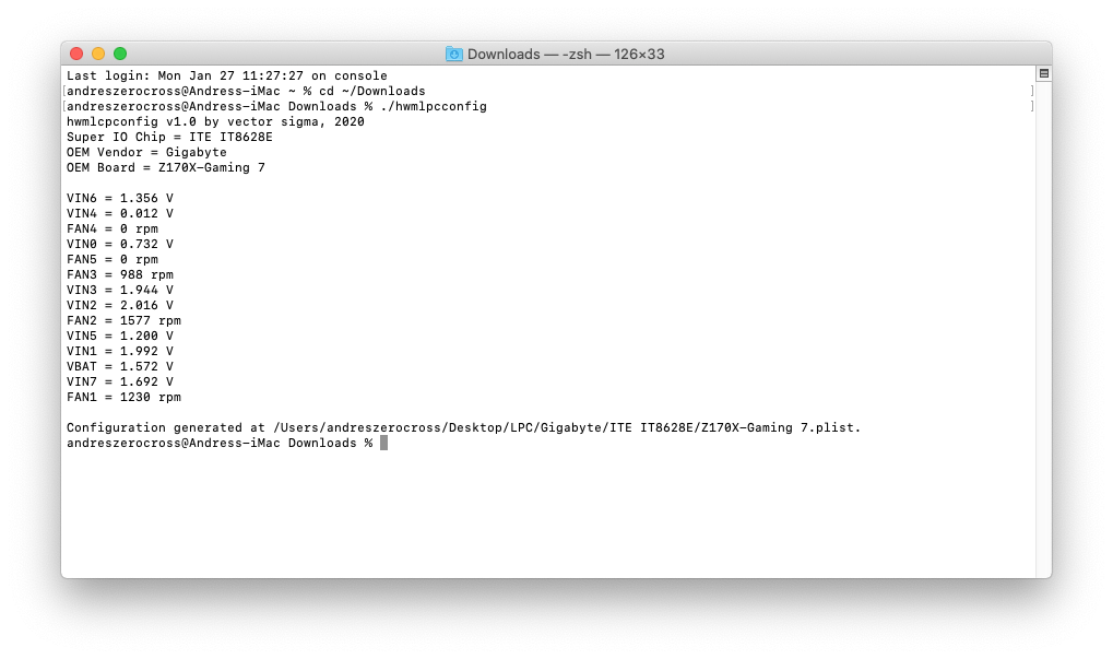

Andres ZeroCross Posted January 27, 2020 Share Posted January 27, 2020 (edited) 6 hours ago, vector sigma said: To the end I did not understand if you want to show them or not Lol Z170X-Gaming 7.plist Edited January 27, 2020 by Andres ZeroCross 1 Link to comment https://www.insanelymac.com/forum/topic/335292-virtualsmc-%E2%80%94-smc-emulator/page/27/#findComment-2705938 Share on other sites More sharing options...
jinbingmao Posted January 27, 2020 Share Posted January 27, 2020 (edited) 5 hours ago, Andres ZeroCross said: Z170X-游戏 7.plist Should be submitted like this。 Gigabyte.zip LPC/Gigabyte/ITE IT8628E/Z170X-Gaming 7.plist Please delete this file LPC/Gigabyte/ITE IT8728F/Z170X-Gaming 7.plist Edited January 27, 2020 by jinbingmao Link to comment https://www.insanelymac.com/forum/topic/335292-virtualsmc-%E2%80%94-smc-emulator/page/27/#findComment-2705954 Share on other sites More sharing options...

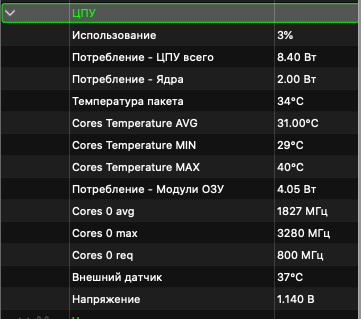

Andrey1970 Posted January 27, 2020 Share Posted January 27, 2020 12 hours ago, vector sigma said: Fixed thanks. Guys, the final HWMonitorSMC2.app.zip, check it one last. This version not show Cores frequency MIN Link to comment https://www.insanelymac.com/forum/topic/335292-virtualsmc-%E2%80%94-smc-emulator/page/27/#findComment-2705960 Share on other sites More sharing options...
vector sigma Posted January 27, 2020 Share Posted January 27, 2020 35 minutes ago, Andrey1970 said: This version not show Cores frequency MIN Was working? ..here always 0, at least on my laptop. The code is commented out but I'll test again with my Haswell desktop system.. Link to comment https://www.insanelymac.com/forum/topic/335292-virtualsmc-%E2%80%94-smc-emulator/page/27/#findComment-2705970 Share on other sites More sharing options...
Andrey1970 Posted January 27, 2020 Share Posted January 27, 2020 25 minutes ago, vector sigma said: Was working? ..here always 0, at least on my laptop. The code is commented out but I'll test again with my Haswell desktop system.. There not zero. Link to comment https://www.insanelymac.com/forum/topic/335292-virtualsmc-%E2%80%94-smc-emulator/page/27/#findComment-2705974 Share on other sites More sharing options...

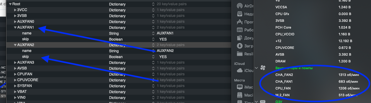

vector sigma Posted January 27, 2020 Share Posted January 27, 2020 Guys, what if fans that reports 0 rpm will be automatically skipped? 2 Link to comment https://www.insanelymac.com/forum/topic/335292-virtualsmc-%E2%80%94-smc-emulator/page/27/#findComment-2706031 Share on other sites More sharing options...
Nuacho Posted January 27, 2020 Share Posted January 27, 2020 3 minutes ago, vector sigma said: Ребята, а что если фанаты, которые сообщают 0 об / мин, будут автоматически пропущены? yes, I think it will be right 1 Link to comment https://www.insanelymac.com/forum/topic/335292-virtualsmc-%E2%80%94-smc-emulator/page/27/#findComment-2706032 Share on other sites More sharing options...
Andrey1970 Posted January 27, 2020 Share Posted January 27, 2020 33 minutes ago, vector sigma said: Guys, what if fans that reports 0 rpm will be automatically skipped? But if the fan breaks, it will disappear. Link to comment https://www.insanelymac.com/forum/topic/335292-virtualsmc-%E2%80%94-smc-emulator/page/27/#findComment-2706036 Share on other sites More sharing options...
vector sigma Posted January 27, 2020 Share Posted January 27, 2020 1 minute ago, Andrey1970 said: But if the fan breaks, it will disappear. Not entirely true. When the sensor it is added it will continue monitoring even if the value is zero. The problem is if starts broken. Link to comment https://www.insanelymac.com/forum/topic/335292-virtualsmc-%E2%80%94-smc-emulator/page/27/#findComment-2706037 Share on other sites More sharing options...
Nuacho Posted January 27, 2020 Share Posted January 27, 2020 (edited) 7 minutes ago, vector sigma said: Not entirely true. When the sensor it is added it will continue monitoring even if the value is zero. The problem is if starts broken. do let's check Edited January 27, 2020 by Nuacho Link to comment https://www.insanelymac.com/forum/topic/335292-virtualsmc-%E2%80%94-smc-emulator/page/27/#findComment-2706039 Share on other sites More sharing options...
rramon Posted January 27, 2020 Share Posted January 27, 2020 1 hour ago, vector sigma said: Guys, what if fans that reports 0 rpm will be automatically skipped? Clean approach, like it! Link to comment https://www.insanelymac.com/forum/topic/335292-virtualsmc-%E2%80%94-smc-emulator/page/27/#findComment-2706042 Share on other sites More sharing options...
Andrey1970 Posted January 28, 2020 Share Posted January 28, 2020 12 hours ago, vector sigma said: Guys, what if fans that reports 0 rpm will be automatically skipped? But then users will send not full configuration files of motherboards to database HWMonitorSMC2. In configuration database there shall be all fans. 2 Link to comment https://www.insanelymac.com/forum/topic/335292-virtualsmc-%E2%80%94-smc-emulator/page/27/#findComment-2706093 Share on other sites More sharing options...
jinbingmao Posted January 28, 2020 Share Posted January 28, 2020 12 hours ago, vector sigma said: Not entirely true. When the sensor it is added it will continue monitoring even if the value is zero. The problem is if starts broken. Add an option button in the main menu, which is freely selected by the user. Link to comment https://www.insanelymac.com/forum/topic/335292-virtualsmc-%E2%80%94-smc-emulator/page/27/#findComment-2706094 Share on other sites More sharing options...
