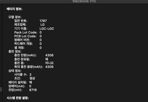

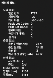

usr-sse2 Posted October 14, 2019 Share Posted October 14, 2019 (edited) 51 minutes ago, Sherlocks said: now i have 2 cycles. seems good my battery capacity is 4553. will be fix? I see an error with rounding in calculation of mA•h from mW•h. Voltage is converted from millivolts to volts (7600/1000 = 7) and then capacity is divided by 7, instead of being multiplied by 1000 and then divided by 7600 which is the equivalent of division by 7.6. Fixed in master (not tested as my laptop has mA•h in ACPI). SMCBatteryManager.kext.zip Edited October 14, 2019 by usr-sse2 Link to comment https://www.insanelymac.com/forum/topic/335292-virtualsmc-%E2%80%94-smc-emulator/page/21/#findComment-2693558 Share on other sites More sharing options...
Sherlocks Posted October 14, 2019 Share Posted October 14, 2019 (edited) 15 minutes ago, usr-sse2 said: I see an error with rounding in calculation of mA•h from mW•h. Voltage is converted from millivolts to volts (7600/1000 = 7) and then capacity is divided by 7, instead of being multiplied by 1000 and then divided by 7600 which is the equivalent of division by 7.6. Fixed in master (not tested as my laptop has mA•h in ACPI). SMCBatteryManager.kext.zip still 4912 EDIT1 this line need edit? https://github.com/acidanthera/VirtualSMC/blob/785594f2fcd60ad68479b5e0fc8fa35d09df1e45/Sensors/SMCBatteryManager/BatteryManager.cpp#L14 Edited October 14, 2019 by Sherlocks Link to comment https://www.insanelymac.com/forum/topic/335292-virtualsmc-%E2%80%94-smc-emulator/page/21/#findComment-2693559 Share on other sites More sharing options...
usr-sse2 Posted October 14, 2019 Share Posted October 14, 2019 (edited) 1 hour ago, Sherlocks said: still 4912 EDIT1 this line need edit? https://github.com/acidanthera/VirtualSMC/blob/785594f2fcd60ad68479b5e0fc8fa35d09df1e45/Sensors/SMCBatteryManager/BatteryManager.cpp#L14 Yes, I fixed only current capacity and forgot about full. Thanks, fixed there too. SMCBatteryManager.kext.zip Edited October 14, 2019 by usr-sse2 Attach file 1 Link to comment https://www.insanelymac.com/forum/topic/335292-virtualsmc-%E2%80%94-smc-emulator/page/21/#findComment-2693568 Share on other sites More sharing options...

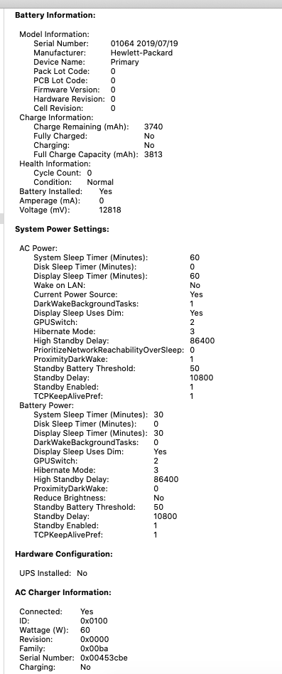

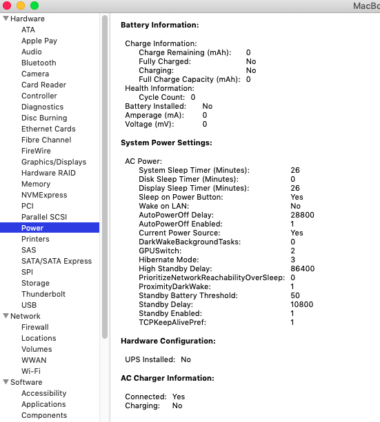

DonBronko Posted October 14, 2019 Share Posted October 14, 2019 I have an HP probook 450 G6. My battery status, cycle count and charging information is working with acpibatterymanager but not really with smcbatterymanager. And as you can see smcbatterymanager is showing in sysinfo not fully charged and isnt charging the battery. But the battery is at 100%. What could be the problem? Link to comment https://www.insanelymac.com/forum/topic/335292-virtualsmc-%E2%80%94-smc-emulator/page/21/#findComment-2693604 Share on other sites More sharing options...

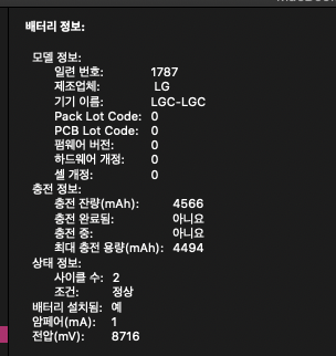

Sherlocks Posted October 14, 2019 Share Posted October 14, 2019 6 hours ago, usr-sse2 said: Yes, I fixed only current capacity and forgot about full. Thanks, fixed there too. SMCBatteryManager.kext.zip thanks alot seems good Link to comment https://www.insanelymac.com/forum/topic/335292-virtualsmc-%E2%80%94-smc-emulator/page/21/#findComment-2693614 Share on other sites More sharing options...

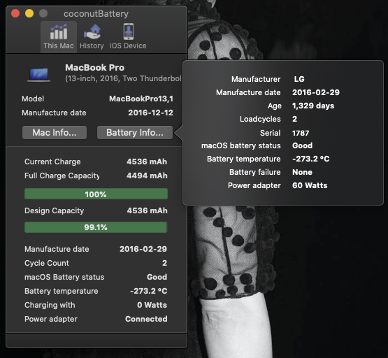

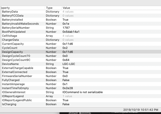

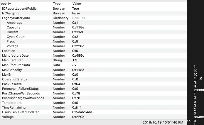

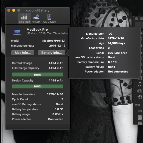

Sherlocks Posted October 19, 2019 Share Posted October 19, 2019 (edited) On 10/15/2019 at 12:28 AM, usr-sse2 said: Yes, I fixed only current capacity and forgot about full. Thanks, fixed there too. SMCBatteryManager.kext.zip @usr-sse2 i tested it about 4days. there is a problem. in systemprofiler, MaxCapacity is 0x118e :: 4494 but current is 0x11d6. 4566 maxcapacity always lower than current. there is something wrong. also to debug, i added bootarg "-vsmcdbg, -liludbg" i can get this log Timestamp (process)[PID] 2019-10-19 23:01:15.744375+0900 localhost kernel[0]: (kernel) SMCBatteryManager: smcbus @ (DBG) startRequest is called 2019-10-19 23:01:15.744382+0900 localhost kernel[0]: (kernel) SMCBatteryManager: smcbus @ (DBG) startRequest is called, address = 0xb, command = 0xb, protocol = 0x9, status = 0xff, sendDataCount = 0x0, receiveDataCount = 0x2 2019-10-19 23:01:15.797776+0900 localhost kernel[0]: (kernel) SMCBatteryManager: smcbus @ (DBG) startRequest is called 2019-10-19 23:01:15.797783+0900 localhost kernel[0]: (kernel) SMCBatteryManager: smcbus @ (DBG) startRequest is called, address = 0xa, command = 0x2, protocol = 0x9, status = 0xff, sendDataCount = 0x0, receiveDataCount = 0x2 2019-10-19 23:01:15.797795+0900 localhost kernel[0]: (kernel) SMCBatteryManager: smcbus @ (DBG) startRequest is called 2019-10-19 23:01:15.797801+0900 localhost kernel[0]: (kernel) SMCBatteryManager: smcbus @ (DBG) startRequest is called, address = 0xa, command = 0x1, protocol = 0x9, status = 0xff, sendDataCount = 0x0, receiveDataCount = 0x2 2019-10-19 23:01:15.798230+0900 localhost kernel[0]: (kernel) SMCBatteryManager: smcbus @ (DBG) startRequest is called 2019-10-19 23:01:15.798236+0900 localhost kernel[0]: (kernel) SMCBatteryManager: smcbus @ (DBG) startRequest is called, address = 0xb, command = 0x0, protocol = 0x8, status = 0xff, sendDataCount = 0x2, receiveDataCount = 0x0 2019-10-19 23:01:15.798244+0900 localhost kernel[0]: (kernel) SMCBatteryManager: smcbus @ (DBG) startRequest sendData contains kBExtendedPFStatusCmd or kBExtendedOperationStatusCmd 2019-10-19 23:01:15.898873+0900 localhost kernel[0]: (kernel) SMCBatteryManager: smcbus @ (DBG) startRequest is called 2019-10-19 23:01:15.898893+0900 localhost kernel[0]: (kernel) SMCBatteryManager: smcbus @ (DBG) startRequest is called, address = 0xb, command = 0x0, protocol = 0x9, status = 0xff, sendDataCount = 0x0, receiveDataCount = 0x2 2019-10-19 23:01:15.898942+0900 localhost kernel[0]: (kernel) SMCBatteryManager: smcbus @ (DBG) startRequest is called 2019-10-19 23:01:15.898958+0900 localhost kernel[0]: (kernel) SMCBatteryManager: smcbus @ (DBG) startRequest is called, address = 0xb, command = 0x20, protocol = 0xb, status = 0xff, sendDataCount = 0x0, receiveDataCount = 0x0 2019-10-19 23:01:15.898984+0900 localhost kernel[0]: (kernel) SMCBatteryManager: smcbus @ (DBG) startRequest is called 2019-10-19 23:01:15.898999+0900 localhost kernel[0]: (kernel) SMCBatteryManager: smcbus @ (DBG) startRequest is called, address = 0xb, command = 0x23, protocol = 0xb, status = 0xff, sendDataCount = 0x0, receiveDataCount = 0x0 2019-10-19 23:01:15.899030+0900 localhost kernel[0]: (kernel) SMCBatteryManager: smcbus @ (DBG) startRequest is called 2019-10-19 23:01:15.899044+0900 localhost kernel[0]: (kernel) SMCBatteryManager: smcbus @ (DBG) startRequest is called, address = 0xb, command = 0x70, protocol = 0xb, status = 0xff, sendDataCount = 0x0, receiveDataCount = 0x0 2019-10-19 23:01:15.899073+0900 localhost kernel[0]: (kernel) SMCBatteryManager: smcbus @ (DBG) startRequest is called 2019-10-19 23:01:15.899089+0900 localhost kernel[0]: (kernel) SMCBatteryManager: smcbus @ (DBG) startRequest is called, address = 0xb, command = 0x21, protocol = 0xb, status = 0xff, sendDataCount = 0x0, receiveDataCount = 0x0 2019-10-19 23:01:15.899112+0900 localhost kernel[0]: (kernel) SMCBatteryManager: smcbus @ (DBG) startRequest is called but. i can't get this line for example SYSLOG("acpib", "battery %d has no remaining capacity reported (%u)", id, DBGLOG("binfo", "battery voltage %d,%03d", mV / 1000, mV % 1000); SYSLOG("binfo", "battery reports mWh but uses mAh (%u)", designCapacity); just only show log related in "smcbus" thanks in advance EDIT1 SMCBattery ACPIBattery Edited October 20, 2019 by Sherlocks Link to comment https://www.insanelymac.com/forum/topic/335292-virtualsmc-%E2%80%94-smc-emulator/page/21/#findComment-2694251 Share on other sites More sharing options...

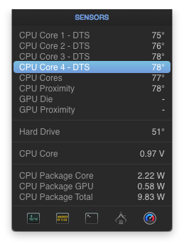

an1r0n Posted October 21, 2019 Share Posted October 21, 2019 (edited) Anyone using Intel Iris 5200 GPU? VirtualSMC doesn't seem to show GPU temps anymore. Any advice? I am using the latest VirtualSMC version, along with Whatevergreen. Thanks! Edited October 21, 2019 by an1r0n Link to comment https://www.insanelymac.com/forum/topic/335292-virtualsmc-%E2%80%94-smc-emulator/page/21/#findComment-2694562 Share on other sites More sharing options...

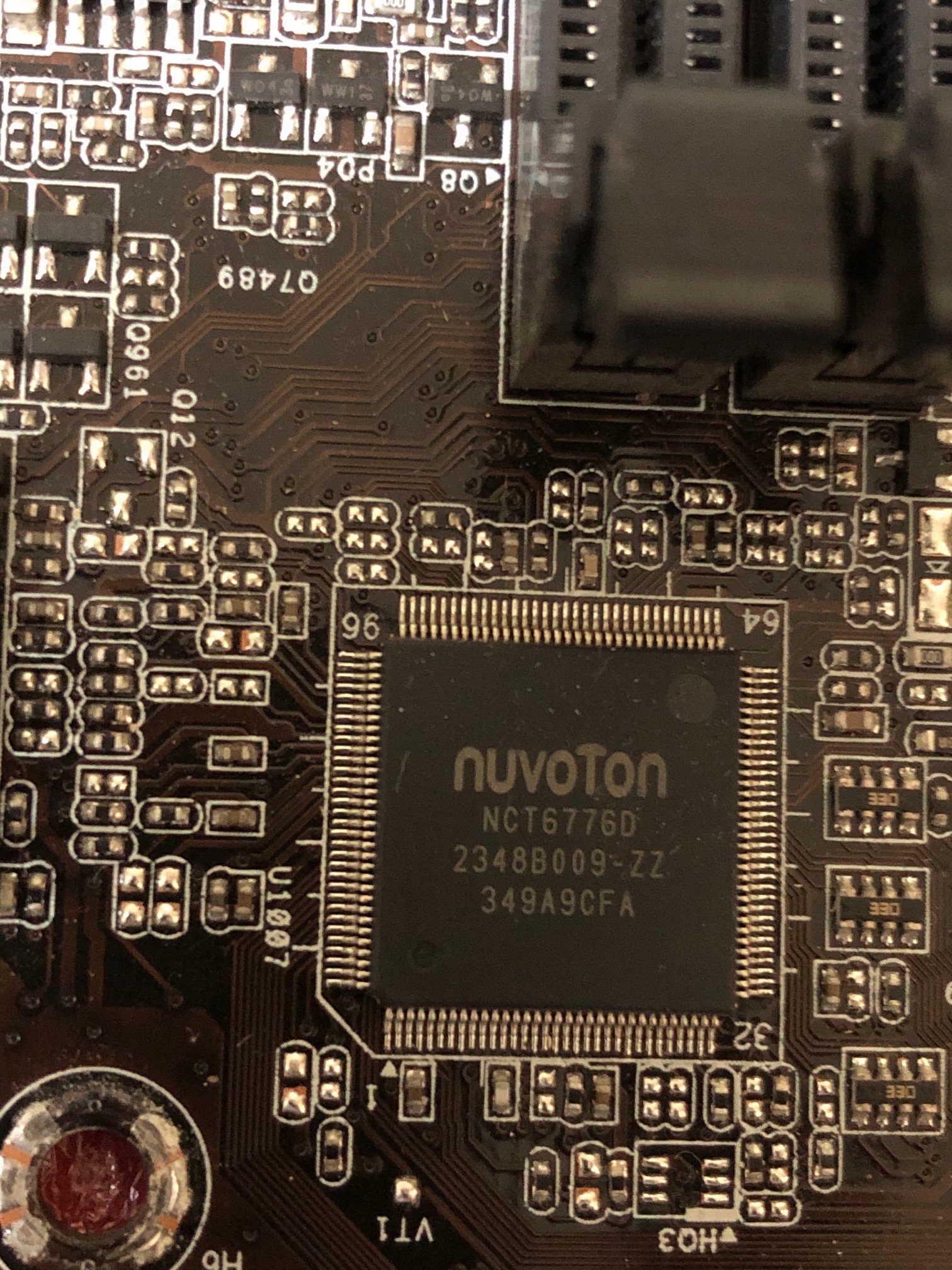

margono Posted December 3, 2019 Share Posted December 3, 2019 (edited) On 4/4/2019 at 6:06 AM, Modmike said: I just fixed NCT6798D and added NCT679BD to VirtualSMC for Z370 & Z390 support. Can you guys please test it? It works great for me so far. I only have 1 pump, fans are on a noncontrollable hub. Nuvoton.zip @Modmike my board using NCT6776D can you add it too? Edited December 17, 2019 by margono edit Link to comment https://www.insanelymac.com/forum/topic/335292-virtualsmc-%E2%80%94-smc-emulator/page/21/#findComment-2699477 Share on other sites More sharing options...

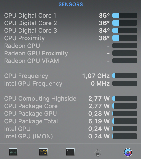

1Ale1 Posted December 8, 2019 Share Posted December 8, 2019 (edited) @vit9696 Trying for the first time VirtualSMC 1.0.9 with iStat Menus 6.40, I've read the docs and I found them very useful. Since VirtualSMC seems to be reading correctly the GPU temperature in the CPU & GPU drop-down menu, is it possible to display that value even in GPU-Proximity, which currently displays a "-" ? And for CPU frequency monitoring installing Intel power Gadget is sufficient? I found some users having issues with that, maybe because the .pkg was able to write/damage permissions in the preboot volume or something causing an instant reboot across many platforms right after logins... Anyway good job guys for keeping VirtualSMC clean and stable. I hope new features are coming in the next updates Edited December 8, 2019 by 1Ale1 Link to comment https://www.insanelymac.com/forum/topic/335292-virtualsmc-%E2%80%94-smc-emulator/page/21/#findComment-2699964 Share on other sites More sharing options...

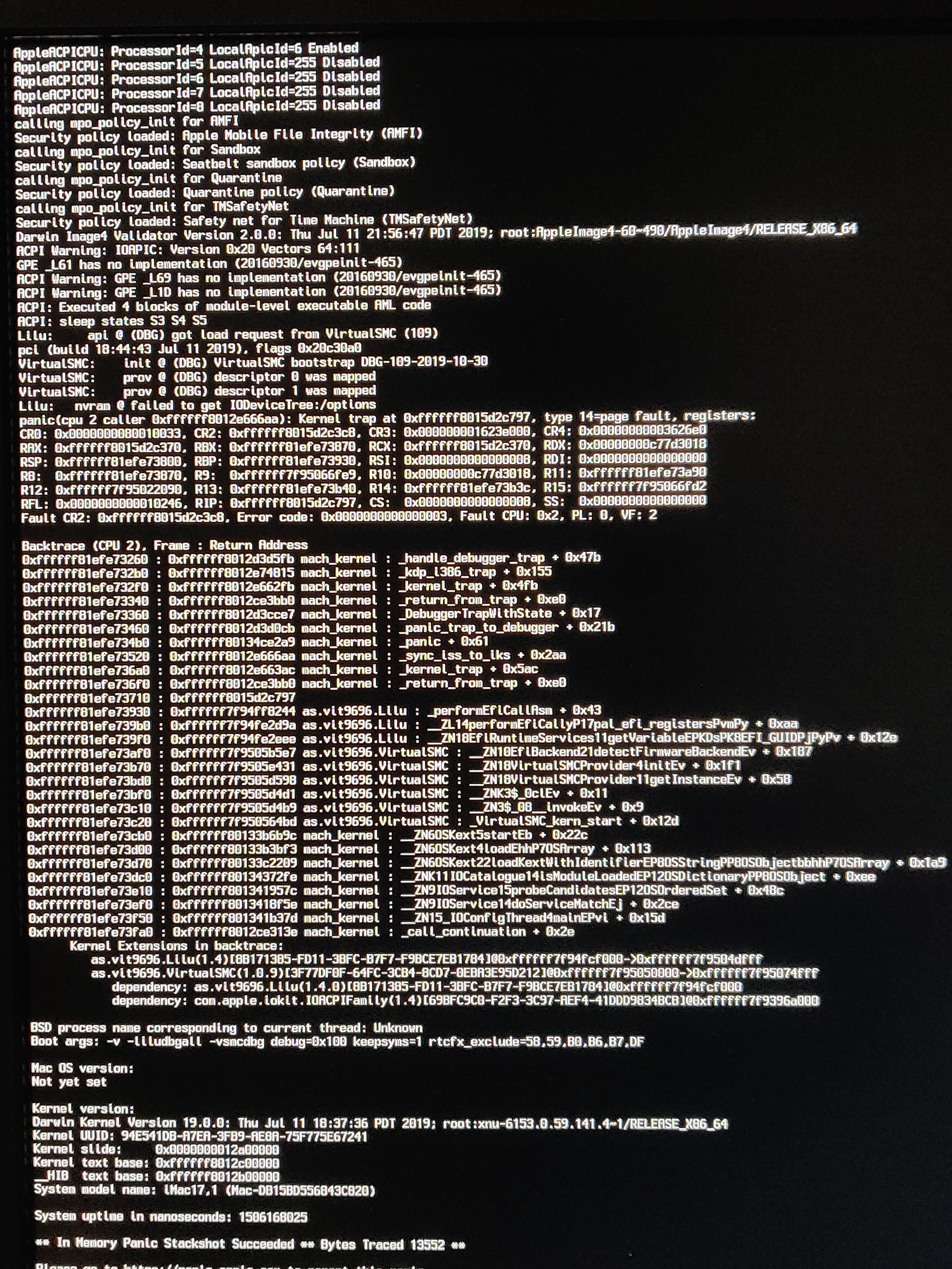

Zhen-zen Posted January 6, 2020 Share Posted January 6, 2020 Hello, I was upgrading my desktop after a long break. It was running like OC 0.3 and VirtualSMC 1.0.5 (around June) on Catalina 10.15 GM. I tried just upgrade the system but there's a KP in the middle. Then I upgrade them to OC 0.5.3 as well as all other kexts. But there's still something wrong, with Lilu, VirtualSMC and IOACPIFamily in the log. Although I have read that these kind of problem might be other kexts' issue. I have trimmed all unnecessary kexts but didn't help. The log hints there might be something wrong when loading VirtualSMC and no other custom kexts are loaded at this early stage. I hope if you can give me some suggestions. Link to comment https://www.insanelymac.com/forum/topic/335292-virtualsmc-%E2%80%94-smc-emulator/page/21/#findComment-2703162 Share on other sites More sharing options...
holyfield Posted January 6, 2020 Share Posted January 6, 2020 1 hour ago, gongzhen said: I hope if you can give me some suggestions. Could you post even more blurry image? And thank you for being very secretive about your system, that helps a lot to make suggestions! Link to comment https://www.insanelymac.com/forum/topic/335292-virtualsmc-%E2%80%94-smc-emulator/page/21/#findComment-2703185 Share on other sites More sharing options...

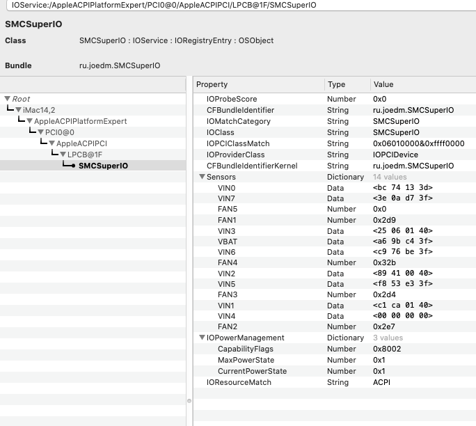

jinbingmao Posted January 6, 2020 Share Posted January 6, 2020 Added fan and voltage reporting in SMCSuperIO through I/O Registry (requires client updates) by @joedmru https://github.com/acidanthera/VirtualSMC/commit/ab5e40d02a4079bc35ecffec51fb601fd21cf738 Link to comment https://www.insanelymac.com/forum/topic/335292-virtualsmc-%E2%80%94-smc-emulator/page/21/#findComment-2703256 Share on other sites More sharing options...
holyfield Posted January 6, 2020 Share Posted January 6, 2020 43 minutes ago, jinbingmao said: Added fan and voltage reporting in SMCSuperIO through I/O Registry (requires client updates) by @joedmru https://github.com/acidanthera/VirtualSMC/commit/ab5e40d02a4079bc35ecffec51fb601fd21cf738 When next release will be avaialble? Link to comment https://www.insanelymac.com/forum/topic/335292-virtualsmc-%E2%80%94-smc-emulator/page/21/#findComment-2703258 Share on other sites More sharing options...
Zhen-zen Posted January 7, 2020 Share Posted January 7, 2020 8 hours ago, holyfield said: Could you post even more blurry image? And thank you for being very secretive about your system, that helps a lot to make suggestions! Thank you for your kind remind. I thought I have put it somewhere like signature but it's not there. The machine is a HP Prodesk 400 G3 SFF (H110 chipset) with i5-6500 and HD530. The drive is a SanDisk SATA SSD and a disabled DVD writer which suffered from setPowerState issues before. The photo got compressed during transmission, and I took another one. Link to comment https://www.insanelymac.com/forum/topic/335292-virtualsmc-%E2%80%94-smc-emulator/page/21/#findComment-2703259 Share on other sites More sharing options...

holyfield Posted January 7, 2020 Share Posted January 7, 2020 18 minutes ago, gongzhen said: Thank you for your kind remind. I thought I have put it somewhere like signature but it's not there. The machine is a HP Prodesk 400 G3 SFF (H110 chipset) with i5-6500 and HD530. The drive is a SanDisk SATA SSD and a disabled DVD writer which suffered from setPowerState issues before. I reccomend to read about ACPI. Also I reccomend ALWAYS to have ready Ubuntu Live USB, so you can boot into Ubuntu and extract lspci list when posting help requests. Also do I really shall google all about your comp? Me or others are not clairvoyants. Seems power management issue at a first glance . Have you tried to boot with AppleIntelCPUPowerManagement.kext? Link to comment https://www.insanelymac.com/forum/topic/335292-virtualsmc-%E2%80%94-smc-emulator/page/21/#findComment-2703263 Share on other sites More sharing options...
Zhen-zen Posted January 7, 2020 Share Posted January 7, 2020 (edited) 1 hour ago, holyfield said: I reccomend to read about ACPI. Also I reccomend ALWAYS to have ready Ubuntu Live USB, so you can boot into Ubuntu and extract lspci list when posting help requests. Also do I really shall google all about your comp? Me or others are not clairvoyants. Seems power management issue at a first glance . Have you tried to boot with AppleIntelCPUPowerManagement.kext? Thank you for your patience. Since it also seems not a VirtualSMC issue, maybe I should open another thread elsewhere? In my old OC configuration, I did a lot of ACPI modification like CPU PLUG, DeepIdle, HPET SSDTs. I thought these are not related so I left ACPI section blank when debugging the KP after updating these kexts. Currently I only have Lilu vsmc alc weg and nothing's blocked. I haven't modified PM before so maybe it's working by default? I'm a little bit confused recently upgrading this one and another laptop to newer OC with other kexts, and both failed after reading difference.pdf several times. And sorry for the unclear specs, the lspci output is attached below. lspci.txt opencore-2020-01-07-080634.txt Edited January 7, 2020 by gongzhen Missing attachment Link to comment https://www.insanelymac.com/forum/topic/335292-virtualsmc-%E2%80%94-smc-emulator/page/21/#findComment-2703268 Share on other sites More sharing options...
holyfield Posted January 7, 2020 Share Posted January 7, 2020 (edited) 20 minutes ago, gongzhen said: Thank you for your patience. Since it also seems not a VirtualSMC issue, maybe I should open another thread elsewhere? Yes, you are correct! Edited January 7, 2020 by holyfield Link to comment https://www.insanelymac.com/forum/topic/335292-virtualsmc-%E2%80%94-smc-emulator/page/21/#findComment-2703270 Share on other sites More sharing options...
justin Posted January 7, 2020 Share Posted January 7, 2020 8 hours ago, Andrey1970 said: awesome upgrades, what software do you recommend to use to read the information? HWMonitorSMC2, iStat Menu and maybe others? Link to comment https://www.insanelymac.com/forum/topic/335292-virtualsmc-%E2%80%94-smc-emulator/page/21/#findComment-2703284 Share on other sites More sharing options...
Andrey1970 Posted January 7, 2020 Share Posted January 7, 2020 4 hours ago, justin said: awesome upgrades, what software do you recommend to use to read the information? HWMonitorSMC2, iStat Menu and maybe others? The software is absent, you ask @vector sigma that added support in HWMonitorSMC2. 1 Link to comment https://www.insanelymac.com/forum/topic/335292-virtualsmc-%E2%80%94-smc-emulator/page/21/#findComment-2703300 Share on other sites More sharing options...
