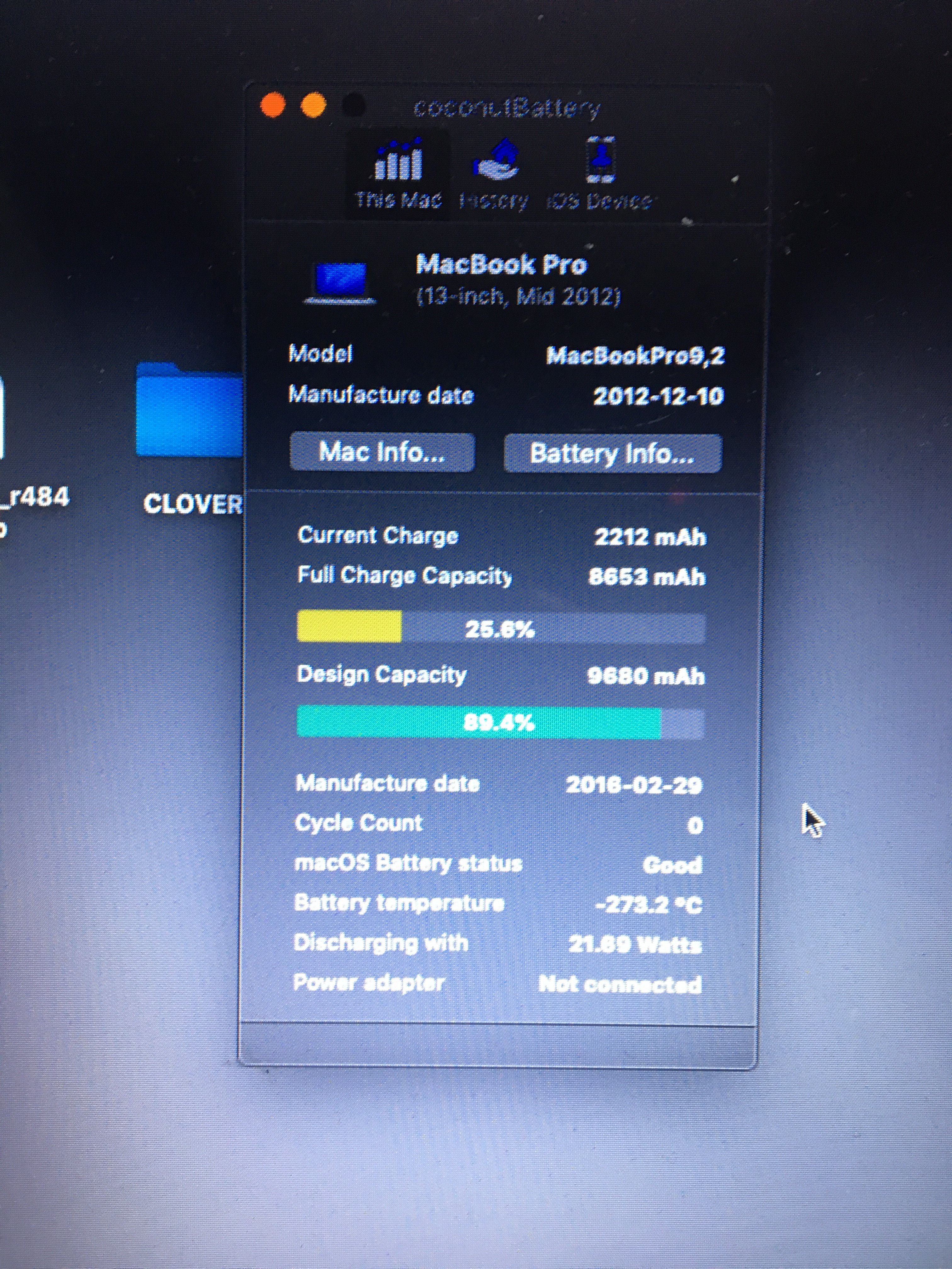

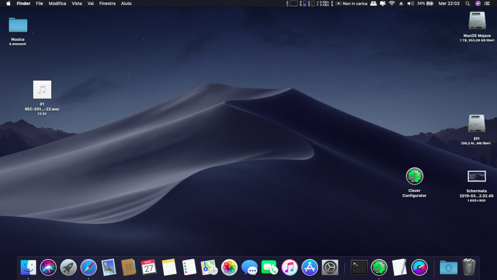

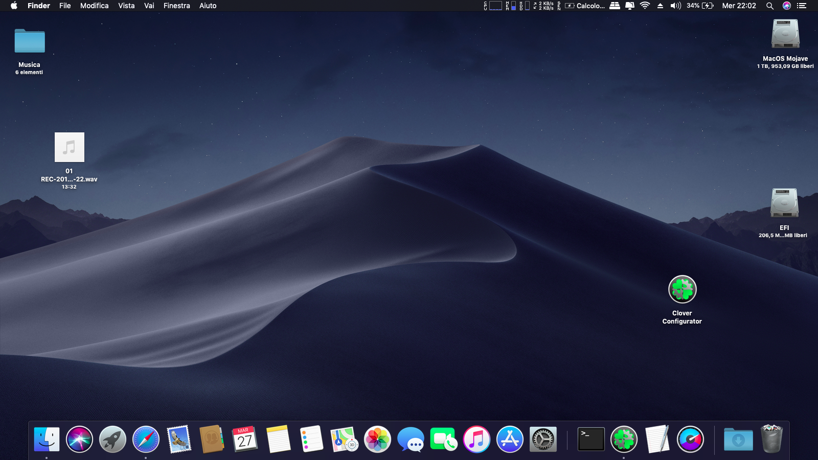

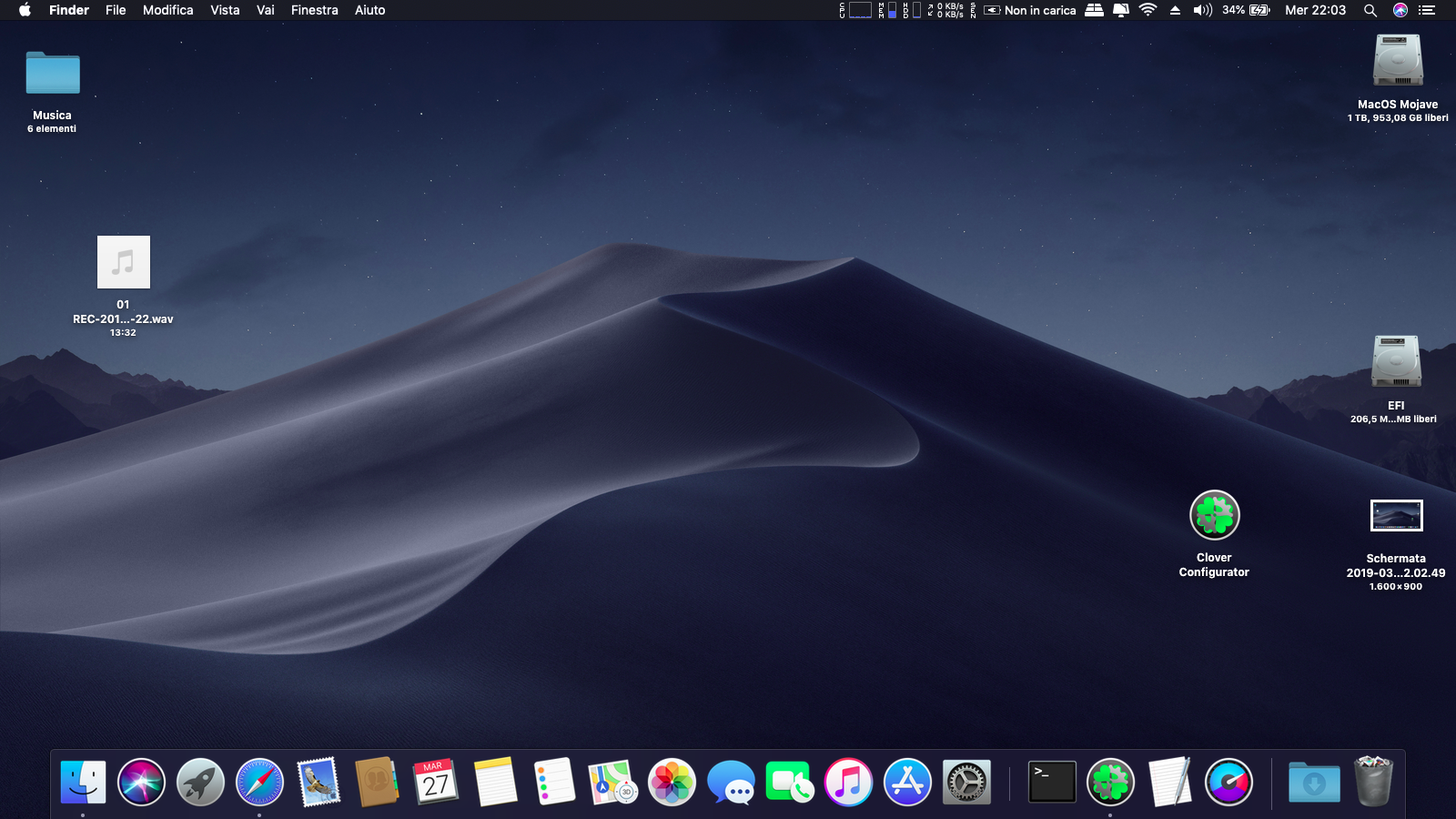

Emanuele-1998 Posted January 21, 2019 Share Posted January 21, 2019 (edited) I was trying to contact the developers through github but I could not. I use virtualsmc but the battery control is not accurate because using also istats to see the battery check marks me unpacked values. The temperature battery is -273? for example, the discharge time is 20 minutes and is at 7% and then turns off by itself. fan control is always a little accelerated and I can not change from the bios as I have a laptop. I did various tests and I saw that virtualsmc is better than fakesmc in my case as reported by the intel test.but I was wondering if it will be updated again. Edited January 21, 2019 by Emanuele-1998 Link to comment https://www.insanelymac.com/forum/topic/335292-virtualsmc-%E2%80%94-smc-emulator/page/16/#findComment-2660399 Share on other sites More sharing options...
Dr. Hurt Posted January 21, 2019 Share Posted January 21, 2019 -273C is 0 Kelvins (absolute zero). I think this happens when no battery temperature is reported (battery hardware doesn’t support reporting temperature). As for sudden shutdowns, that could mean your battery is going bad. It’s reporting incorrect capacity. Try to calibrate it by charging to 100% then discharging to power off. Repeat a couple of times. 1 Link to comment https://www.insanelymac.com/forum/topic/335292-virtualsmc-%E2%80%94-smc-emulator/page/16/#findComment-2660453 Share on other sites More sharing options...
Emanuele-1998 Posted January 25, 2019 Share Posted January 25, 2019 (edited) On 1/21/2019 at 5:11 PM, Dr. Hurt said: 273C is 0 Kelvins (absolute zero). I think this happens when no battery temperature is reported (battery hardware doesn’t support reporting temperature). As for sudden shutdowns, that could mean your battery is going bad. It’s reporting incorrect capacity. Try to calibrate it by charging to 100% then discharging to power off. Repeat a couple of times. the kext started but the system decided to close it by returning value 5, but it does not succeed for some reason. why do you close it if the kext continuously passes the values to intelpowergadget, istats...? @chris1111 @Dr. Hurt Edited January 25, 2019 by Emanuele-1998 1 Link to comment https://www.insanelymac.com/forum/topic/335292-virtualsmc-%E2%80%94-smc-emulator/page/16/#findComment-2661161 Share on other sites More sharing options...

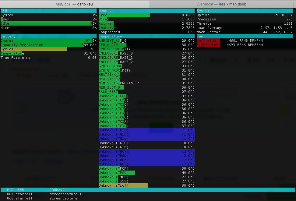

crashinc99 Posted February 1, 2019 Share Posted February 1, 2019 I'm getting thermal cycling on a 2012 MacBook Pro (Mac9,1). A project similar to this on github is called dshb and prints out the SMC values and labels (if known) or keys/values to unknown SMC keys. A screen capture is attached. The only temp being reported higher than the others is associated with SMC Key TSQF. I checked this post and a bunch of the links and VirtualSMC project source code and there's not much info on this key. Anyone know what TSQF is? I have iStat menu too and created a fan schedule that keeps the MBP running. The fan is on high a lot though. I was hoping Apple diagnostics would point to the culprit but it thermal cycles before diagnostics can complete running. I'm hoping I can figure out what h/w component is running hot and get the dang thing fixed. Thanks! Link to comment https://www.insanelymac.com/forum/topic/335292-virtualsmc-%E2%80%94-smc-emulator/page/16/#findComment-2662213 Share on other sites More sharing options...

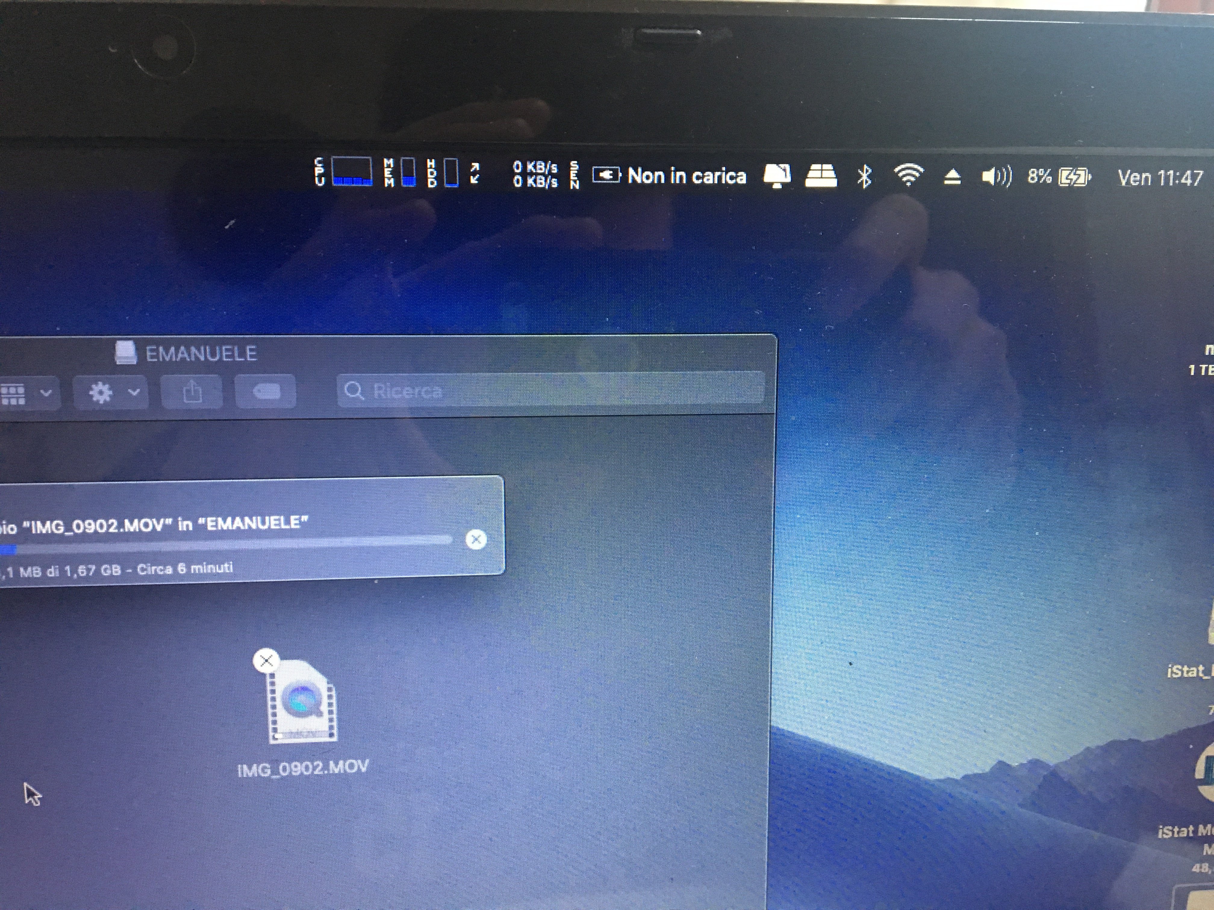

Emanuele-1998 Posted February 1, 2019 Share Posted February 1, 2019 (edited) @Dr. Hurt @vit9696 @chris1111 @vandroiy2012 it remains locked at 8% even if it is being loaded Edited February 1, 2019 by Emanuele-1998 Link to comment https://www.insanelymac.com/forum/topic/335292-virtualsmc-%E2%80%94-smc-emulator/page/16/#findComment-2662252 Share on other sites More sharing options...

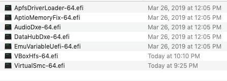

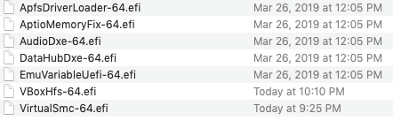

LockDown Posted February 1, 2019 Share Posted February 1, 2019 Does VirtualSMC.efi bypass SMCHelper.efi if both exist? Link to comment https://www.insanelymac.com/forum/topic/335292-virtualsmc-%E2%80%94-smc-emulator/page/16/#findComment-2662277 Share on other sites More sharing options...
Matgen84 Posted February 1, 2019 Share Posted February 1, 2019 2 hours ago, ellaosx said: Does VirtualSMC.efi bypass SMCHelper.efi if both exist? In FAQ. SMCHelper is not compatible with VirtualSMC: remove it What are the requirements? macOS 10.8.5 or newer. Compatible Lilu is required for full functionality, basic functionality will be available even on beta macOS versions or with -liluoff boot-arg. VirtualSMC.efi module is recommended for boot.efi compatibility when FileVault 2 is enabled. SMCHelper-64.efi is not compatible with VirtualSMC.efi and must be removed. 1 Link to comment https://www.insanelymac.com/forum/topic/335292-virtualsmc-%E2%80%94-smc-emulator/page/16/#findComment-2662300 Share on other sites More sharing options...

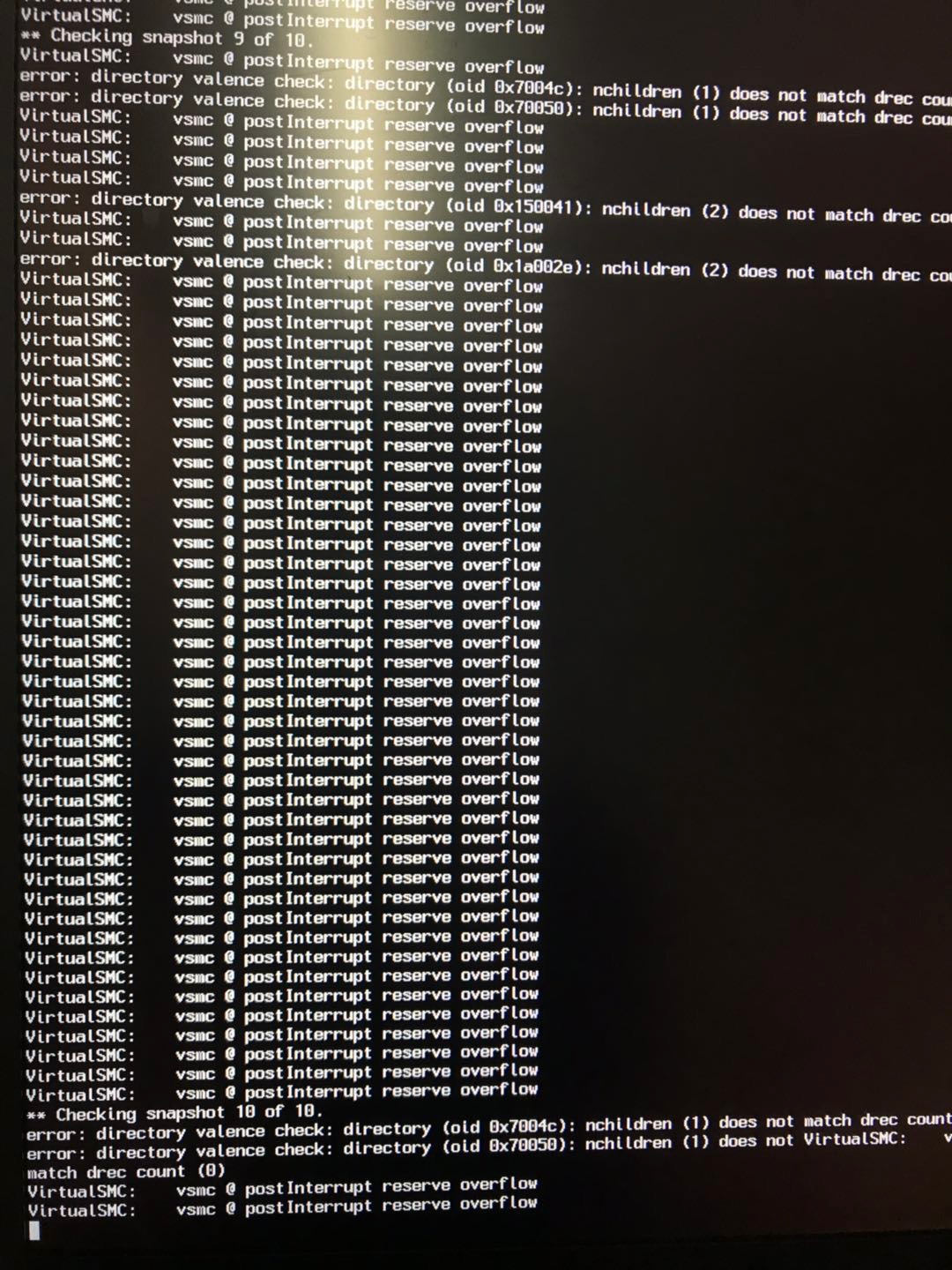

darkhandz Posted February 9, 2019 Share Posted February 9, 2019 How can I avoid the continuous VSMC log? (I'm in the Single-User-Mode) Link to comment https://www.insanelymac.com/forum/topic/335292-virtualsmc-%E2%80%94-smc-emulator/page/16/#findComment-2663340 Share on other sites More sharing options...
vit9696 Posted February 11, 2019 Author Share Posted February 11, 2019 Try without plugins. I think the issue could be caused by installing incompatible plugins, but hard to say at a glance. 3 Link to comment https://www.insanelymac.com/forum/topic/335292-virtualsmc-%E2%80%94-smc-emulator/page/16/#findComment-2663597 Share on other sites More sharing options...

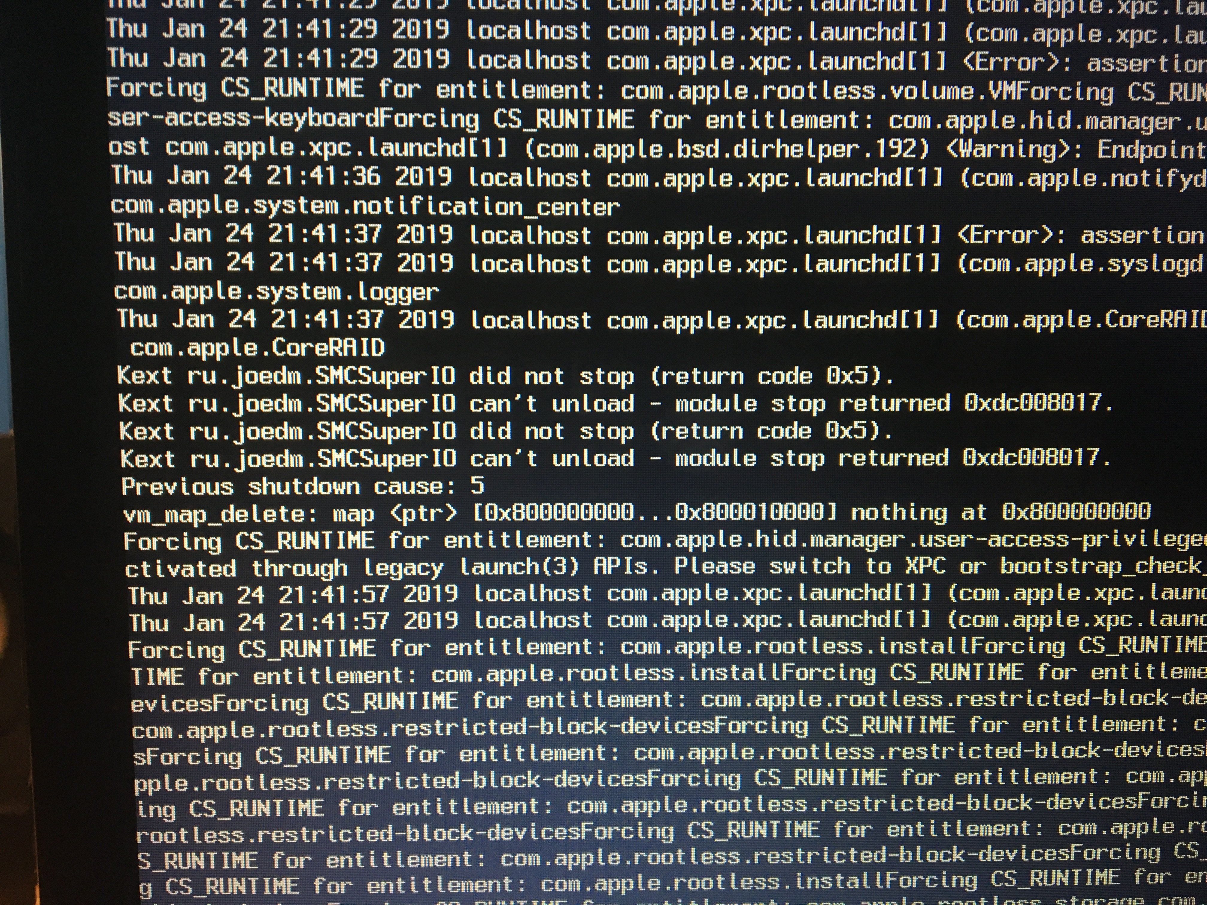

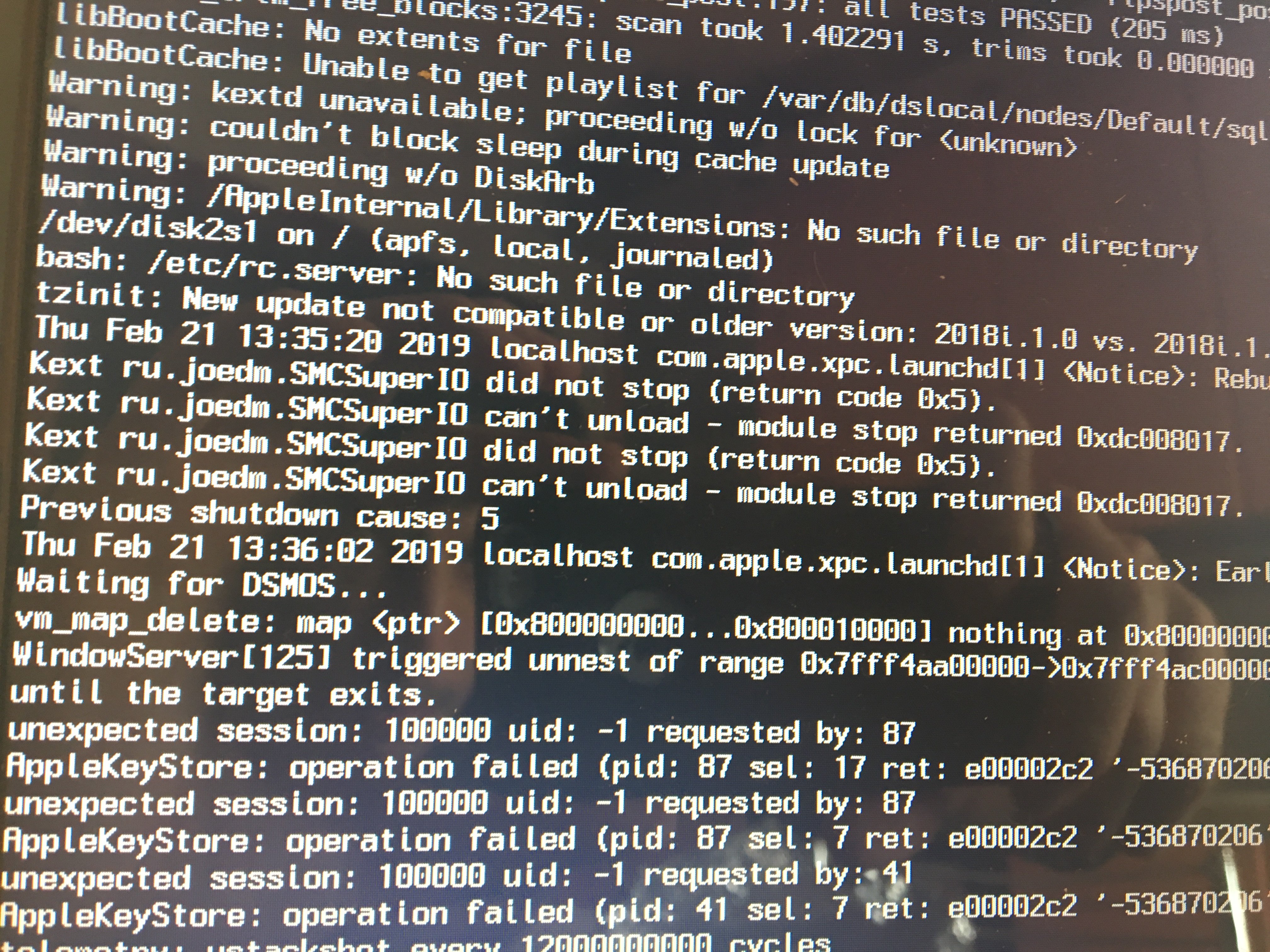

Emanuele-1998 Posted February 22, 2019 Share Posted February 22, 2019 Why can’t unload virtualSM super I/O ? @vit9696 @chris1111 @Dr. Hurt 1 Link to comment https://www.insanelymac.com/forum/topic/335292-virtualsmc-%E2%80%94-smc-emulator/page/16/#findComment-2665066 Share on other sites More sharing options...

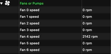

Modmike Posted March 29, 2019 Share Posted March 29, 2019 (edited) @vit9696 I spent 2 days trying to get a reading from my fan and am wondering if you could help me make it work. I have an Asus Z390-I that uses the NCT6798D and needs emulated nvram. I was poking around in one of the plists and saw that it was supported. I am currently on 10.14.4 and everything boots perfectly with VirtualSMC. Here is what I did: I deleted FakeSMC, its sensors, nvram.plist, and RC scripts from /etc. Using Clover Configurator I installed the following: VirtualSMC.kext, SMCProcessor.kext SMCSuperIO.kext VirtualSmc-64.efi (in drivers) I also installed the following apps: Intel Power Gadgets HWMonitorSMC2 (from GitHub) Screen shot of my /other kext folder and drivers. As you may remember from our previous conversation, I never put anything in /L/E Questions: Do I need RC scripts or not for emulated nvram with EmuVariableUefi-64.efi? I've read yes AND no in this thread. I still can not get my Fan speeds, do I need to configure in a plist? Seeing as I had about 20 different installs of different monitors and FakeSMC and multiple version of a few apps, do I need to delete a config or plist somewhere? Finally, is there a way to configure the HWMonitorSMC2 menus by modifying a plist? If so which one? I've attached a dump for you to examine. Thank you. dump.zip Edited March 29, 2019 by Modmike Link to comment https://www.insanelymac.com/forum/topic/335292-virtualsmc-%E2%80%94-smc-emulator/page/16/#findComment-2668370 Share on other sites More sharing options...
Modmike Posted April 3, 2019 Share Posted April 3, 2019 (edited) I just fixed NCT6798D and added NCT679BD to VirtualSMC for Z370 & Z390 support. Can you guys please test it? It works great for me so far. I only have 1 pump, fans are on a noncontrollable hub. Nuvoton.zip Edited April 4, 2019 by Modmike Link to comment https://www.insanelymac.com/forum/topic/335292-virtualsmc-%E2%80%94-smc-emulator/page/16/#findComment-2669026 Share on other sites More sharing options...

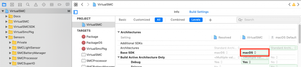

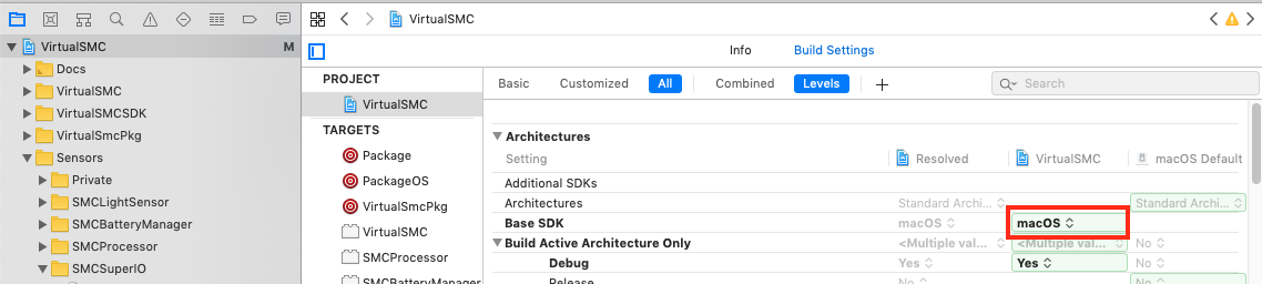

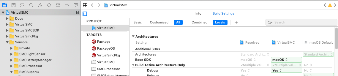

Badruzeus Posted April 4, 2019 Share Posted April 4, 2019 (edited) Hi @vit9696, when building VirtualSmcPkg using Xcode 10,1 under 10.13.6 it failed with this error message: Pccts/h/pccts_stdio.h:5:10: fatal error: 'cstdio' file not found Occurred after cloning UDK. mtoc was installed on `/usr/local/bin/`. Build separated *.kext from Scheme is succeeded though, I got this warning: /Users/badruzeus/Projects/XCode/VirtualSMC/Lilu.kext/Contents/Resources/Library/plugin_start.cpp:24:19: warning: unused variable 'kextVersion' [-Wunused-const-variable] static const char kextVersion[] { ^ 1 warning generated. Is there any missing step? Thanks. Edited April 4, 2019 by Badruzeus Link to comment https://www.insanelymac.com/forum/topic/335292-virtualsmc-%E2%80%94-smc-emulator/page/16/#findComment-2669049 Share on other sites More sharing options...
Modmike Posted April 4, 2019 Share Posted April 4, 2019 I had the same error. I solved it by setting the SDK to macOS: Everything compiled and ran but not sure if that is the right way to do it. 1 Link to comment https://www.insanelymac.com/forum/topic/335292-virtualsmc-%E2%80%94-smc-emulator/page/16/#findComment-2669064 Share on other sites More sharing options...

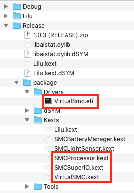

Modmike Posted April 4, 2019 Share Posted April 4, 2019 (edited) My Fan fix PR was just merged with the gracious help and infinite patience of @vit9696 I attached the files with all the sensors but if you want to build it yourself I suggest you download Hackintools and use that to build. It's fully automated and works great. Red highlights indicate that a newer version is available but it's not always a good idea to update unless you know the new version is good. In our case, the version is green but it is safe to build so I selected it: Hackintool will prompt you for permission to install components if they're missing but the process is otherwise automatic. When it's done it will open the build folder. The files you need are outlined below. Sensors.zip @vit9696 I really dislike the look of iStat. What configurable version of HWMonitor do you recommend? Edited April 4, 2019 by Modmike Link to comment https://www.insanelymac.com/forum/topic/335292-virtualsmc-%E2%80%94-smc-emulator/page/16/#findComment-2669079 Share on other sites More sharing options...
