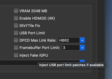

Hi @headkaze I hope you are well and safe.
A small bug accidentally discovered, for your next release:
The tooltip text for "Inject Fake IGPU" was probably accidentally copied from "USB Port Limit" code, in PATCH > Patch > Advanced section :D
Many thanks again for your continuing devotion to Hackintosh! Cheers mate.

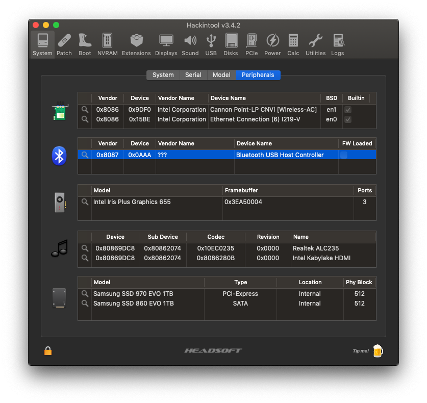

Wanted to report a missing ID for Vendor 0x8087 that is still Intel Corporation. Is this due to PCIIDs not being updated, or some other tool issue? Please see below the screenshots.
Intel 9560 Bluetooth 5.1 Module [8087:0aaa] reported as ? in Vendor Name column.
Just wanted to check with you :D
By the way, how is "FW Loaded" detected please? This way I can ask the developer of Intel Bluetooth to improve his/her kext as it works very well on Mojave and NUC8i7BEH ! Thank you!

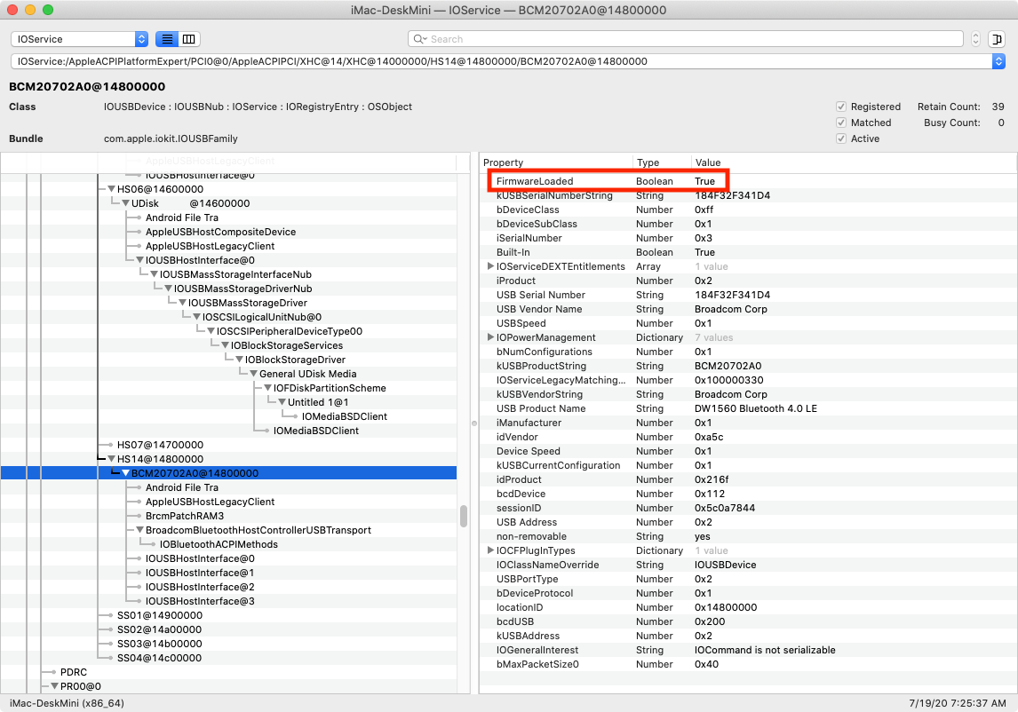

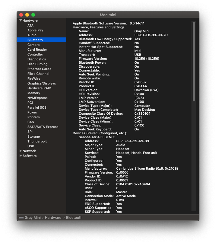

18 hours ago, MacKonsti said:
Hi @headkaze hope you are well and safe!
  Reveal hidden contents
I can add the Intel device id's (since they're "usb devices" they're not in the  PCIIDs database) so I add them manually.
There must be a "FirmwareLoaded" entry for the device's IOUSBDevice entry in IORegistry for Hackintool to detect a successful FW load.
a) Thank you for adding those @headkaze !
b) Please kindly add support for the working IntelBluetoothFirmware kext? Main repo is here: https://github.com/OpenIntelWireless/IntelBluetoothFirmware
This BTLE 5.0 module is integrated to the Intel AC-Wireless 9560 controller and works great on Mojave.
I asked the developers to also add FirmwareLoaded so you can detect it in Hackintool, please follow/join the thread if you can: https://github.com/OpenIntelWireless/IntelBluetoothFirmware/issues/142
c) Please add to your to-do list the kext-check support for the soon-to-be-officially-announce Intel AC-Wireless driver: https://github.com/OpenIntelWireless/itlwm
Kext has been stable in late builds and works great (emulates a LAN device as it's easier to implement, needs HeliPort to control the device: https://github.com/OpenIntelWireless/HeliPort for those interested)
When you can, of course. Thanks mate.
Edited by MacKonsti

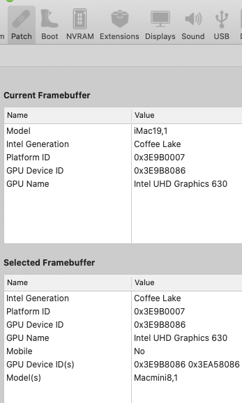

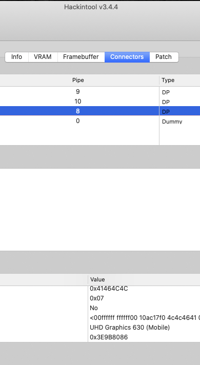

Two oddities I do not understand:-
When trying to search the forum for hackintool nothing comes up?
the other oddity different screens of information
one snapshot suggests that it is mobile
one snapshot suggests it is not mobile?
The other oddity is when installing kernels
I select my choice but hackintool always puts in system library
and removes it from Oc Kext folder
