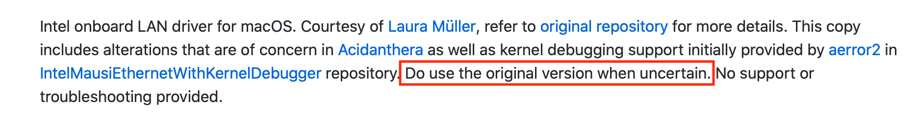

5 hours ago, Tiem said:
"Correct one"?
Hackintool lists IntelMausi as 1.0.2. First off this is wrong. Both IntelMausi and IntelMausiEthernet are at v2.5.0. Second, com.insanelymac.IntelMausiEthernet is the original project: https://github.com/Mieze/IntelMausiEthernet
Then you are referring to is from Acidenthera (https://github.com/acidanthera/IntelMausi) but even he says in the read me:
938206084_ScreenShot2020-03-01at9_21_48AM.thumb.png.5e9476a94452bc690c7ca188b594ab8b.png
Lastly, it still doesn't list the other kexts (SMCProcessor and SMCSuperIO), I assume because you are hard coding all these kexts. In any case, a bit confusing on the user's end.
Since they're both developed by Mieze you should ask her which one is the "correct" one then. In general I use the acidanthera version because they tend to be the latest and most actively developed. I do change them as needed when reported by users.
The version I'm using is:
   73    0 0xffffff7f8486b000 0x22000    0x22000    as.acidanthera.mieze.IntelMausi (1.0.2) 0F110A60-EA75-3D68-8619-4020F951982E <18 13 6 5 3 1>
Which is the one from the acidanthera repo. If this is not the most actively developed version then the kext database in Hackintool should be updated.
Yes they're hard coded so it can pull the version, binary and source code. It's not designed to keep all 3rd party kext's up to date; it's for Hackintosh user's and so only includes kext's relevant to that use-case. There are plenty of things that users can be confused about in Hackintool. For example a user thought the "Serial" tab was for the current system so I renamed it to "Serial Generator". I noticed in your UI update you renamed it back to "Serial". So what may be obvious to you is not always obvious to someone else.

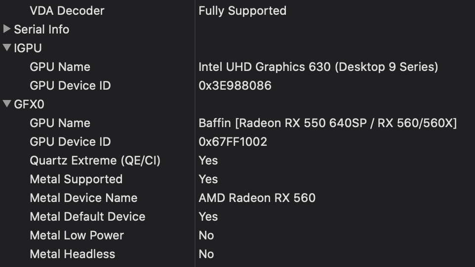

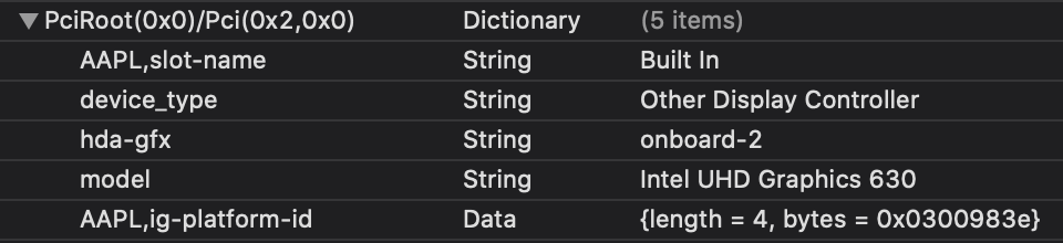

@headkaze what is this Metal Headless on the GFX0 section? is that mean if we set up correctly headless mode this value must turn YES? Cause I set up headless mode on OpenCore tried tree different ig-platform-id but this setting never turns as a YES.
BIOS settings;
IGPU enabled
Primary PEG
Multi-Monitor Enabled
I tried that ig-platform-id which are all recommended;
0x0300913e
0x0300923e
0x0300983e
Am I doing something wrong?
3 minutes ago, headkaze said:
If you set up headless for your IGPU then it won't show "Yes" under GFX0. So what you have there is expected.
I thought when we configured headless correctly this setting (Metal Headless) must be YES. Thanks to you I learned it. :thumbsup_anim:

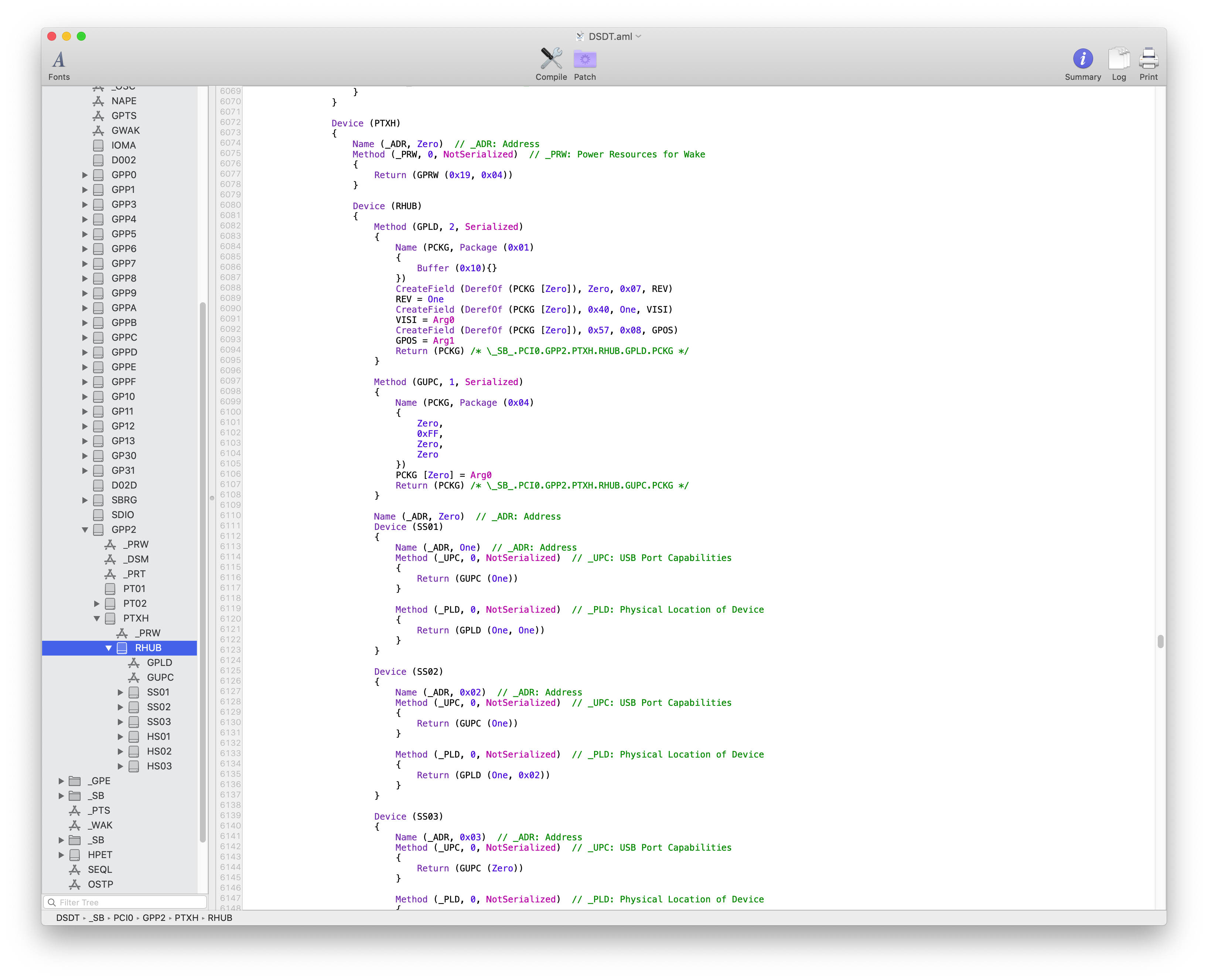

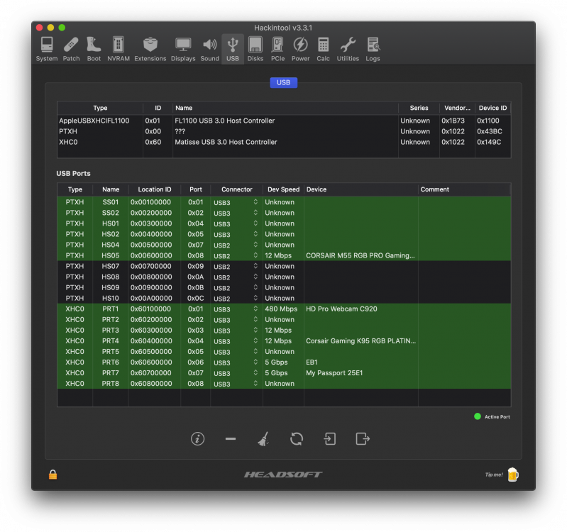

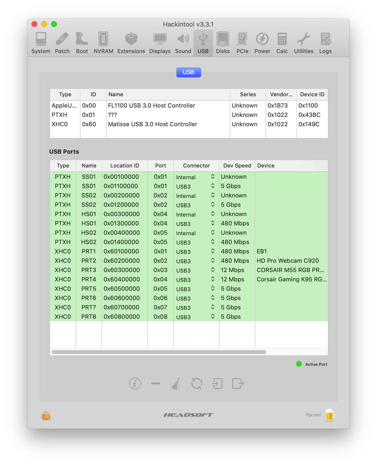

Trying to verify my USB ports on my Asrock A320M-HDV, can't find the USB 2.0 ports at all under macOS. Not the 2 on the back panel, nor the 2 headers on the motherboard ( means no working bluetooth). I can provide any files needed to help find the problem.
This is what Hackintool shows:
1142700929_ScreenShot2020-03-21at5_15_49PM.thumb.png.77af2d3be66423544f56e3e108da4d3c.png
Here's a screenshot of my DSDT
188418753_ScreenShot2020-03-21at5_14_31PM.thumb.png.5bdd69d360fc99e1ac6c837e402f7756.png
Do they show up in Registry Explorer?
No, but they work just fine in Windows. Can't seem to find them in the DSDT either.
This is what Windows sees:
USB xHCI Compliant Host Controller
    RootHub
        [Port1]NoDeviceConnected
        [Port2]NoDeviceConnected
        [Port3]NoDeviceConnected
        [Port4]DeviceConnected :  USB Mass Storage Device
        [Port5]DeviceConnected :  USB Mass Storage Device
        [Port6]NoDeviceConnected
        [Port7]DeviceConnected :  USB Mass Storage Device
        [Port8]DeviceConnected :  USB Mass Storage Device
        [Port9]NoDeviceConnected
        [Port10]NoDeviceConnected
        [Port11]NoDeviceConnected
        [Port12]DeviceConnected :  Intel(R) Wireless Bluetooth(R)
Ports 1 & 2 are front panel USB 3 ports
Ports 4 & 5 are the front panel USB 2 ports ( same physical ports as 1 & 2 )
Ports 7 & 8 are the rear panel USB 2 ports
Ports 9, 10, 11, & 12 are the MB USB 2.0 headers
And this is how it list the controller:
\\?\pci#ven_1022&dev_43bc&subsys_43d01849&rev_02#4&1efa78ed&0&000b#{3abf6f2d-71c4-462a-8a92-1e6861e6af27}
{36fc9e60-c465-11cf-8056-444553540000}\0017
The IO Registry list Ports 1, & 2 as SS01 & SS02
port 3 as SS03
ports 4 & 5 as HS01 and HS02
port 6 as HS303
 the rest of the ports are missing.
Ports 1,2,4, & 5 are the only ports that work under macOS.
I can add my dsdt and ioregisty file when I get back to my hack.
DSDT.aml.zip
Config copy.plist.zip
Usbinfo.zip
Darrell’s iMac Pro.zip
Edited by moozuki
Adding files

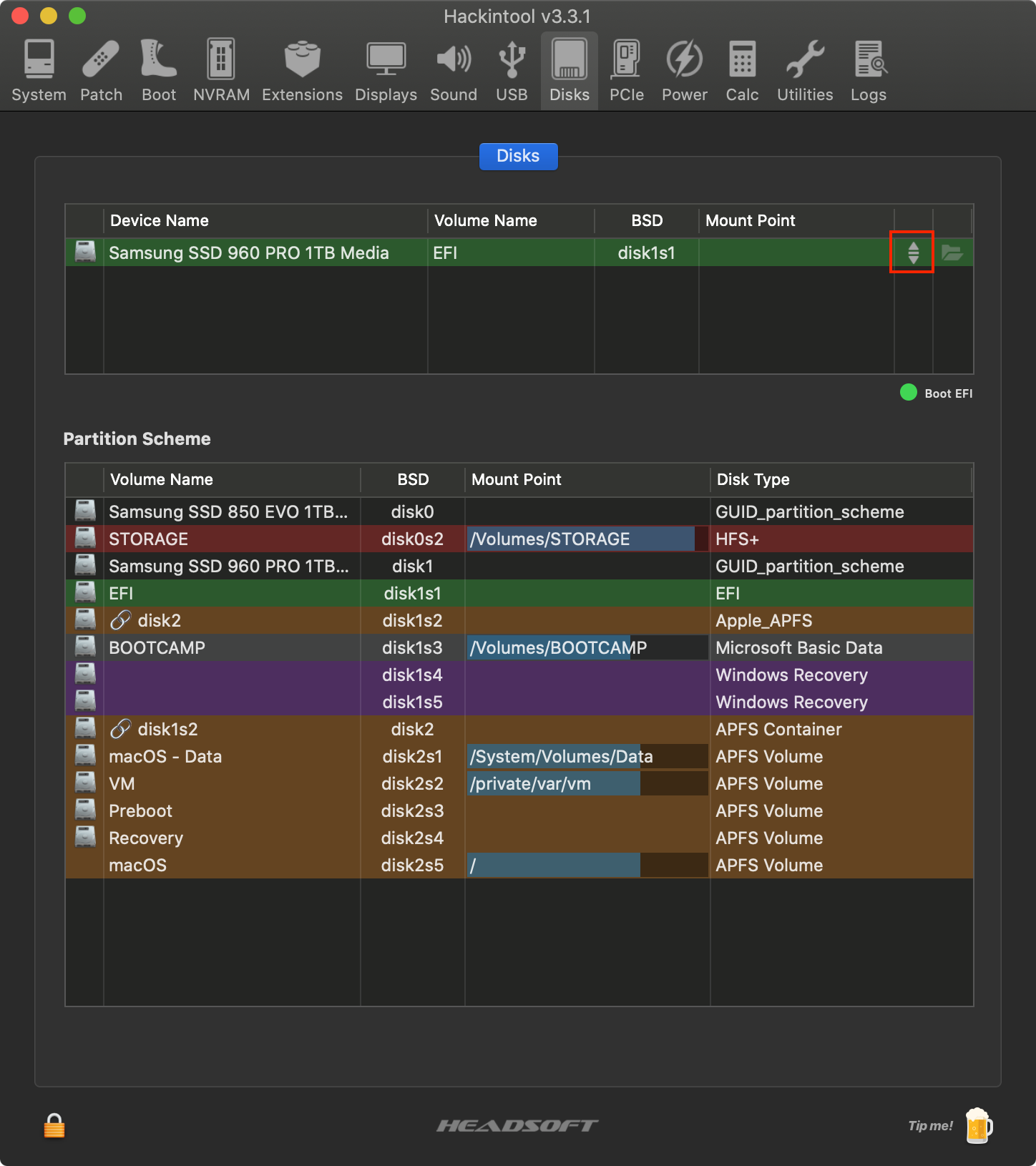

Can I kindly make a suggestion ... it's a great tool for all sort of work required to make a hackintosh work, and it would be a nice addition to have the possibility to mount the EFI partition, without having to go through the patch section ... like a standalone in the tool section.
And thanks for the work you put into making this tool work.
Edited by Septendre

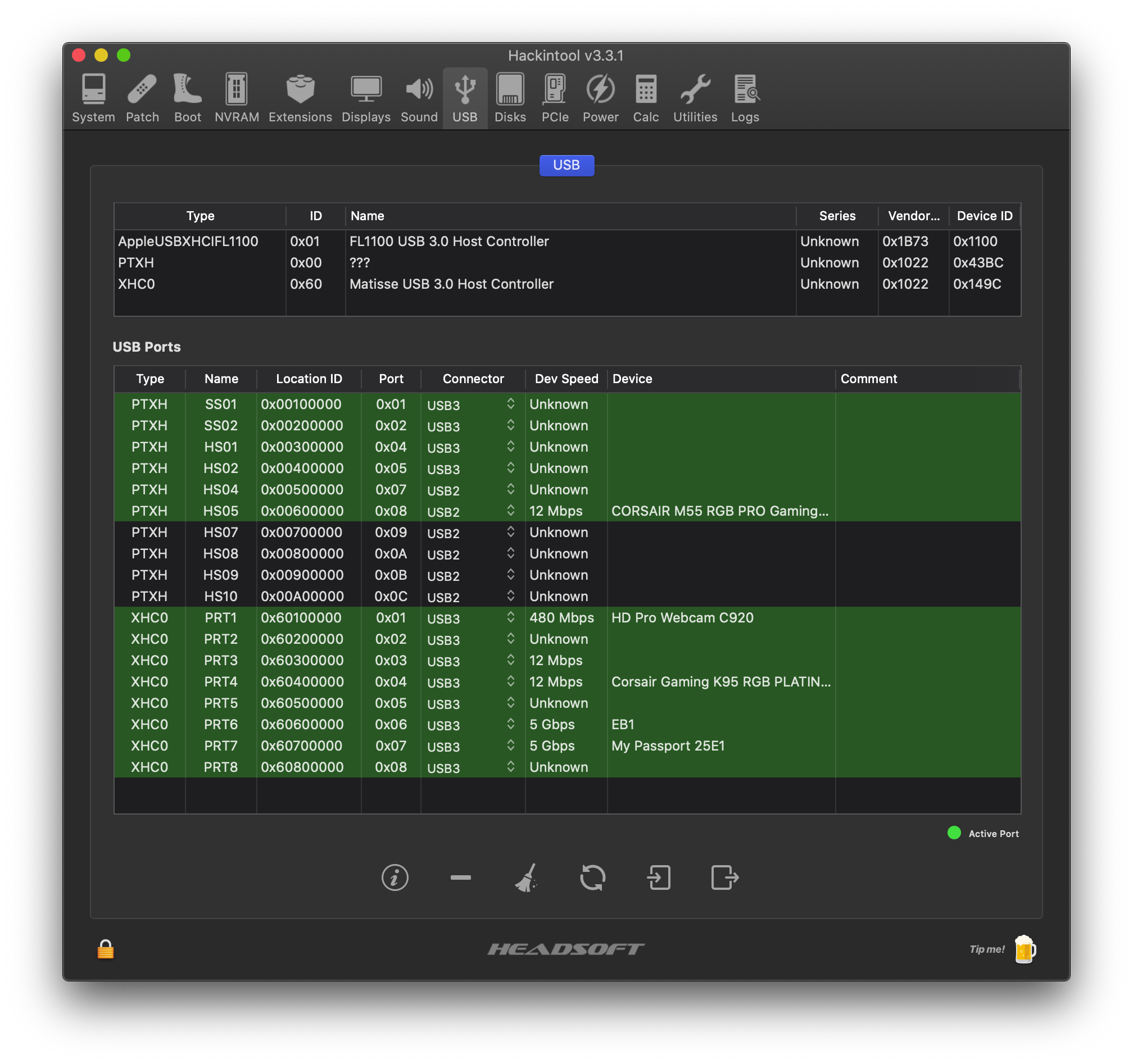

Hi everyone, any idea what Clover patches for USB Port Limits are needed for Catalina 10.15.4 update released yesterday? Are we still supposed to use the previous ones?
I can safely assume that new Catalina will continue working with current Hackintool and show all USB ports as expected.
Thanks!
