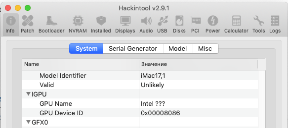

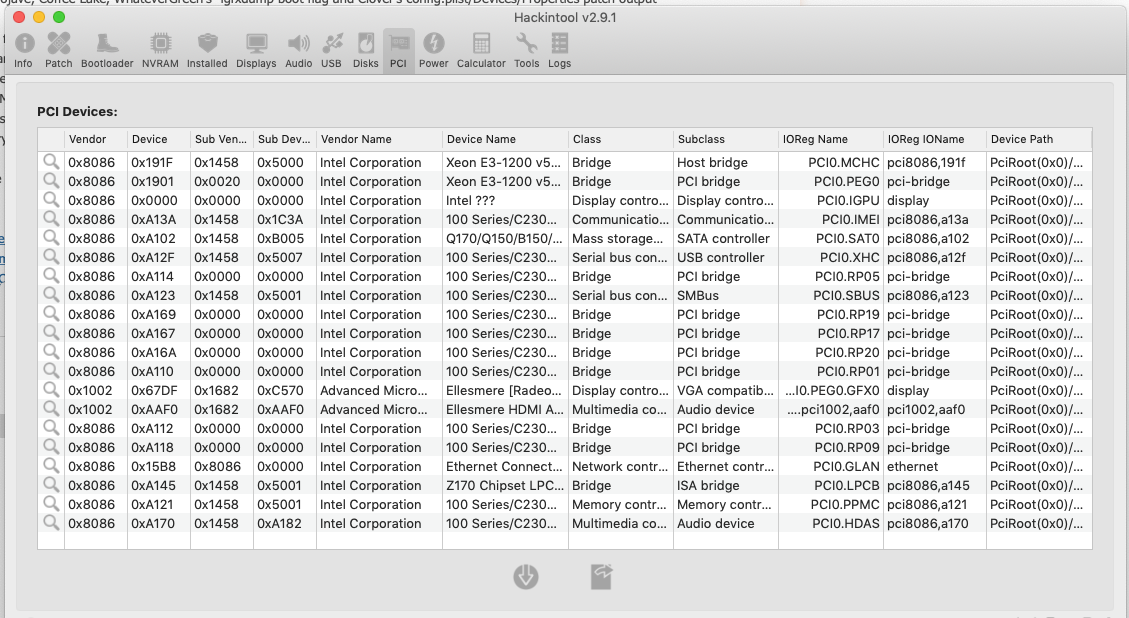

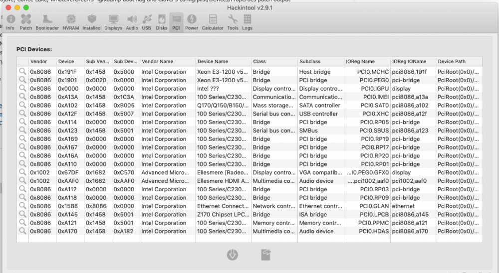

Slice Posted January 18, 2020 Share Posted January 18, 2020 Something is still wrong for #1 in signature. It is not Xeon E3.. it is i5-6400 and intel graphics IGPU is HD530. Link to comment https://www.insanelymac.com/forum/topic/335018-hackintool-v3xx/page/31/#findComment-2704797 Share on other sites More sharing options...
maclinuxG4 Posted January 18, 2020 Share Posted January 18, 2020 @slice plateform Id to change into 0x1912010 ... and many with be good (HF 530, plateform ID, etc..) excepted processor. Link to comment https://www.insanelymac.com/forum/topic/335018-hackintool-v3xx/page/31/#findComment-2704798 Share on other sites More sharing options...

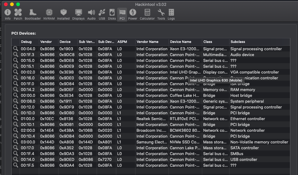

nik135 Posted January 24, 2020 Share Posted January 24, 2020 Thanks for developers, this is cool app! I have a feature request: Can you add a aspm option (column) for the Pci Devices table? ps. i try to achieve the same as Windows workin battery time on my hackintosh.... 1 Link to comment https://www.insanelymac.com/forum/topic/335018-hackintool-v3xx/page/31/#findComment-2705531 Share on other sites More sharing options...
headkaze Posted January 26, 2020 Author Share Posted January 26, 2020 (edited) On 1/24/2020 at 6:00 PM, nik135 said: Thanks for developers, this is cool app! I have a feature request: Can you add a aspm option (column) for the Pci Devices table? ps. i try to achieve the same as Windows workin battery time on my hackintosh.... Hi @nik135 I added an ASPM column. It displays the value of pci-aspm-default from the PCI IOReg entry. It would be nice to display a more friendly version than the hex value so I was doing some research and found these values: # Hex Binary Meaning # ------------------------- # 0 0b00 L0 only # 1 0b01 L0s only # 2 0b10 L1 only # 3 0b11 L1 and L0s On my laptop I'm seeing values of 0, 2 and 3 and sometimes bit 8 is set. I'm not entirely sure if the first two bits correspond to the table above. Bit 8 being set could be "exit latency" or something else I'm not sure. I could just show the values of the first two bits instead? I've also seen the following #define's which also corresponds to the chart above but I can't find anything that explains bit 8. #define PCIE_LINK_STATE_L0S 1 #define PCIE_LINK_STATE_L1 2 #define PCIE_LINK_STATE_CLKPM 4 EDIT: Hackintool has been updated to display a "text friendly" version of the ASPM state for each PCI device. Edited January 30, 2020 by headkaze 1 Link to comment https://www.insanelymac.com/forum/topic/335018-hackintool-v3xx/page/31/#findComment-2705794 Share on other sites More sharing options...

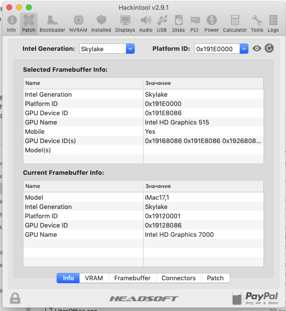

headkaze Posted January 30, 2020 Author Share Posted January 30, 2020 (edited) On 1/18/2020 at 2:09 PM, Slice said: Something is still wrong for #1 in signature. ... It is not Xeon E3.. it is i5-6400 and intel graphics IGPU is HD530. In your first image Info->System you have "Intel ???" and "GPU Device ID" of 0x00008086. This data is displayed by enumerating the IODisplay's on your system. The "GPU Device ID" value is the device-id and vendor-id of the parent IOPCIDevice (in this case IGPU). The device-id for your IGPU must be 0x0, missing or not in NSData format. Perhaps it's because you're running in headless mode (0x19120001)? Give Hackintool v2.9.7 a try and if it's still not working please attach your IORegistry so I can take a more in depth look at this issue. Edited January 30, 2020 by headkaze Link to comment https://www.insanelymac.com/forum/topic/335018-hackintool-v3xx/page/31/#findComment-2706350 Share on other sites More sharing options...
Slice Posted January 30, 2020 Share Posted January 30, 2020 3 hours ago, headkaze said: In your first image Info->System you have "Intel ???" and "GPU Device ID" of 0x00008086. This data is displayed by enumerating the IODisplay's on your system. The "GPU Device ID" value is the device-id and vendor-id of the parent IOPCIDevice (in this case IGPU). The device-id for your IGPU must be 0x0, missing or not in NSData format. Perhaps it's because you're running in headless mode (0x19120001)? Give Hackintool v2.9.7 a try and if it's still not working please attach your IORegistry so I can take a more in depth look at this issue. Yes, headless mode. iMac — Slice.ioreg.zip Link to comment https://www.insanelymac.com/forum/topic/335018-hackintool-v3xx/page/31/#findComment-2706364 Share on other sites More sharing options...
headkaze Posted January 30, 2020 Author Share Posted January 30, 2020 (edited) 7 hours ago, Slice said: Yes, headless mode. iMac — Slice.ioreg.zip The device-id for your IGPU was in NSData format but was only 2 bytes long (I was ignoring anything less than 4 bytes). Please try Hackintool v2.9.8. As for the PCI devices showing as "Xeon E3" it's only what's matched via PID/VID in the pci.ids database. You could always submit a correction for it. Edited January 30, 2020 by headkaze 1 Link to comment https://www.insanelymac.com/forum/topic/335018-hackintool-v3xx/page/31/#findComment-2706367 Share on other sites More sharing options...

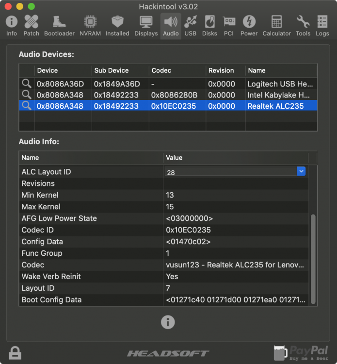

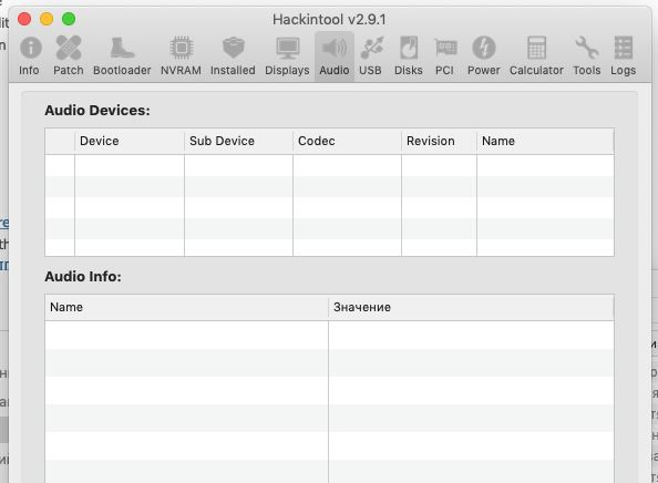

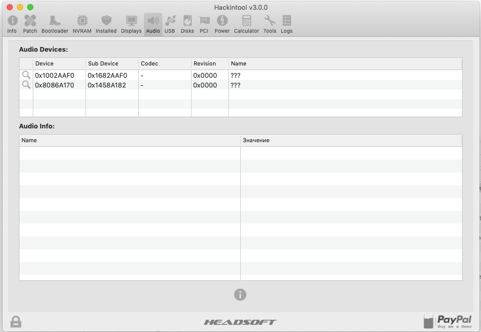

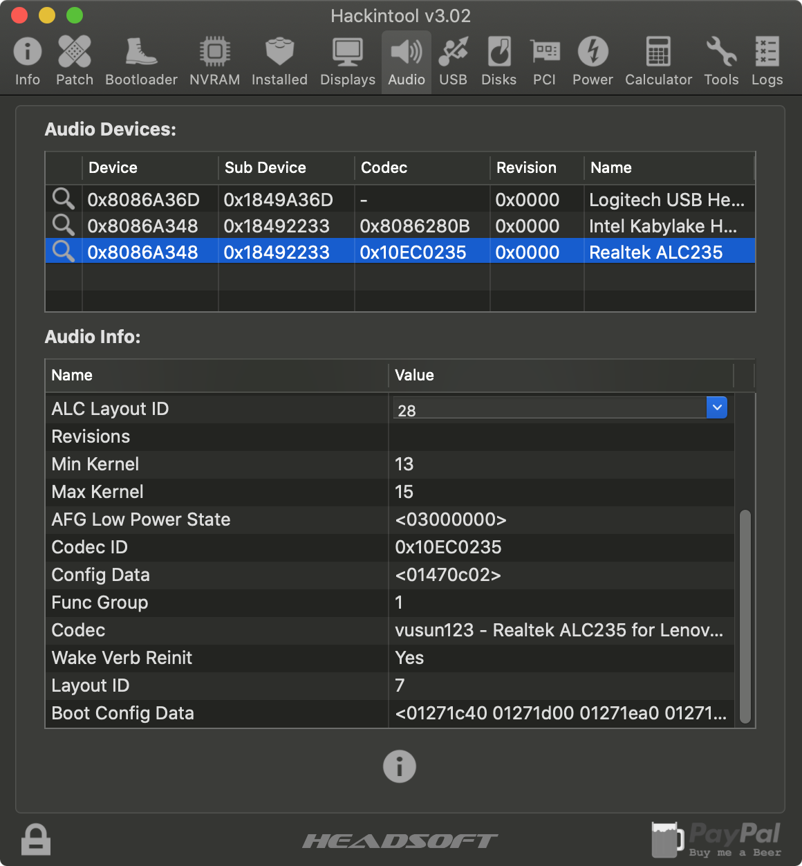

Slice Posted January 30, 2020 Share Posted January 30, 2020 Tested 2.9.9. It is much better now! Intel graphics all correct. Audio device information is still absent. Link to comment https://www.insanelymac.com/forum/topic/335018-hackintool-v3xx/page/31/#findComment-2706428 Share on other sites More sharing options...
headkaze Posted January 31, 2020 Author Share Posted January 31, 2020 9 hours ago, Slice said: Audio device information is still absent. Hackintool didn't display non-AppleALC compatible devices but I have re-worked it to show all audio devices. Can you please try 3.0.0? 1 1 Link to comment https://www.insanelymac.com/forum/topic/335018-hackintool-v3xx/page/31/#findComment-2706476 Share on other sites More sharing options...

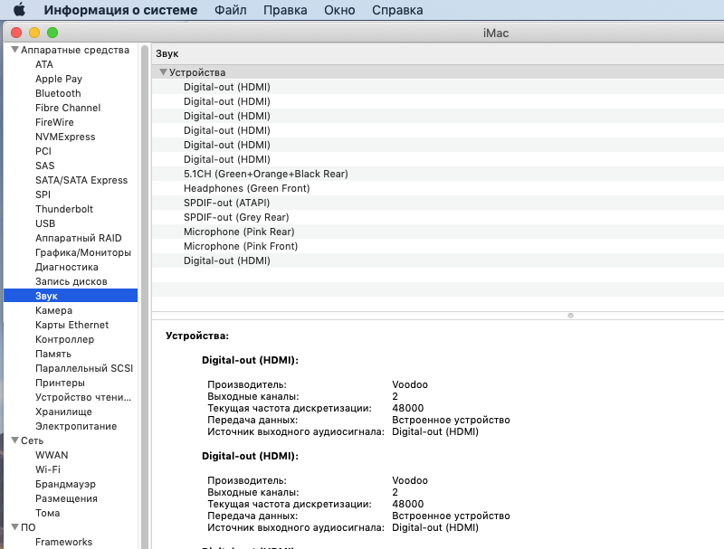

Slice Posted January 31, 2020 Share Posted January 31, 2020 24 minutes ago, headkaze said: Hackintool didn't display non-AppleALC compatible devices but I have re-worked it to show all audio devices. Can you please try 3.0.0? Better then nothing You can look in my ioreg for additional info. Anyway Apple sees my audio 1 Link to comment https://www.insanelymac.com/forum/topic/335018-hackintool-v3xx/page/31/#findComment-2706479 Share on other sites More sharing options...
headkaze Posted February 1, 2020 Author Share Posted February 1, 2020 (edited) 20 hours ago, Slice said: Anyway Apple sees my audio You'll need to select a device to populate the Audio Info section. Rather than replicate Apple's System Report I'm aiming to provide information that's more relevant to Hackintosh users. In a recent update I added additional info for AppleALC users (IOService:/.../HDEF/.../AppleHDACodecGeneric/HDAConfigDefault/0). I can add more info for VoodooHDA just let me know what info to add and the location in IORegistry. I also updated Pin Configurator so you can import the IOService:/.../HDAConfigDefault/0/BootConfigData dumped by AppleALC. It would be nice to be able to do this with VoodooHDA. Is there a location in IORegistry where the Pin Config data is stored? Edited February 1, 2020 by headkaze Link to comment https://www.insanelymac.com/forum/topic/335018-hackintool-v3xx/page/31/#findComment-2706596 Share on other sites More sharing options...

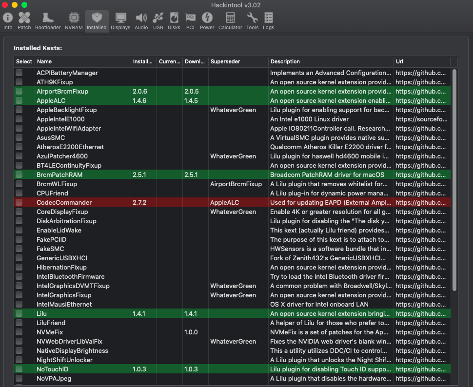

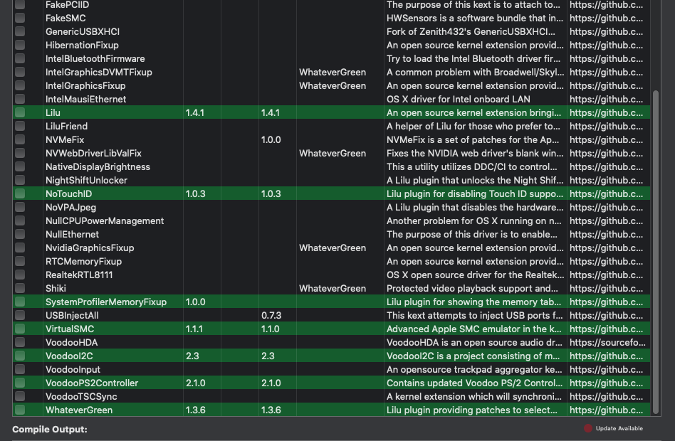

headkaze Posted February 1, 2020 Author Share Posted February 1, 2020 (edited) 10 minutes ago, mifjpn said: But i can not see the current kext version.(Hisierra,Mojave,Catalina) Yes, it's by design. You need to click the "Update Version Info" button now. Edited February 1, 2020 by headkaze Link to comment https://www.insanelymac.com/forum/topic/335018-hackintool-v3xx/page/31/#findComment-2706614 Share on other sites More sharing options...

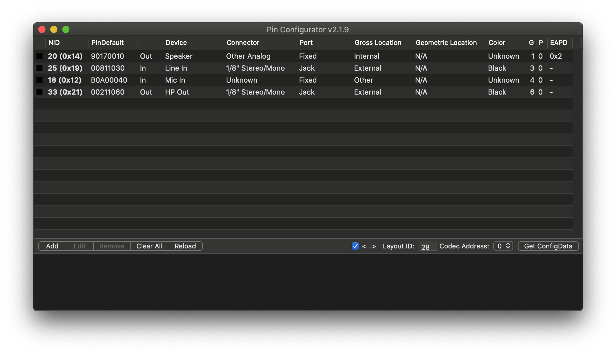

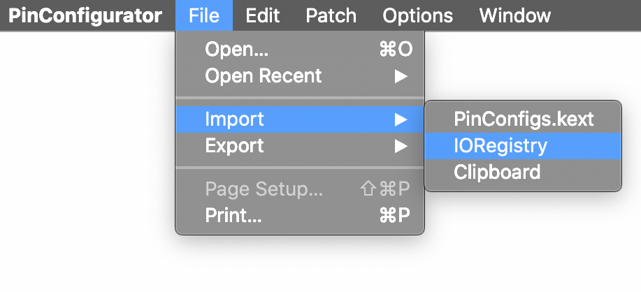

Pavo Posted February 1, 2020 Share Posted February 1, 2020 @headkaze Do you have a tutorial to Pin Configurator? Link to comment https://www.insanelymac.com/forum/topic/335018-hackintool-v3xx/page/31/#findComment-2706665 Share on other sites More sharing options...
headkaze Posted February 1, 2020 Author Share Posted February 1, 2020 6 minutes ago, Pavo said: @headkaze Do you have a tutorial to Pin Configurator? Reading through the AppleALC — dynamic AppleHDA patching would probably get you up to speed and you can always ask any questions there. 1 Link to comment https://www.insanelymac.com/forum/topic/335018-hackintool-v3xx/page/31/#findComment-2706666 Share on other sites More sharing options...
