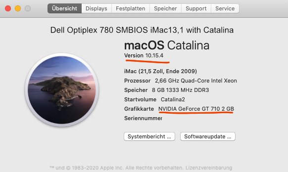

Here Catalina 10.15.4 including sound works very well with the GT710.
SMBIOS iMac10,1 is broken, raise to iMac13,1 for Catalina !!!
Mojave still works great with SMBIOS iMac10.1.

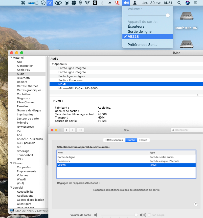

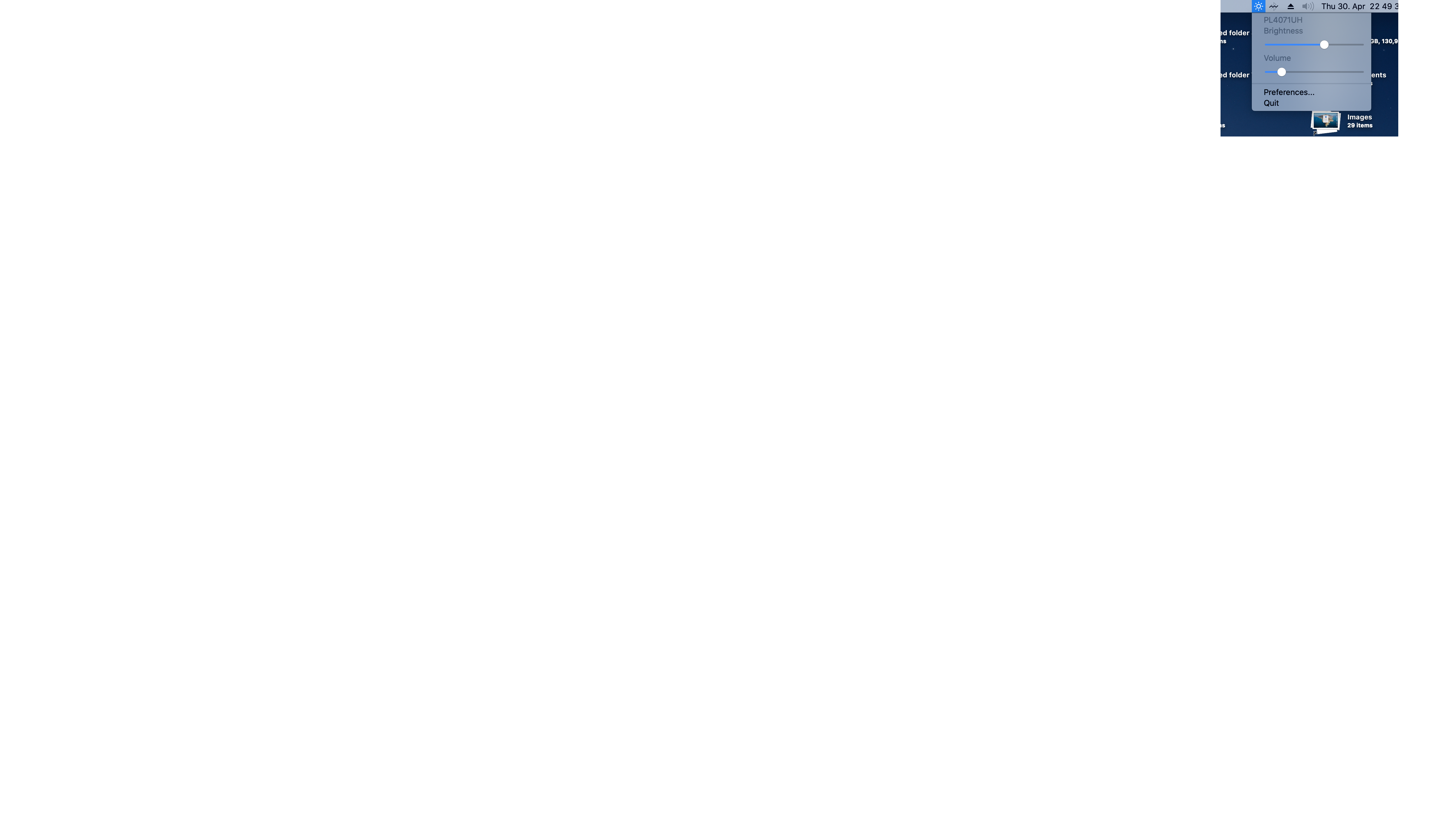

FIX HDMI Dell Optiplex 790  GeForce GT 710 macOS Catalina 10.15.4 / macOS Mojave 10.14.6
Using Lilu.kext and AppleALC.kext + DSDT.aml
Put WhateverGreen.kext in 10.15 folder of Clover kexts :w00t::thumbsup_anim:
2004664154_Capturedcranle2020-04-3014_51_15.thumb.png.49b92e28c8f2a051c269606199892e0e.png
You can control the volume by installing this app
https://github.com/the0neyouseek/MonitorControl/releases/tag/v2.0.0
Enjoy!!! 2226636975.gif.0f02f03eef72aceab1e69cde69858c74.gif 2464933482-2.gif.df98a2165e16f236363c6f82ce4ab705.gif
Edited by chris1111
Also working macOS Mojave 10.14.6

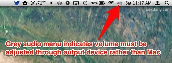

1 minute ago, Rocky12 said:
Sorry of topic

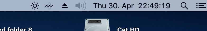

@ Chris1111    hi got it too HDMI Audio finally working on GTX 670 the sound icon is still blur386977226_Screenshot2020-04-30at22_49_19.png.a0c913fe7cf96518aa96689de12f4e64.png
 Its normal the Audio HDMI sounds is grey out , that's why you need using Monitor control :D
Okay so you mean that it is something related to colours and nothing else
Okay my friend thanks for your help enjoy HDMI all the best :thumbsup_anim:
Edited by Rocky12
Just now, Rocky12 said:
Okay so you mean that it is something related to colors and nothing else
Why is the Sound Menu Icon Grey?You will notice that after an HDMI sound output source (and many other output options) has been selected, the Sound menu icon turns grey:
This does not mean that exporting sound is not working, it simply means that sound volume must be controlled through the hardware the Mac is now outputting to through HDMI, which is typically a TV or presentation shooter, as the internal volume adjustment sliders and keyboard buttons will no longer work.

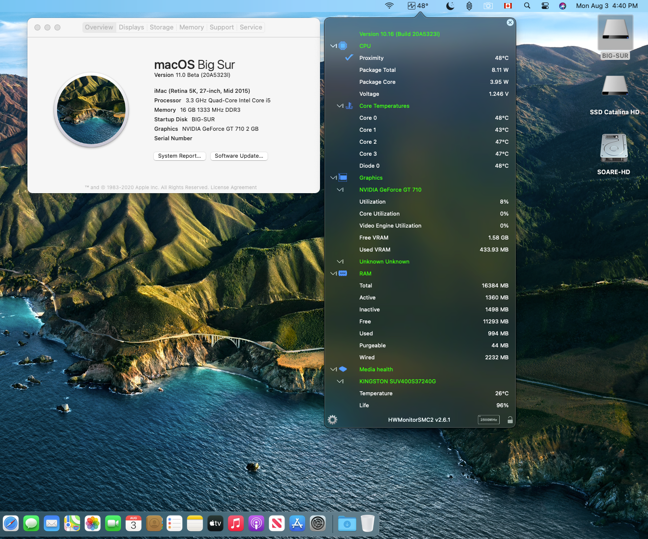

Big Sur B3 run on my Optiplex 790 with OpenCore + GeForce GT 710 :wink_anim:
the system has been installed for more than a week already
Everything is perfect and boot twice as fast as Clover with OpenCore
842167055_ScreenShot2020-08-03at4_40_13PM.thumb.png.9e65bd0c594ba6539244cfc06c20cf9b.png

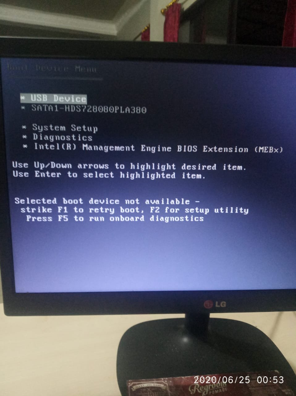

I don't know if I'm asking in the wrong place or what... but if ANYONE would be kind enough to respond... I went ahead and tried to do a clean install (after backing up my system). I get through the first install sequence from the Install stick, then I select Install MacOS from [system SSD] after the first reboot. Installation goes well, but after it finishes and I reboot again, I can't see the system SSD. Only the Install USB. I've done this 3 times today. Can I PLEASE get some guidance on what I might do? I've removed the drive and hooked it up to another machine, and I can see all of the system files. I even tried installing Clover directly to the system SSD, and removed the install USB... but when I did, there was NO boot option. Frustrated as all get out. Can anyone offer some advice? Please?
