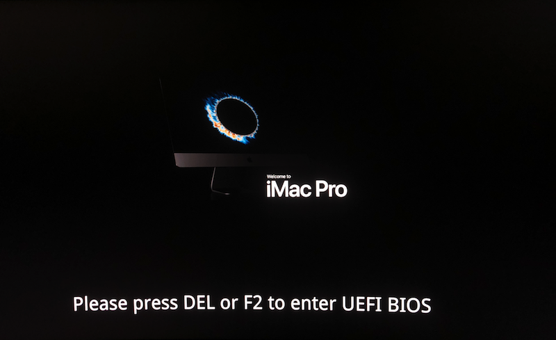

Based on the ideas and instructions of @Matthew82, I achieved an iMacPro ASUS BIOS Boot Splash Screen implementation, which hopefully will further motivate you in patching your ASUS BIOS Firmware.
New Section E.11) contains all necessary details.
Note that the new iMac Pro Splash Screen Image is already part of the patched 1102 ASUS Prime X299 Deluxe Firmware X299D.CAP, newly implemented in the guide in the originating post of this thread. I once more attach this patched BIOS also here below.
Please note that for the new iMacPro ASUS Boot Splash Screen patch approach, it is mandatory to set BIOS setting "Boot Logo Display" to "AUTO"
Enjoy and have fun!

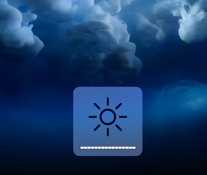

1.) Native Display Brightness Control
Many of you might miss the ability to control the display brightness with the F1/F2 keys on original Apple Keyboards, or with FN&F1/FN&F2 on non-Apple keyboards.
@bensge wrote a small but genius application to do just that on any Hackintosh System and to show the native OSX brightness system UI.

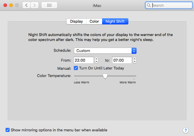

2.) Native NightShift Functionality for Monitors with DDC/IC Support
Native NightShift works so far for the 38" LG 38UC99. NightShift should also work for the Acer 38" and Dell 38" Monitors. Yet @Ramalama misses the respective EDIDs. Any body with e.g. the Acer XR382CQK should immediately upload the requested information and contact @Ramalama by respective postings! Many thanks in advance!
Many thanks to user @Ramalama for providing both Native Display Brightness Control and Native NightShift Functionality for Monitors with DDC/IC Support also to our community and this thread.

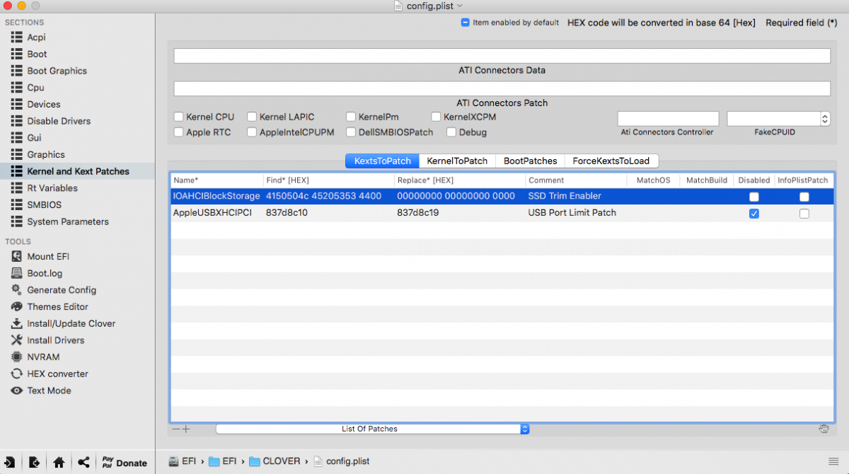

New patch for usb limit in 10.13.4
  • AppleUSBXHCI - 837d940f 0f839704 0000 > 837d941e 90909090 9090

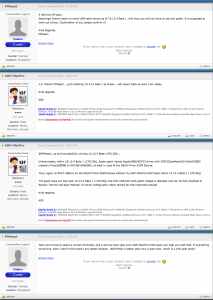

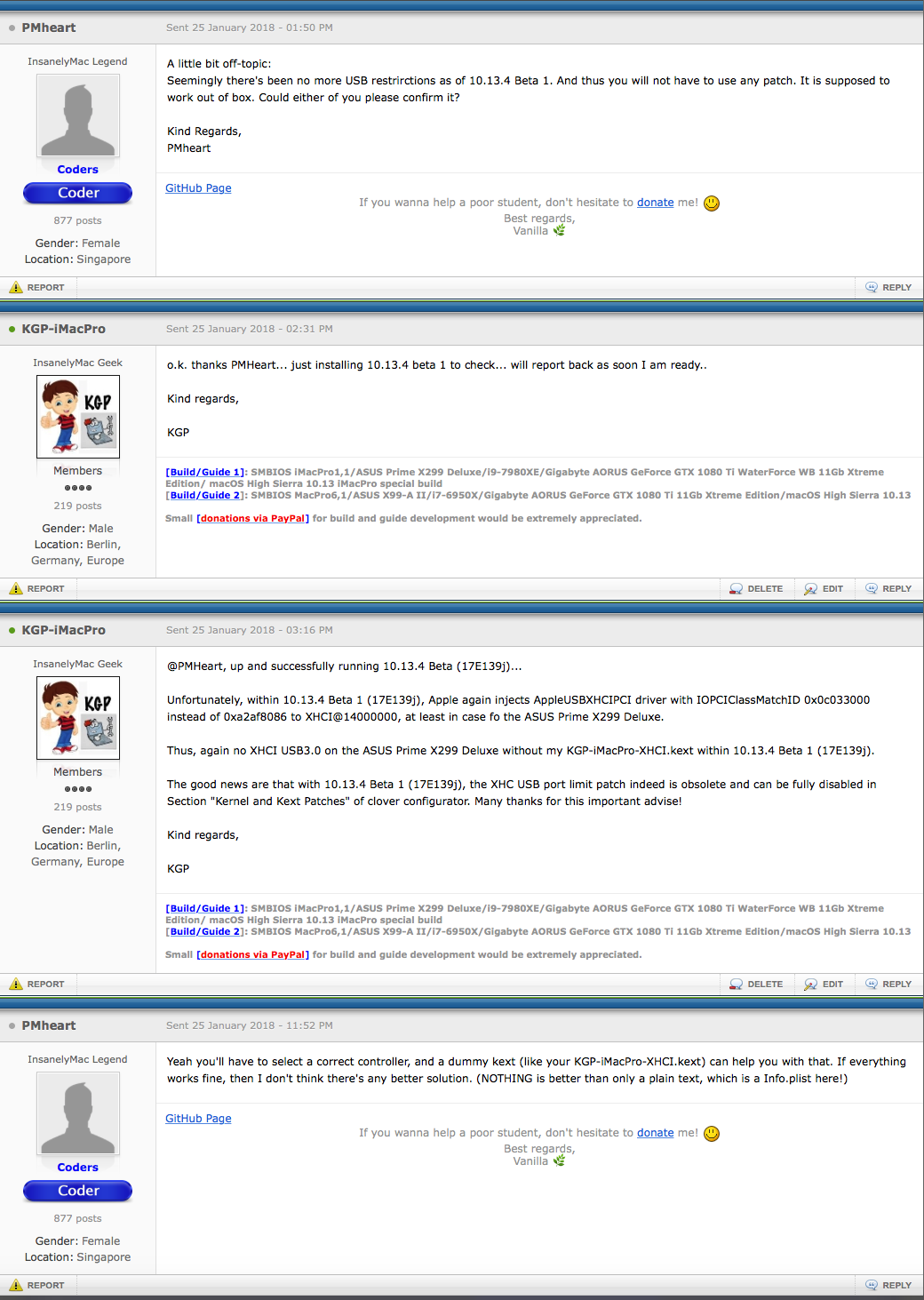

Thanks Matthew! But can we clarify one thing? Following @PMHeart, the port limit patch should be obsolete on Skylake-X/X299 systems under 10.13.4 Beta 1. I was able to confirm this guess on my system. Do you really need the port limit patch under 10.13.4 Beta 1 on your Skylake-X/X299 system?
Appreciate your feedback..

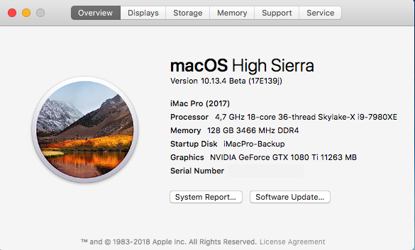

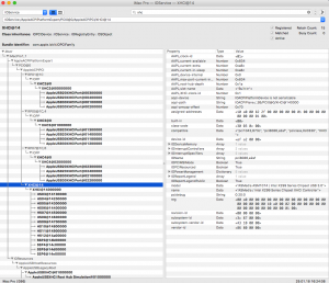

It was within some PM... I guess it is fine with @PMHeart if I make the corresponding part of the PM public... (see figure below)..
and indeed XHC USB for me works without any XHC USB port limiting patch under 10.13.4 Beta 1...

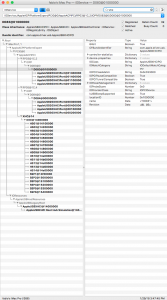

Could you also post a pictures like this I attached here?
it is not x299 related because now I have not my x299 near to me but I would like to know if 15 port limit is in your IOREG
also this one are all Deluxe Prime USB port If I don't mind

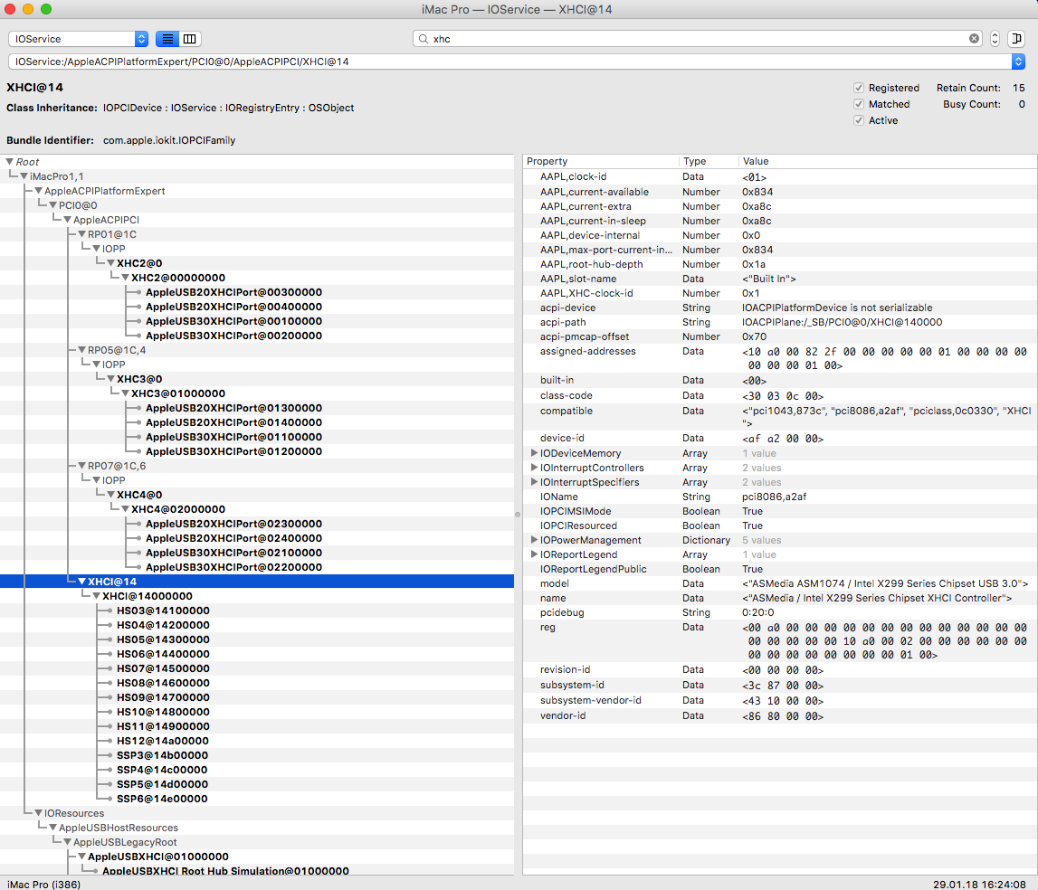

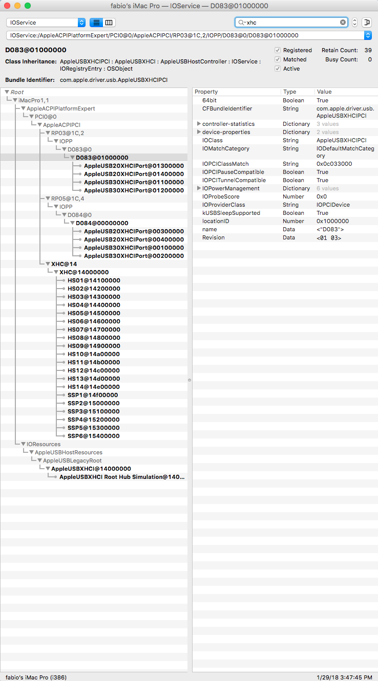

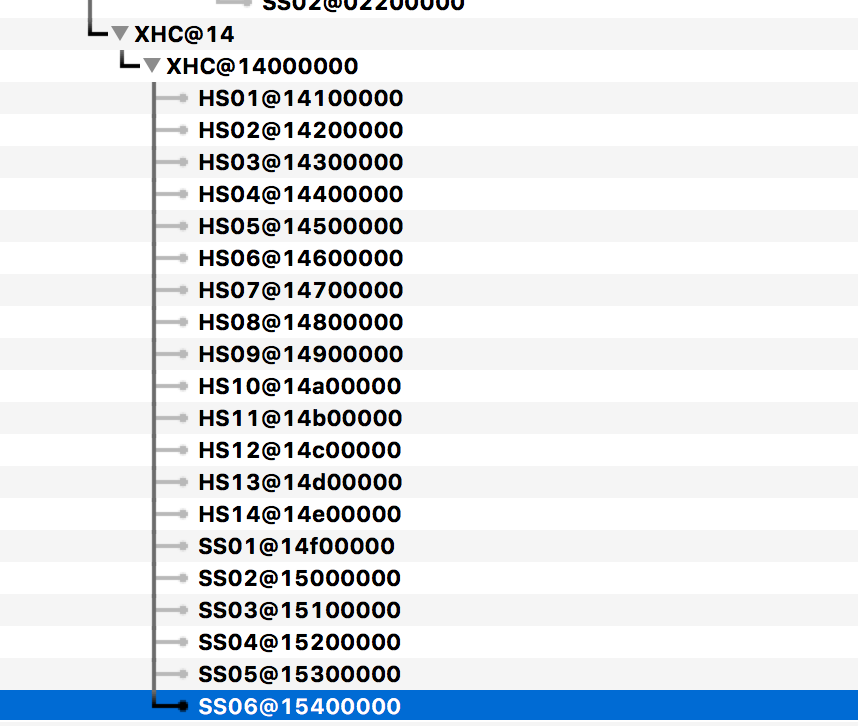

Your are welcome, man! See images below:
BTW.. I just realised once more that my XHC kext does anyway not use more than 10 HS ports and 4 SS ports.
This might be also the explanation why I do not need the XHC port limit patch..
I cannot try to skip the port limit patch without my kext because apparently the kext is required during betas, as OSX injects without my kext the wrong AppleUSBXHCISPT driver for my Asus Prime X299 Deluxe onboard XHC controller. In all final releases, the correct driver is injected and I do not need the kext..

attachicon.gifZrzut ekranu 2018-01-29 o 16.38.14.pngThis is with patch. 5 more ports.
Because you use XHC1  ;) ..With XHCI, the port implementation looks different...
I was creating my kext within the USB Emergency Configuration.. No need for HS 1and 2 and SS 1 and 2 with XHCI
Anyway, I guess it is not wrong if you claim that the XHC USB port limit patch is still needed but it might depend on the XHC implementation..  I cannot confirm the latter with my Asus Prime X299 Deluxe in macOS betas... I have to use my kext, which enables all XHC USB ports without the need of any port limit patch.
Do you understand what I mean?
In any case, if the port limit patch is still needed with some XHC configurations under 10.13.4, @PMHearts initial guess seems not to be confirmed by your observations. Which is totally fine with me..
