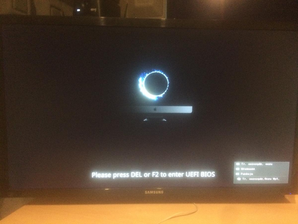

Matthew82 Posted January 24, 2018 Share Posted January 24, 2018 I added iMacPro boot logo to Asus bios X299D.CAP 2 Link to comment https://www.insanelymac.com/forum/topic/331658-how-to-build-your-own-imac-pro-successful-buildextended-guide/page/4/#findComment-2575855 Share on other sites More sharing options...
kgp Posted January 24, 2018 Author Share Posted January 24, 2018 I added iMacPro boot logo to Asus bios X299D.CAP IMG_0449.jpg Gorgeous man! Could you explain how you did it, thus I could implement that outstanding feature in my guide? It is indeed a very nice add-on, which I would love to share with the community. Very nice job! Link to comment https://www.insanelymac.com/forum/topic/331658-how-to-build-your-own-imac-pro-successful-buildextended-guide/page/4/#findComment-2575888 Share on other sites More sharing options...
Matthew82 Posted January 24, 2018 Share Posted January 24, 2018 is it animated? or just a still? still Link to comment https://www.insanelymac.com/forum/topic/331658-how-to-build-your-own-imac-pro-successful-buildextended-guide/page/4/#findComment-2575891 Share on other sites More sharing options...
Matthew82 Posted January 24, 2018 Share Posted January 24, 2018 Download UEFITool. Load your bios. The logo is stored in 7BB28B99-61BB-11D5-9A5D-0090273FC14D module. Replace it with your picture. 2 Link to comment https://www.insanelymac.com/forum/topic/331658-how-to-build-your-own-imac-pro-successful-buildextended-guide/page/4/#findComment-2575909 Share on other sites More sharing options...
Matthew82 Posted January 24, 2018 Share Posted January 24, 2018 Long time ago I found tutorial on some asus forum. Link to comment https://www.insanelymac.com/forum/topic/331658-how-to-build-your-own-imac-pro-successful-buildextended-guide/page/4/#findComment-2576002 Share on other sites More sharing options...

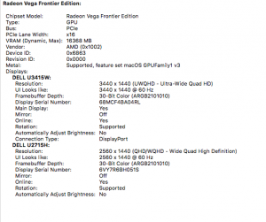

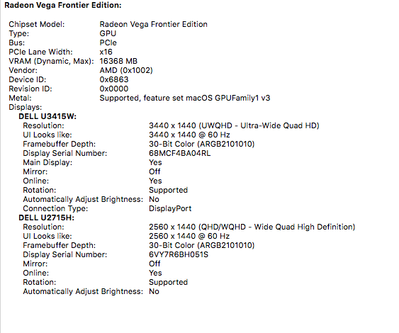

surfinchina Posted January 25, 2018 Share Posted January 25, 2018 Moving right along... 10.13.4 The USB seems to be working on all ports at full speed without any patches. Haven't tested speed. The Vega is recognised in 'about this mac' without patches or kexts. DPs 2 thru 4 are gone. I'm only getting HDMI and DP port one now on the Vega FE. GPU and CPU benches seem about the same but my SSD is indexing after the upgrade so it's hard to be exact with this. Link to comment https://www.insanelymac.com/forum/topic/331658-how-to-build-your-own-imac-pro-successful-buildextended-guide/page/4/#findComment-2576183 Share on other sites More sharing options...
surfinchina Posted January 25, 2018 Share Posted January 25, 2018 interesting, the card is properly recognized. but the ports are broken? can you send an ioreg? I always hate it when the file is 11mb, too big to attach lol. Here you go with a dropbox link: ioreg Link to comment https://www.insanelymac.com/forum/topic/331658-how-to-build-your-own-imac-pro-successful-buildextended-guide/page/4/#findComment-2576209 Share on other sites More sharing options...
surfinchina Posted January 25, 2018 Share Posted January 25, 2018 Hmm im going to do more inspection tomorrow, care to send me the AMDRadeonX5000GLDriver as well a screenshot of the system profiler for GFX. Also side note. how come no DSDT renames, or an ssdt? I've never really run DSDT renames or SSDT My ACPI is empty. The systems been pretty good without them. Possibly the Gigabyte, 7900 and vega is a sweet spot for 10.13. I see there's a new metal kext for vega you want that as well? Too big for this post... This is the metal kext AMDRadeonX5000GLDriver.bundle.zip AMDRadeonX5000MTLDriver.bundle.zip Link to comment https://www.insanelymac.com/forum/topic/331658-how-to-build-your-own-imac-pro-successful-buildextended-guide/page/4/#findComment-2576218 Share on other sites More sharing options...

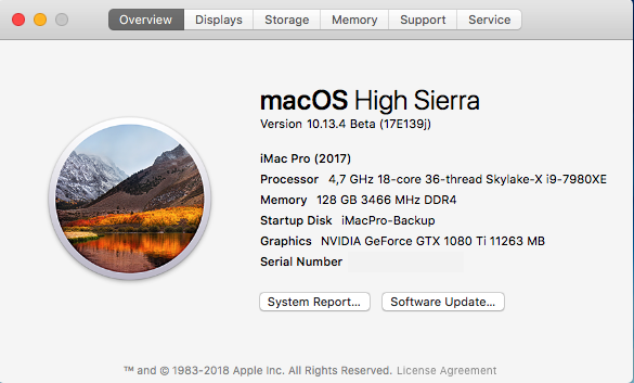

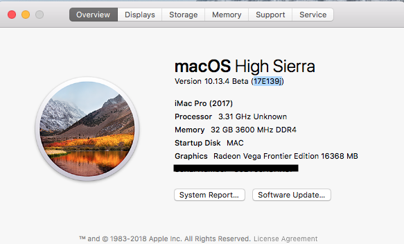

kgp Posted January 25, 2018 Author Share Posted January 25, 2018 Up and successfully running 10.13.4 Beta 1 (17E139j)... Unfortunately, within 10.13.4 Beta 1 (17E139j), Apple again injects AppleUSBXHCIPCI driver with IOPCIClassMatchID 0x0c033000 instead of 0xa2af8086 to XHCI@14000000, at least in case of the ASUS Prime X299 Deluxe.. Thus, again no XHCI USB3.0 on the ASUS Prime X299 Deluxe without my KGP-iMacPro-XHCI.kext (attached below) within 10.13.4 Beta 1 (17E139j). The good news are that within 10.13.4 Beta 1 (17E139j), the XHC USB port limit patch becomes obsolete as Apple apparently removed the XHC USB port limit restriction. Thus, this KextToPatch entry can be fully disabled in Section "Kernel and Kext Patches" of Clover Configurator when using 10.13.4 Beta 1 (17E139j). Many thanks for the important advise of @PMHeart! Enjoy and have fun, KGP KGP-iMacPro-XHCI.kext.zip Link to comment https://www.insanelymac.com/forum/topic/331658-how-to-build-your-own-imac-pro-successful-buildextended-guide/page/4/#findComment-2576488 Share on other sites More sharing options...

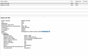

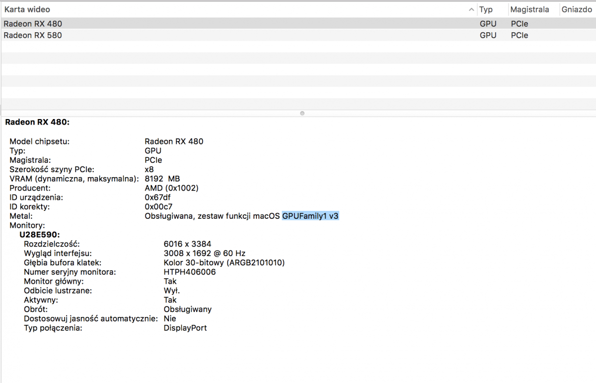

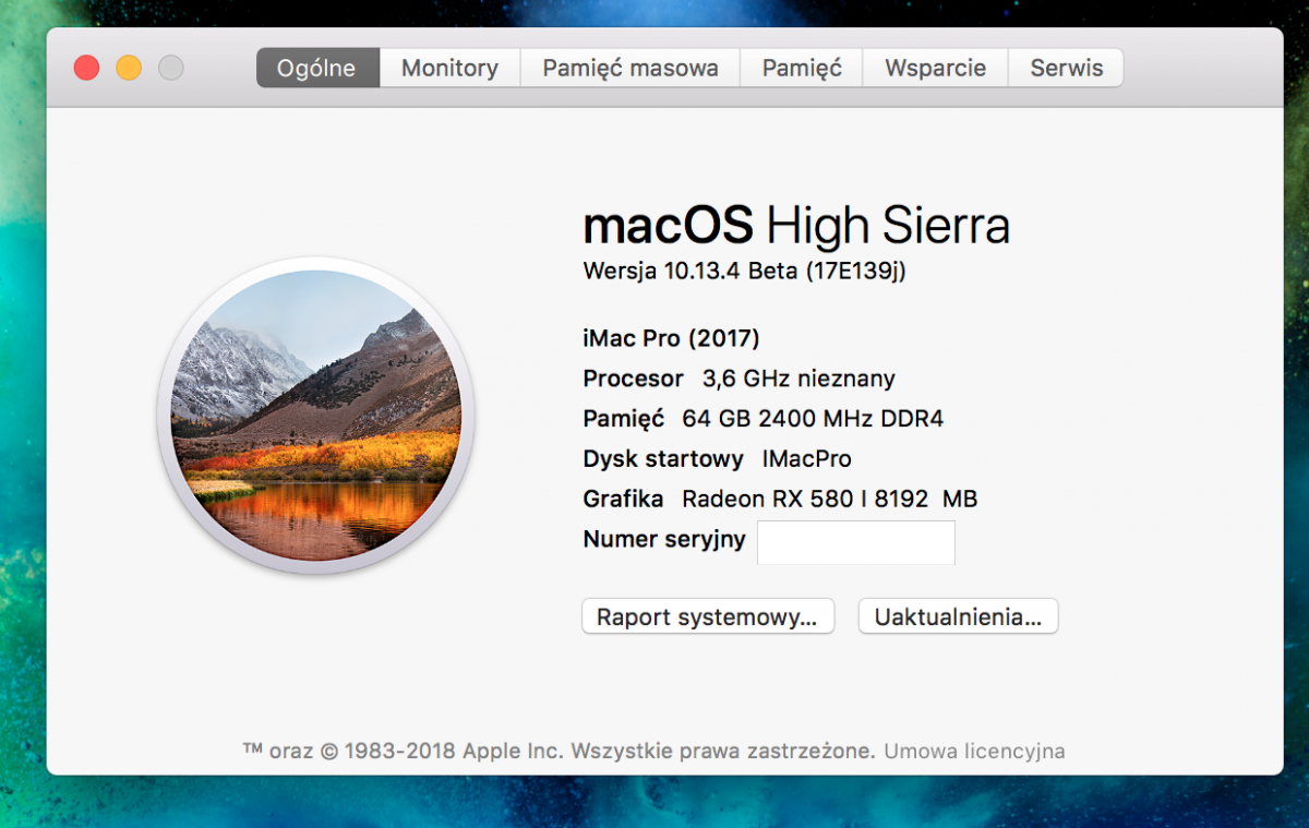

Matthew82 Posted January 25, 2018 Share Posted January 25, 2018 Good news about 10.13.4 benefits. 1. Sleep working native. No need ssdt or any patch. 2. After many years apple fix radeon initialization and wake function. No more need RadeonDelnit in Cover or ssdt inject. 3. GPU Famili1 v3 for metal in RX GPU One sed thing - Port limits patch is not working anymore First time my acpi patch folder look like it should Link to comment https://www.insanelymac.com/forum/topic/331658-how-to-build-your-own-imac-pro-successful-buildextended-guide/page/4/#findComment-2576542 Share on other sites More sharing options...

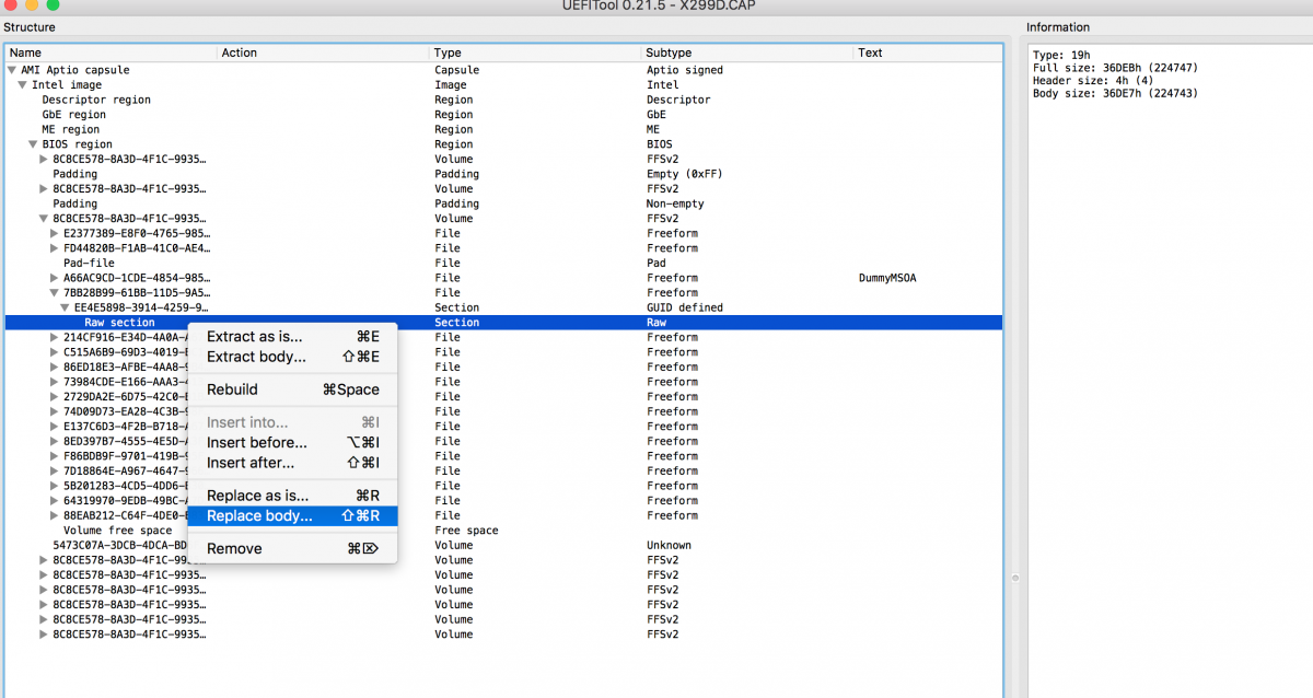

kgp Posted January 26, 2018 Author Share Posted January 26, 2018 Download UEFITool. Load your bios. The logo is stored in 7BB28B99-61BB-11D5-9A5D-0090273FC14D module. Replace it with your picture. Zrzut ekranu 2018-01-24 o 21.01.58.png @Matthew82, if I properly understand I should replace "Raw section" with the picture, correct? Now "Replace Body" suggests *.raw, *.bin files... In which format the image must be to properly replace the original ASUS RAW Section? Do I need a raw image or jpg or bmp? To save the modified CAP file, just "Save File as.." or any other action before? Link to comment https://www.insanelymac.com/forum/topic/331658-how-to-build-your-own-imac-pro-successful-buildextended-guide/page/4/#findComment-2577047 Share on other sites More sharing options...
Matthew82 Posted January 26, 2018 Share Posted January 26, 2018 Like on picture. JPG is OK Replace body. Remember that picture size should be the same as original Asus logo and have black background. Here is bios with mer unlock and iMacPro logo https://drive.google.com/file/d/156MYbAxh_Cl9rMEhaXTLjYBZs2gwhzhH/view?usp=sharing 1 Link to comment https://www.insanelymac.com/forum/topic/331658-how-to-build-your-own-imac-pro-successful-buildextended-guide/page/4/#findComment-2577076 Share on other sites More sharing options...
kgp Posted January 26, 2018 Author Share Posted January 26, 2018 Like on picture. JPG is OK Replace body. Remember that picture size should be the same as original Asus logo and have black background. Here is bios with mer unlock and iMacPro logo https://drive.google.com/file/d/156MYbAxh_Cl9rMEhaXTLjYBZs2gwhzhH/view?usp=sharing o.k. great! However, I would like to try the procedure myself and likely implement it in the guide with your credits.. What is the size of the original ASUS logo pixels per pixels or do you mean the file size? Could you just attach the iMacPro Splash Screen Logo you used? Link to comment https://www.insanelymac.com/forum/topic/331658-how-to-build-your-own-imac-pro-successful-buildextended-guide/page/4/#findComment-2577080 Share on other sites More sharing options...
Matthew82 Posted January 26, 2018 Share Posted January 26, 2018 I don't have it anymore. It should be the same but don't must! If it will be in bigger size and when you enabled full screen logo in bios it will be invisible. To check the size extract original raw body. Link to comment https://www.insanelymac.com/forum/topic/331658-how-to-build-your-own-imac-pro-successful-buildextended-guide/page/4/#findComment-2577086 Share on other sites More sharing options...
kgp Posted January 26, 2018 Author Share Posted January 26, 2018 I don't have it anymore. It should be the same but don't must! If it will be in bigger size and when you enabled full screen logo in bios it will be invisible. To check the size extract original raw body. When I try to save the modified CAP file, I always get the Error "Invalid UEFI Volume"... Link to comment https://www.insanelymac.com/forum/topic/331658-how-to-build-your-own-imac-pro-successful-buildextended-guide/page/4/#findComment-2577109 Share on other sites More sharing options...
Matthew82 Posted January 26, 2018 Share Posted January 26, 2018 https://www.bios-mods.com/forum/Thread-AMI-Aptio-Splash-screen-changing-guide Link to comment https://www.insanelymac.com/forum/topic/331658-how-to-build-your-own-imac-pro-successful-buildextended-guide/page/4/#findComment-2577110 Share on other sites More sharing options...
kgp Posted January 26, 2018 Author Share Posted January 26, 2018 https://www.bios-mods.com/forum/Thread-AMI-Aptio-Splash-screen-changing-guide Extracted raw image, replaced content of image and saved it as bmp, renamed it again to raw, replaced body and saved the cap file. Image file size before 762108, image file size after 762106.. Independent of using bmp, jpg or renaming bmp to raw, the Splash Screen remains black. Else, the approach seems to work now. I can save the modified CAP without problems.. Link to comment https://www.insanelymac.com/forum/topic/331658-how-to-build-your-own-imac-pro-successful-buildextended-guide/page/4/#findComment-2577155 Share on other sites More sharing options...
