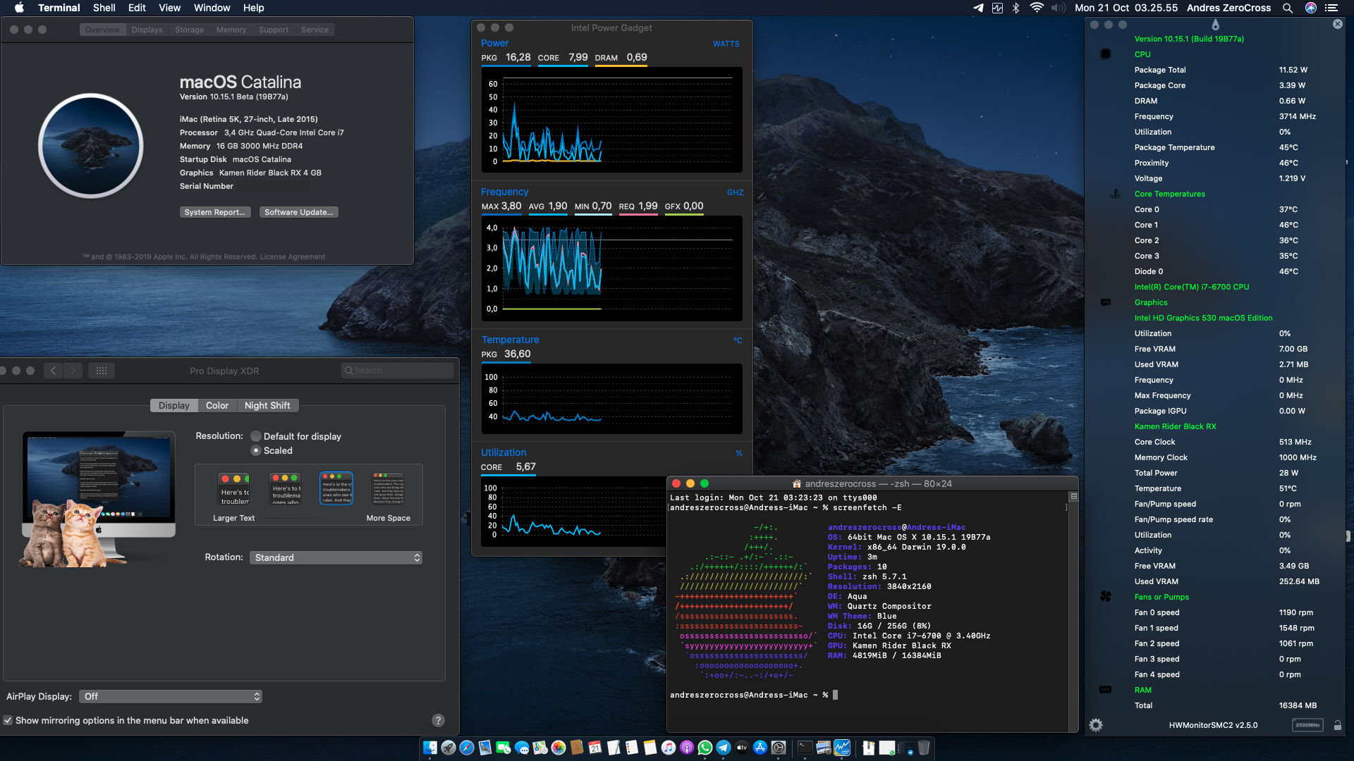

On 10/15/2019 at 2:23 PM, Andres ZeroCross said:
You can first try remove Whatevergreen.kext,, just use FakePCIID.kext+ FakePCIIDintelHDGrahics.kext from rehabman. Then set fakeID GPU to 0x014128086.
Let's see about your min freq of GPU. If it still same, then the problem is commonly from the macOS, not about WEG
Unfortunately no change, iGPU still running at .55 with FakePCI.

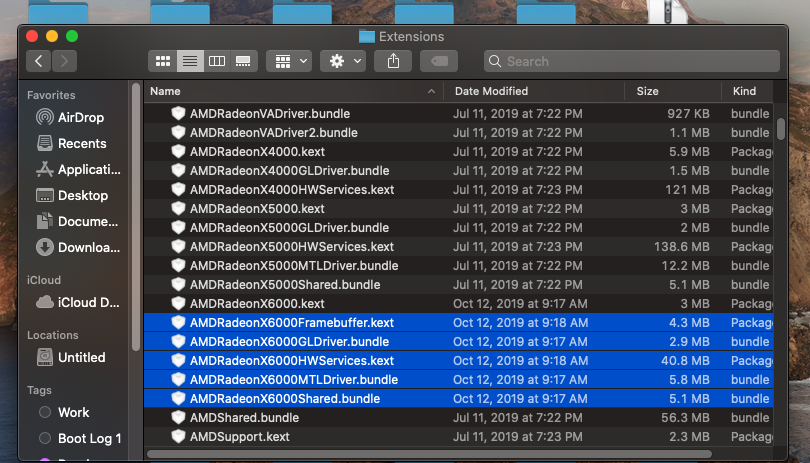

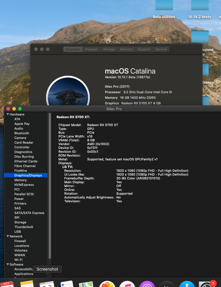

AS OF 10/17/19 CATALINA DEV BETA 15.1 version 2 has support for AMD Navi cards.    They added the 6000 kexts series to accelerate and to load frame buffers.   This is a different situation than the normal Controllerkexts for graphics cards.
@vit9696  WEG needs to be disabled or removed for the cards to work.    AMD Navi 5700 device ID is 0x73101002, 5700XT is 0x731F1002.   Could the issue be non support for the cards in WEG or is it the new controller routing through the new Framebuffer kext?

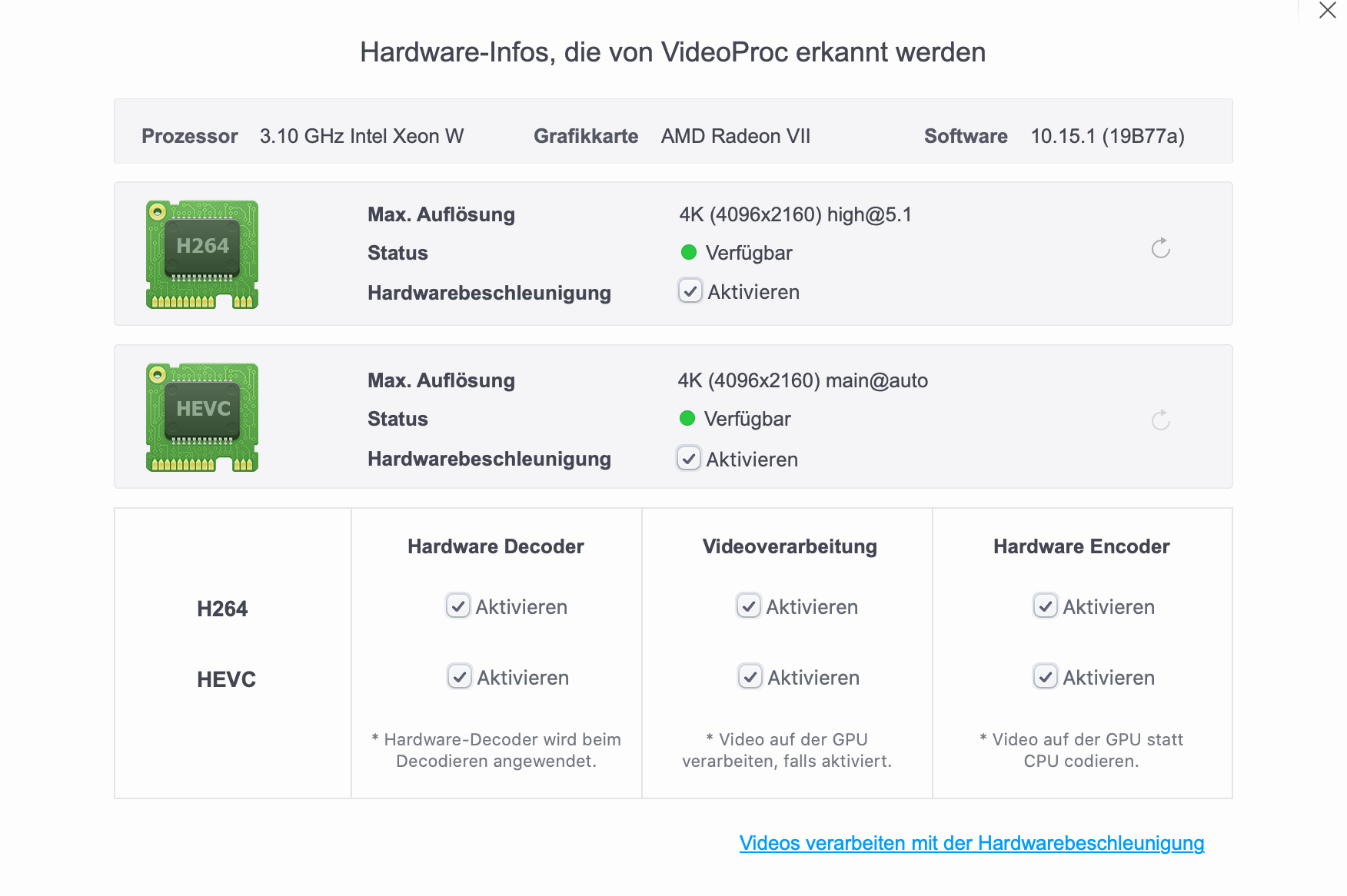

@DSM2 what SMBIOS are you using to get HW h264 + h265 encode/decode?  Is it iMac Pro 1.1?
Can you tell me if HW h264/h265 encode/decode works perfectly?  Do you use it much, eg with software like Premiere Pro, Final Cut Pro, Davinci Resolve or so?
I ask because some of us have regular problem with freezing of screen, requiring reboot, when HW encode is used on system with no internal GPU.  For me it happens with Radeon Vega 64, but someone else on this forum has issue with both Vega 64 and VII Pro, like you have.
So I would be interested to hear how it is for you.

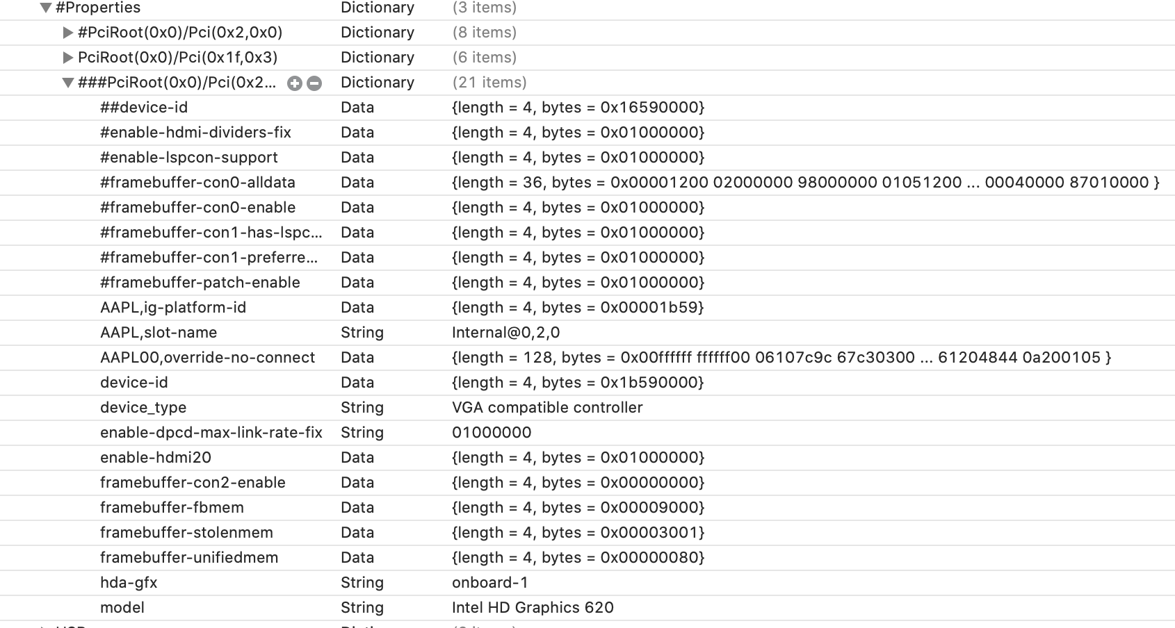

Hi,
Cannot get 8550 working, please help. It has UHD620 and I've set device-id to 16590000 but have HD620, not uhd, so "feature set macOS GPUFamily2 v1"
What id shall I use to get it working? Thank you.
Edited by viktr
13 hours ago, viktr said:
Hi,
Well, probably I am doing something wrong. Need assistance, please help.
I still have a new barebone pc with 8550 cpu and cannot get it working with whatevergreen. I did the patch with clover and everything works just fine with the Rehabman's FakePCIID_intel_hd_Graphics:
removed weg
injected intel with 0x591b0000 ig platform id
set intel gfx fake id to 0x59168086
installed latest Rehabman's fakepciid
enabled gfx to igpu and heci to imei patches
disabled firmware uploading with -disablegfxfirmware
and everything looks like it is working fine in latest catalina - transparency etc. HDMI sound is not working though.
Is it possible to achieve at least the same result with the WEG? Tried this:
System boots but without ui transparency etc.
Thank you

7 minutes ago, errorexists said:
doesnt seem to be any good as i tried it on catalina db2 with a 5700xt neither dp or hdmi working still back screen an was told that weg is not going to be supported in clover
We didn't test WEG on 5700, but we will carry out the test soon.
On previous generation AMD everything is good.
Kexts don't depend on the bootloader.
