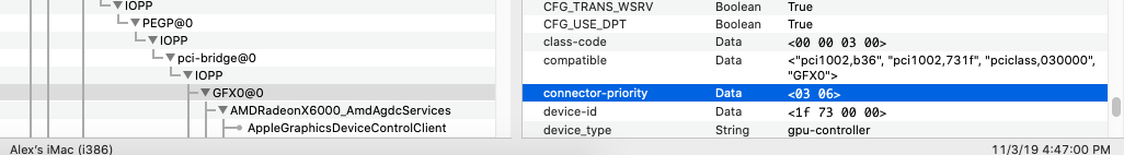

Sign me up for the issues with 5700 XT cards. Without agdpmod=pikera, black screen. But I want to extend it for Recovery mode as well: it is unusable as the screen is garbled. -radvesa does not help in here either.
Also, I can only get DisplayPort if I have a HDMI connected. Even while BIOS/kernel loading prefers the DP, without a HDMI connected device, black screen with all possible combinations.
Did you try to explicitly define connectors priority?
Nope. How do I do it?
Via custom ssdt or device properties. It is in the docs. Download debug versions of liku and weg, provide debug boot parameters for both liku and weg (it is something like -liludbg and -wegdbg), reboot, then find your connectors numbers in the log.
Then you need to find the pci three path to your gpu, for example with https://github.com/acidanthera/gfxutil
After you’ve got connectors numbers and device pci path, you can define their priorities for weg, either with connector priority under your device’s properties in devices or with custom ssdt
Fir device properties just list your connectors, for example you found in logs that 3 is dp, 0 is hdmi and 5 is dvi and you'd like to set the priorities as hdmi (highest), dp, dvi. So your connector-priority property shall look like 0x000305. Here's an example how it could be lookinlg like:

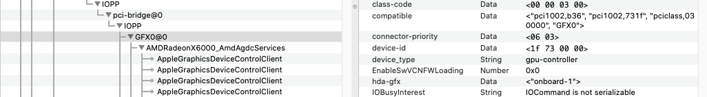

Did the connectors priority change via OC injection. Changed DP over HDMI and HDMI over DP as well. No changes whatsoever. HDMI is still the first display to change to graphics mode after kernel finishes load, and I still have to use a HDMI unit in order to get DP output - a pure DP setup gives black screen, and a HDMI with DP gives me multi monitor setup. DP continues to be the default output for BIOS and kernel loading screens.
Worth a shot though, thanks.
I have completely opposite situation - my dp is set as the first in the bios, connector-priority and ssdt, my system starts to boot with dp as main but when it is switching to gui, it switchs output to the hdmi monitor. Maybe it depends on mac model used, have no idea. Btw, is there a setting for that in your mobo? Mine gb z270 has it for the egpu although it's not so easy to find )
