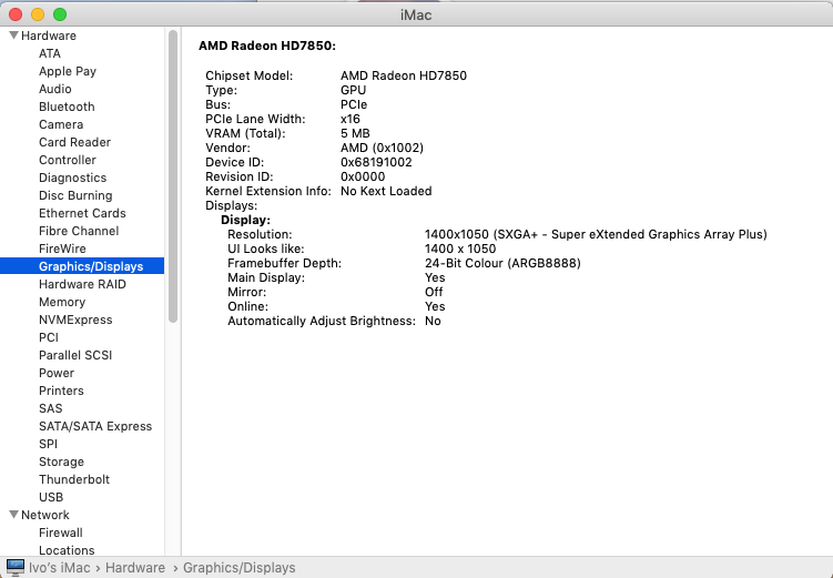

Hi all,
I am struggling now for two weeks to get my card working properly - I have Sapphire HD7850 2GB OC and cannot seem to get hardware acceleration working. Screenshot attached together with my clover.plist.
I am also attaching report from Lilu and WhateverGreen debug versions.
These are my specs:
  • Asrock Z77 Pro3
  • i5-2500k
  • Sapphire HD7850 2GB OC
 I am using these kexts:
  • WhateverGreen
  • Lilu
  • AppleALC
  • RealtekRTL8111
  • USBInjectAll
  • VirtualSMC
I tried all ports (2 mDP, HDMI, DVI), tried ati injector, without ati injector, radpg boot flag but nothing seems to work.
Do you have any idea what else could I try?
config.plist
debug.log
Edited by Mojo28
On 9/8/2019 at 9:30 AM, Mojo28 said:
Hi all,
These are my specs:
  • Asrock Z77 Pro3
  • i5-2500k
  • WhateverGreen
  • Lilu
  • AppleALC
  • RealtekRTL8111
  • USBInjectAll
  • VirtualSMC
config.plist
debug.log
See messages in your log
2019-09-01 23:51:10.568411+0200  localhost kernel[0]: (kernel) WhateverGreen:     weg @ IGPU device (00:02.00) has device-id 0x0112, you should change it to 0x0116
2019-09-01 23:51:10.575741+0200  localhost kernel[0]: (kernel) WhateverGreen:     weg @ IMEI device (00:16.00) has device-id 0x1E3A, you should change it to 0x1C3A
The IGPU message seems was coming from igfxsnb=1 boot argument...
I removed it and also seems that I managed to get rid of the other warning:
2019-09-09 18:25:55.761803+0200  localhost kernel[0]: (kernel) WhateverGreen:     weg @ IMEI device (00:16.00) has device-id 0x1E3A, you should change it to 0x1C3A
2019-09-09 18:28:35.605336+0200  localhost kernel[0]: calling mpo_policy_init for Lilu
2019-09-09 18:28:35.606464+0200  localhost kernel[0]: Security policy loaded: Lilu Kernel Extension 1.3.8 DEBUG build (Lilu)
2019-09-09 18:28:37.649370+0200  localhost kernel[0]: (kernel) WhateverGreen:     weg @ IMEI device (00:16.00) has device-id 0x1C3A0000, you should change it to 0x1C3A
2019-09-09 18:33:43.605995+0200  localhost kernel[0]: calling mpo_policy_init for Lilu
2019-09-09 18:33:43.607123+0200  localhost kernel[0]: Security policy loaded: Lilu Kernel Extension 1.3.8 DEBUG build (Lilu)
Seems that from my last boot (18:33) I don't get any warning anymore.
Didn't help however :(
Edited by Mojo28
