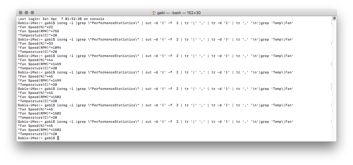

okrasit Posted April 6, 2018 Share Posted April 6, 2018 (edited) 7 minutes ago, gabilopezb said: The same way as it does now. It’s like the patch does not affect the behavior of the fan at all Exactly, it affects only the pump I'd guess. Can you check the temperatures & fan (pump) speed ? ioreg -l |grep \"PerformanceStatistics\" | cut -d '{' -f 2 | tr '|' ',' | tr -d '}' | tr ',' '\n'|grep 'Temp\|Fan' Edited April 6, 2018 by okrasit 1 Link to comment https://www.insanelymac.com/forum/topic/325120-vega-frontier-edition-on-high-sierra/page/7/#findComment-2608166 Share on other sites More sharing options...

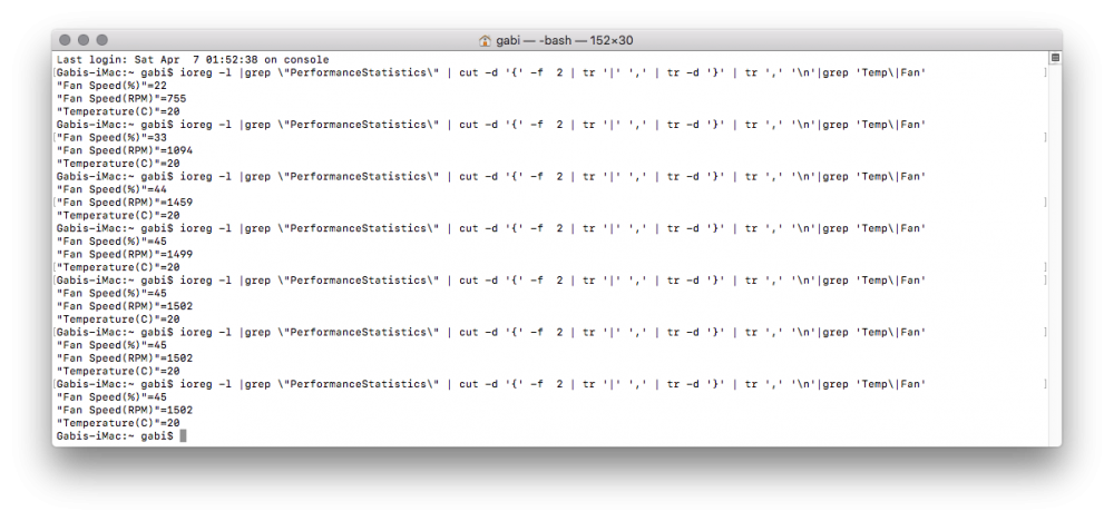

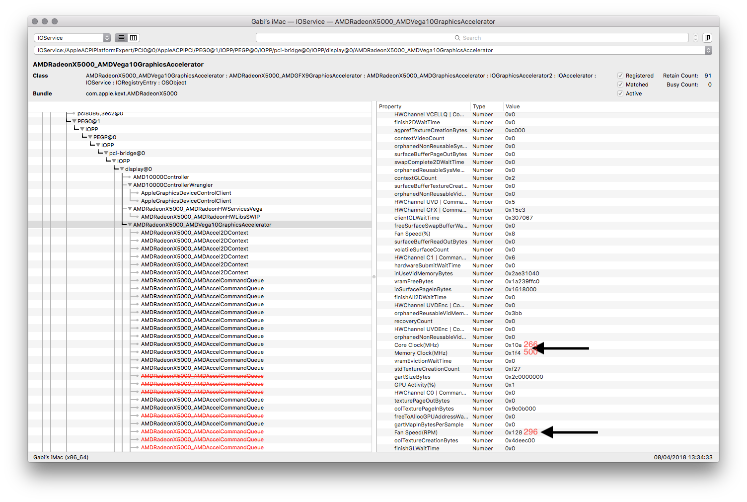

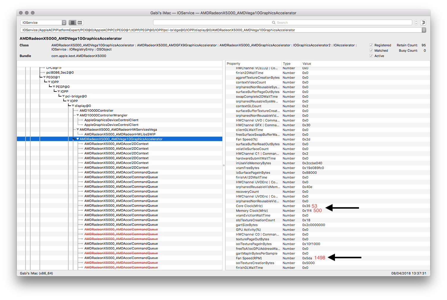

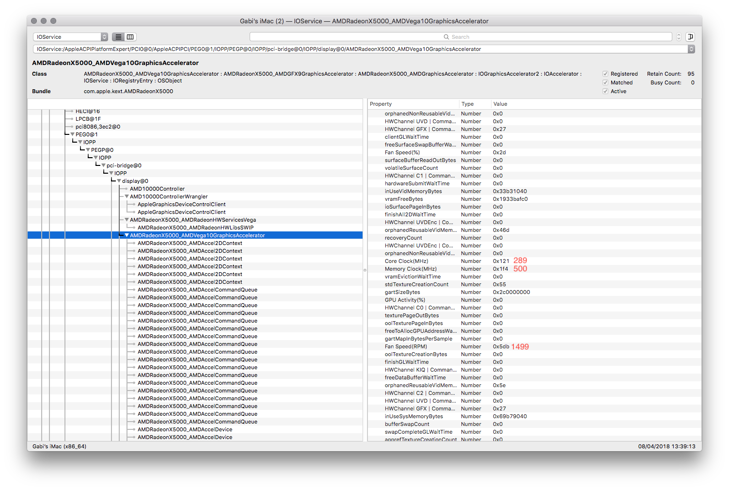

gabilopezb Posted April 6, 2018 Share Posted April 6, 2018 6 hours ago, okrasit said: Exactly, it affects only the pump I'd guess. Can you check the temperatures & fan (pump) speed ? ioreg -l |grep \"PerformanceStatistics\" | cut -d '{' -f 2 | tr '|' ',' | tr -d '}' | tr ',' '\n'|grep 'Temp\|Fan' Hey, thanks again. Sorry for the delay. In the file attached you can see how the fan speed increases since the login and reaches the maximum of 1500ish and stays there. Link to comment https://www.insanelymac.com/forum/topic/325120-vega-frontier-edition-on-high-sierra/page/7/#findComment-2608225 Share on other sites More sharing options...

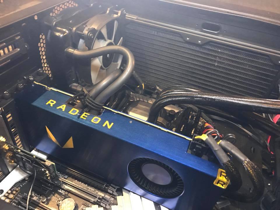

Wackymac Posted April 16, 2018 Share Posted April 16, 2018 @okrasit Look what you made me do! 2 Link to comment https://www.insanelymac.com/forum/topic/325120-vega-frontier-edition-on-high-sierra/page/7/#findComment-2610297 Share on other sites More sharing options...
