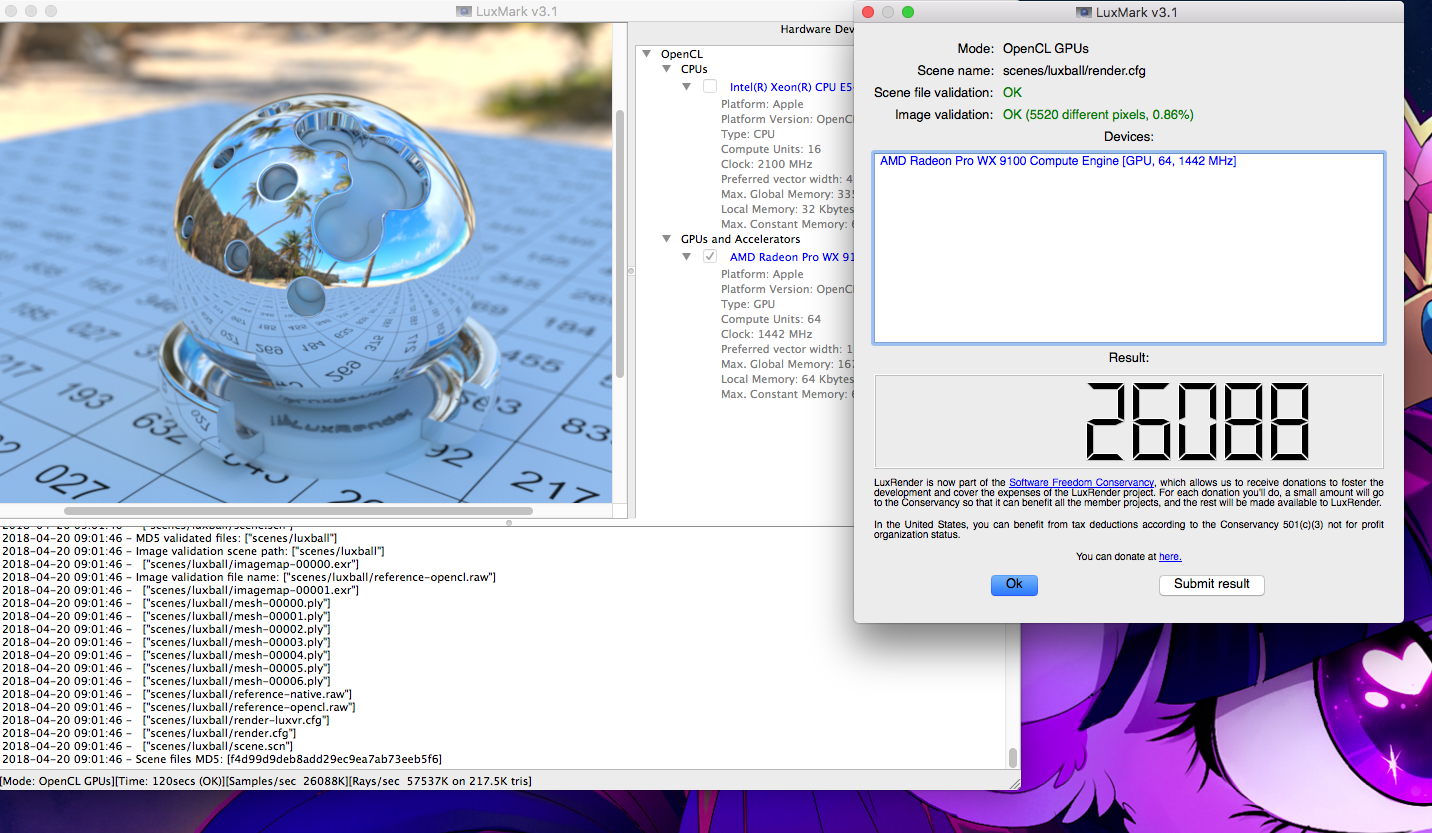

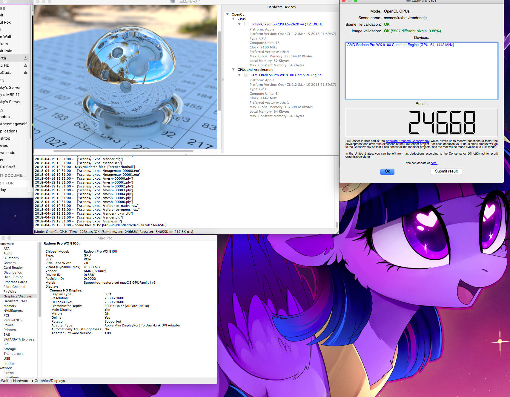

Setura Posted April 19, 2018 Share Posted April 19, 2018 (edited) 33 minutes ago, okrasit said: Running luxmark benchmark, your fan rpm should go very high, you’d notice it for sure. Also, make sure you don’t have SIP enabled, csrutil or something and Clover config has some activecsr config option, google it! well in my clover I had to have my setting as BooterConfig 0x28 and CsrActiveConfig 0x67 to start OSX with my Xeon which im pretty sure also disables SIP. I'll run Luxmark now then. I ran ARK for 10 mins and the fan didn't really kick up but the exhaust from the card sure was warm. --- EDIT: ok. Ran it. Oh boy, that fan came alive after about 40 secs Sadly my score is below the Frontier edition I saw someone else post with higher clock rate. If it's not a good idea to take my 1442mhz any higher then I won't as I value the health of this GPU and don't plan on watercooling it. Are there any other ways that might boost its performance or am I just needing to wait and hope that Apple do something? Edited April 19, 2018 by Setura Link to comment https://www.insanelymac.com/forum/topic/325120-vega-frontier-edition-on-high-sierra/page/8/#findComment-2610708 Share on other sites More sharing options...
okrasit Posted April 19, 2018 Share Posted April 19, 2018 (edited) 13 hours ago, Setura said: well in my clover I had to have my setting as BooterConfig 0x28 and CsrActiveConfig 0x67 to start OSX with my Xeon which im pretty sure also disables SIP. I'll run Luxmark now then. I ran ARK for 10 mins and the fan didn't really kick up but the exhaust from the card sure was warm. --- EDIT: ok. Ran it. Oh boy, that fan came alive after about 40 secs Sadly my score is below the Frontier edition I saw someone else post with higher clock rate. If it's not a good idea to take my 1442mhz any higher then I won't as I value the health of this GPU and don't plan on watercooling it. Are there any other ways that might boost its performance or am I just needing to wait and hope that Apple do something? I'm sure you got some throttling during the benchmark, due to low initial fan speed & high temps. Run the benchmark twice and you'll see. OR NOT Try this, it has lower temp target (57C). tgIIAQBcAOEGAADuKwAAGwBIAAAAgKkDAPBJAgCOAAgAAAAAAAAAAAAAAAAAAAIBXABPAkYClACeAb4AKAF6AIwAvAEAAAAAcgIAAJAAqAJtAUMBlwHwSQIAcQICAgAAAAAAAAgAAAAAAAAABQAHAAMABQAAAAAAAAABCIQDhAOEA4QDhAOEA7YDMwQBATMEAQGEAwAIYOoAAABAGQEAAYA4AQAC3EoBAAOQXwEABAB3AQAFkJEBAAZQvQEABwEI0EwBAAAAgAAAAAAAAByDAQABAAAAAAAAAABwpwEAAgAAAAAAAAAAiLwBAAMAAAAAAAAAADjBAQAEAAAAAAAAAACI1QEABQAAAAABAAAAmPwBAAYAAAAAAQAAAEgzAgAHAAAAAAEAAAAABWDqAAAAQBkBAACAOAEAANxKAQAAkF8BAAAACChuAAAALMkAAAH4CwEAAoA4AQADkF8BAAT0kQEABdCwAQAGOMEBAAcACGw5AAAAJF4AAAH8hQAAAqy8AAADNNAAAARobgEABQiXAQAGsK0BAAcAAWg8AQAAAQQ8QQAAAAAAUMMAAAAAAIA4AQACAAA0mAEABAAAAQgAmIUAAEC1AABg6gAAUMMAAAGAuwAAYOoAAJQLAQBQwwAAAgDhAACUCwEAQBkBAFDDAAADeP8AAEAZAQCIJgEAUMMAAARAGQEAgDgBAIA4AQBQwwAABYA4AQDcSgEA3EoBAFDDAAAGAHcBAAB3AQCQXwEAUMMAAAeQkQEAkJEBAAB3AQBQwwAAARgAAAAAAAAACwAAvAJIJjkACgBUA5ABkAGQAZABkAGQAZABAAAAAAACBDEH3ADcANwAkAEAAFkAaQBKAEoAXwBzAHMAZABAAJCSl2CWAJBVAAAAAAAAAAAAAAAAAAAAAAACAtQwAAACEGDqAAACEA== I got some throttling with FE too (memory gets too hot, probably) , didn't notice it before as I also have RX64. Edited April 19, 2018 by okrasit 1 Link to comment https://www.insanelymac.com/forum/topic/325120-vega-frontier-edition-on-high-sierra/page/8/#findComment-2610767 Share on other sites More sharing options...
Setura Posted April 19, 2018 Share Posted April 19, 2018 well, that certainly made a difference. Fan kicked into blower mode about 10 sec earlier Thanks. 1 Link to comment https://www.insanelymac.com/forum/topic/325120-vega-frontier-edition-on-high-sierra/page/8/#findComment-2610772 Share on other sites More sharing options...

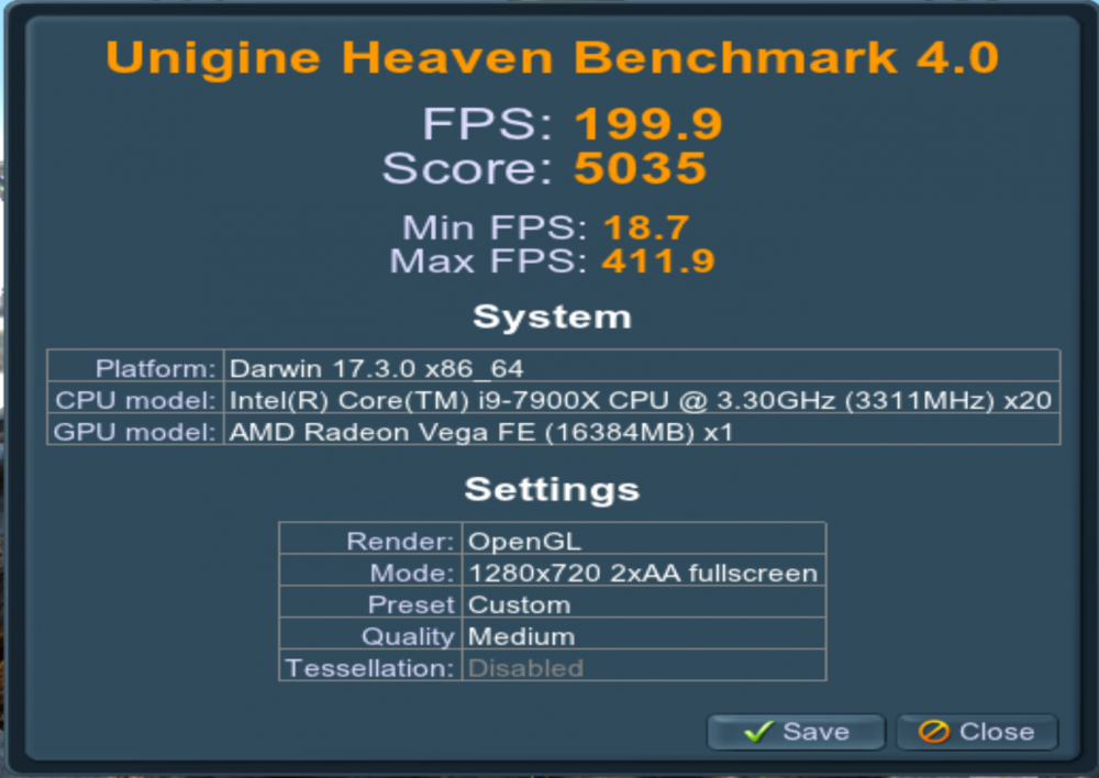

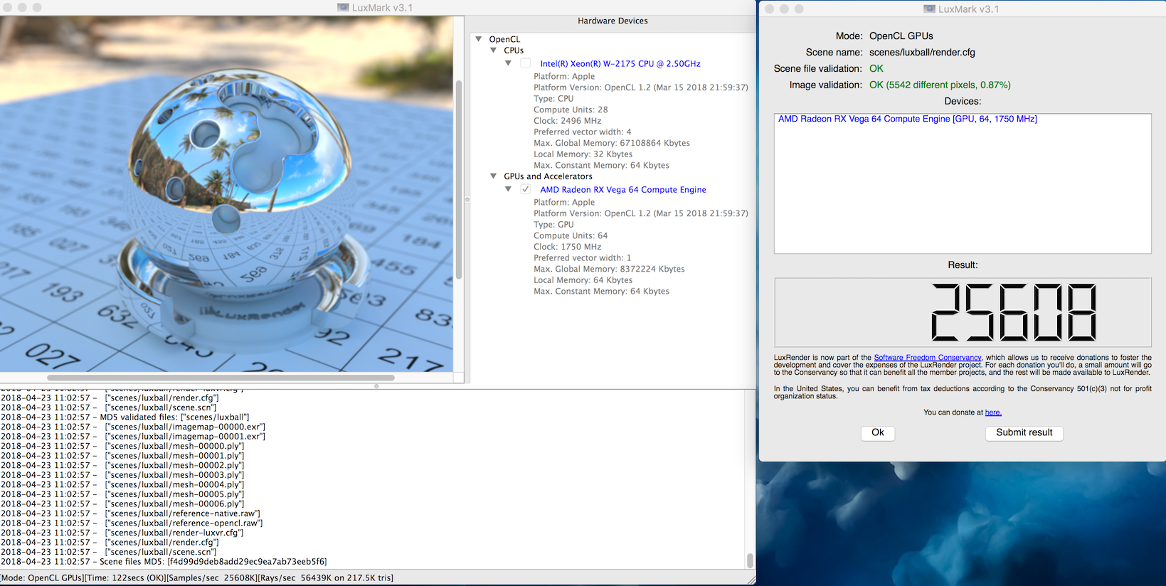

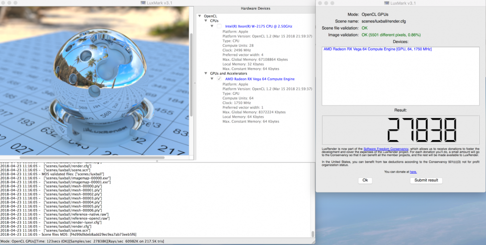

obus Posted April 23, 2018 Share Posted April 23, 2018 On 4/16/2018 at 9:54 PM, okrasit said: It's not a good benchmark, your fps will get capped to screen refresh rate in some situations, like an open browser window etc. Sorry again @okrasit maybe OT because I'm not running FE but I have a weird problem with my Vega 64 liquid. I need to put my rig into sleep before I run Cinebench!!!?? if not the open GL performance is really poor like 80 to 87 fps maximum. After one sleep cycle the open GL performance increase to 131 fps as best result. The same for Unigine_Valley-1.0-Advanced. In windows Cinebech is scoring like 145 fps so I think that 131 should be good for those now existing drivers in High Sierra. I'm running my rig on intel Xeon W 2175 if that could have any impact. Link to comment https://www.insanelymac.com/forum/topic/325120-vega-frontier-edition-on-high-sierra/page/8/#findComment-2611137 Share on other sites More sharing options...
obus Posted April 23, 2018 Share Posted April 23, 2018 On 4/4/2018 at 8:19 PM, okrasit said: For custom water cooled ones: Core: 1642MHz/1150mV, Memory: 1045MHz/1075mV, SOC: 1199MHz, Temp target: 75, Idle fan: 1000rpm tgIIAQBcAOEGAADuKwAAGwBIAAAAgKkDAPBJAgCOAAgAAAAAAAAAAAAAAAAAAAIBXABPAkYClACeAb4AKAF6AIwAvAEAAAAAcgIAAJAAqAJtAUMBlwHwSQIAcQICAgAAAAAAAAgAAAAAAAAABQAHAAMABQAAAAAAAAABCIQDhAO2A+gDGgRMBGAEfgQBATMEAQGEAwAIYOoAAABAGQEAAYA4AQAC3EoBAAOQXwEABAB3AQAFkJEBAAZQvQEABwEI0EwBAAAAgAAAAAAAAESNAQABAAAAAAAAAADcxwEAAgAAAAAAAAAAmPwBAAMAAAAAAAAAANgbAgAEAAAAAAAAAAD0QAIABQAAAAABAAAAHGQCAAYAAAAAAQAAAGiBAgAHAAAAAAEAAAAABWDqAAAAQBkBAACAOAEAANxKAQAAkF8BAAAACChuAAAALMkAAAH4CwEAAoA4AQADkF8BAAT0kQEABdCwAQAGOMEBAAcACGw5AAAAJF4AAAH8hQAAAqy8AAADNNAAAARobgEABQiXAQAGsK0BAAcAAWg8AQAAAQQ8QQAAAAAAUMMAAAAAAIA4AQACAAA0mAEABAAAAQgAmIUAAEC1AABg6gAAUMMAAAGAuwAAYOoAAJQLAQBQwwAAAgDhAACUCwEAQBkBAFDDAAADeP8AAEAZAQCIJgEAUMMAAARAGQEAgDgBAIA4AQBQwwAABYA4AQDcSgEA3EoBAFDDAAAGAHcBAAB3AQCQXwEAUMMAAAeQkQEAkJEBAAB3AQBQwwAAARgAAAAAAAAAC+QS0AckE0sACgBUA5ABkAGQAZABkAGQAZABAAAAAAACBDEHkAGQAZABkAEAAFkAaQBKAEoAXwBzAHMAZABAAJCSl2CWAJBVAAAAAAAAAAAAAAAAAAAAAAACAtQwAAACEGDqAAACEA== Used your patch on my Vega 64 Liquid with no problems and increased performance. The fan for the cooler is a little more noisy but that's not a big problem. 1 Link to comment https://www.insanelymac.com/forum/topic/325120-vega-frontier-edition-on-high-sierra/page/8/#findComment-2611139 Share on other sites More sharing options...

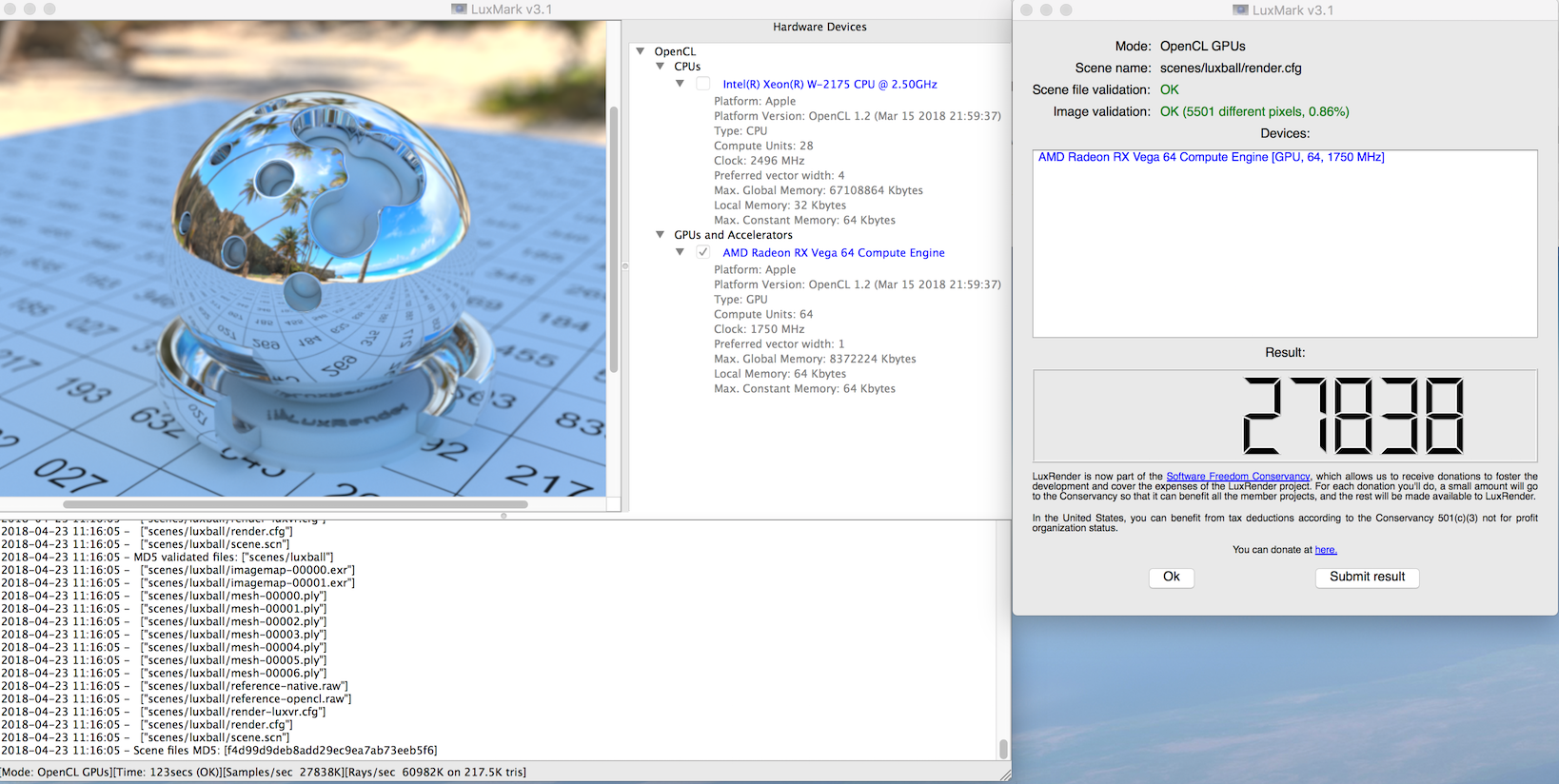

surfinchina Posted April 27, 2018 Share Posted April 27, 2018 On 4/20/2018 at 7:52 AM, okrasit said: I'm sure you got some throttling during the benchmark, due to low initial fan speed & high temps. Run the benchmark twice and you'll see. OR NOT Try this, it has lower temp target (57C). tgIIAQBcAOEGAADuKwAAGwBIAAAAgKkDAPBJAgCOAAgAAAAAAAAAAAAAAAAAAAIBXABPAkYClACeAb4AKAF6AIwAvAEAAAAAcgIAAJAAqAJtAUMBlwHwSQIAcQICAgAAAAAAAAgAAAAAAAAABQAHAAMABQAAAAAAAAABCIQDhAOEA4QDhAOEA7YDMwQBATMEAQGEAwAIYOoAAABAGQEAAYA4AQAC3EoBAAOQXwEABAB3AQAFkJEBAAZQvQEABwEI0EwBAAAAgAAAAAAAAByDAQABAAAAAAAAAABwpwEAAgAAAAAAAAAAiLwBAAMAAAAAAAAAADjBAQAEAAAAAAAAAACI1QEABQAAAAABAAAAmPwBAAYAAAAAAQAAAEgzAgAHAAAAAAEAAAAABWDqAAAAQBkBAACAOAEAANxKAQAAkF8BAAAACChuAAAALMkAAAH4CwEAAoA4AQADkF8BAAT0kQEABdCwAQAGOMEBAAcACGw5AAAAJF4AAAH8hQAAAqy8AAADNNAAAARobgEABQiXAQAGsK0BAAcAAWg8AQAAAQQ8QQAAAAAAUMMAAAAAAIA4AQACAAA0mAEABAAAAQgAmIUAAEC1AABg6gAAUMMAAAGAuwAAYOoAAJQLAQBQwwAAAgDhAACUCwEAQBkBAFDDAAADeP8AAEAZAQCIJgEAUMMAAARAGQEAgDgBAIA4AQBQwwAABYA4AQDcSgEA3EoBAFDDAAAGAHcBAAB3AQCQXwEAUMMAAAeQkQEAkJEBAAB3AQBQwwAAARgAAAAAAAAACwAAvAJIJjkACgBUA5ABkAGQAZABkAGQAZABAAAAAAACBDEH3ADcANwAkAEAAFkAaQBKAEoAXwBzAHMAZABAAJCSl2CWAJBVAAAAAAAAAAAAAAAAAAAAAAACAtQwAAACEGDqAAACEA== I got some throttling with FE too (memory gets too hot, probably) , didn't notice it before as I also have RX64. My Luxmark went from 25000 to 27000. Heaven is even crazier! But my max temps went from 45 to 92 degrees. So I guess it pays to be careful... I'm runnung a Vega AIO bios on an air Vega with EK watercooling on it. For some reason images aren't uploading. Heaven from 5000 to 6000. 1 Link to comment https://www.insanelymac.com/forum/topic/325120-vega-frontier-edition-on-high-sierra/page/8/#findComment-2611721 Share on other sites More sharing options...
okrasit Posted April 27, 2018 Share Posted April 27, 2018 (edited) 8 hours ago, surfinchina said: My Luxmark went from 25000 to 27000. Heaven is even crazier! But my max temps went from 45 to 92 degrees. So I guess it pays to be careful... I'm runnung a Vega AIO bios on an air Vega with EK watercooling on it. For some reason images aren't uploading. Heaven from 5000 to 6000. Those temps Edited April 28, 2018 by okrasit Link to comment https://www.insanelymac.com/forum/topic/325120-vega-frontier-edition-on-high-sierra/page/8/#findComment-2611727 Share on other sites More sharing options...

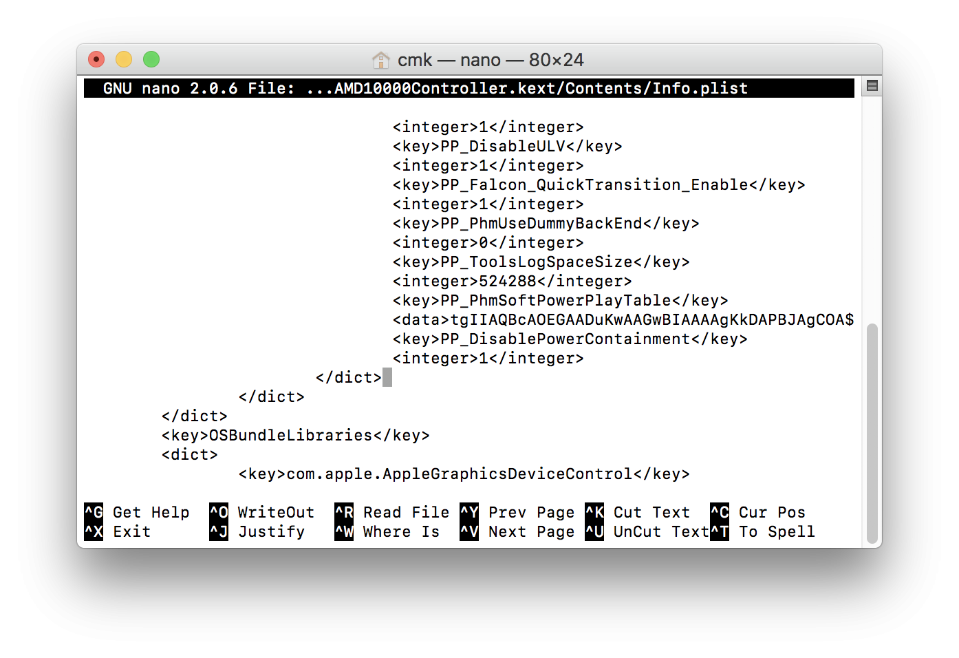

cmk☆ Posted May 5, 2018 Share Posted May 5, 2018 On 4/5/2018 at 3:19 AM, okrasit said: Here's one for anyone with air-cooled card: Core: 1600MHz/1150mV, Memory: 1045MHz/1075mV, SOC: 1199MHz, Temp target: 70, Idle fan: 700rpm tgIIAQBcAOEGAADuKwAAGwBIAAAAgKkDAPBJAgCOAAgAAAAAAAAAAAAAAAAAAAIBXABPAkYClACeAb4AKAF6AIwAvAEAAAAAcgIAAJAAqAJtAUMBlwHwSQIAcQICAgAAAAAAAAgAAAAAAAAABQAHAAMABQAAAAAAAAABCIQDhAO2A+gDGgRMBGAEfgQBATMEAQGEAwAIYOoAAABAGQEAAYA4AQAC3EoBAAOQXwEABAB3AQAFkJEBAAZQvQEABwEI0EwBAAAAgAAAAAAAAESNAQABAAAAAAAAAADcxwEAAgAAAAAAAAAAmPwBAAMAAAAAAAAAANgbAgAEAAAAAAAAAAD0QAIABQAAAAABAAAAHGQCAAYAAAAAAQAAAABxAgAHAAAAAAEAAAAABWDqAAAAQBkBAACAOAEAANxKAQAAkF8BAAAACChuAAAALMkAAAH4CwEAAoA4AQADkF8BAAT0kQEABdCwAQAGOMEBAAcACGw5AAAAJF4AAAH8hQAAAqy8AAADNNAAAARobgEABQiXAQAGsK0BAAcAAWg8AQAAAQQ8QQAAAAAAUMMAAAAAAIA4AQACAAA0mAEABAAAAQgAmIUAAEC1AABg6gAAUMMAAAGAuwAAYOoAAJQLAQBQwwAAAgDhAACUCwEAQBkBAFDDAAADeP8AAEAZAQCIJgEAUMMAAARAGQEAgDgBAIA4AQBQwwAABYA4AQDcSgEA3EoBAFDDAAAGAHcBAAB3AQCQXwEAUMMAAAeQkQEAkJEBAAB3AQBQwwAAARgAAAAAAAAACwAAvAJIJkYACgBUA5ABkAGQAZABkAGQAZABAAAAAAACBDEHkAGQAZABkAEAAFkAaQBKAEoAXwBzAHMAZABAAJCSl2CWAJBVAAAAAAAAAAAAAAAAAAAAAAACAtQwAAACEGDqAAACEA== Hey! I'm a bit of a newbie to all this, so thanks all for your patients, but my Vega FE in Mantiz enclosure has been crashing under heavy load. I got a brand new 800w PSU and it still tanks almost immediately. The fan on the FE is not cranking up, which led me here. I tried Okrasit's edit of the kext. Then when I try: On 4/5/2018 at 3:11 AM, okrasit said: touch /System/Library/Extensions; kextcache -update-volume / I get "Kext with invalid signatured (-67030) allowed:..." not sure if that's an error or not, but when I reboot, there's no apparent change. opening a demanding motion project maxes out the eGPU, no big fan speed change, and system egpu crashes within seconds. I really appreciate the input from Okrasit and everyone here. I feel like I'm getting close. Can anyone spot something I might be missing? Thanks so much!! 1 Link to comment https://www.insanelymac.com/forum/topic/325120-vega-frontier-edition-on-high-sierra/page/8/#findComment-2612561 Share on other sites More sharing options...

cmk☆ Posted May 5, 2018 Share Posted May 5, 2018 6 hours ago, Xplisite said: i have exactly the same problem with a VEGA 64 STRIX and my Fan speed which no go up in a sonnet BB enclosure, i have try different edit with no effect, and same error in the terminal. Xplisite, I just tried Kext Utility as Setura mentioned earlier (thanks Setura!). On 4/19/2018 at 3:08 PM, Setura said: Ok, thank you. Took two goes (first time it rejected the kext upon restart) but using Kext Utility after touch /System/Library/Extensions; kextcache -update-volume / nd then restarting, I think its worked. not sure if I'd done it right (had to rename the backup since it never wrote a new file) but after that the changes are working. you can download it here: http://mac.softpedia.com/get/System-Utilities/Kext-Utility.shtml Lexmark is running smoothly now, and Davinci hasn't crashed yet, but I still get a system failure with my Motion project before the fan has a chance to kick in. I've got the stock 1600Mhz that Okrasit (thank you're a saint!) posted for Vega FE air cooled, but looks like I may have to experiment with lower temp tolerance and/or lower clock. Link to comment https://www.insanelymac.com/forum/topic/325120-vega-frontier-edition-on-high-sierra/page/8/#findComment-2612616 Share on other sites More sharing options...
