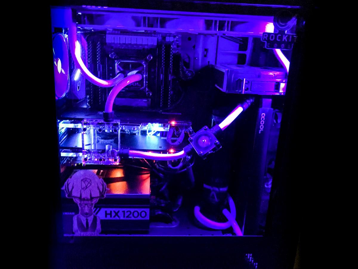

jnolla Posted November 27, 2017 Author Share Posted November 27, 2017 I got the same problem! What did you already try to fix it? which psu do you use? I have not been able to fix this issue Only running one card. Vega RX is sitting disabled. Have you had any luck? My PSU: SeaSonic 1200W ATX12V/EPS12V 80 Plus Platinum Power Supply PLATINUM-1200 ; SS-1200XP3 Updated to Beta4, getting flickering lights and weird fan action. Link to comment https://www.insanelymac.com/forum/topic/325120-vega-frontier-edition-on-high-sierra/page/5/#findComment-2540156 Share on other sites More sharing options...
surfinchina Posted November 27, 2017 Share Posted November 27, 2017 I have not been able to fix this issue Only running one card. Vega RX is sitting disabled. Have you had any luck? My PSU: SeaSonic 1200W ATX12V/EPS12V 80 Plus Platinum Power Supply PLATINUM-1200 ; SS-1200XP3 Updated to Beta4, getting flickering lights and weird fan action. Hi jnolla. Try running a youtube video on Safari and see what happens. My flickering lights stop then, I don't know about fans because I'm on water, but it feels like the GPU is running cooler when I do that. I'm wondering if it's something to do with metal using the GPU memory for something... Link to comment https://www.insanelymac.com/forum/topic/325120-vega-frontier-edition-on-high-sierra/page/5/#findComment-2540176 Share on other sites More sharing options...
jnolla Posted November 27, 2017 Author Share Posted November 27, 2017 Hi jnolla. Try running a youtube video on Safari and see what happens. My flickering lights stop then, I don't know about fans because I'm on water, but it feels like the GPU is running cooler when I do that. I'm wondering if it's something to do with metal using the GPU memory for something... Nope. It actually spikes on utilization. It sits idle if no apps are running on foreground. I was able to get past the pLimit error. Still can't run two cards working I get this message multiple times, and then it blacks out. busy timeout[0], (60s): display Link to comment https://www.insanelymac.com/forum/topic/325120-vega-frontier-edition-on-high-sierra/page/5/#findComment-2540183 Share on other sites More sharing options...

123456789323 Posted January 16, 2018 Share Posted January 16, 2018 I have not been able to fix this issue Only running one card. Vega RX is sitting disabled. Have you had any luck? My PSU: SeaSonic 1200W ATX12V/EPS12V 80 Plus Platinum Power Supply PLATINUM-1200 ; SS-1200XP3 Updated to Beta4, getting flickering lights and weird fan action. Sorry just answering right now but I am not very often around here. Yes, I am running 2 Vega 64 on water For running 2 Vega's you have to disable above 4g and then you will pass the busy timeout[0], (60s): display error... Link to comment https://www.insanelymac.com/forum/topic/325120-vega-frontier-edition-on-high-sierra/page/5/#findComment-2570092 Share on other sites More sharing options...

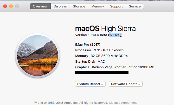

SammlerG Posted February 1, 2018 Share Posted February 1, 2018 today i installed a VEGA 64 FE card, works without any kexts or patches. Only one problem the fans spinnig up to full speed after login. Is there a workaround for this? Link to comment https://www.insanelymac.com/forum/topic/325120-vega-frontier-edition-on-high-sierra/page/5/#findComment-2582167 Share on other sites More sharing options...
surfinchina Posted February 1, 2018 Share Posted February 1, 2018 today i installed a VEGA 64 FE card, works without any kexts or patches. Only one problem the fans spinnig up to full speed after login. Is there a workaround for this? What version of high sierra are you using? Link to comment https://www.insanelymac.com/forum/topic/325120-vega-frontier-edition-on-high-sierra/page/5/#findComment-2582342 Share on other sites More sharing options...
SammlerG Posted February 1, 2018 Share Posted February 1, 2018 i use macOS 10.13.4 beta (17E139j) EDIT: if i play a video in Youtube, then the fans slow down and work normal. I can also top video playback, an fans work normal and quiet. Link to comment https://www.insanelymac.com/forum/topic/325120-vega-frontier-edition-on-high-sierra/page/5/#findComment-2582372 Share on other sites More sharing options...
surfinchina Posted February 1, 2018 Share Posted February 1, 2018 i use macOS 10.13.4 beta (17E139j) EDIT: if i play a video in Youtube, then the fans slow down and work normal. I can also top video playback, an fans work normal and quiet. Right, same as mine. Except I have an EK waterblock so I only get the blue lights winking away at me. Nobodys found a fix yet. If I play a video in Chrome nothing slows down, in Safari the light activity stops. Safari is metal and Chrome is openCL, so I guess it has something to do with metal. Link to comment https://www.insanelymac.com/forum/topic/325120-vega-frontier-edition-on-high-sierra/page/5/#findComment-2582420 Share on other sites More sharing options...

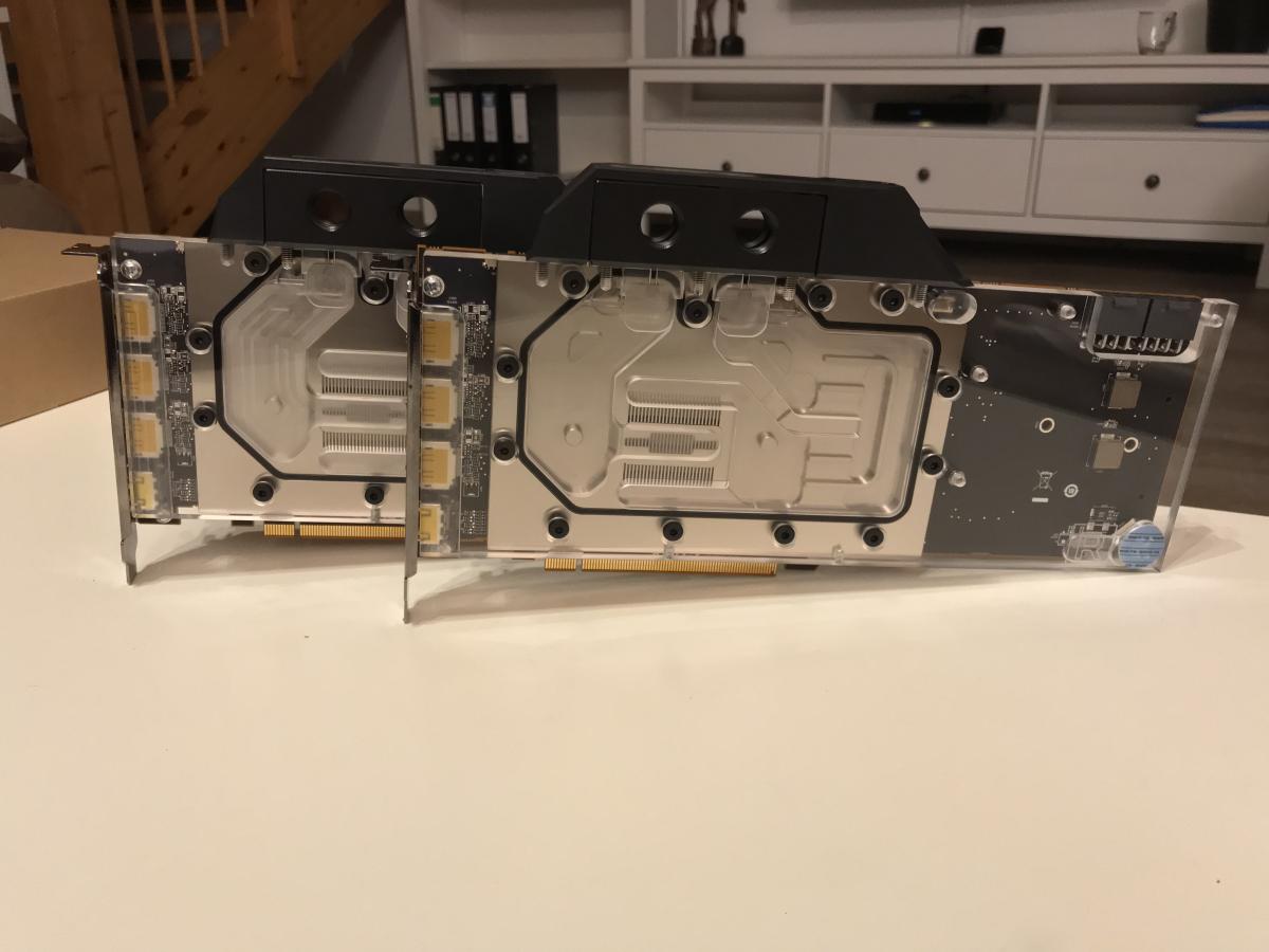

jnolla Posted February 11, 2018 Author Share Posted February 11, 2018 Sorry just answering right now but I am not very often around here. Yes, I am running 2 Vega 64 on water For running 2 Vega's you have to disable above 4g and then you will pass the busy timeout[0], (60s): display error... Could you please share how to disable above 4gig? Link to comment https://www.insanelymac.com/forum/topic/325120-vega-frontier-edition-on-high-sierra/page/5/#findComment-2589317 Share on other sites More sharing options...
mitch_de Posted February 12, 2018 Share Posted February 12, 2018 disable above 4gig is an OPTION you can find in the mainboard uefi settings. Link to comment https://www.insanelymac.com/forum/topic/325120-vega-frontier-edition-on-high-sierra/page/5/#findComment-2590331 Share on other sites More sharing options...

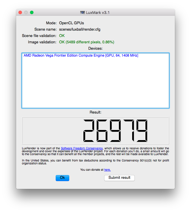

okrasit Posted March 26, 2018 Share Posted March 26, 2018 Memory @1100MHz, SOC @1199MHz and Core DPM7 @1408MHz. Link to comment https://www.insanelymac.com/forum/topic/325120-vega-frontier-edition-on-high-sierra/page/5/#findComment-2605832 Share on other sites More sharing options...
