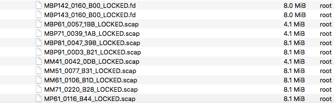

Riley Freeman Posted June 8, 2017 Share Posted June 8, 2017 The bios versions are in the firmware updates which are included with the install and there's no update for MP51 in there. So I'm assuming the installer doesn't do the APFS check with a MP51 SMBIOS as it knows there's no APFS support for it yet. 1 Link to comment https://www.insanelymac.com/forum/topic/324194-pre-release-macos-high-sierra/page/17/#findComment-2438897 Share on other sites More sharing options...

Needy Posted June 8, 2017 Share Posted June 8, 2017 hi needy..there is no macpro5.1 biosversion.. right! As @Riley Freeman said, there's specific update for MacPro5,1. See attached screenshot. However, if you're willing to experiment a little bit and have some time, we can determine what firmware is required for your model, if any at all. Otherwise, trial and error, use same bios version that's used for MacPro6,1 and see if it works. 1 Link to comment https://www.insanelymac.com/forum/topic/324194-pre-release-macos-high-sierra/page/17/#findComment-2438904 Share on other sites More sharing options...

Riley Freeman Posted June 8, 2017 Share Posted June 8, 2017 As I still use MP51 on my X79, to satisfy my curiosity I built a custom Clover 4084 with the old values for FirmwareFeatures and FirmwareFeaturesMask. As the MP51 doesn't have a firmware upgrade I assumed that it would install without complaining about the firmware lacking APFS. And I was right. It's installing now with the old values. Link to comment https://www.insanelymac.com/forum/topic/324194-pre-release-macos-high-sierra/page/17/#findComment-2438921 Share on other sites More sharing options...

Cyberdevs Posted June 8, 2017 Share Posted June 8, 2017 The bios versions are in the firmware updates which are included with the install and there's no update for MP51 in there. So I'm assuming the installer doesn't do the APFS check with a MP51 SMBIOS as it knows there's no APFS support for it yet. How can we extract the data from these files? for instance how to get the full value like: MacPro6,1 MP61.88Z.0116.B44.1705011717 Link to comment https://www.insanelymac.com/forum/topic/324194-pre-release-macos-high-sierra/page/17/#findComment-2438925 Share on other sites More sharing options...

Riley Freeman Posted June 8, 2017 Share Posted June 8, 2017 Just open them in a hex editor and you can read the BIOS version. Link to comment https://www.insanelymac.com/forum/topic/324194-pre-release-macos-high-sierra/page/17/#findComment-2438933 Share on other sites More sharing options...
Needy Posted June 8, 2017 Share Posted June 8, 2017 As I still use MP51 on my X79, to satisfy my curiosity I built a custom Clover 4084 with the old values for FirmwareFeatures and FirmwareFeaturesMask. As the MP51 doesn't have a firmware upgrade I assumed that it would install without complaining about the firmware lacking APFS. And I was right. It's installing now with the old values. ↑ @Needy.that is to say apfs dont support macpro5.1. right? Link to comment https://www.insanelymac.com/forum/topic/324194-pre-release-macos-high-sierra/page/17/#findComment-2438934 Share on other sites More sharing options...
