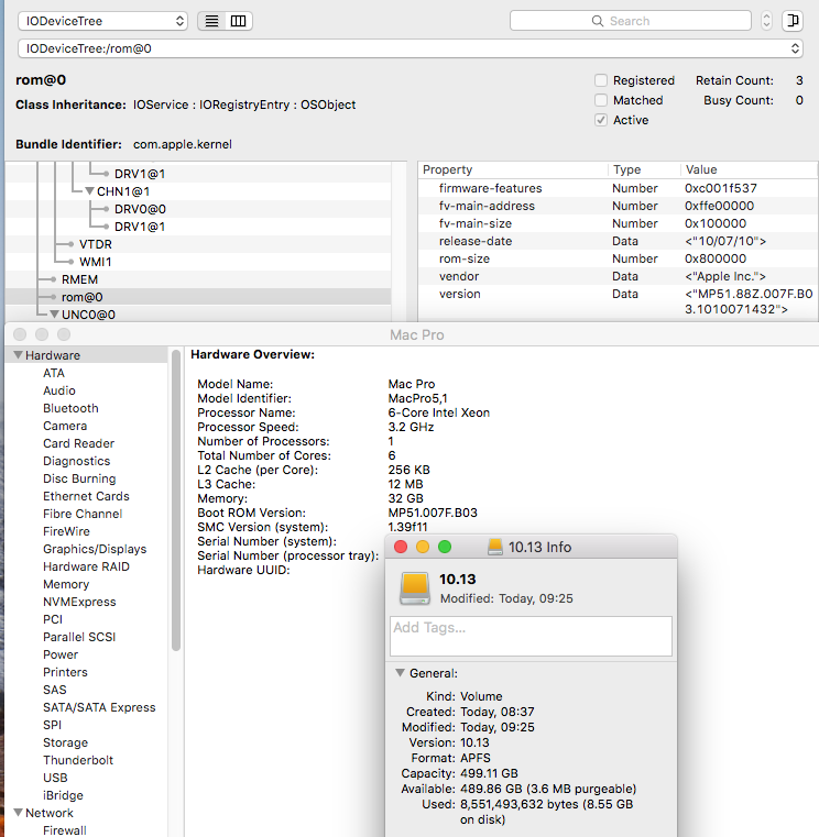

Cyberdevs Posted June 8, 2017 Share Posted June 8, 2017 Just open them in a hex editor and you can read the BIOS version. Thanks man! Link to comment https://www.insanelymac.com/forum/topic/324194-pre-release-macos-high-sierra/page/18/#findComment-2438936 Share on other sites More sharing options...

xtddd Posted June 8, 2017 Share Posted June 8, 2017 Just open them in a hex editor and you can read the BIOS version. MP51.88Z.007F.B03.1010071432 I'm installing with HFS right now but I'll try that next. I'm guessing it'll work OK if I put the apfs.efi into my EFI folder. I only have a hard disk to install to so APFS will be super slow. i get it..thanks Link to comment https://www.insanelymac.com/forum/topic/324194-pre-release-macos-high-sierra/page/18/#findComment-2438943 Share on other sites More sharing options...

Riley Freeman Posted June 8, 2017 Share Posted June 8, 2017 Installation to APFS with MP51 smbios and the old FF/FFM values seems to be going fine here. I put apfs.efi and the apfsjumpstart.efi files into Drivers64UEFI. Link to comment https://www.insanelymac.com/forum/topic/324194-pre-release-macos-high-sierra/page/18/#findComment-2439005 Share on other sites More sharing options...

Riley Freeman Posted June 8, 2017 Share Posted June 8, 2017 @ Riley My new attempt installing on usb hd using apfs fails with screen showing cannot make preboot apfs image,seems like a new one, any suggestions I didn't see that here so I can't think of a way around it. Installing to APFS seems to be no different than HFS except for needing the extra efi file. Installation is almost done here. It hung for some reason before the setup stage so I reset and second time around it loaded fine. It's at the desktop now, grinding away. And we're done: Link to comment https://www.insanelymac.com/forum/topic/324194-pre-release-macos-high-sierra/page/18/#findComment-2439036 Share on other sites More sharing options...
