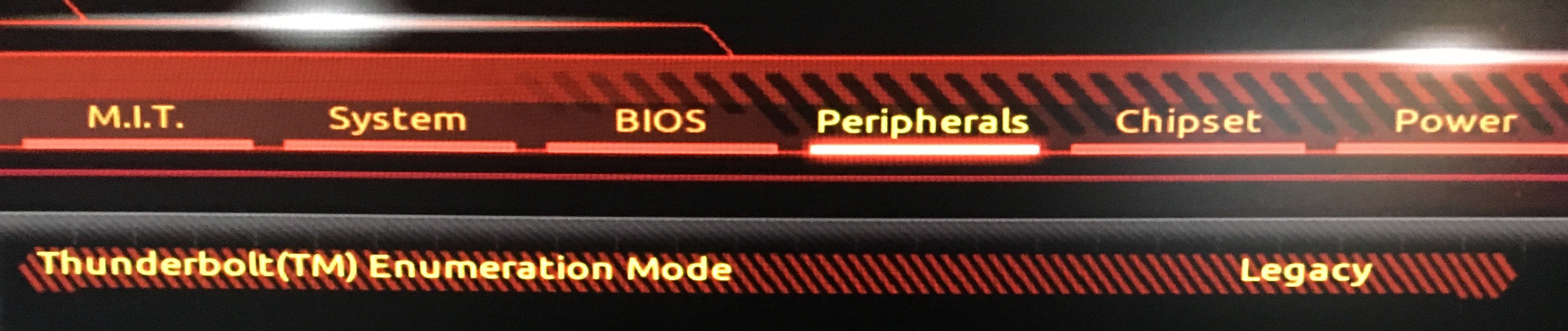

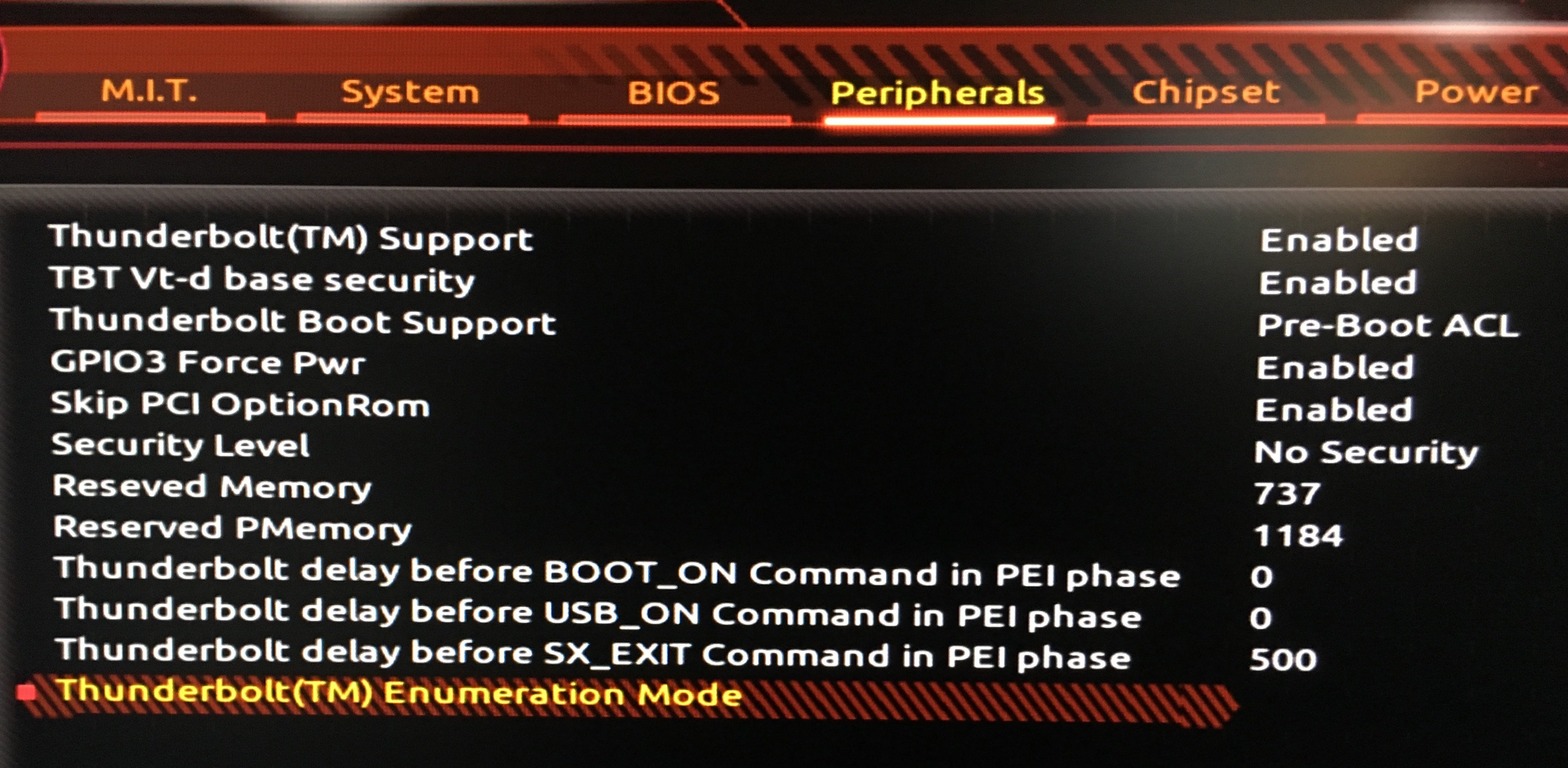

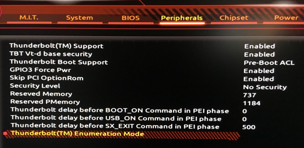

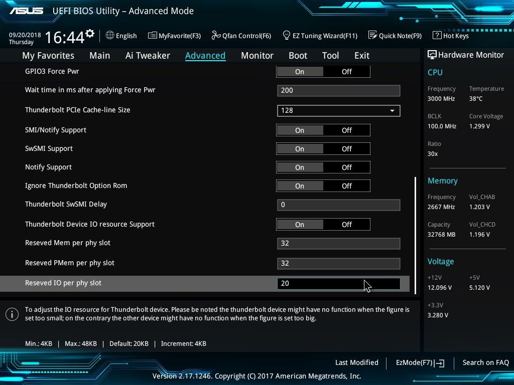

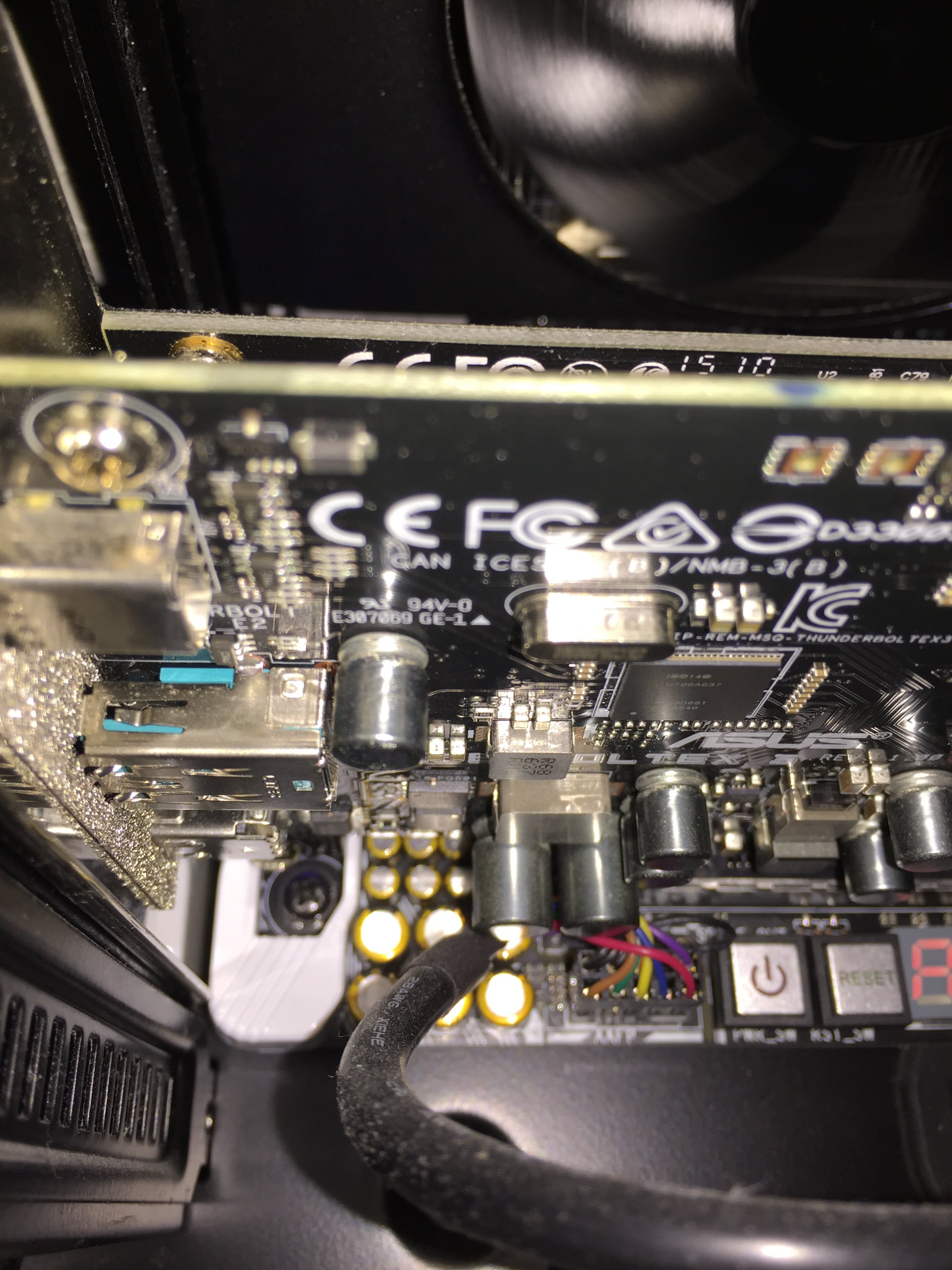

Today I updated the bios of my GB Z370 to the F10 version, and I noticed new settings in the Thunderbolt section.
Now I have the THB_C cable disconnected and it is not comfortable to install it, so, someone who has the cable already connected (with similar hardware) can do some tests and see if anything changes?
1536103683_2018-08-3012_14_56.thumb.jpg.ee02e697e094f2b112bdbf7243eeb93a.jpg1829610176_2018-08-3012_15_10.thumb.jpg.9c2bb3790947c2c28d5af2b79bd80e3a.jpg

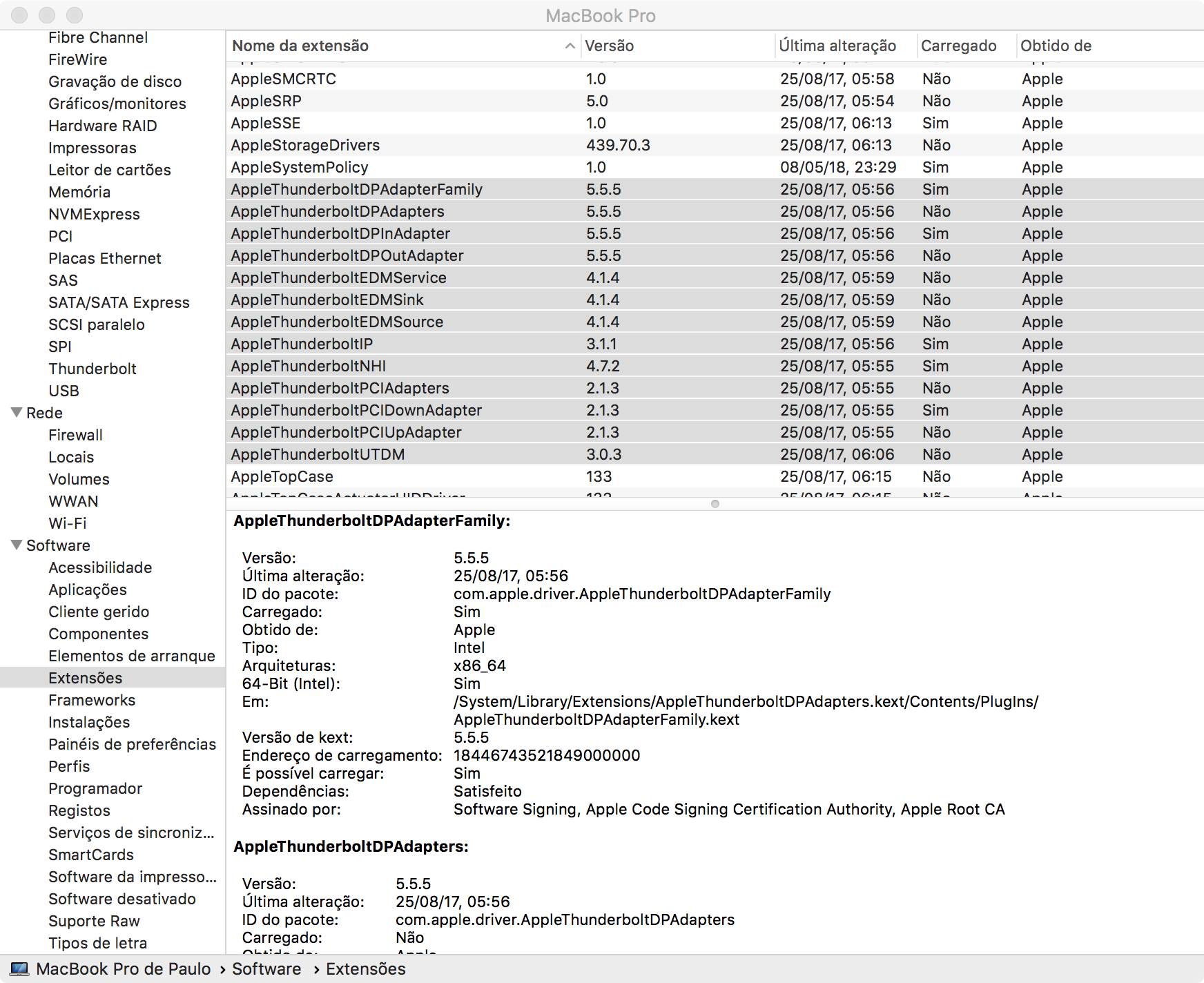

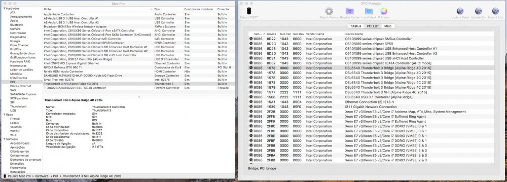

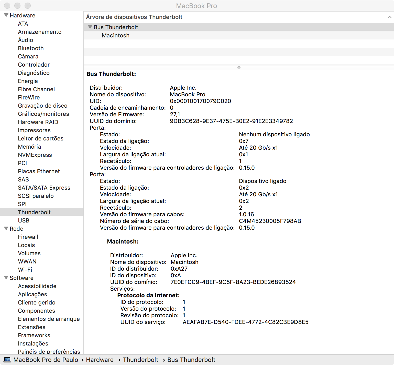

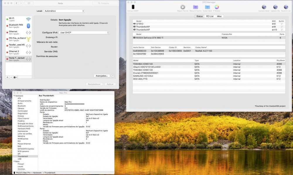

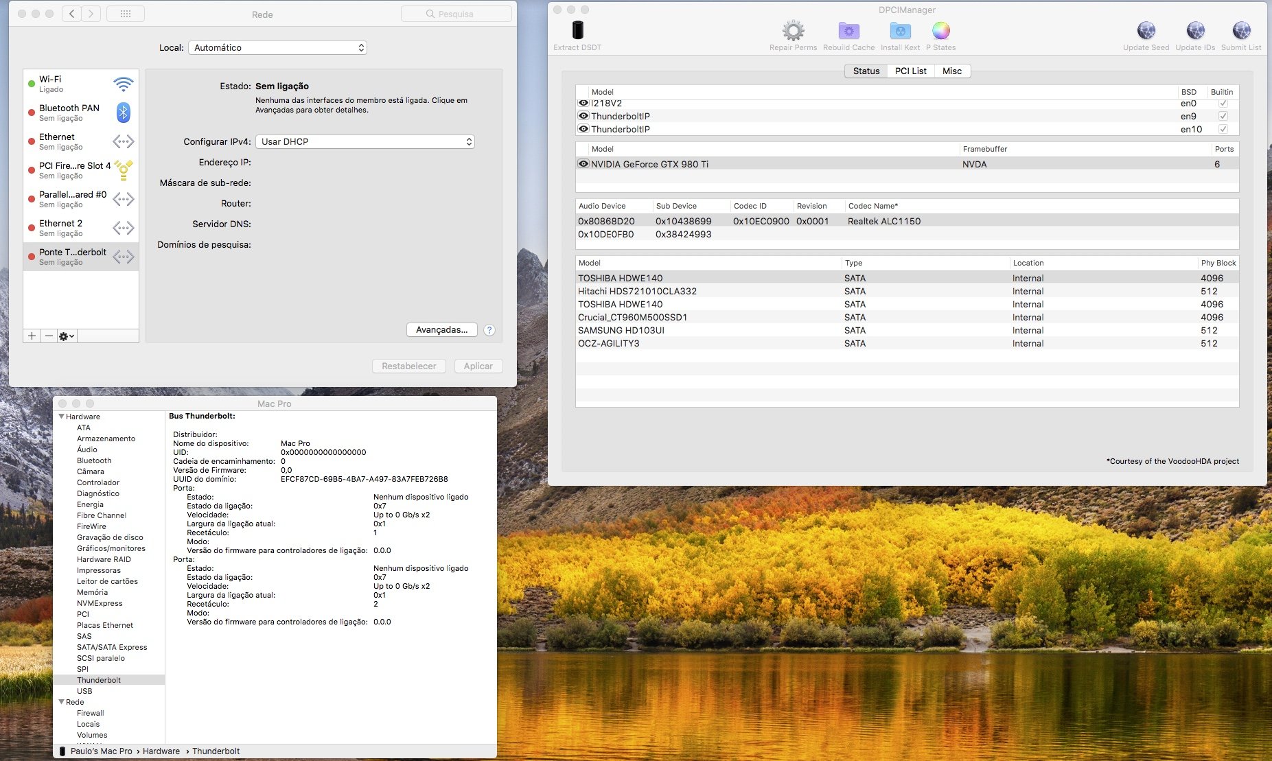

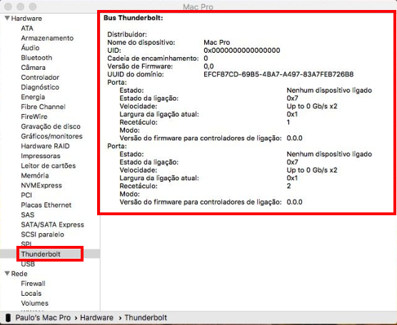

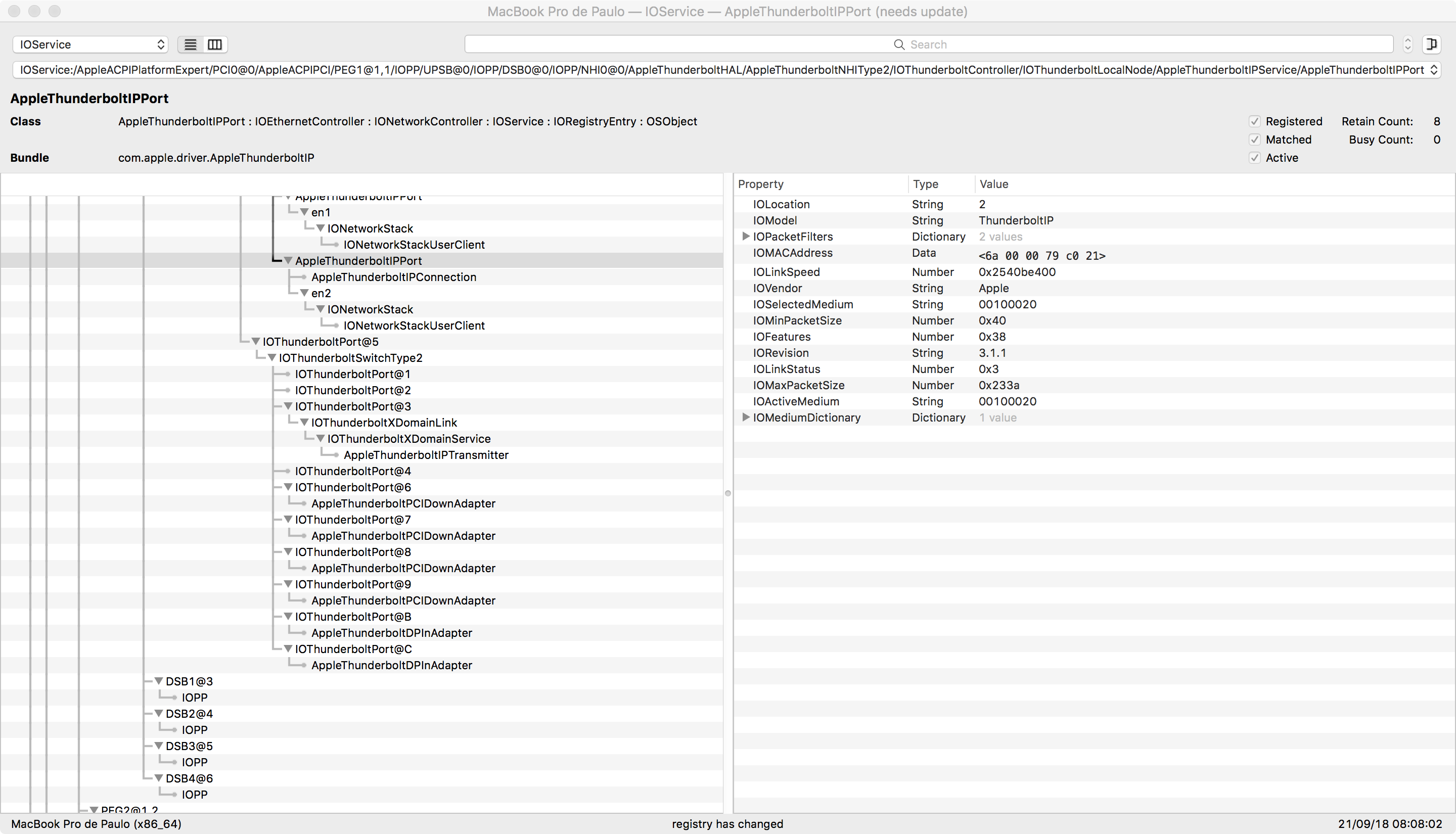

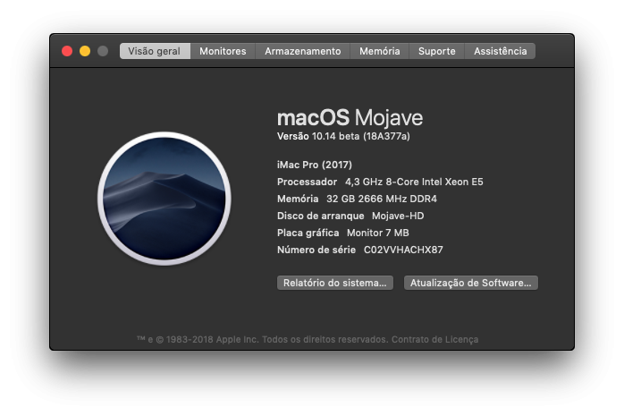

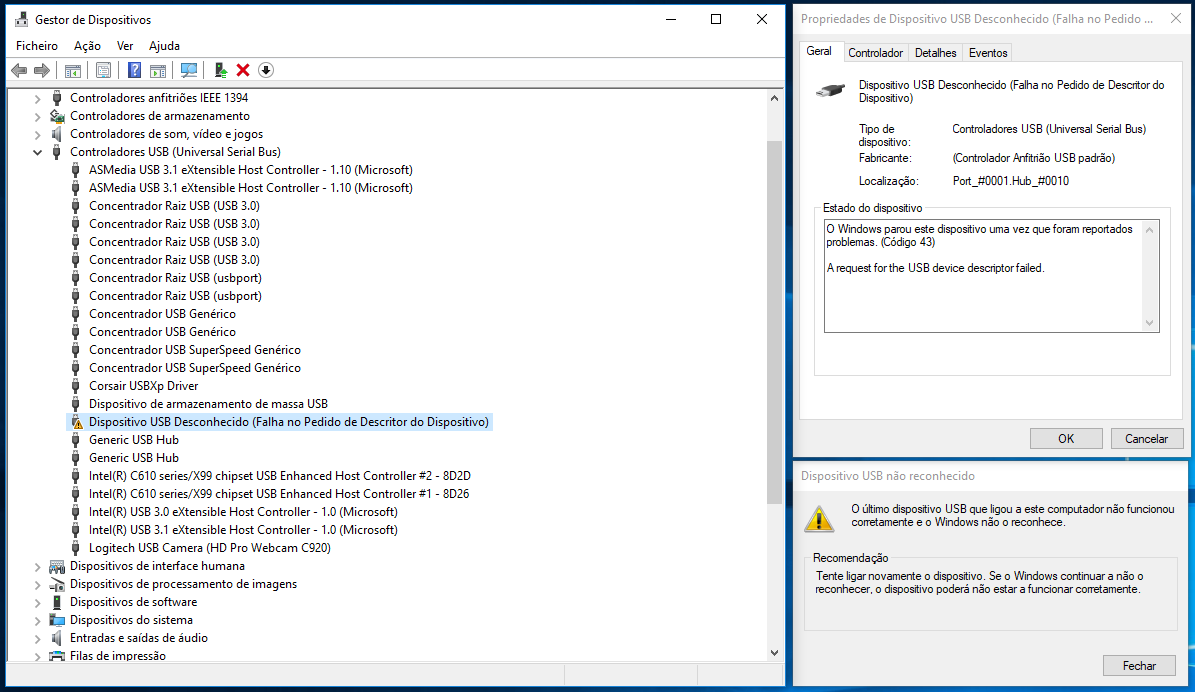

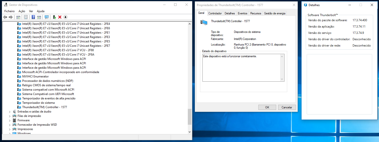

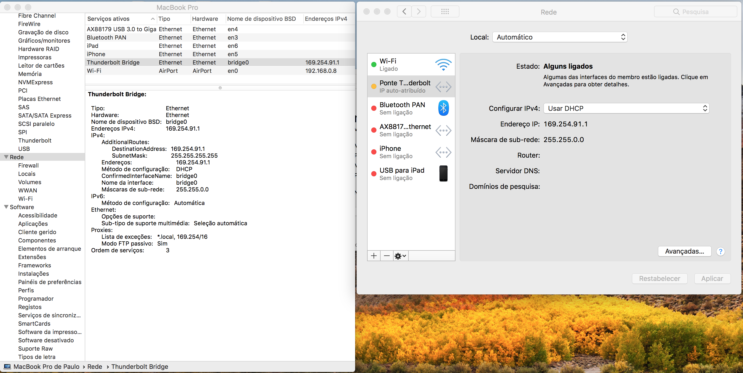

Hi Guys,

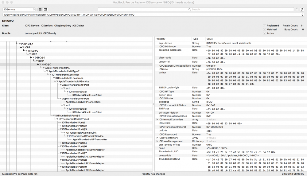

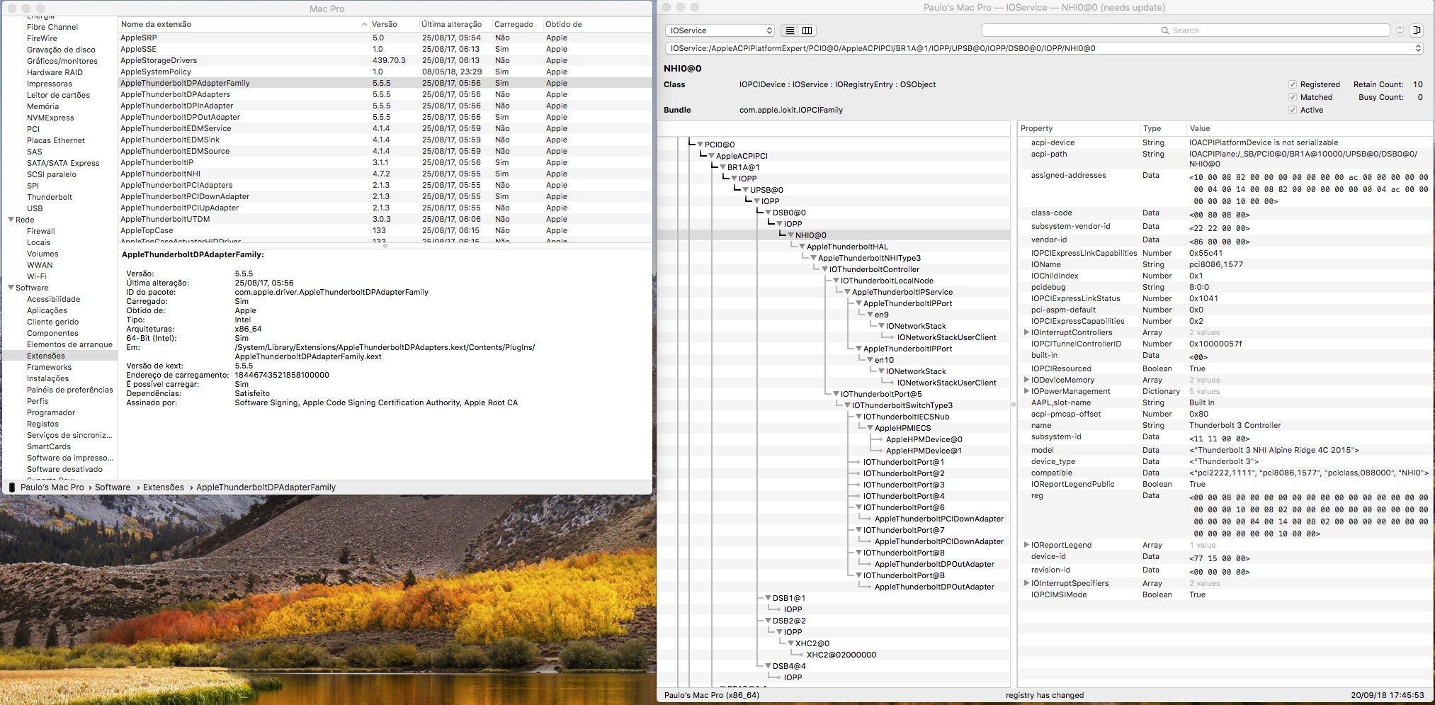

Suddenly my Asus TB3 card started to appear in System Info/Thunderbolt with a lot of thunderbolt kexts loaded!!!
For the very first time I've got:
  • 2 x Thunderbolt port information - although it seems no version info is gathered
  • 2 x Thunderbolt IP adapter detection - not in operation
  • Thunderbolt DP adapter detection
Now, I'm not sure if I have a damaged card, since it does appear in my Asus X99 Deluxe II BIOS fully configured, but as soon as I power off or reset the motherboard the PCIEX16_5 slot shows "Not Present"...
The only way to get it back is to power off (power off PSU!) for about 10 minutes and it then gets detected again by Macosx...
Unfortunately at the moment I on't have a working Win10 installation to test...
What do you guys think ? Damage TB3 adaptor or a "miracle" ? :wink_anim:
Send me Paulos-Mac-Pro.zip

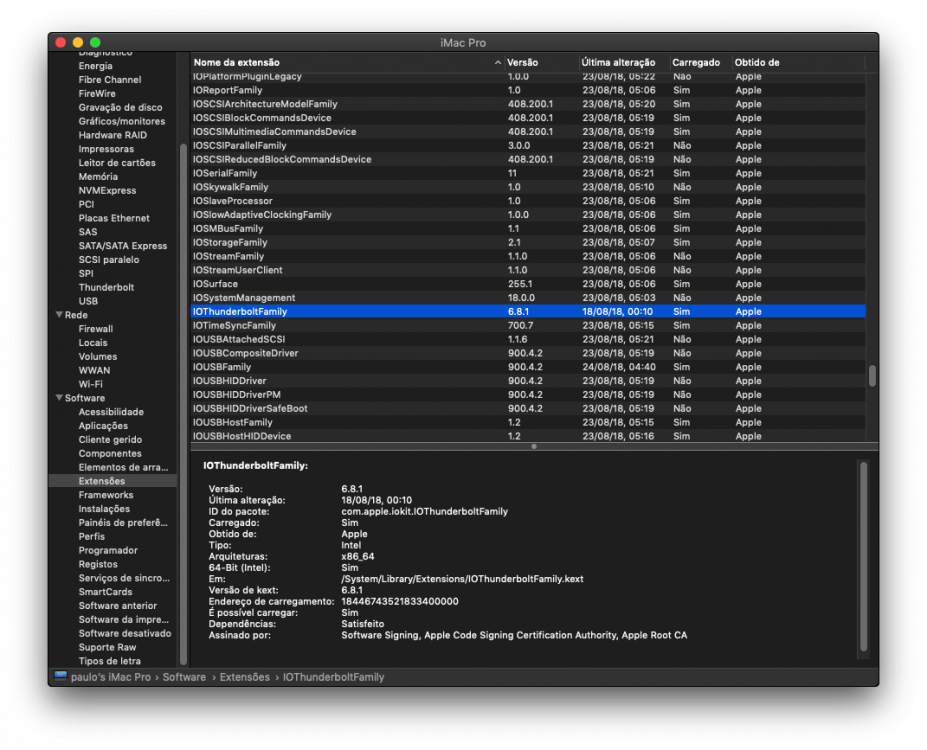

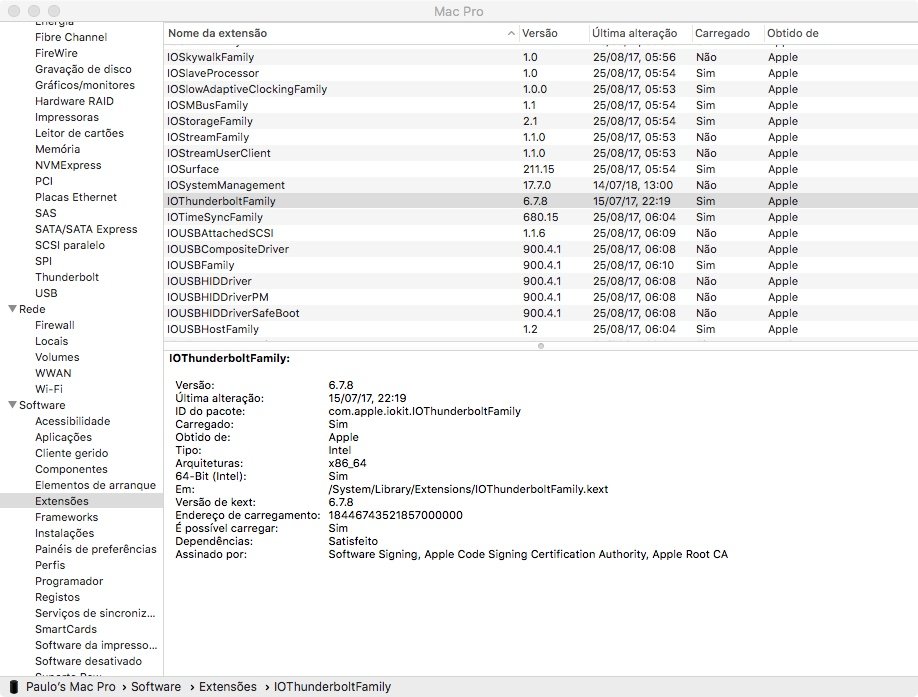

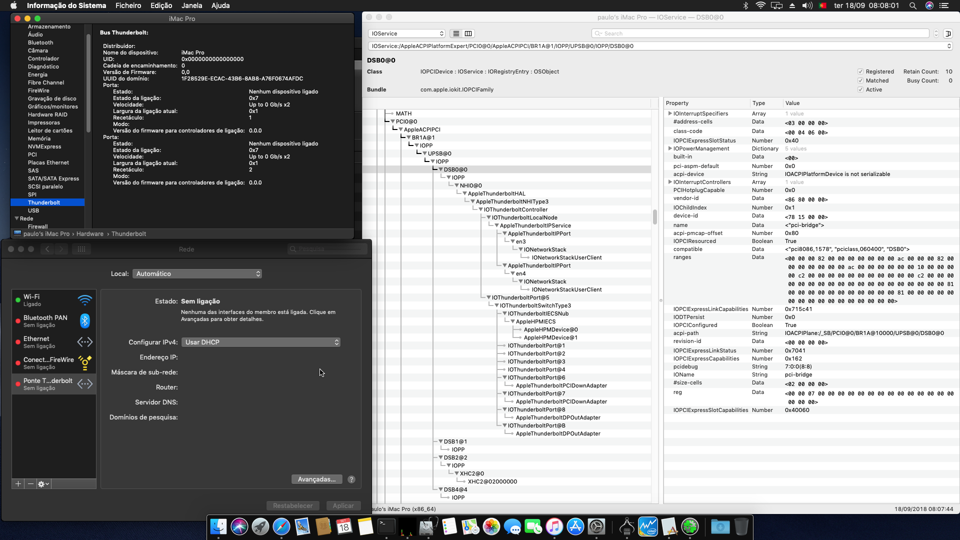

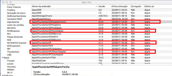

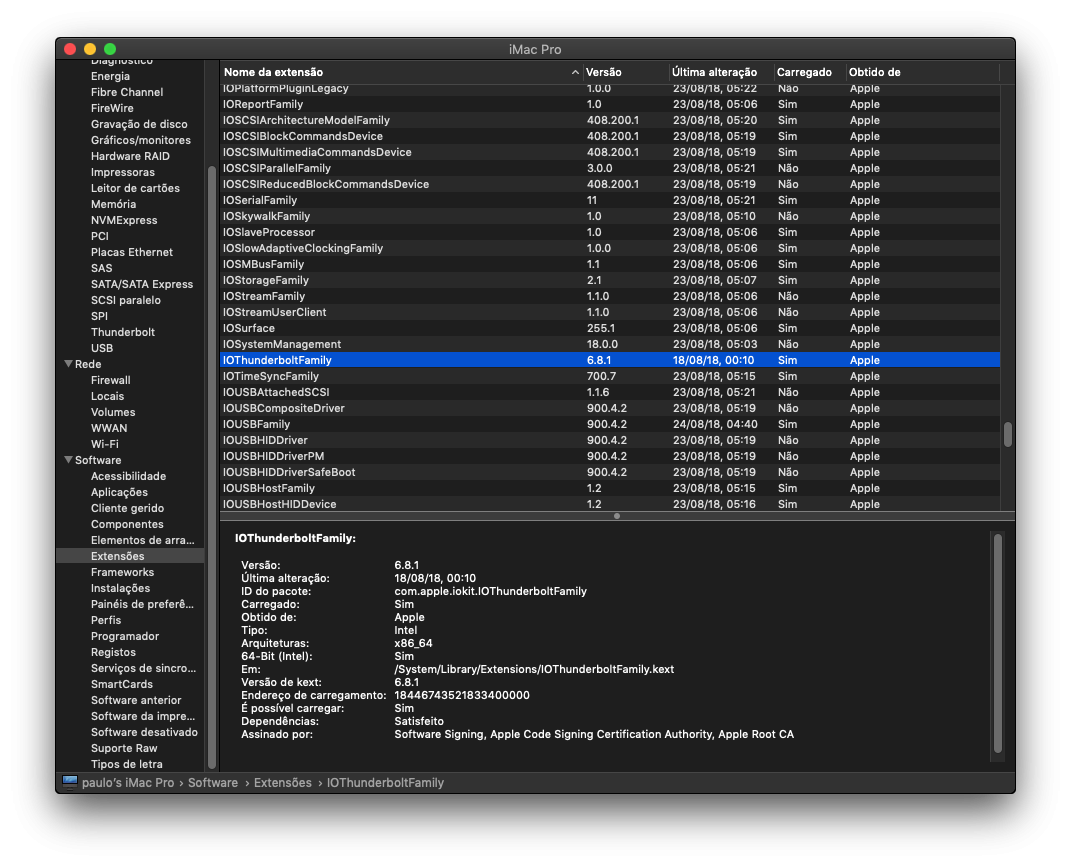

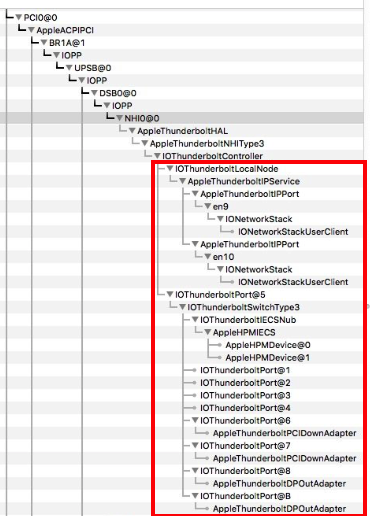

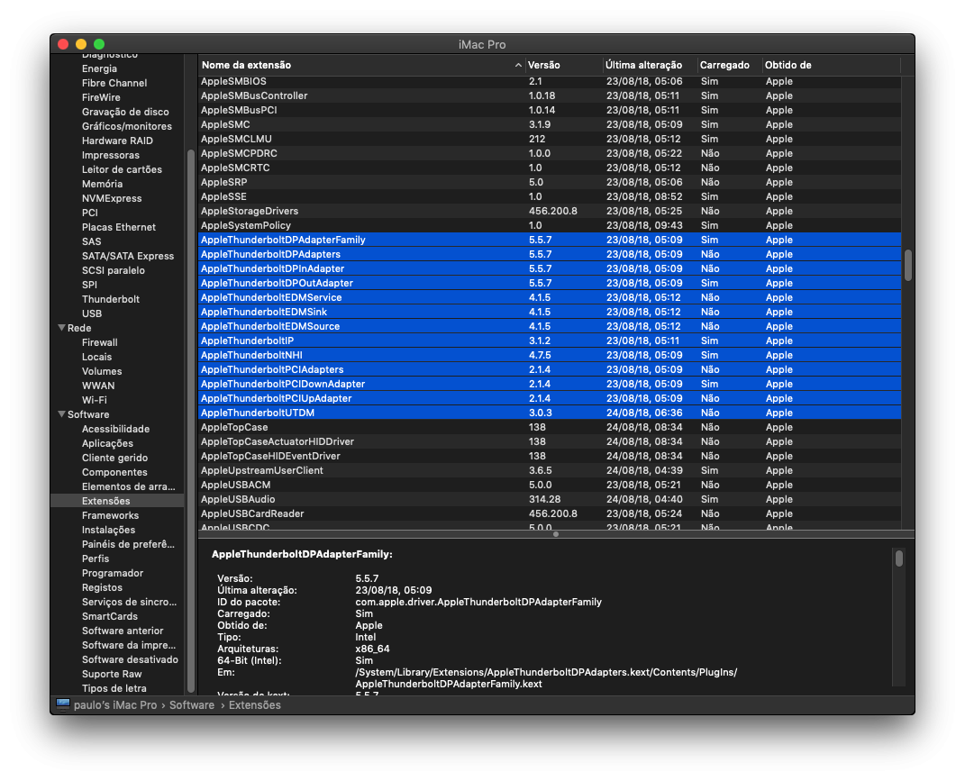

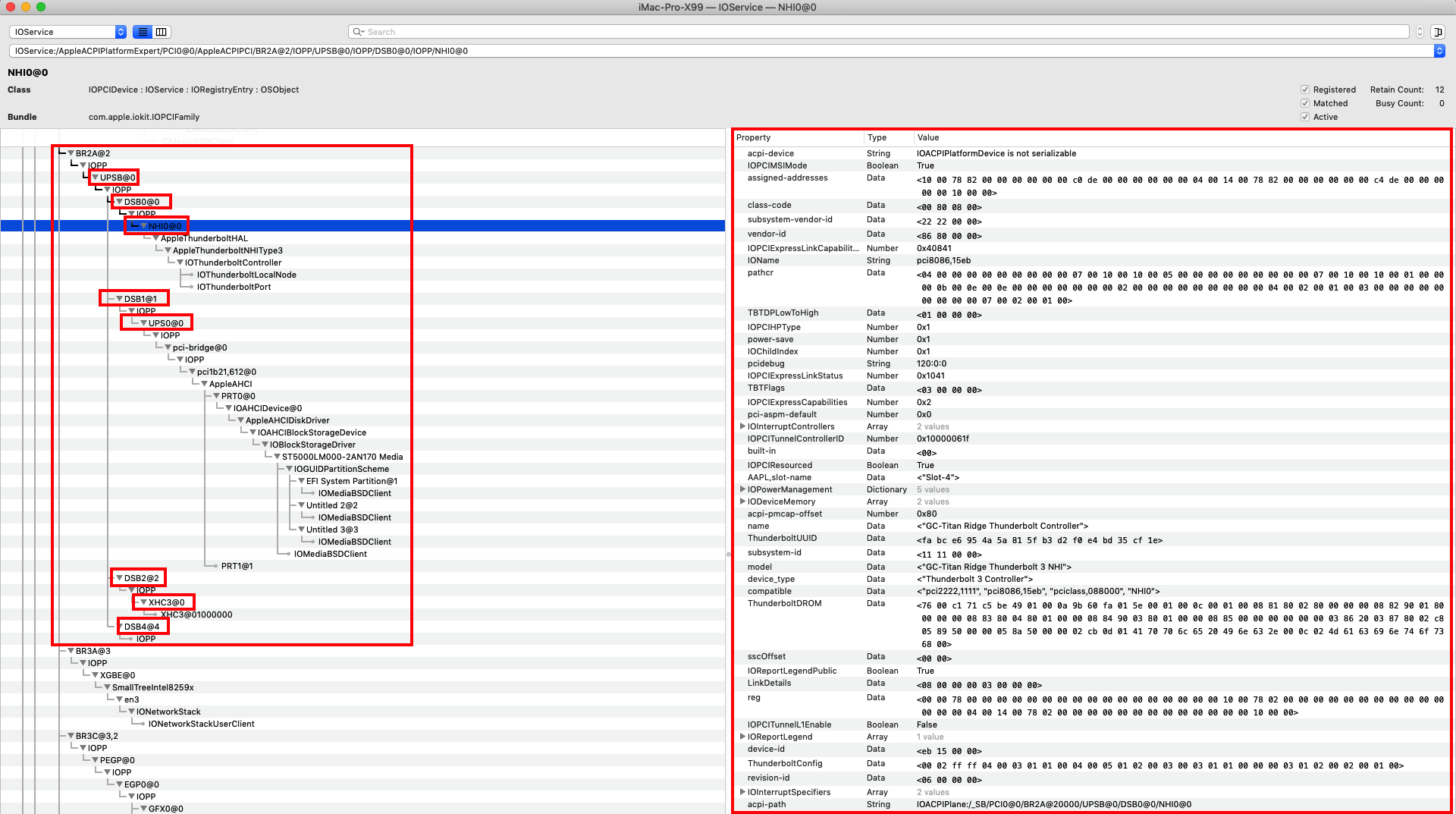

3 hours ago, augustopaulo said:
Hi Guys,
Looks rather like a miracle... or to say it in simple words... you are the one out of millions not affected by the virus... and nobody knows why.. :drool:
My goodness... you have a fully implemented local thunderbolt node
and even the thunderbolt bus driver loaded
While usually in TB Hackintosh systems only the IOThunderboltFamily.kext and ThunderboltNHI.kext are active, you also have the AppleThunderboltDPAdapaterFamily.kext, the AppleThunderboltDPOutAdapter.kext, the AppleThunderboltIP.kext  the AppleThunderboltPCIDownAdapter.kext active on your system..
Some TB kexts not marked in red are still missing though also on your system..
Anyway.. no idea how all this is possible without doing anything else then configuring the TB BIOS settings like we all did?
You do not even mention a SSDT, although I do not understand how you obtain without the latter the UPSB, DSB0, DSB1, DSB2, DSB4, NHI0 and XHC2 ACPI implementation..
Edited by KGP-iMacPro
Seems that @augustopaulo performs some DSDT patching... Now the question is where all this comes from?

anyway fail on our Hackintosh systems.. Noticeable, that in the actual DSDT.aml,  UPSB is also part of the  the_GPE implementation. The remaining TB DSDT patches seem to consist of a simple DSB0 and DSB2 "PCIHotplugCapable" property injection and the usual ACPI TB device definitions. In my opinion, nothing that could result in the TB miracle observed above.. :rofl:
Spoiler
Yes , yesterday night I compiled a SSDT with appropriate parts from this DSDT and no miracle...:cry:
( even with adjusting thunderbolt settings in bios)

I also wanted to bring my experience because I currently have the hotplug working properly without using strange tricks.
Gigabyte recently released an BIOS update for the Z370 motherboard, which adds compatibility to the new 9th Gen processors.
I had read earlier that the Z390 chipset would bring greater compatibility with the Thunderbolt connection, and I think this BIOS update brought some of these changes.
In fact now, not only do I have new Thunderbolt settings in the BIOS, but the hotplug also works perfectly with the THB_C header connected!
I have sucessefully connected an USB C ethernet PCi on USB C TB EX3  and internet connection 10/100/1000 was right pass through in.
Edited by Loloflat6

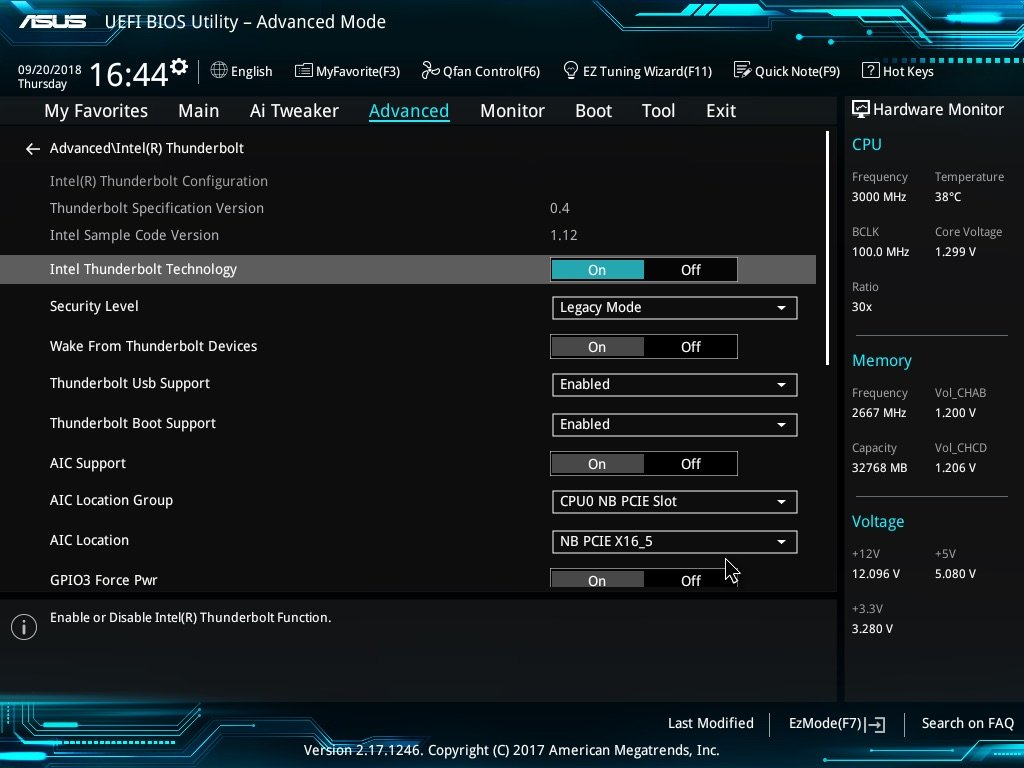

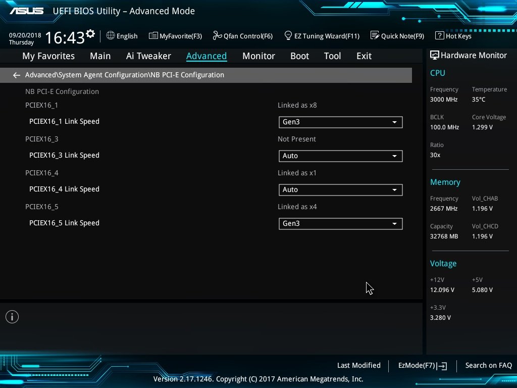

Hi Guys,
I still think that this TB adapter is not working properly since I'm not able anymore to successfully transfer data on a TB connection between 2 devices as before (my 1st post here), but has got something configure/misconfigured that somehow triggers the full TB detection from OSX, which is what is very impressive!!
Also agree with KGP-iMacPro, that I don't have any special configuration or settings from before...

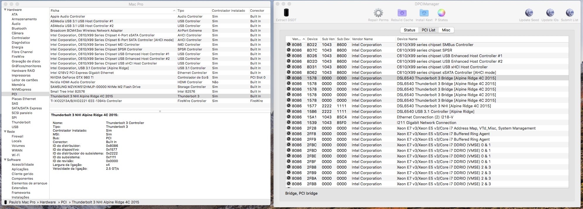

Anyway, some more testing that I did with this "miracle" Asus EX3 TB adapter:

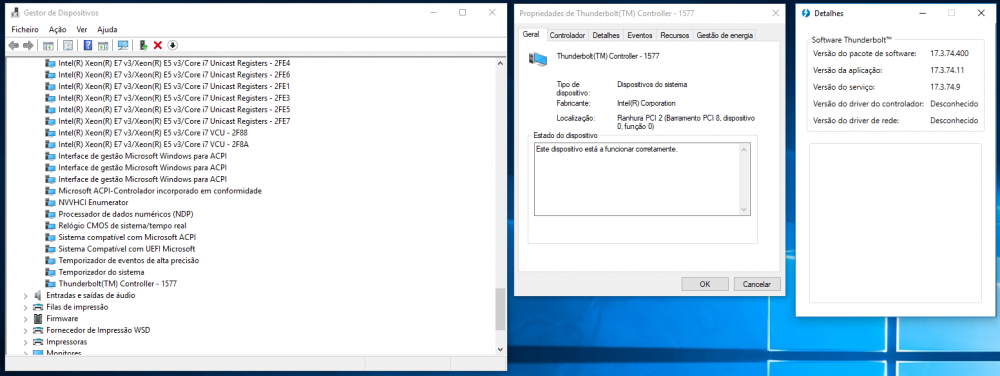

Windows 10 64bits:
On a fresh install, with latest ASUS drivers ver 17.3.74, the ASUS EX3 TB adapter is detected by windows but the ASUS TB SW doesn't detect any adapter (as per OSX) connected!
Also, a new USB device (associated with this TB adapter) is detected but the windows driver halted from starting with error 42!

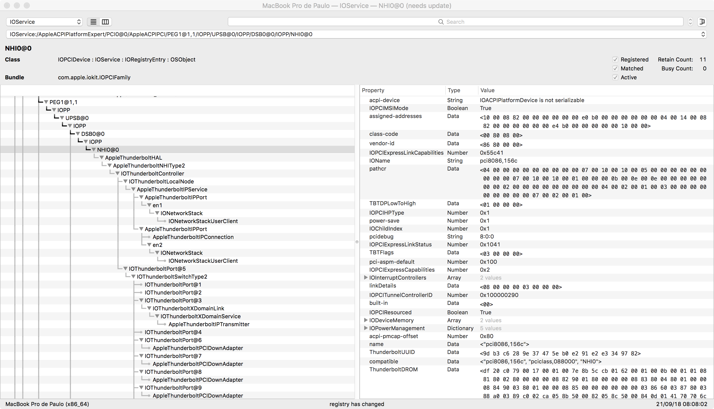

MOJAVE:
The same full TB functionality detection is achieved on MOJAVE beta configured as an iMac Pro -  so it does not seem to be OSX version dependent!
976701000_Capturadeecr2018-09-21s08_18_42.png.c74ca5f053832b9abc8788d2be66abd9.png1401391057_Capturadeecr2018-09-18s08_08_01.thumb.png.a8ad8e106a056e7998045b0be64c018a.png
576820536_Capturadeecr2018-09-18s08_12_32.thumb.png.3ebcd9ebb798d64ca74e2383899bb26e.png
Apple TB 2 cable connectivity testing:
In order to verify if my Apple Thunderbolt 2m cable (MD861ZM/A) is still functional, I've used 2 x MacBooPro's (2015 & 2016 models), with one of them with Windows 10 64bits (bootcamp) through this cable and I can transfers files at a blazing 20GB/s speed between the 2 x MBPs!
425418901_ThunderboltCablebetween2xMBPretina15.thumb.png.a30f4861c7e0eb35b19d8b0a2d3f9949.png1913928987_ThunderboltCablebetween2xMBPretina15-2.thumb.png.697e51ad8c29ed43619e72f5e23b41d9.png
CONCLUSION:
If I can no longer connect 2 devices via TB connection using my Asus EX3 TB adapter, I'm going to check its warranty and request for a RMA or, maybe consider the next intel TB 3 card with chips set JHL 7xxx series (apparenty with latest MBP 2018) link:

3 minutes ago, KGP-iMacPro said:
@augustopaulo, I rather think the opposite!
This adaptor or your current configuration might be a unique opportunity to shed new light onto the entire TB Hackintosh story.. we just don't know yet why and in which way. The only thing I would like to ask you: please never return it to the manufacturer until we deeply investigated cause and effects of your recent discovery..
Generally I don't think that it is a good idea to mix things between Windows and macOS.. Don't forget that we are dealing with UEFI.. thus specific settings under some certain operating system might affect the adopters functionality in the other operating system. Me myself many times I even reached to a situation where the removal and replugging of the adopter was the only possibility to make the adopter work again under any system.
Thus please, once more don't request any RMA for the adopter. It is a 50$ investment that could change many things! I rather encourage you to purchase a second adopter to see whether or not you would be able to replicate the same effects with an else unchanged system configuration.
Hi KGP-iMacPro,
Point well made.
I won't return it/RMA, I promise!
Now, tell me (& others) what do you want me to further test this Asus TB3 adapter, ok ?
1 minute ago, augustopaulo said:
Hi KGP-iMacPro,
Point well made.

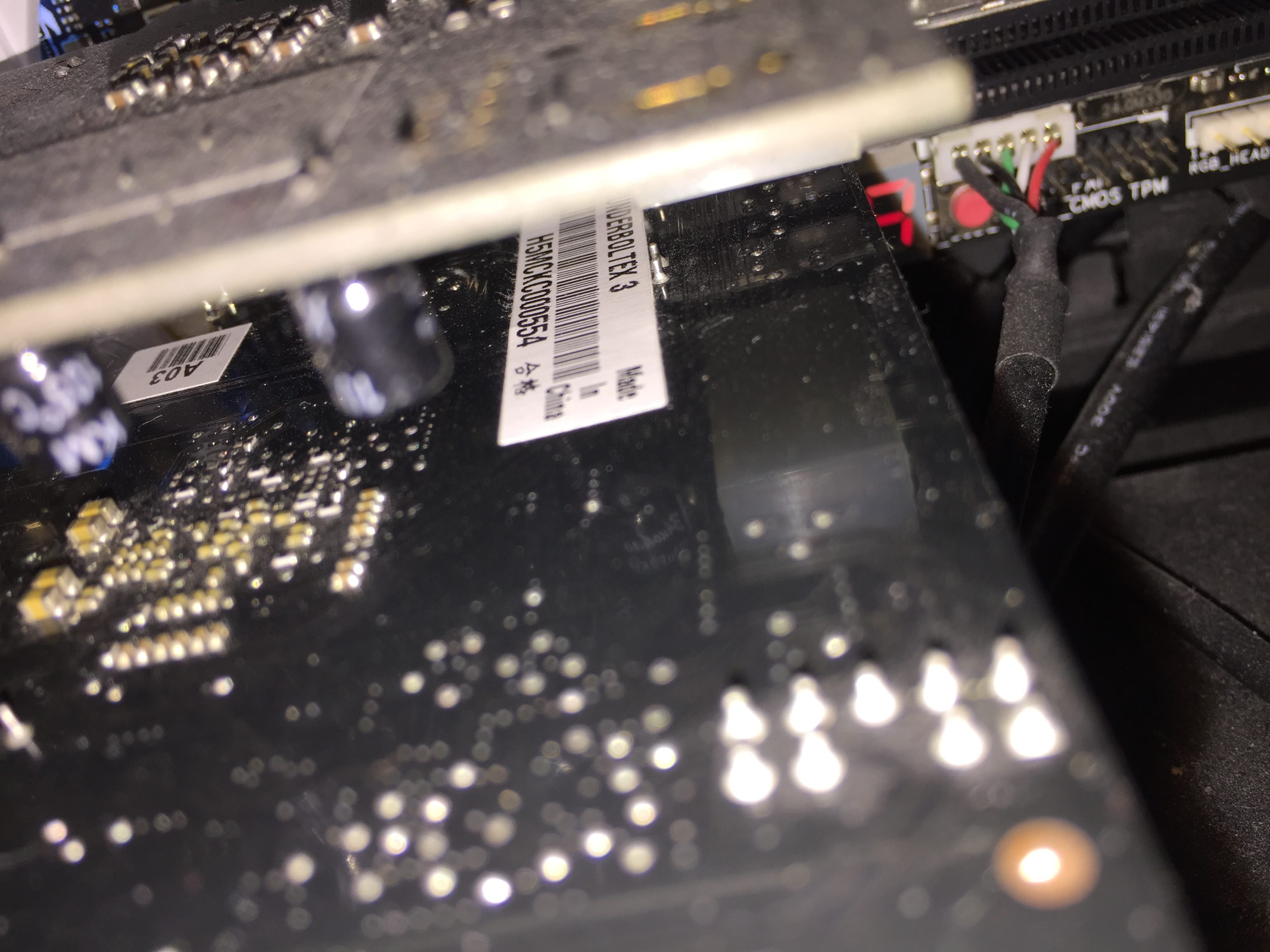

12 minutes ago, fabiosun said:
Have you connected tb header cable?
Rev 1.00 on your PCB card is visible?
Thank you
Yes, header cable always connected.
As for version, see if you can see it from the 2 photos I've taken.. (my son is using the PC for now) and don't look at the dust!!:blush:
But, later today I'll take it out an take proper pictures...
Pictures are fine..it is rev 1.00 as mine

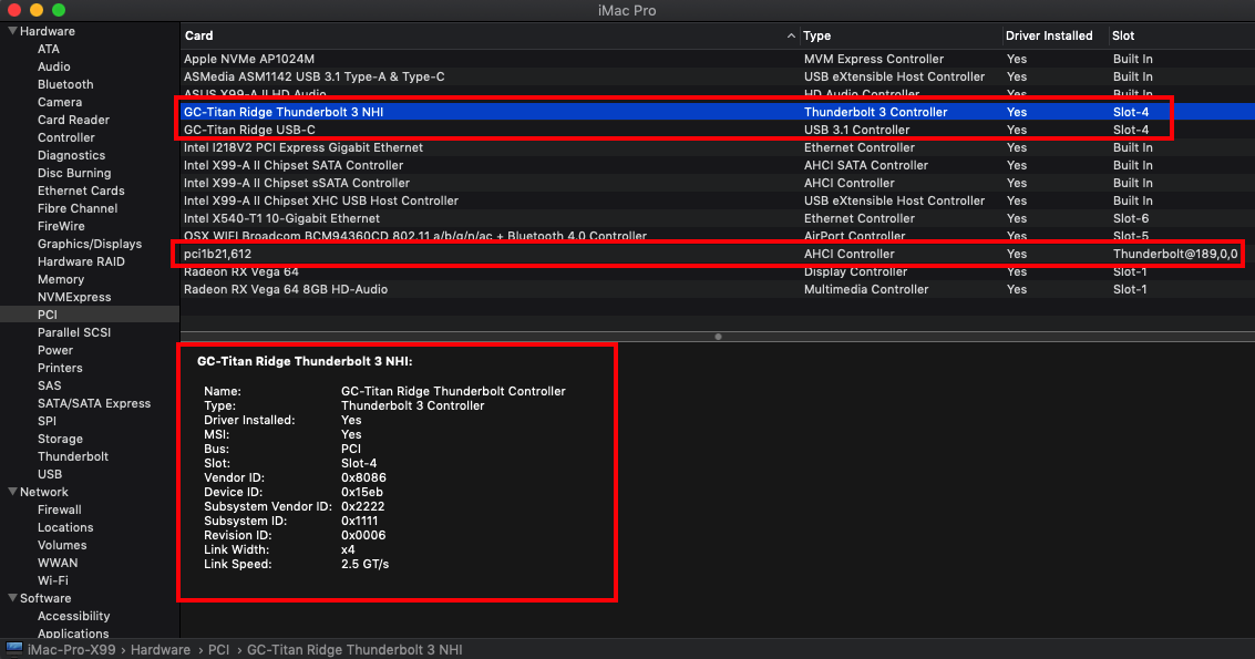

GC-Titan Ridge 40GB/S Intel Thunderbolt 3 Certified Add-in Card fully functional under macOS!
GC-Titan Ridge working OoB under macOS 10.14 Mojave with SSDT-X299-TB3HP-TTR.aml and SSDT-X99-TB3HP-TTR.aml :superman:
GC-Titan Ridge Features:
2x PCIe 6pin power connectors
1x USB2.0 Header Cable
1x THB_C Header Cable
2x mini-DP 1.4 input
2x TB3 out
1x DP 1.4 out
GC-Titan Ridge macOS Implementation:
897843326_Screenshot2018-09-24at15_35_06.thumb.png.df12ec41e0f790acaa09c14a52c32d1a.png
424265117_Screenshot2018-09-24at15_34_42.thumb.png.74d60c0eb7abe84b1d8038560577dc9d.png
Gorgeous! :plane:
Enjoy and have fun :thumbsup_anim:
