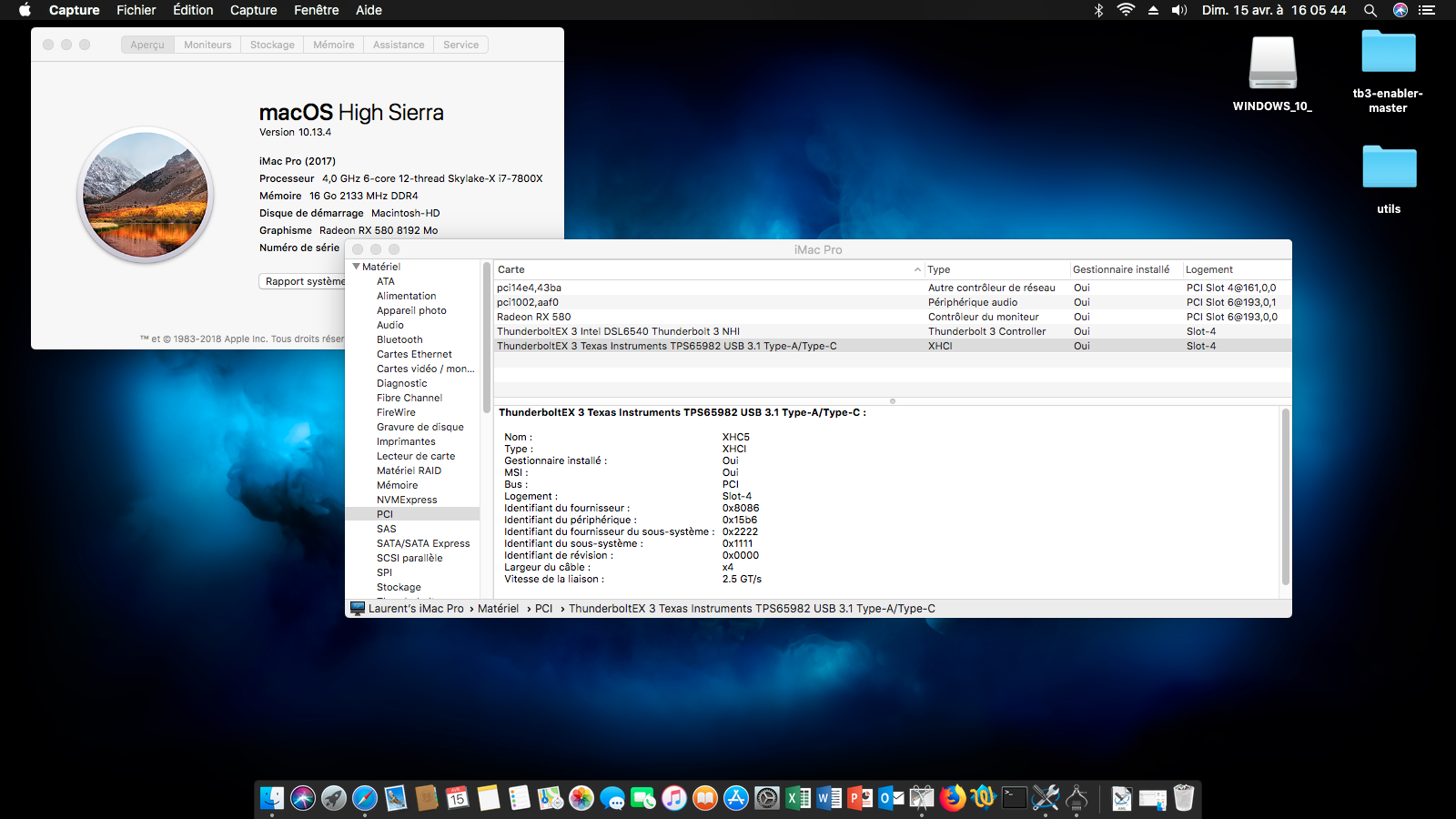

:) All right now : I have taked delivery of my new TBEX3  this afternoon : plugged and all is fine at startup, screen plugged on USB_C
My Settings recap :
1/ Bios recommended parameters for Thunderbolt + Pci devices set as Legacy
2/ I added arbitrary lines on my config.plist ( Thanks @Matthew82.)
<dict>
				<key>Comment</key>
				<string>THUNDERBOLT 1577</string>
				<key>CustomProperties</key>
				<array>
					<dict>
						<key>Disabled</key>
						<false/>
						<key>Key</key>
						<string>model</string>
						<key>Value</key>
						<string>Thunderbolt EX3</string>

3/ my SSDT
SSDT-TB3U2.aml.zip
4/ I have updated the drivers for TB3 on Windows 10 with the last one.
Edited by Loloflat6
If you use the ssdt the arbitrary inject are not needed because PCI-Thunderbolt One is already present on the ssdt under UPSB ;)

Sleep / wake :
- Sreen on USB_C
- HDD or USB on USB 3.1
But I have not PCI device to try sleep/wake on USB 3.1
I can eject the HDD or USB on USB 3.1 and replug it.
My SSDT is according to my IOReg

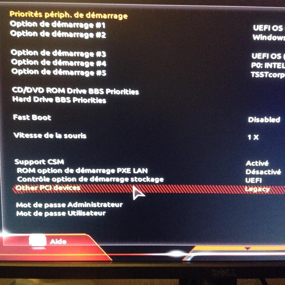

What do you mean by setting PCIe devices as legacy ?
On GA  mobos  this setting ;
