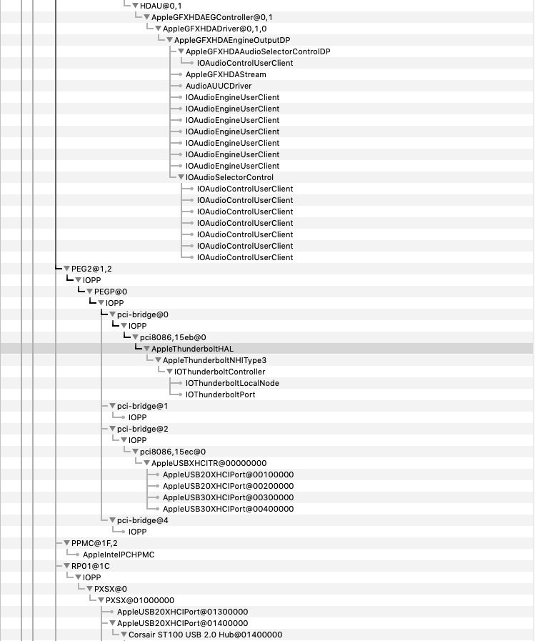

!!! There seems to be good news for REAL Thunderbolt live HotPlug/HotSwap functionallity while your Hackintosh is running !!!
I found a solution with just 7 rows of code within any of your Thunderbolt-SSDTs (you are just using right now to make it work) to make HotPlug/HotSwap work for any Thunderbolt/USB-C device possible w/o the need for shutdown/restart of the machine.
Right now i still test it with some german guys to make sure, it runs on any motherboard (not just ASRock Z3x0 like mine). If all tests confirmed it working succesfully, i promise, i will provide you with a detailed
instruction on how to make it work.
And SORRY, it's still a solution for HotPlug/HotSwap with Thunderbolt, it's NOT a solution to make Thunderbolt-tree visible under Systeminformation/Thunderbolt
So far you will find attached an IORegistryExplorer file of my System connected with CalDigit ThunderboltStation 2 connected to CalDigit ThunderboltStation 3 on Port #1 of GC Titan Ridge PCIe Card and a LaCie Tb2-SSD connected to Port #2
I just swapped the Devices on Port #1 to Port #2 and vice versa while runnning my machine - not turning off/on before swapping. You will notice this in the IOReg file by the red parts within Thunderbolt Part at PCI0-PEG2. RED lines mean
in which position the TB-device was connected before HotSwapping it to the new position, black lines mean where it sits right now.
Just a little notice: TB-SSDs/TB-HDDs need to be unmounted before hotswapping - otherwise you will get error message of not correctly unmounted device  ;-)

Want real Thunderbolt HotPlug/HotSwap on the fly while your Hackintosh is running? Well, than this might be your solution:
I have tested a lot of so promising Thunderbolt HotPlug SSDTs out there and none of them provide a working solution for me, so i decided to spend some time on a working solution for real Thunderbolt HotPlug/HotSwap,
where you can change your Thunderbolt devices on the fly w/o restarting your Hackintosh every time you connect/change a device. Also this tutorial will work for motherboards with onboard Thunderbolt as well as for motherboards with Thunderbold Header connector.
Ok, lets start how to make it work:

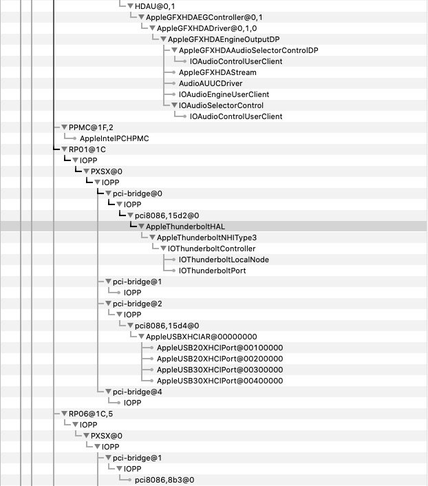

as in many other threads the first thing you have to know is where your Thunderbolt hardware belongs in your ACPI path. To find out where it belongs, just open "IORegistryExlorer" while bootet normaly into macOS. Than search for some entrys like this:
Sample of ASRock Z270 Super Carrier:
Sample of ASRock Z370 Professional Gaming i7:
Just for explanation: ASRock Z270 Super Carrier used builtin/onboard Thunderbolt 3, while ASRock Z370 Professional Gaming i7 uses Thunderbolt Header and a GC Gigabyte Titan Ridge PCIe card for Thunderbolt 3.
As you can see for the Z270 the ACPI path looks like RP01/PXSX, while ACPI path for Z370 looks like PEG2/PEGP. Rememeber these entrys for later modification when it comes to edit the Thunderbolt SSDT file.

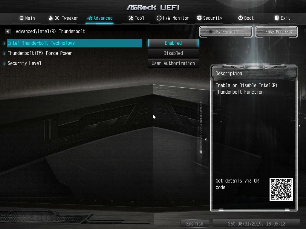

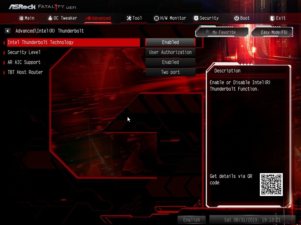

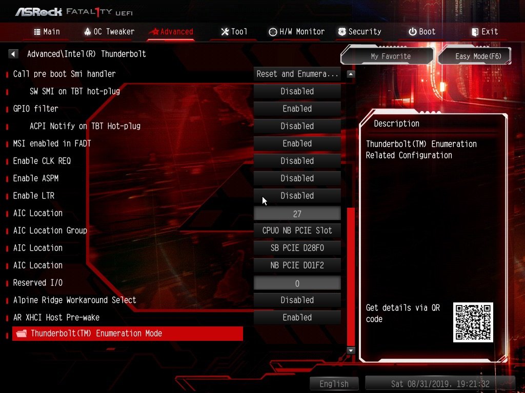

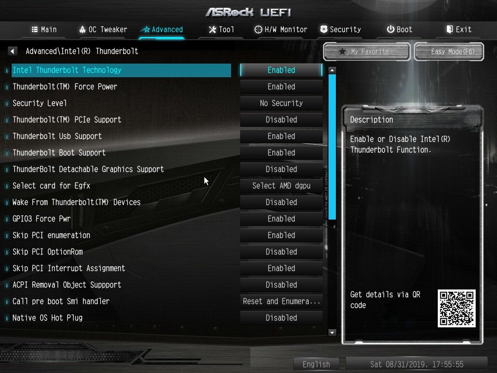

Second: lets set the right BIOS settings for working Thunderbolt HotPlug/HotSwitch
Lets take a look at the default BIOS settings for the given two sample motherboards  ASRock Z270/370. The following screenshots shows their default settings for Thunderbolt when you install their latest BIOS revisions:
standard BIOS settings ASRock Z270 Super Carrier:
standard BIOS settings ASRock Z370 Professional Gaming i7:
These are all settings for Thunderbolt given by default from ASRock on their Motherboards. But there are even more settings for Thunderbolt within their BIOS files, which need to be "unlocked"* first. After doing so, there might be a lot of more settings, like this:

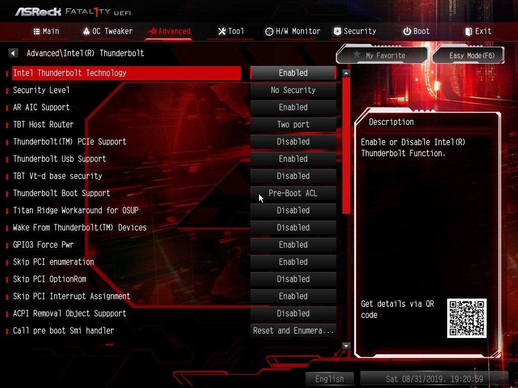

ASRock Z270 Super Carrier all settings unlocked:
Z270_TB_modified_1.thumb.jpg.106f4245a64a5fc4f09e4d8b6270de6f.jpg - Z270_TB_modified_2.thumb.jpg.e3101d909efcf79dba09600dd03df6ec.jpg
ASRock Z370 Professional Gaming i7 all settings unlocked:
Z370_TB_modified_1.thumb.jpg.c7e2408840ff972b27a7c89da2124ba9.jpg - Z370_TB_modified_2.thumb.jpg.b50662c246755a607b85cacb16a125d3.jpg

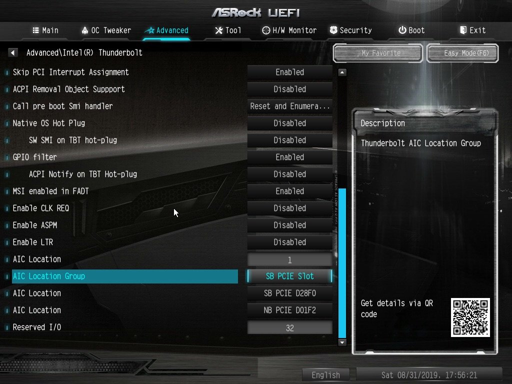

To make HotPlug/HotSwap working for your motherboard, just look for similar settings in your BIOS for Thunderbolt and set them as shown in the above screens. Sorry, i could only provide screenshots from ASRock machines, cause i do not have any other manufacturer.
The most importent settings you need are "Thunderbolt (TM) Force Power" (which not all boards will have) and "GPIO3 Force Pwr" (which i recognized allmost every manufacturer will have in their BIOS settings for Thunderbolt). Just set these two settings to "ENABLED". <--- otherwise HotPlug/HotSwap will not work as expected.
Also important is to switch a setting called "AIC Location" from "NB PCIE D01F0" to "NB PCIE D01F2". Notice: on Z270 Super Carrier i had to set this setting from NB PCIE D01F0 to NB PCIE D01F2 while on the Z370 Professional Gaming i7 it was set to NB PCIE D01F02 by default. If all settings set as described, save your settings and restart your Hackintosh.

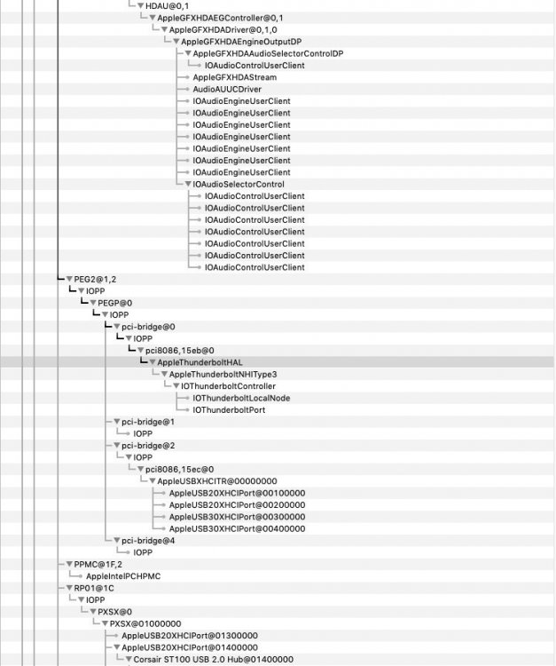

IOReg_allTB3-Devices_I_have.zip
