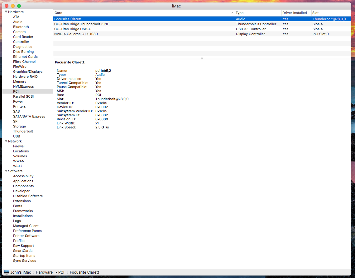

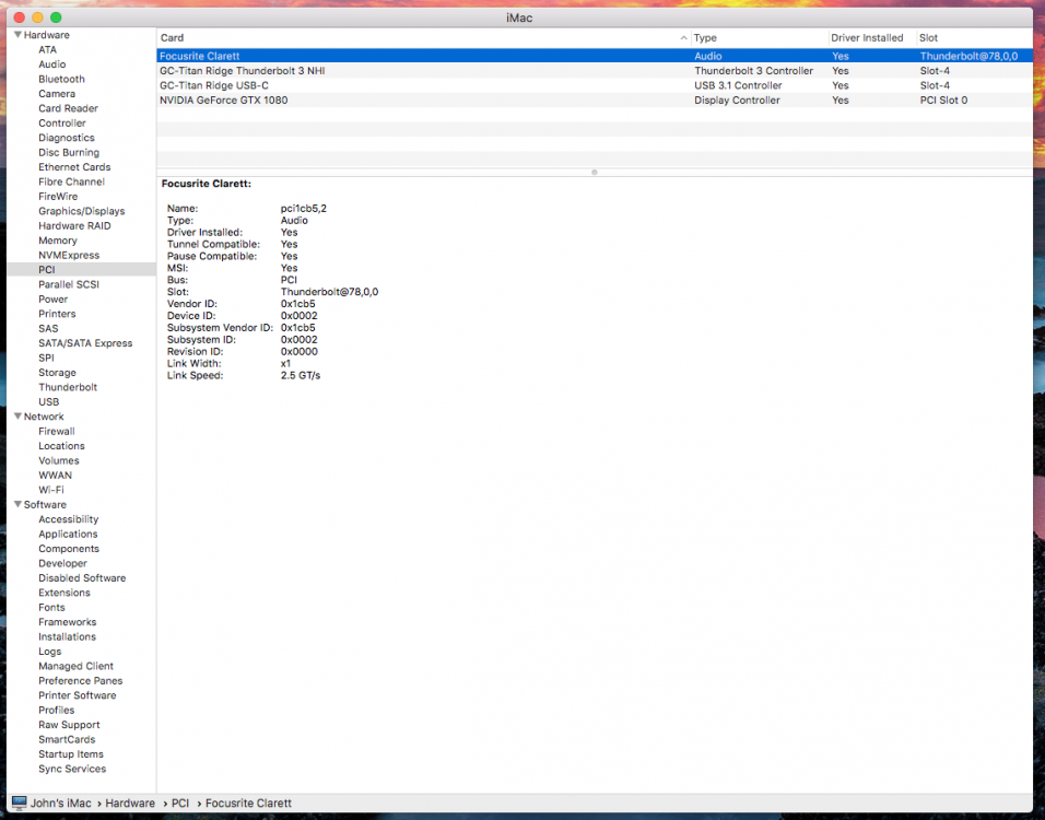

That definitely did something.  My Alpine Ridge now shows up as a Titan Ridge (although, that may just be cosmetic).  My PCI section is definitely different/shorter.
Unfortunately, hotplug still does not work.
Here's a new IOReg (with both those .amls applied), my EFI folder, and my PCI Screenshot.   I had to remove the files in the 'APPLE' folder from my EFI.  They were huge for some reason (24mb)?
IOReg.zip
EFI.zip
You are still missing the TB NHI driver to be loaded under "PCI", although following your actual IOREG save, everything else seems now properly implemented. BIOS settings?
Edited by KGP-iMacPro
You're right.  That's gone now too.  With the other SSDT I was messing with, the 'NHI' driver was showing up.  Now it's definitely not.

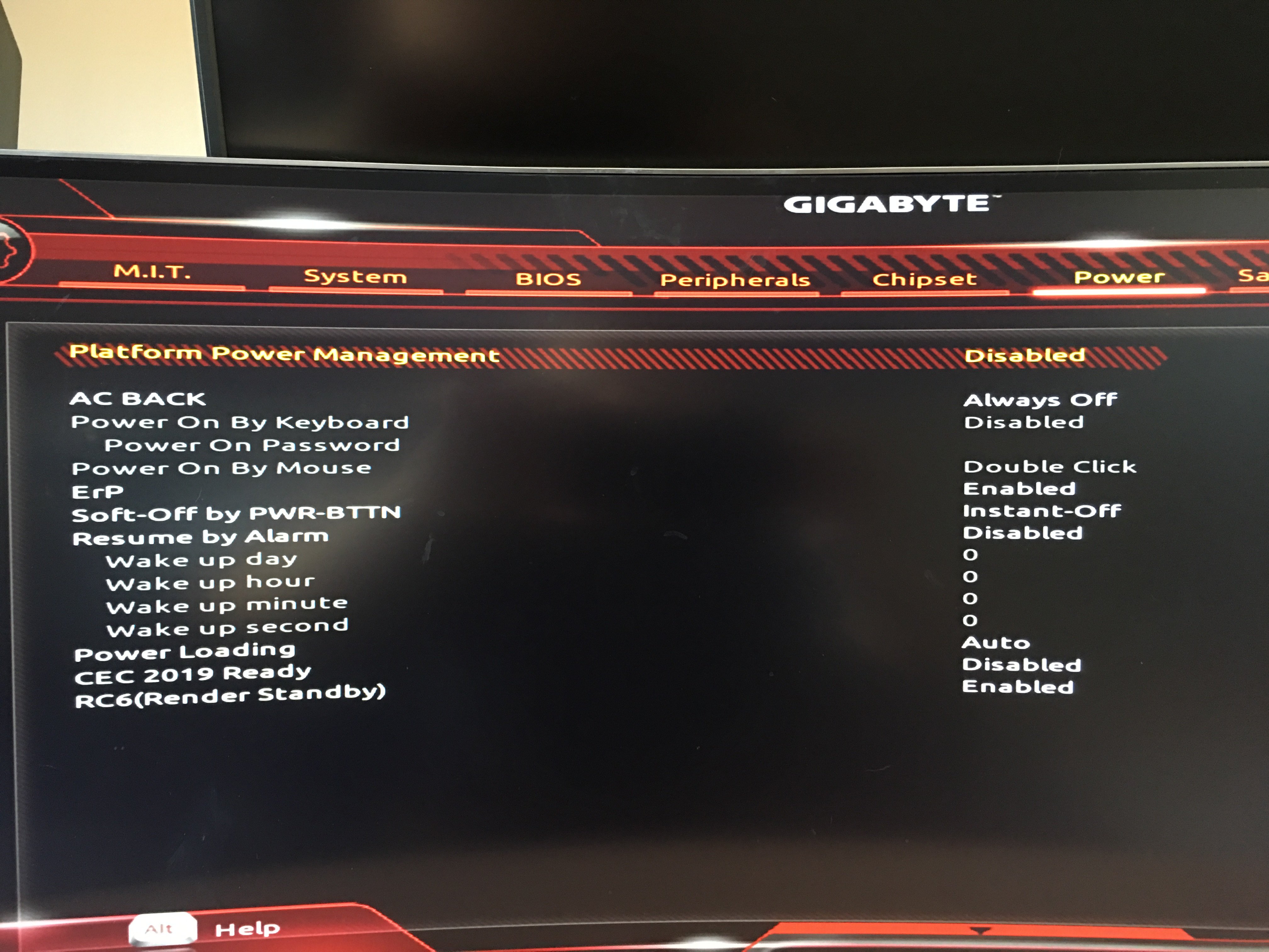

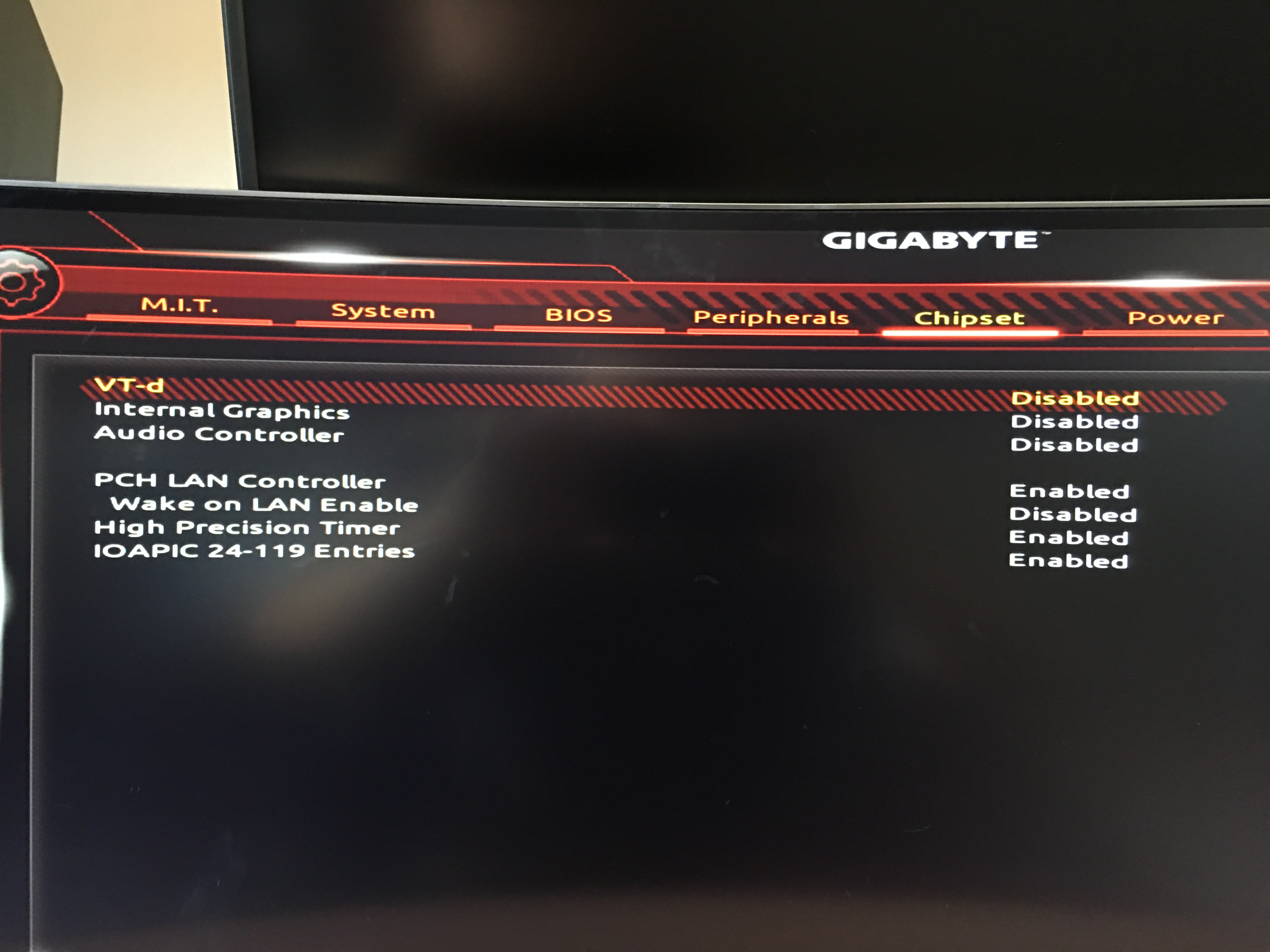

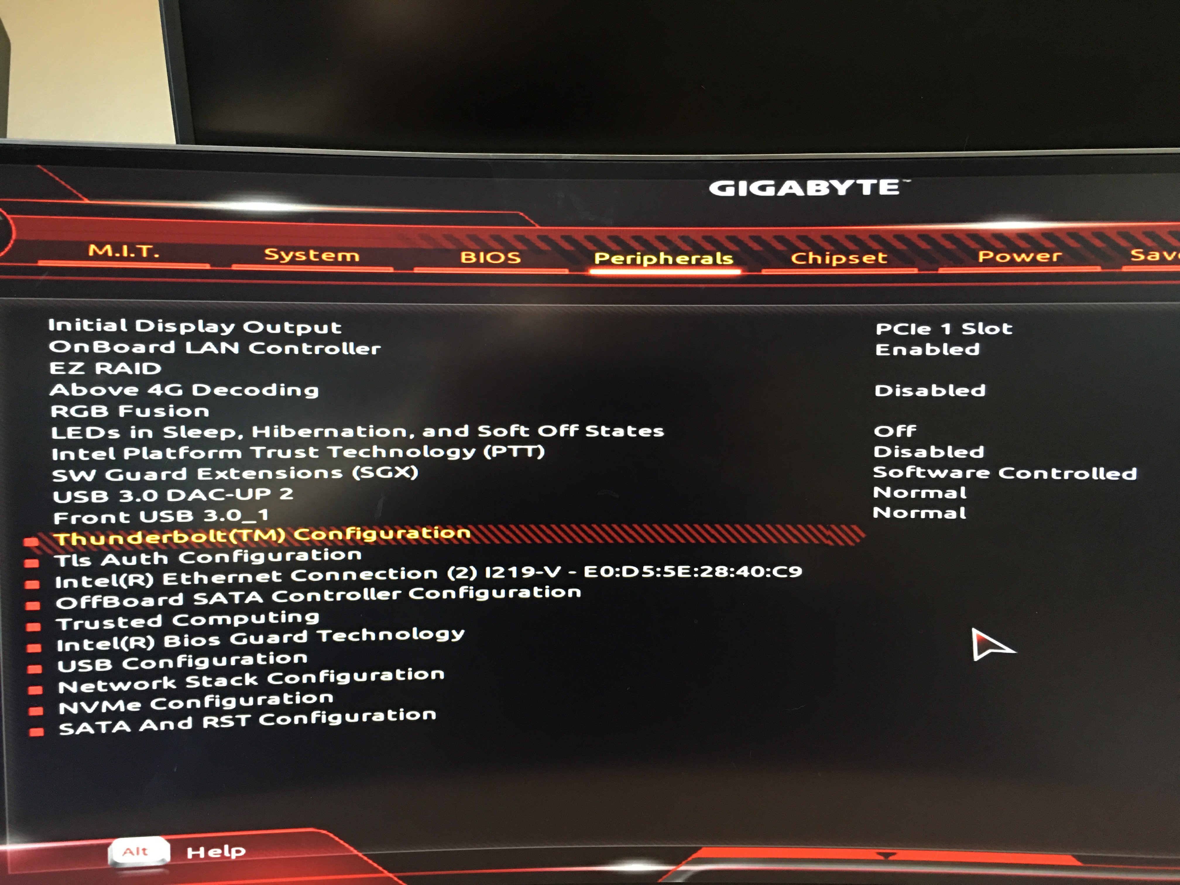

I think BIOS settings are okay.  I've attached some pictures of the various sections:
The Thunderbolt Enumeration Mode is set to 'Legacy'.  I tried to include a picture of that, but ran out of space on this post.

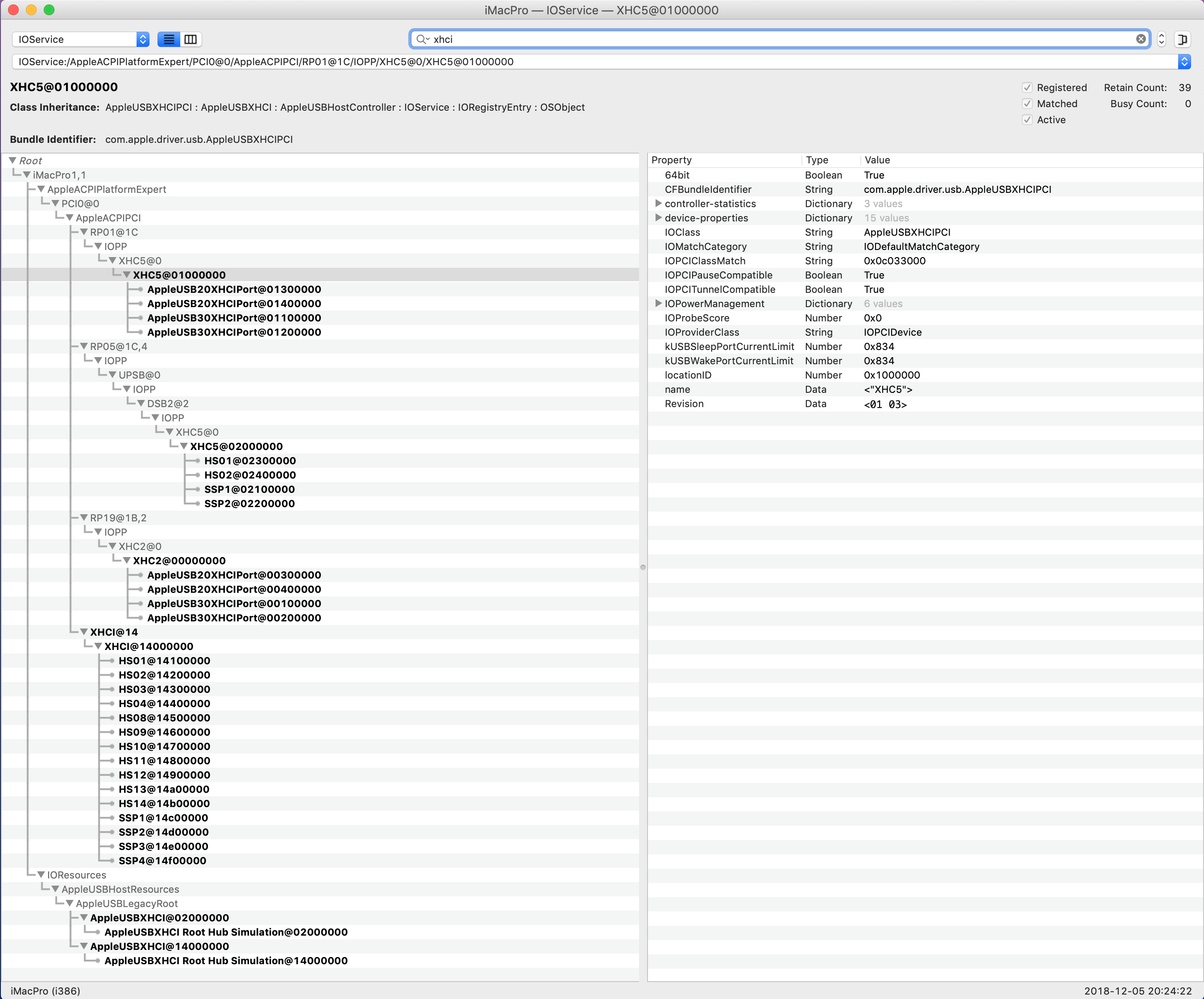

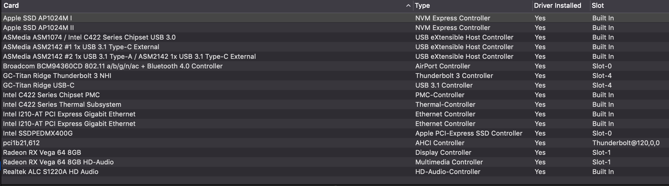

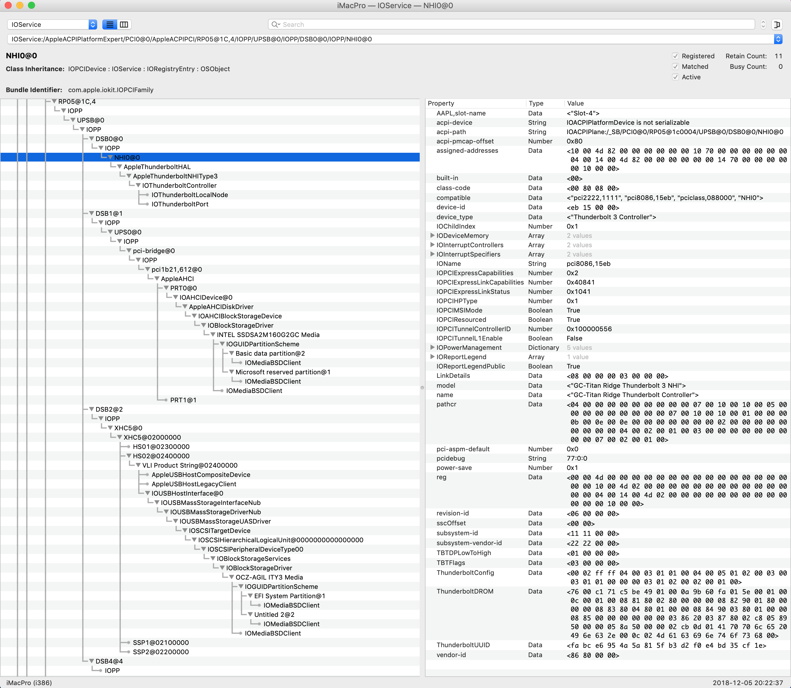

Ok guys.
After switching my Titan Ridge from PCIE_ 16x2 to PCIE_4x1 slot on my mobo with connected USB cable I can confirm that KGP:s SSDT-X299-TB3HP-TTR is reconnecting to my thunderbolt and USB-C device after sleep without first ejecting with no issues and no black screen. As a bonus fully loaded bus drivers and some other cosmetic stuff.
Obviously this has something to do with witch PCIE slot my TB3-card is connected. With the card connected to PCIE_16x2 only @maleordebride:s  SSDT-TB3 was reconnecting to booth USB-C and TB device (with TB2 adapter) after sleep without any need to first eject and no black screen after sleep.
SSDT-C422-TB3HP-RP05-TTR.aml
Edited by obus
1 hour ago, obus said:
Ok guys.
A result that is just obvious. Always one needs to adjust ACPI path and ACPI replacements in concordance with his /her mobo and slot population.
