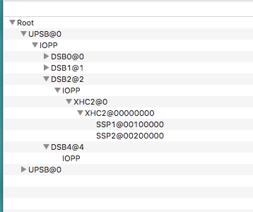

@maleorderbrideTrying to figure out why USB-C doesn't work (at all) with the ASRock TB3 card on the ASRock x299 Professional Gaming 9 XE board (it was working perfectly with the Gigabyte x299 Gaming 7 Pro).
How did you determine the address of the various SSP1/SSP2 and HS01/HS02?
Looking at the ioreg of a real iMac Pro, there's nothing other than SSP1/SSP2
The addresses are also showing as SSPS@00100000, the real ACPI device UPSB.SDB2.XHC2.RHUB.SSP1 was _ADR = 0x03 and _ADR 0x04.
On the ASRock it becomes SSP1@02100000 and SSP2@02200000 (the address of the SSP1,SSP2 however is 0x01 and 0x02 respectively)
The iMac Pro uses the same TB chipset as the ASRock card (or the GB rev2): pci8086,15d2
My setup is very close to what the iMac Pro uses:
iMac Pro: PC02.BR2C.UPSB
ASRock: PC02.BR2A.UPSB (using renamed PEGP)
Any pointers?
Thanks
Any pointers?
Thanks
I took the values from PikerAlpha's blog, but I also posted where he derived them from (published APCI specs) that are freely accessible (page 4 or 5 of this thread).
Copying the iMacPro makes the most sense to me, so why not try cutting the HS01/02, and change the 0x81 in the PLD's to 0x82. I'm not sure about the other values in the PLD buffer as the ACPI specs don't define what Piker chose to do there. The specs do offer other examples you could try though.
Perhaps you should change your devices to match your actual ADR's found in a raw ACPI dump. My USB 3.1 device was at 0x00020000 so I inserted that device at DSB2 (the MacBookPro13,3 had the same pairing of 0x00020000 with DSB2 for it's 3.1), but perhaps your need to adjust the location or ADR? I allude to this in my original post, but this is just speculation on my part.

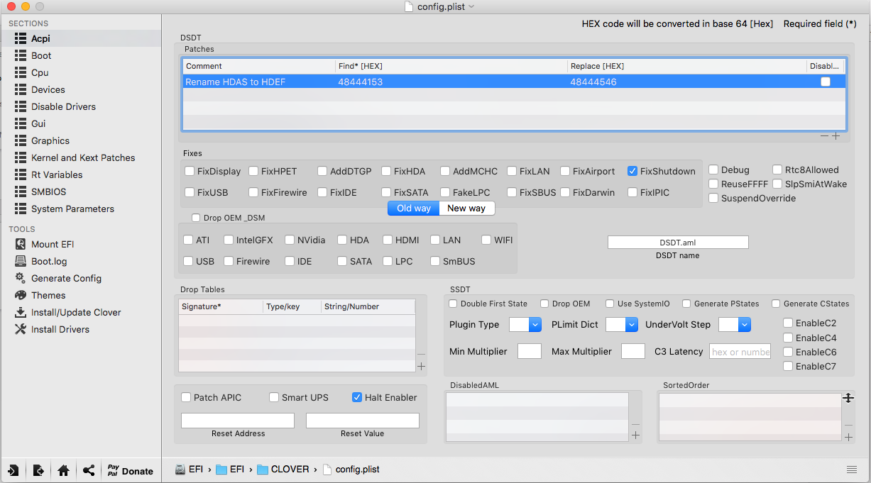

1/ Bios recommended parameters + Pci devices set as Legacy

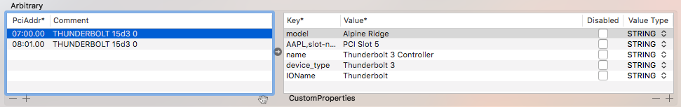

2/ I added this from your post on my config.plist
3/ I created my own SSDT

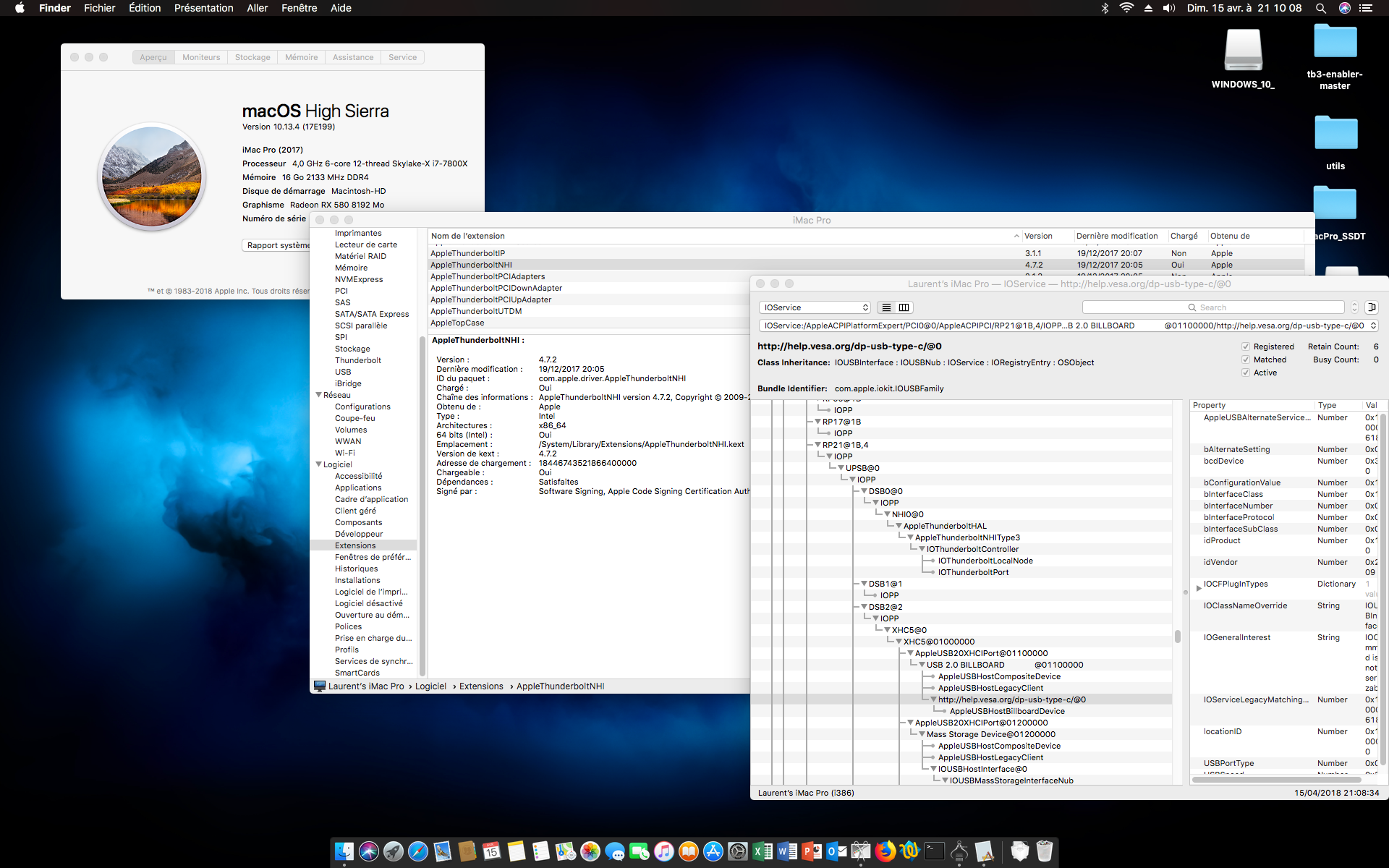

- Hot plug USB or HDD pluged on USB 3.1 or USB C : eject and re-plug OK ( My WINDOWS_10_ HDD connected up right )
Not working ( working in Windows 10 )
- Display sreen connected on USB C
SSDT-TB3U2.aml.zip

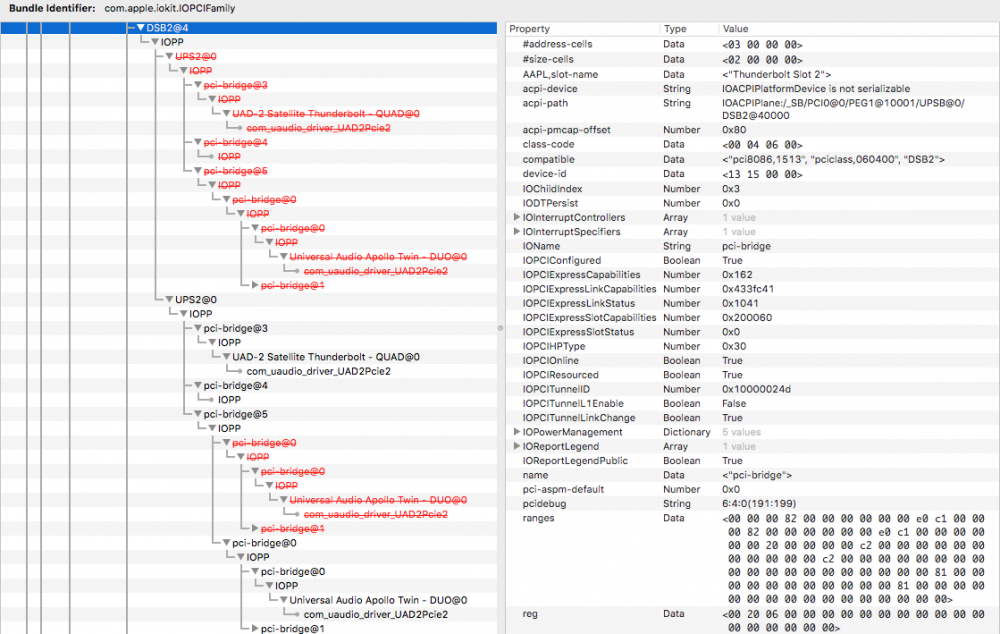

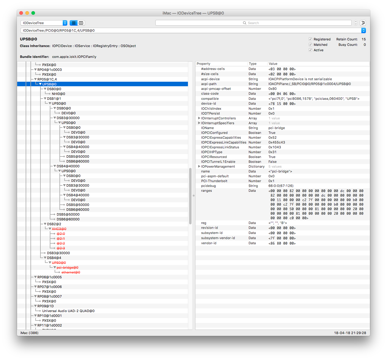

I checked what happens in IOReg and it seems that after turning off the device it remains visible in the ACPI paths (it is not crossed with red).
With many previously used SSDTs, the devices were disconnected correctly, but were not reconnected later.

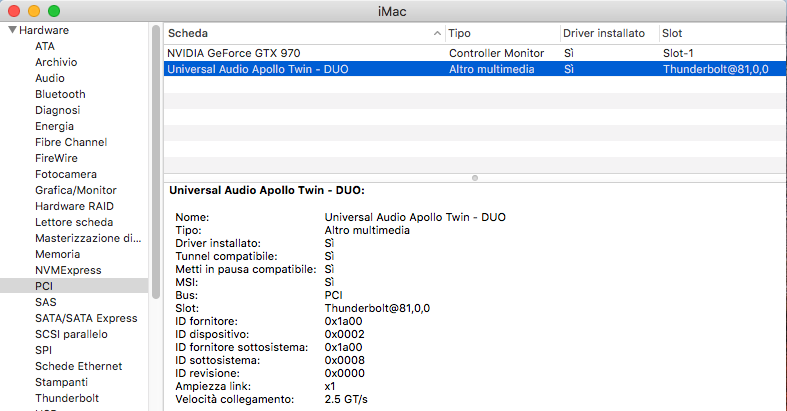

Yes, but it is not a real hotplug, very simply when I turn off my device (UAD Apollo Twin is a powered device always connected with a power button), the system does not disconnect properly, in fact I continue to see it on IOReg but not on the UAD app.
When I turn on the UAD device, it reappears on the UAD app (but the usual popup does not appear: Re-connecting to hardware ...) and if I try to play audio the computer freeze up and goes out as soon as I turn off the Apollo Twin UAD.
Note that in my case, all the devices are reconnected correctly after sleep, even my Belkin dock.

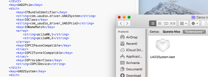

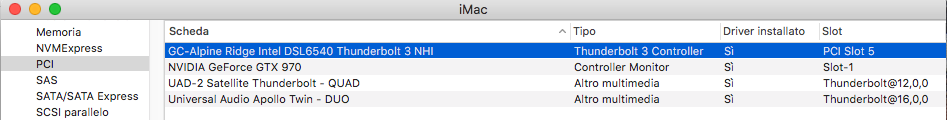

In the kext of my devices there is IOPCITunnelCompatible=true5ad5c10cbe009_Schermata2018-04-17alle11_21_37.png.4ca48cd186a4451891c4174292036583.png
I also tried your method5ad5c2f2f0d0b_Schermata2018-04-17alle11_45_30.png.636d97684d6c0d1ba84ebf2e032d5e19.png5ad5c97cde01f_Schermata2018-04-17alle12_13_01.png.1ffbe77b5814070f2abede28a96bacf1.png
Now in system profile the Thunderbolt devices that I connect are correctly seen.5ad5c99d535bd_Schermata2018-04-17alle12_12_23.png.f08d4b2ac590f1a08985575c7a6d28af.png
And they are disconnected correctly. Unfortunately they are no longer reconnected later.5ad5c9bb1bc11_Schermata2018-04-17alle12_15_13.thumb.png.3cbcf41ac09a310e407a2724d9e3659e.png

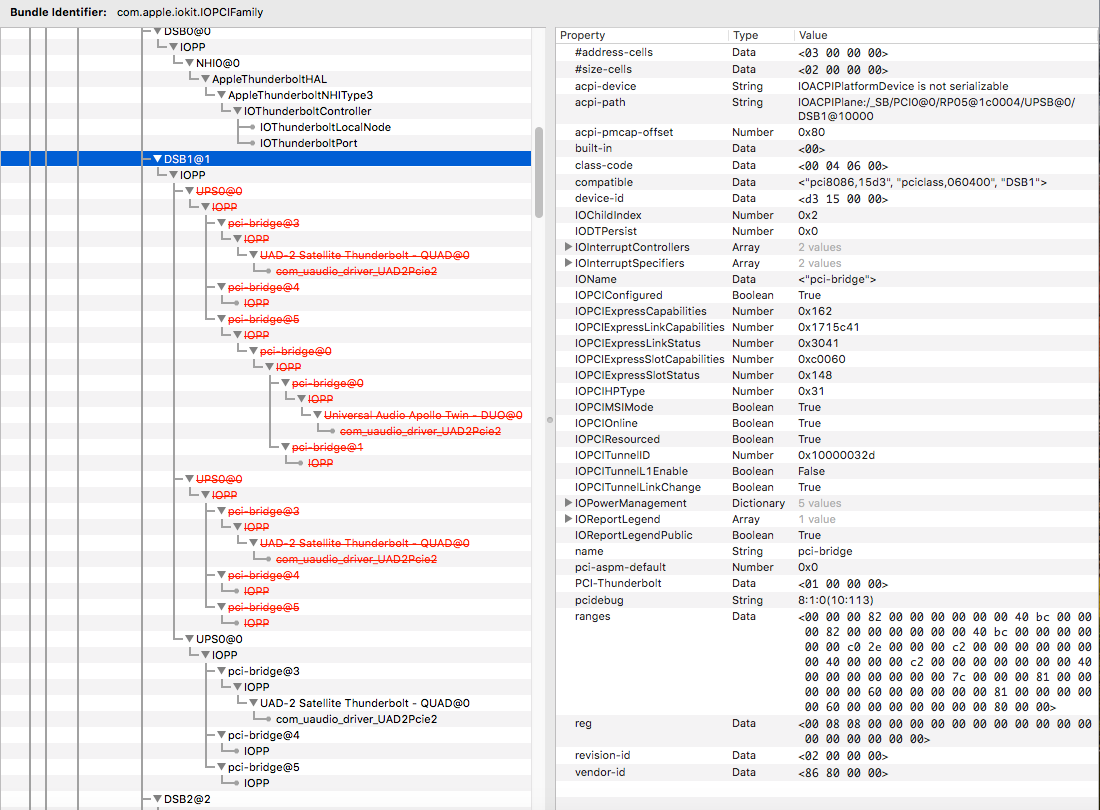

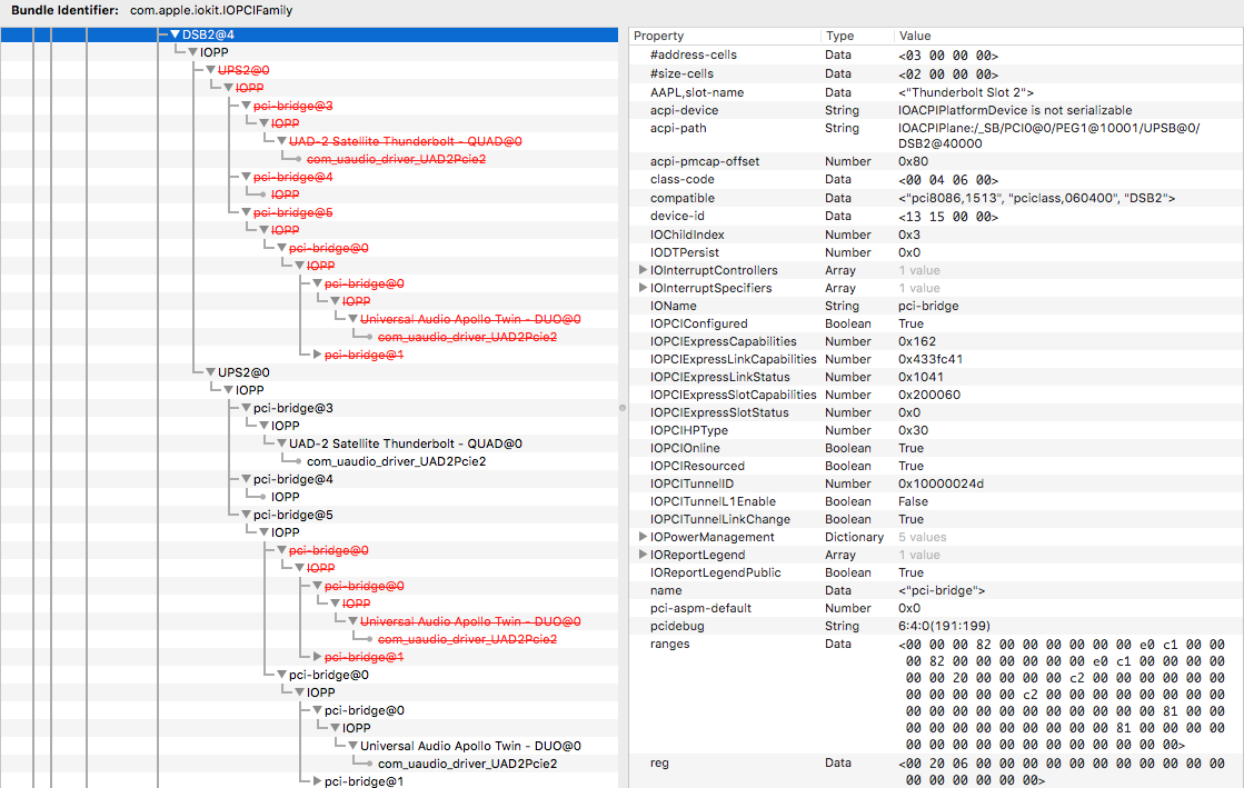

I compared my IOREG with a real iMac18,3 IOReg and I noticed that there are some different voices.
I think the solution is simpler than it seems, but we should understand what prevents Thunderbolt drivers from working properly...
Edited by lelet

Success!!! Finally I managed to enable the hotplug in my Gigabyte Alpine Ridge on MB Z370!
However there are still some corrections to be made, because currently only the first device in the chain is hotpluggable.
Special thanks to everyone who helped and contributed to making this possible!
By combining @maleorderbride's method and @Matthew82's SSDT I can now connect my devices whenever I want. However only the first device reconnects correctly, so I tried the @Loloflat6's SSDT (adapting it to my ACPI paths), but the result is the same with the only difference that the various pci-bridge@# are not renamed in DSB#@.

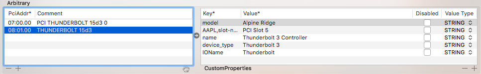

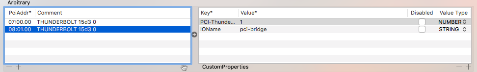

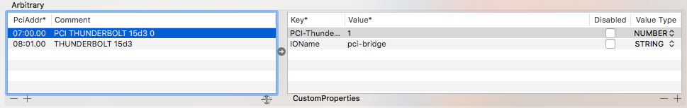

It was enough to add this Arbitrary inject (DSB1 pcidebug):08-01-00.png.9ad8e08c2c3a64590fd2438ee49b04eb.png
Also adding this Arbitrary inject (not mandatory), the information in the PCI system info is displayed (UPSB pcidebug):07-00-00.png.bdd22b069ef610a55d9701525fc11db4.png5ad62f715be93_PCIinfo.png.ee2d0e58e9017cdabb5e238964470b0c.png

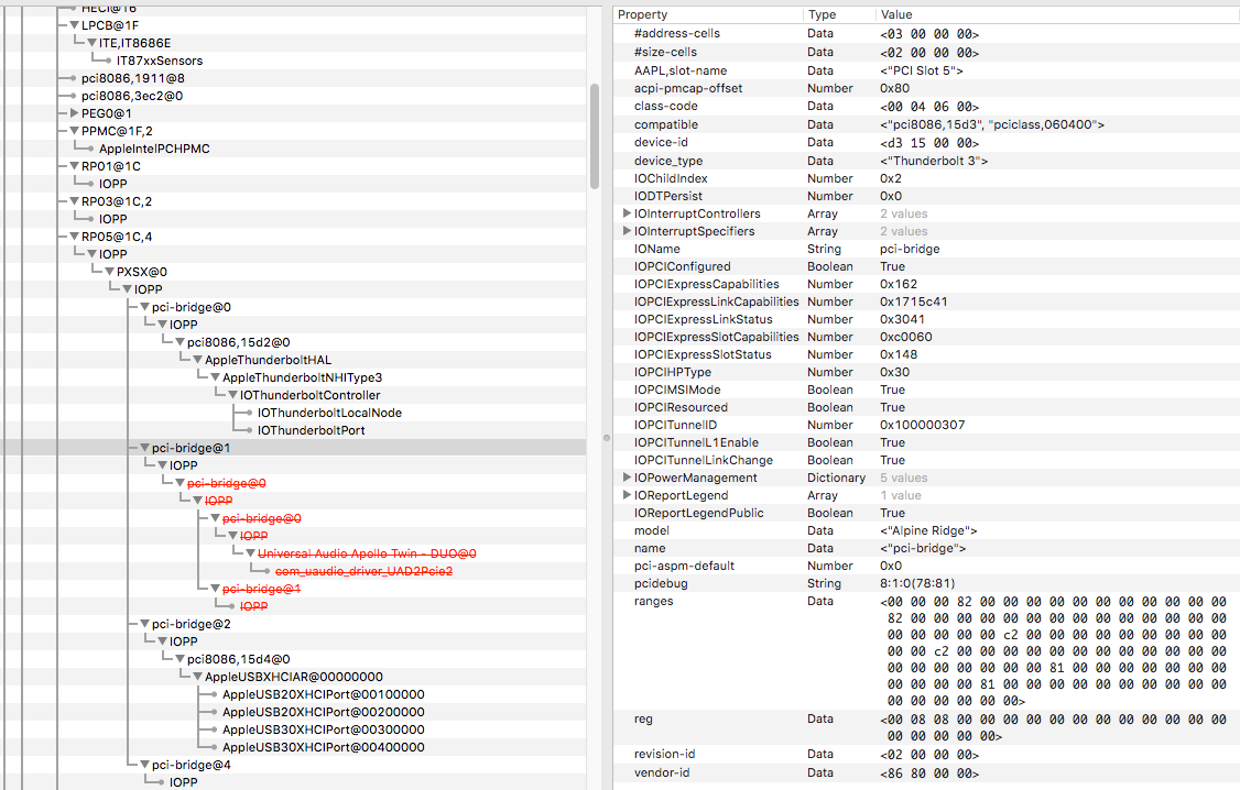

As I said before, however, only the first device in the chain connects correctly. The second device (APOLLO TWIN) even if switched off, is not disconnected correctly until I turn off the first device (UAD 2 Satellite). You probably need to make changes to the SSDT to get the pci-bridge managed differently. Here's how my devices behave now:IOReg.thumb.png.99118a252db54c4bed71e32a0ece2919.png
As you can see, the hotplug is limited to pci-bridge@3.
By making a comparison with the IOReg of my MacBook Pro (same connected/disconnected devices), we see the difference:5ad6346072b57_IORegMacBook.thumb.png.85201c2a13c2ce72afbd615000abbea0.png
I specify that even my Belkin dock is hotpluggable, but subsequent devices behave as described above.
I think that now we are almost there and this could be the way to finally activate the hotplug even in the MB series 100/200/300.
Could someone help me edit or create a proper SSDT? All those created so far only work with the first connected device, so I think it can be useful to everyone.

If not work, add this entry (only the first) on clover (UPSB address):Schermata 2018-04-17 alle 11.45.30.png
Reboot, remove the Arbitrary inject and reboot again.
Here is my IOReg with this SSDT. I do not know if the USB-C works because I have such devices, but hopefully we can implement it later.
IOReg: TB3 Partial-Hotplug.zip

Almost couldn't believe my eyes first! But... SUCCESS FOR ME!!
Used this SSDT and just hotplugget my Focusrite Clarett 4Pre multiple times, tried both turning on and off the device and pulling the thunderbolt cable out and in. The ioreg shows red when disconnected and green when reconnected. WOW!

Another observation: with  SSDT-TBARLOLO.aml installed, when I shutdown my hack it reboots instead.
Gigabyte Z170X-UD5-TH/2 combo TB3/USB3.1 ports
Any suggestions for adaptations for my board welcome.
May you try fix Shutdown in clover :
( I  did cheked this too )
