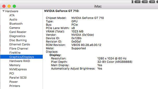

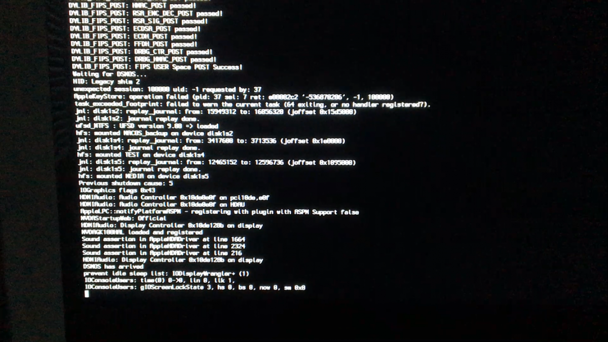

This is the last thing I see before the screen goes black when I try to boot with imac11,1
What do you think?
So, it does actually boot, and it appears the the driver loads too, but the display will not load.  Here is a view from Screen Sharing from my MBP.  So now i think it has something to do with the graphics driver, but I'm not sure why.

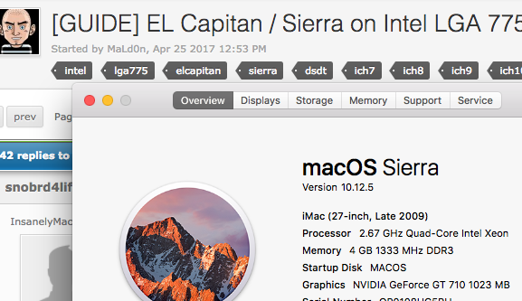

Here is another screenshot from Screen Sharing.
What do you think?
Since Sierra 10.12.5 the GT 710 will not work with imac10,1, imac11,1 et cetera (it works fine in 10.12.4 and below).
It works with smbios macpro3,1 or iMac13,1. Maybe other smbios's too, but I did not test them. I'm using macpro3,1, which works fine.
Note: if using macpro3,1 smbios with Clover bootloader, you'll need -no_compat_check.
