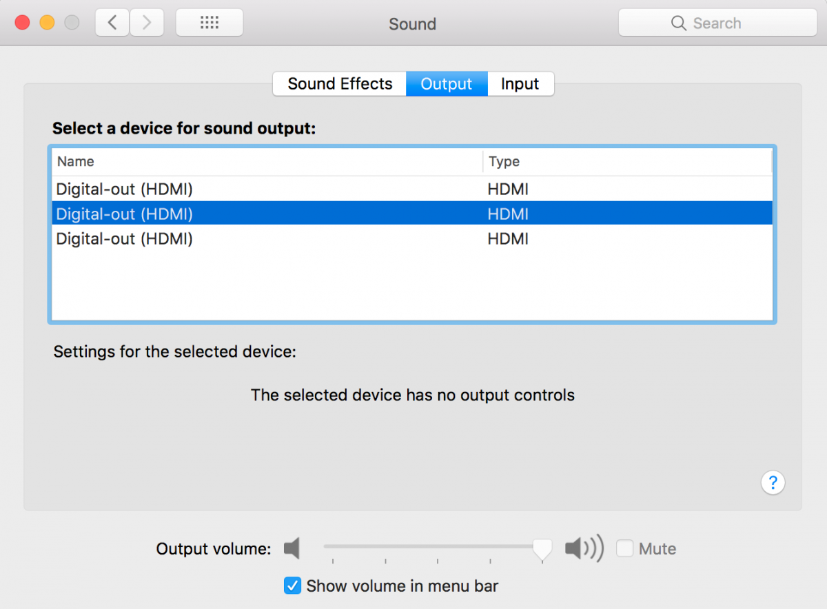

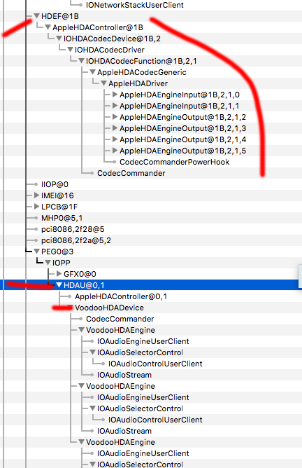

I have managed to boot with -s and the sound works now with my displayport which i want that :) Im not using udmi.. but it shows strange as in the picture below.
the system keeps rebooting after trying to boot now.
run kextutility one time
Kext Utility.app.zip
u can use all kexts in clover/kexts/other, voodoohda too
use kexts there, if u have kexts installed in L/E or S/L/E, remove and run kext utility
Ye, voodoohda inject all
u dont use onboard audio?

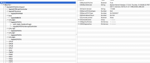

send me one ioreg after reboot
attachicon.gifIORegistryExplorer.app.zip
Thank you. I have attached the IORegistry. I hope I did it correctly.

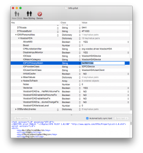

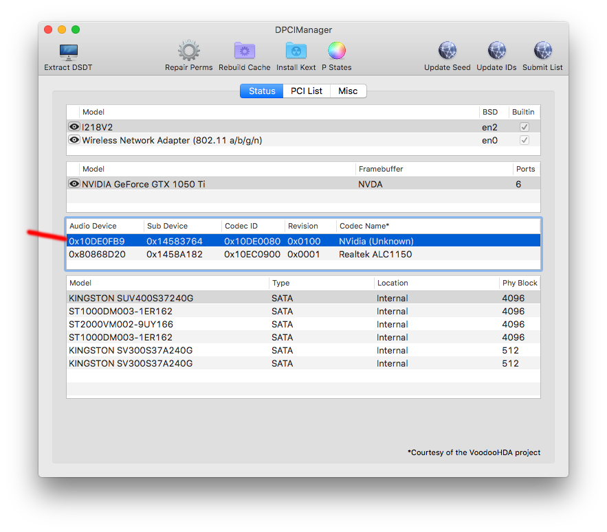

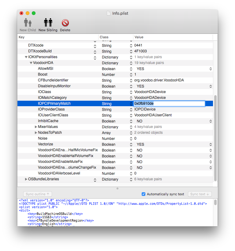

Do u can share how u add id from GPU use HDMI audio?
tks u
tks u
here
Onboard with AppleAlc, HDMI nVidia Pascal with VoodooHda, avoid sleep problems, bad sound
VoodooHda edited, just add ur id in IOPCIPrimaryMatch
VoodooHDA.kext.zip

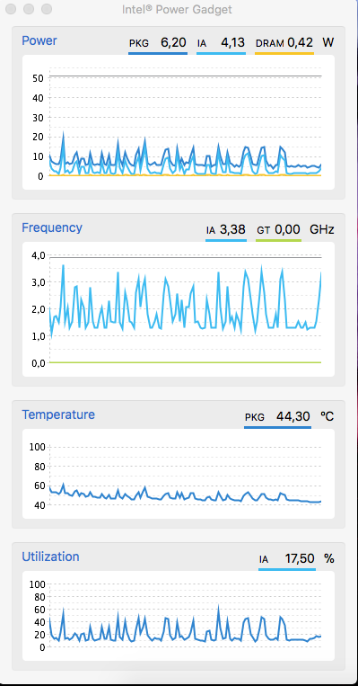

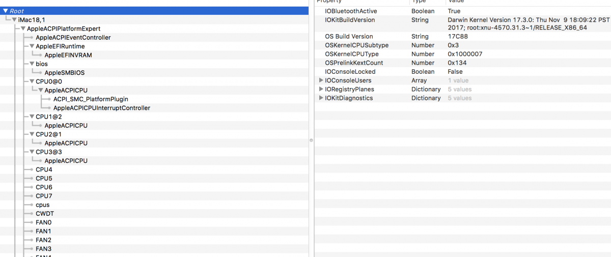

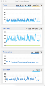

Thanks for the suggestion, but SSDT generated with latest ssdtPRGen seems get worse. In fact now I've problem with Sleep/Wake (black screen instead of sleeping and crash on wake) and anyway CPU never reach 800Mhz.
I've also tried without ur DSDT and without PluginType or any other Table dropping... a baseline system... and seems that in that situation CPU reach 800Mhz as you can see here:
but PM seems however not enabled because X86PlatformPlugin is not present under CPU0@0 in IOReg
Any suggestion?
Any suggestion?
