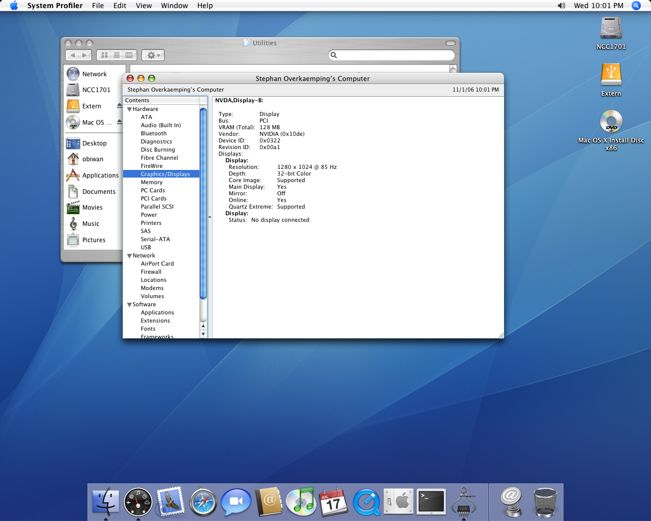

OBIwanKNO Posted November 1, 2006 Share Posted November 1, 2006 Hi, the network card is working again and I can post a screenshot of the FX 5200 with QE and CI. XBench result is about 95 testing only quartz and open gl. I think that's good enough for this old graphic card. Link to comment Share on other sites More sharing options...
