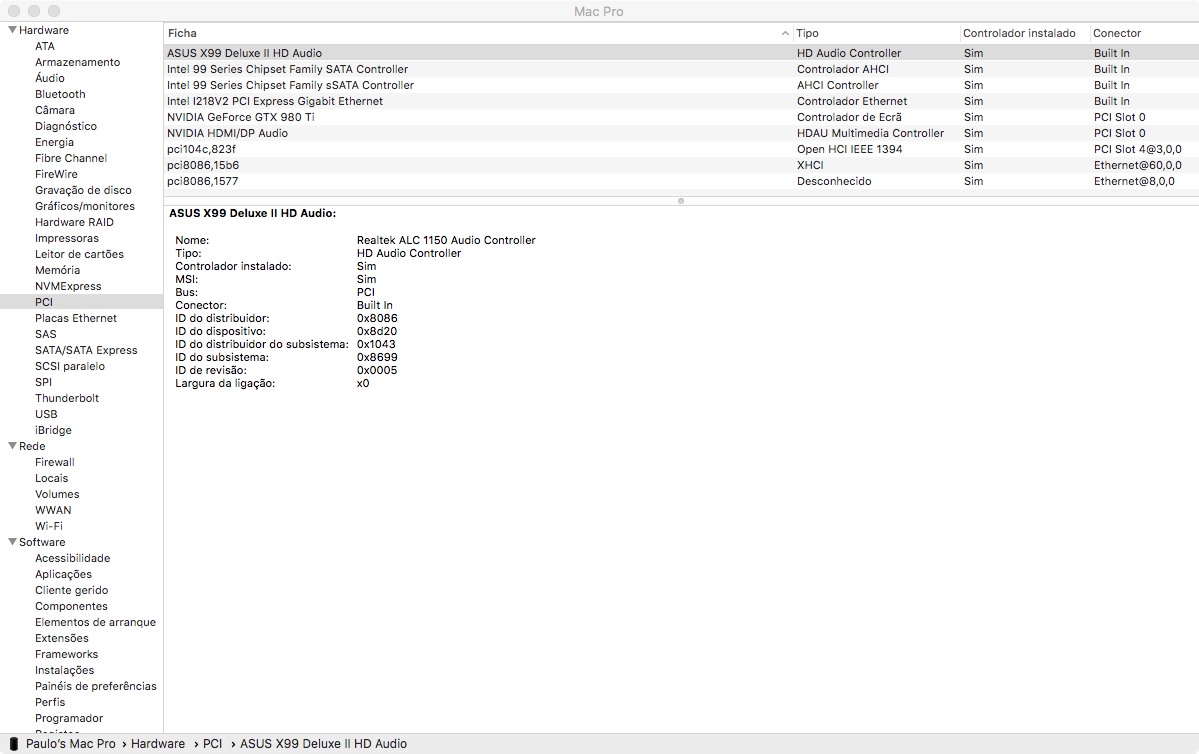

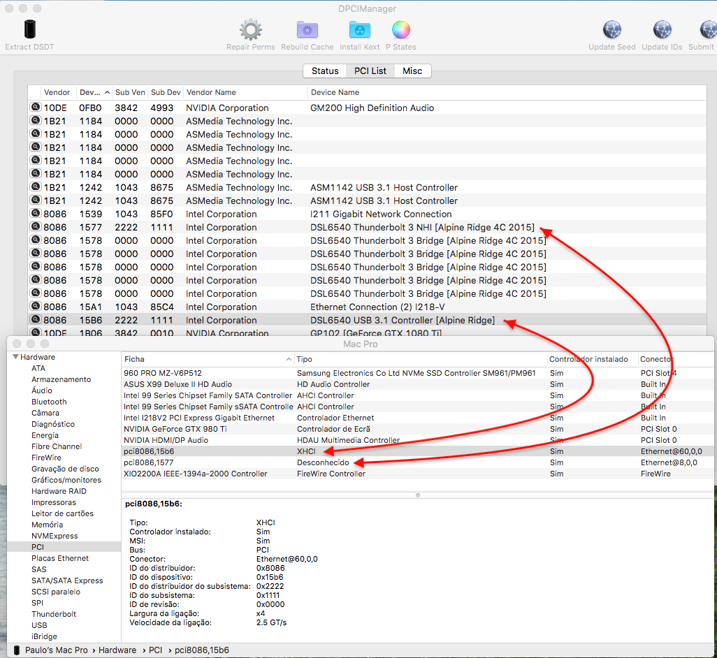

Just for fun, I've used your "SSD-X99-All_Sleep.aml" and for the 1st time ever on any of my hackintosh builds, I was able to fully make system goto to deep sleep and then fully back (with PMDrv.kext for EIST & Corsair PSU link + water cooled H110i GTX USBs active) by pressing the power button, even awakening my Apple Mouse(A1296)+Keyboard(A1314)+trackpad(A1339) bluetooth devices!!!!!icon_mrgreen.gificon_mrgreen.gif
Now the drawback: I've lost my HDMI sound to my Panasonic 4k HDR tv and all my System Information PCI devices that were showing up there, so, I wonder if you (or anyone on this thread) can have a look at my configuration and update it so that I can have all the PCI devices showing in my System Info, plus HDMI sound while maintaining this amazing sleep feature ?
I've tried a couple of times to edit your "SSD-X99-All_Sleep.aml" files with my SSDT files (EFI->CLOVER->ACPI->patched) by looking through IORegistryExplorer info, but always ended up worst than started!!
My current "System Information", PCI section:

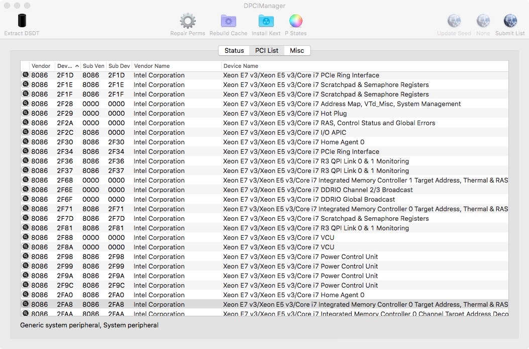

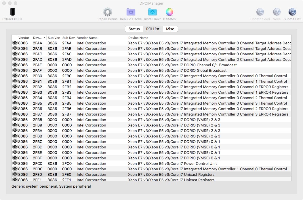

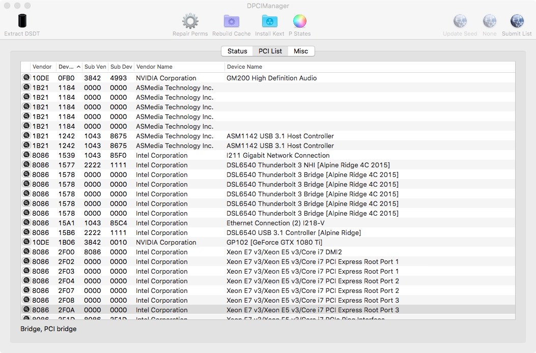

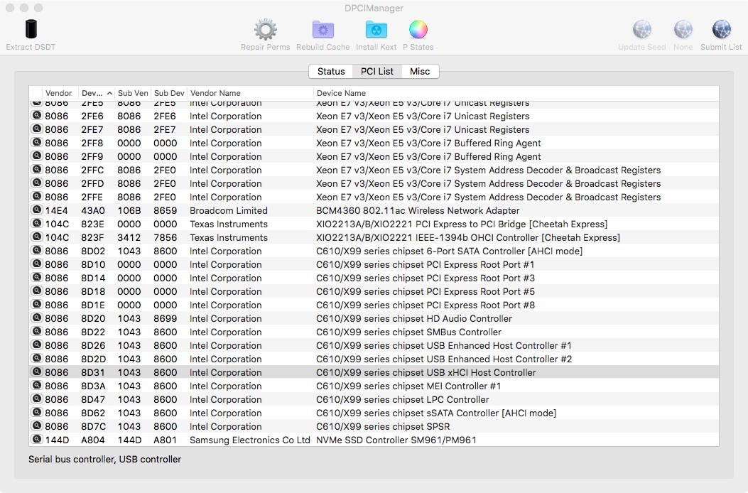

DPCI Manager Devices detected:
post-105782-0-65947000-1511951029_thumb.jpegpost-105782-0-81957100-1511951056_thumb.jpegpost-105782-0-20408600-1511951825_thumb.jpegpost-105782-0-52422900-1511951832_thumb.jpegpost-105782-0-76948500-1511951844_thumb.jpeg
Finally, I've uploaded my EFI folder and the IORegistryExplorer .ioreg file.
EFI.zipPaulo’s Mac Pro.ioreg.zip
Hi nmano,
attachicon.gifDPCI Manager 1.jpegattachicon.gifDPCI Manager 2.jpegattachicon.gifDPCI Manager 3.jpegattachicon.gifDPCI Manager 4.jpegattachicon.gifDPCI Manager 5.jpeg
attachicon.gifEFI.zipattachicon.gifPaulo’s Mac Pro.ioreg.zip

This is the 1st time that I can see the most devices identified in System Information→HW→PCI and it does put my hackintosh into sleep when I click PAUSE, but it wakes up after 2 seconds, no more cold restarts - almost there !!!!   :drool:
Now my System Information→HW→PCI shows the following:
  • I've highlighted above my Asus ThunderboltEX 3 devices detected by DPCI manager - Do you think you can also add them to the SSDT ?
  • The only device not detected (from the new SSDT) is the Broadcom BCM4360 WLAN adapter - the PCI device & vendor are correct tough...
I believe that now that the only thing missing for a successful sleep & awake process is the addition of the USB devices to the SSDT file, which I think, will also make the WLAN device appear in System Information.

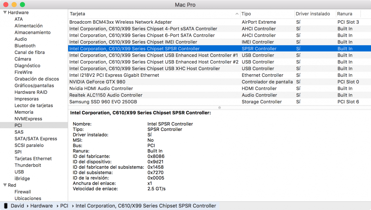

Hi nmano
it is not working well
it miss Nvidia policy patch for 6.1 SMBIOS so I have to start without Nvidia web Driver
then I see few new lines in PCI as you can see:
attached also new ioreg as requested
Thank you
