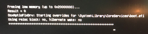

Hi nmano,
thanks a lot for this giude - great.
After a while of trying to do a fresh install of High Sierra with other guides I found yours - it brought me quite far.
The USB installation rebootet 3 times (as I remember) including the long about 20 minute installation part.
But the last boot stuck directly after choosing another time new system disc in clover (screenshot), so installation is incomplete. Boot no longer possible with this target.
(Still there is another partition "Prebooter from Preboot...".)
I used your EFI exactly as it is, no modification, just  adding SMBIOS serial of course.
During all boots there was repeatly a message "boot endpoint has been activated..." as a easy to see problem.
Any sugestion what to do?

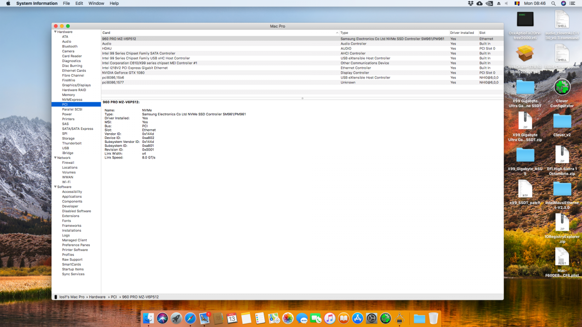

SSDT_2017_X99
This SSDT patches work with DSDT.
I made 23 SSDT patches for X99.
This SSDT work with DSDT.
I update latest BIOS F22
Don’t use MY DSDT.
#1 Check down Rename DSDT Detail.
#2 After rename you have to patch  to X99_comfile and sleep with tool MaciASL.
#3 you have to modify SSDT for your devices.
#I got 17 PCI SLOT If anybody more then 17 slot I like to see that.
#This SSDT patches fixes my NVMe Yellow Icon.
#Please like or not first test.
#Rename info_1
#If you have GPU card in slot BR3C
# 1. Under Device BR3C - Verify IOReg/H000
# 2. Rename device H000 to device H00Y
# 3. Rename device H001 to device HDA1  (Nvidia/AMD HDMI audio)
# 4. Enter Compile
# 5. Look Compile summary just click each red line and Insert H00Y and HDA1(SSDT Rename GFX1 and HDAU).
#Maintained by: N.Mano
#Rename info_2
#If you have wifi card in slot BR2A
# 1. Under Device BR2A - Verify IOReg/H000
# 2. DSDT_Rename device H000 to device ARP0
# 3. (SSDT will Rename ARP0 to ARPT)
# 4. Enter Compile
# 5. Look Compile summary just click each red line and Insert H000 and ARP0(SSDT Rename ARP0 and ARPT).
#Rename info_3
#If you have FireWire IEEE-1394a in slot BR1A
# 1. Under Device BR1A - Verify IOReg/H000
# 2. DSDT_Rename device H000 to device PCIA
# 3. (SSDT patched to Rename PCIA to PCIB)
# 4. Enter Compile
# 5. Look Compile summary just click each red line and Insert H000 to PCIA(SSDT Rename PCIA to PCIB).
#Rename info_4
#if you have NVMe SSD Controller SM961 in BR3A SLOT.
# 1. Under Device BR3A - Verify IOReg/H000
# 2. DSDT_Rename device H000 to device NVM1
# 3. (SSDT will Rename NVM1 to NVME)
# 4. Enter Compile
# 5. Look Compile summary just click each red line and Insert H000 and NVM1(SSDT Rename NVM1 to NVME).
X99_SSDT_2017.zip

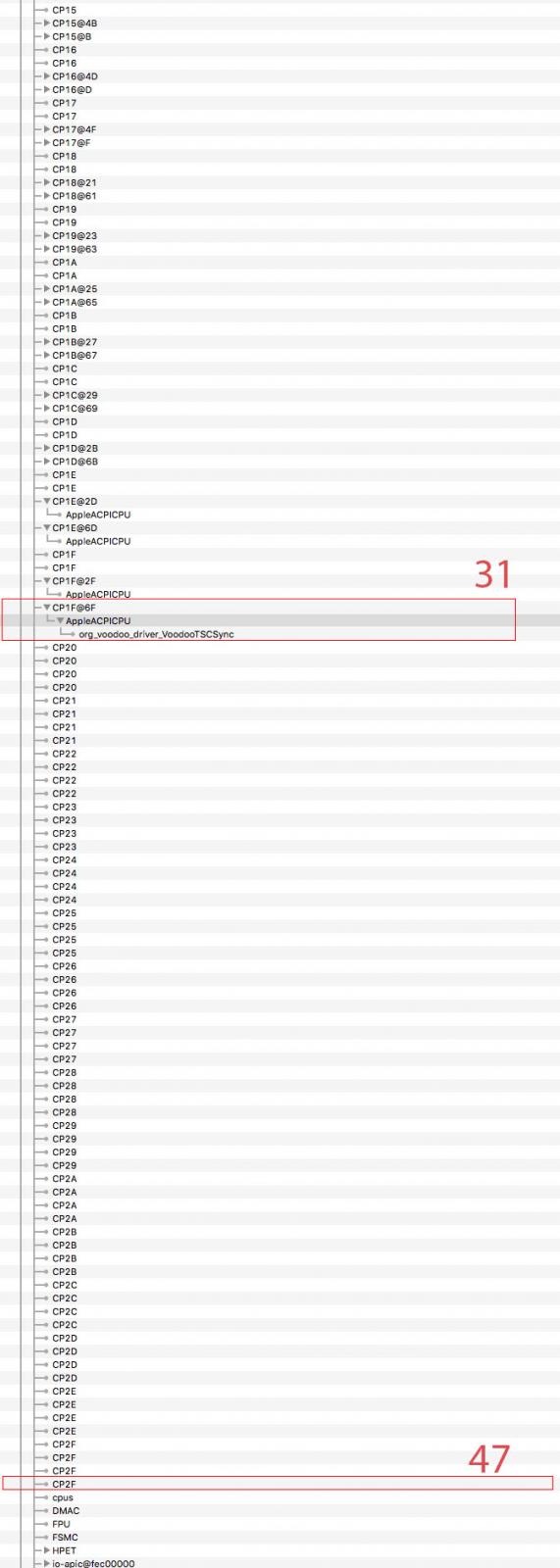

Hey guys and interesting question.
I've dual E5-2696 V4 cut down to 16 cores per CPU totaling 32 Cores (64 Threads).
Why do I have 48 CPU mentions in the IOREG?
Does it means the OS might Get 24 Core CPU support? https://ark.intel.com/products/120504/Intel-Xeon-Platinum-8168-Processor-33M-Cache-2_70-GHz
VooDooTS is locked to CPU 32.

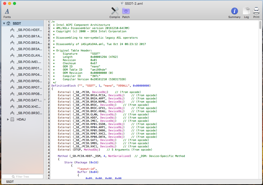

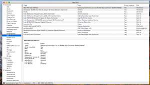

All IN ONE SSDT FOR X99
#You have to rename device first.
#you can rename DSDT or Clover config
#After rename devices you have to patched (X99_comfile and sleep) your DSDT.
I am so happy to made this SSDT map for X99.Its very smooth an clean boot.
Don’t install  my SSDT and DSDT please make for your own DSDT and SSDT.
Enjoy :thumbsup_anim:
#Rename info_1
# 2. Rename device H000 to device GFX1
# 3. Rename device H001 to device HDAU  (Nvidia/AMD HDMI audio)
# 4. Enter Compile
#Rename info_2
# 2. DSDT_Rename device H000 to device ARPT
#Rename info_3
#Rename info_4
# 2. DSDT_Rename device H000 to device NVME
X99_SSDT_ALL IN ONE.zip

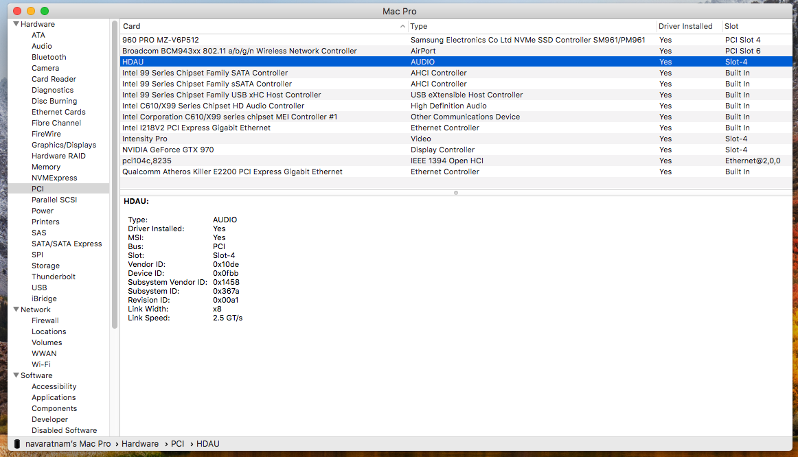

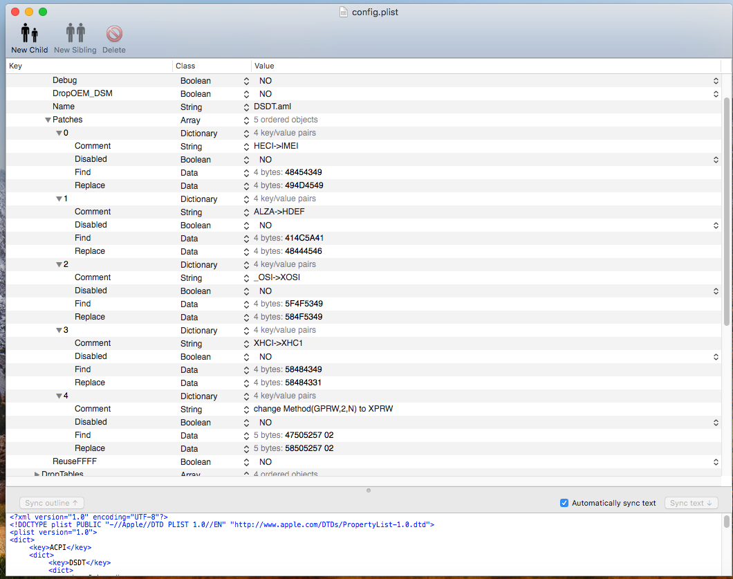

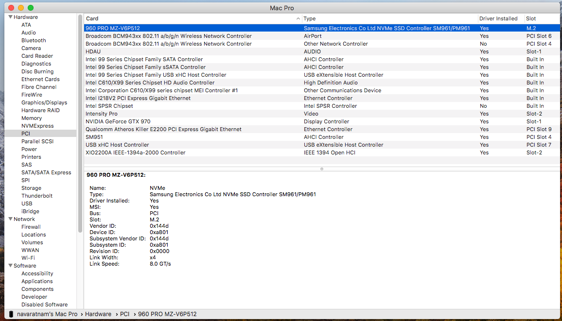

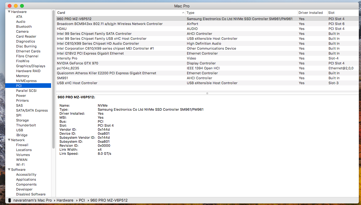

Hi guys
X99 AUTO RENAME PATCHES for DSDT/SSDT
# X99_Maintained and disassembled by:N.Mano
# Credit: RehabMan
#X99_AUTO RENAME DEVICES_Patches.
#X99_Rename_patch_1
#Remove device D083 in BR3C
into Device label D083 remove_entry;
into_all all code_regex \_SB.PCI0.BR3C.H000 replaceall_matched begin _SB.PCI0.BR3C.GFX1 end;
into_all all code_regex \_SB.PCI0.BR3C.H001 replaceall_matched begin _SB.PCI0.BR3C.HDAU end;
into device label H000 parent_label BR3C set_label begin GFX1 end;
into device label H001 parent_label BR3C set_label begin HDAU end;
# Credit: RehabMan
#X99_Rename_patch_2
#If you have GPU card in slot BR2A
into_all all code_regex \_SB.PCI0.BR2A.H000 replaceall_matched begin _SB.PCI0.BR2A.GFX1 end;
into_all all code_regex \_SB.PCI0.BR2A.H001 replaceall_matched begin _SB.PCI0.BR2A.HDAU end;
into device label H000 parent_label BR2A set_label begin GFX1 end;
into device label H001 parent_label BR2A set_label begin HDAU end;
#X99_Rename_patch_3
# Credit: RehabMan
into Device label D07B remove_entry;
into_all all code_regex \_SB.PCI0.BR2A.H000 replaceall_matched begin _SB.PCI0.BR2A.ARPT end;
into device label H000 parent_label BR2A set_label begin ARPT end;
#X99_Rename_patch_4
# Credit: RehabMan
into_all all code_regex \_SB.PCI0.BR1A.H000 replaceall_matched begin _SB.PCI0.BR1A.PCIA end;
into device label H000 parent_label BR1A set_label begin PCIA end;
#X99_Rename_patch_5
# Credit: RehabMan
into Device label D081 remove_entry;
into_all all code_regex \_SB.PCI0.BR3A.H000 replaceall_matched begin _SB.PCI0.BR3A.NVME end;
into device label H000 parent_label BR3A set_label begin NVME end;
#X99_REMOVE device_Add Device_Patch_6
#if you have NVMe SSD Controller SM951 in RP01 SLOT.
# 1 Remove device D073 in RP01
# 2.  Insert Device SSD0
into Device label D073 remove_entry;
into device label RP01 insert begin
 Device (SSD0)\n
 {\n
   Name (_ADR, Zero)\n
 }\n
end;
#X99_REMOVE device_Add Device_Patch_7
# Credit: RehabMan
#if you have USB 3 CARD in  SLOT RP07.
into Device label D079 remove_entry;
into device label RP07 insert begin
 Device (XHC2)\n
 {\n
   Name (_ADR, Zero)\n
 }\n
end;
# Credit: RehabMan
#X99_REMOVE device_Add Device_Patch_8
#if you have WIFI in  SLOT RP04.
into Device label D076 remove_entry;
into device label RP04 insert begin
 Device (ARP1)\n
 {\n
   Name (_ADR, Zero)\n
 }\n
end;

ALL IN ONE SSDT
# X99_SSDT_Maintained and disassembled by:N.Mano
# Credit: RehabMan
#Worked ALL Sleep/HDMI
#NO DSDT
#Enjoy
ALL IN ONE SSDT_Latest.zip
  • Like 5

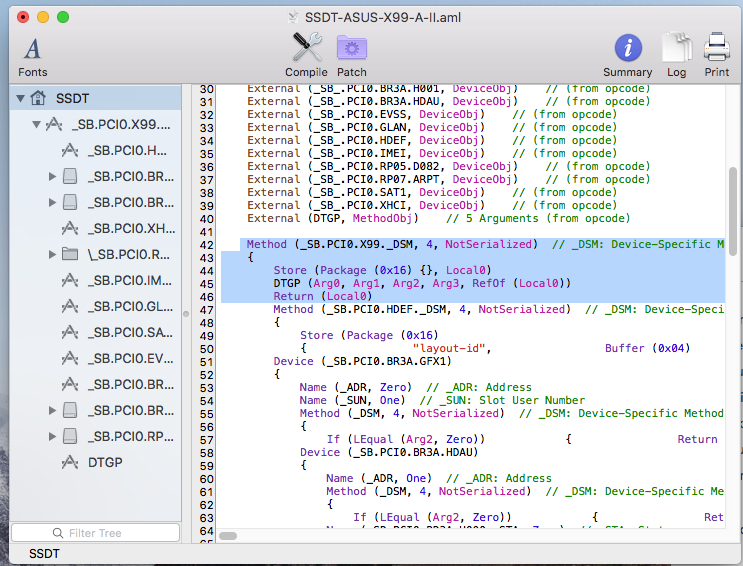

X99_All IN ONE_SSDT FOR GIGABYTE & ASUS
#ADD your layout-id
#Check rename detail in config
#Check Your Devices
X99_Gigabyte_ASUS.zip

Hi Guys

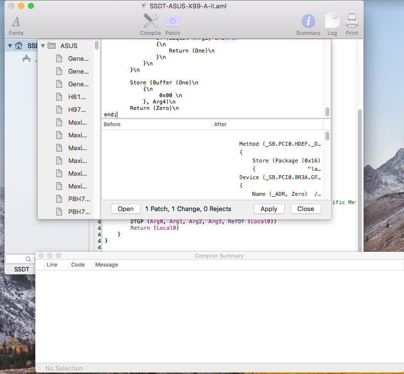

This patched for X99_All_SSDT
#You have to patch over ori SSDT
#After patched removed this part
  Method (_SB.PCI0.X99._DSM, 4, NotSerialized)  // _DSM: Device-Specific Method
        Store (Package (0x16) {}, Local0)
        DTGP (Arg0, Arg1, Arg2, Arg3, RefOf (Local0))        Return (Local0)
SSDT_patched_X99.zip

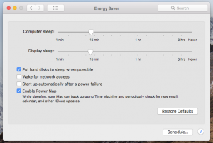

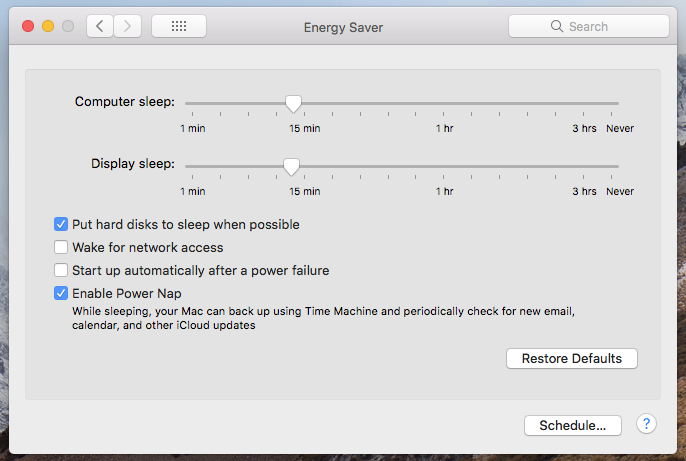

Energy Saver dual slider for X99
UnifiedSleepSliderPref = No
Replace
/IOPlatformPluginFamily.kext/Contents/PlugIns/X86PlatformPlugin.kext/Contents/Resources
Mac-F60DEB81FF30ACF6.plist.zip
  • Like 3
Hi Sygey02
#Remove All DSDT and SSDT and config
#Replace config and SSDT-X99-ALL
#test and report with screen shots.
Enjoy
X99 Gigabyte ultra gaming_SSDT ALL.zip

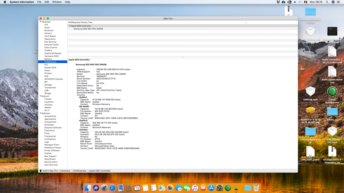

Tank you! it works, but my ssd Samsung its 950 PRO
SPRS missing
I need ssdt for powermangement? or no?

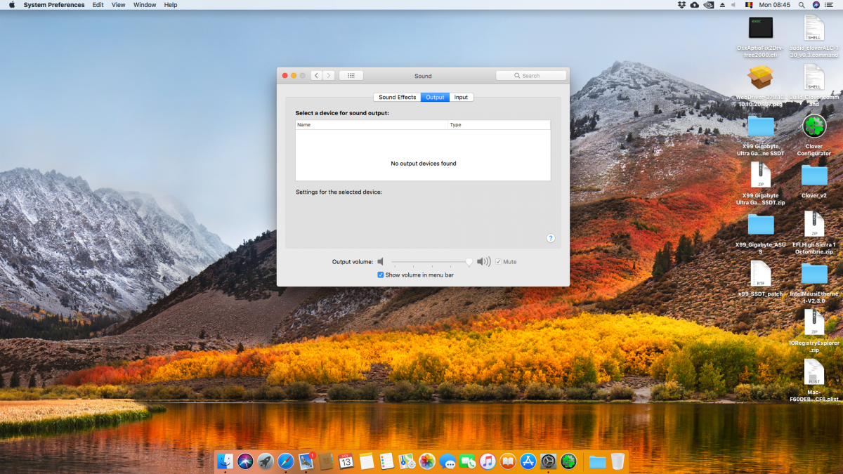

Hi
#Remove AppleALC
#Install AppleHDA with Easykext Utility
#LayoutID = 9
AppleHDA-1150-10.13.1.zip

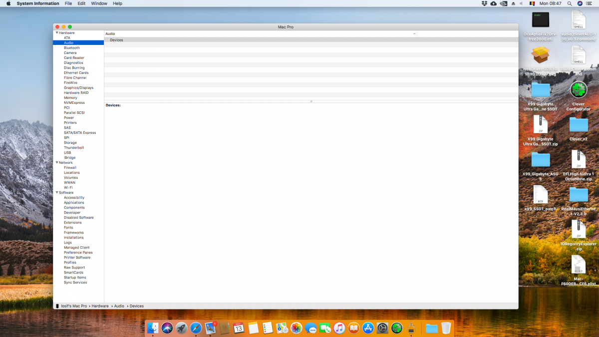

The same state with sound ..no audio devices with audio id 9 in config and applehda.kext!
Can you test sleep work or not?
I change Layout ID 9
Try this
Not working!
when I press sllep command it go to sleep, but it dozen,t resume my os high Sierra wen I press power button for wake.
No Sound device!
Try this
No Sound device!
Not working!
No Sound device!
Its normal.
check your sound.
