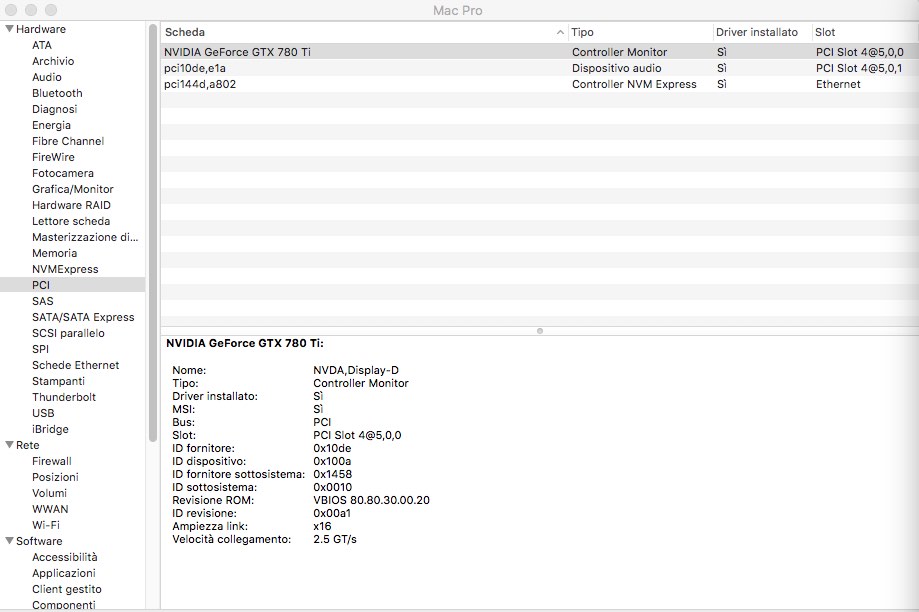

it miss Nvidia policy patch for 6.1 SMBIOS so I have to start without Nvidia web Driver
then I see few new lines in PCI as you can see:
attached also new ioreg as requested
Thank you

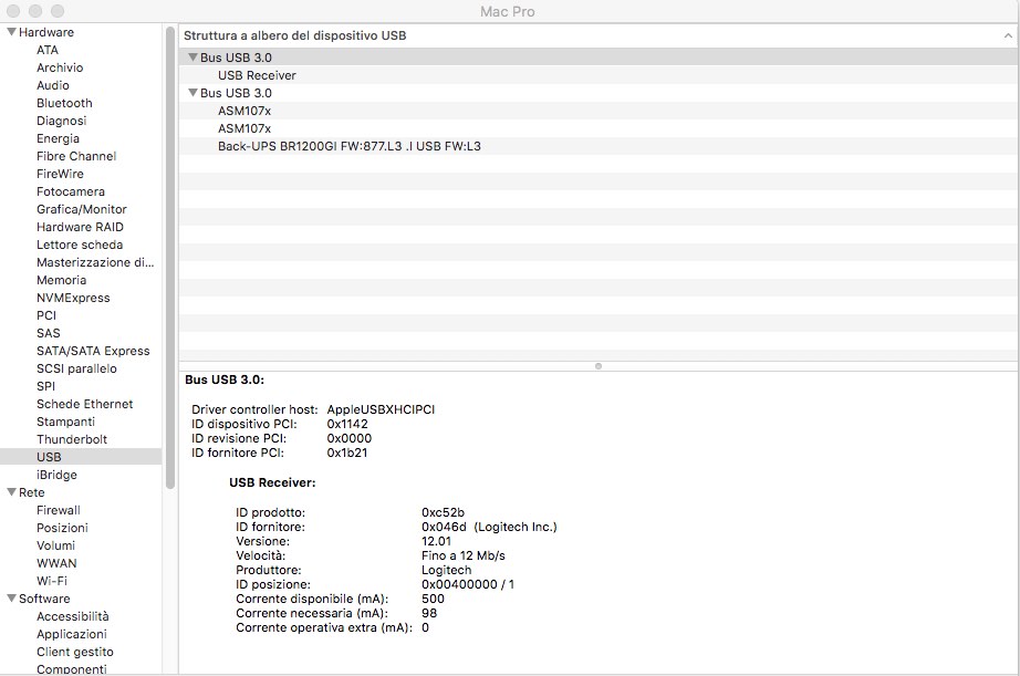

https://imgur.com/a/DBNvh
but to login I have to connect a new mouse and keyboard otherwise I do not have both

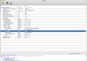

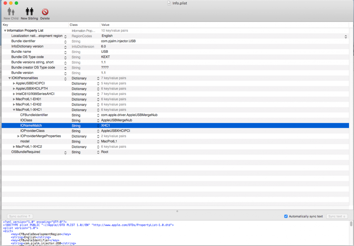

X99_Injector USB 3.kext
I rename device XHCI to XHC1 in SSDT
X99_Injector USB 3.kext set to XHC1
fabiosun
Test 3_SSDT-X99-All_Fabiosun.aml.zip
