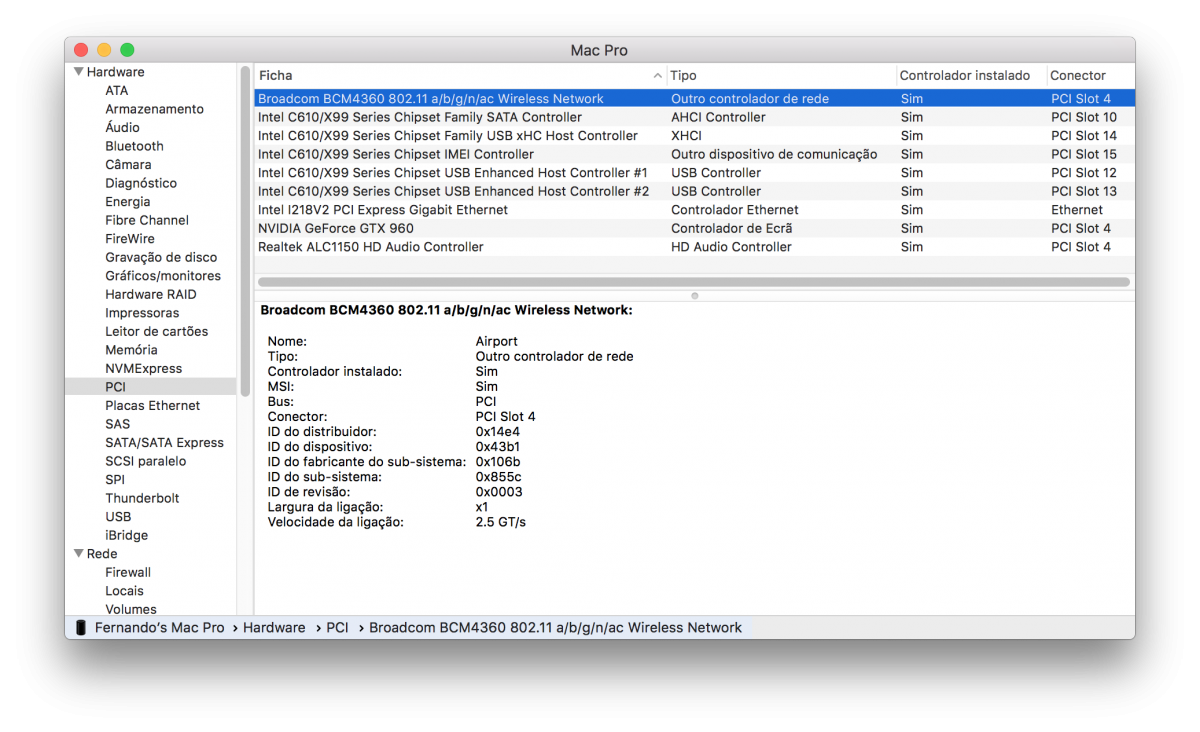

I have a very strange thing going on and i can´t find a solution.
I´m running the Asus X99A II. Everything is fine but after I updated my BIOS from 1504 to 1701 I lost one of the USB 2 controllers. Namely EH01 is not working anymore. It´s probably DSDT related because with my 1504 DSDT it still works.
I attached both DSDT versions + System Report- PCI Pics. They clearly show the problem.
Would be great if someone finds the problem. It´s already the 3rd machine where i see this mistake.
