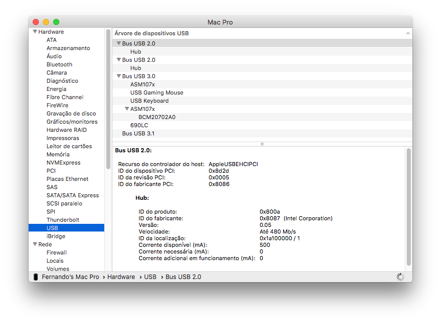

When I use this kext  X99_Injector USB 3.kext   all USB ports stops working!
All its loading fine to the login screen but then all USB ports stops working!
I don't have any patches in plist, in fact I well provide my CLOVER .......  https://drive.google.com/file/d/0B0-k2xeTJWWoU1VwZmc5MkM2dDA/view?usp=sharing
I want to mention that now I can boot, but just to login info because off usb keyboard won't work
Hi! nmano! I used your zip file.  X99_Injector USB 3.kext and now usb its working!

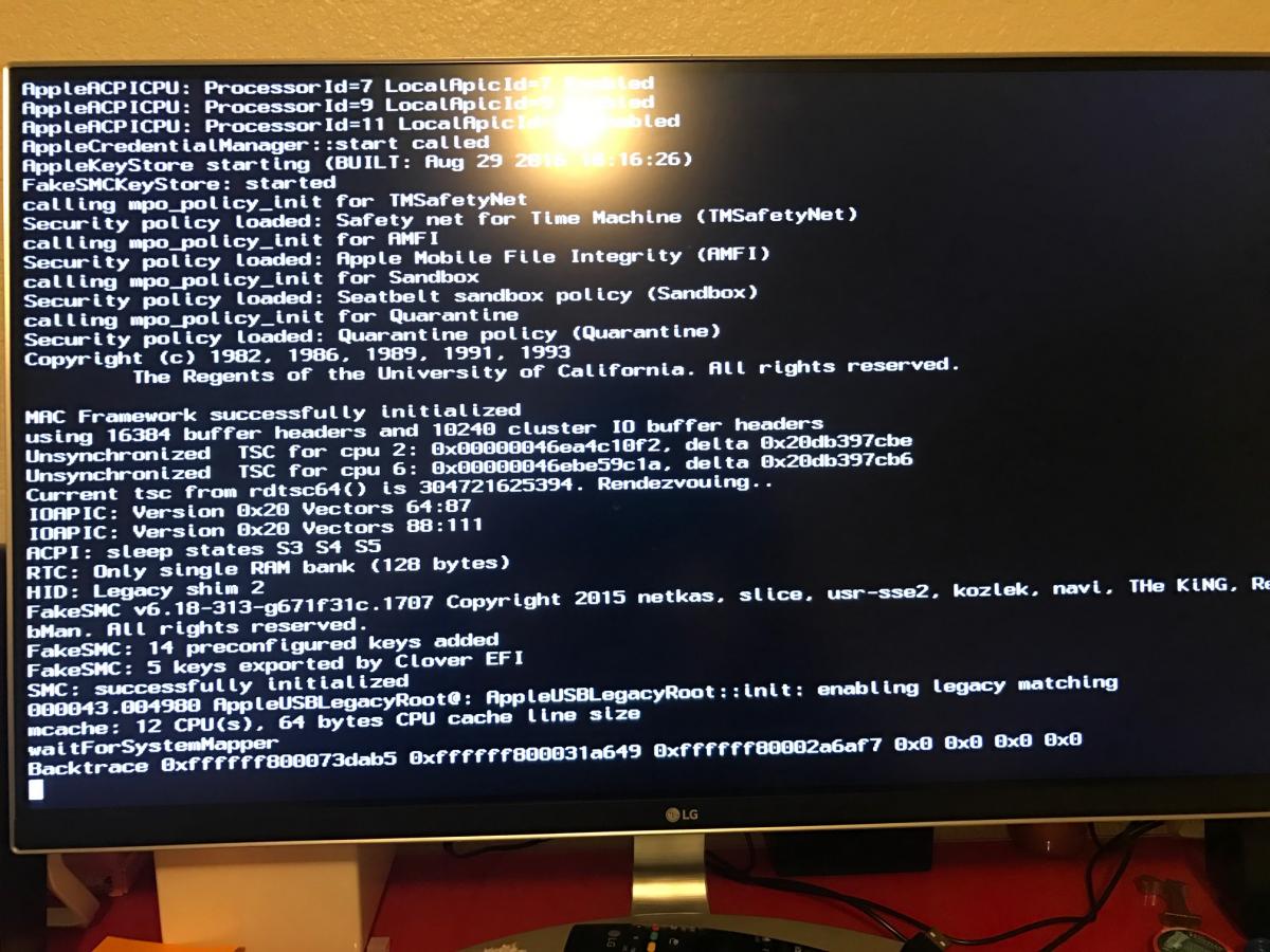

​I notes that  with this   AppleALC.kext  my sistem panics and reboot. message  ( sistem uptime nanosecond)
when I remove this kext it boots fine!

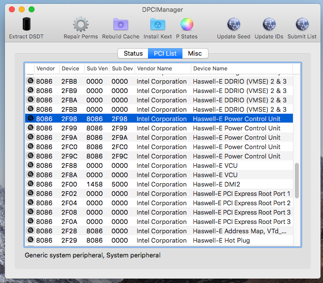

hello nmano , can you help me with dsdt?  3Q very much
I can't help no details.

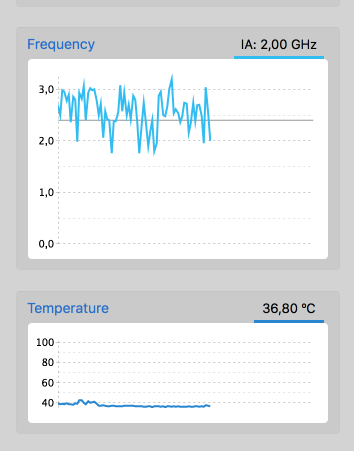

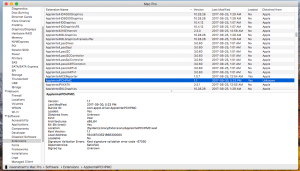

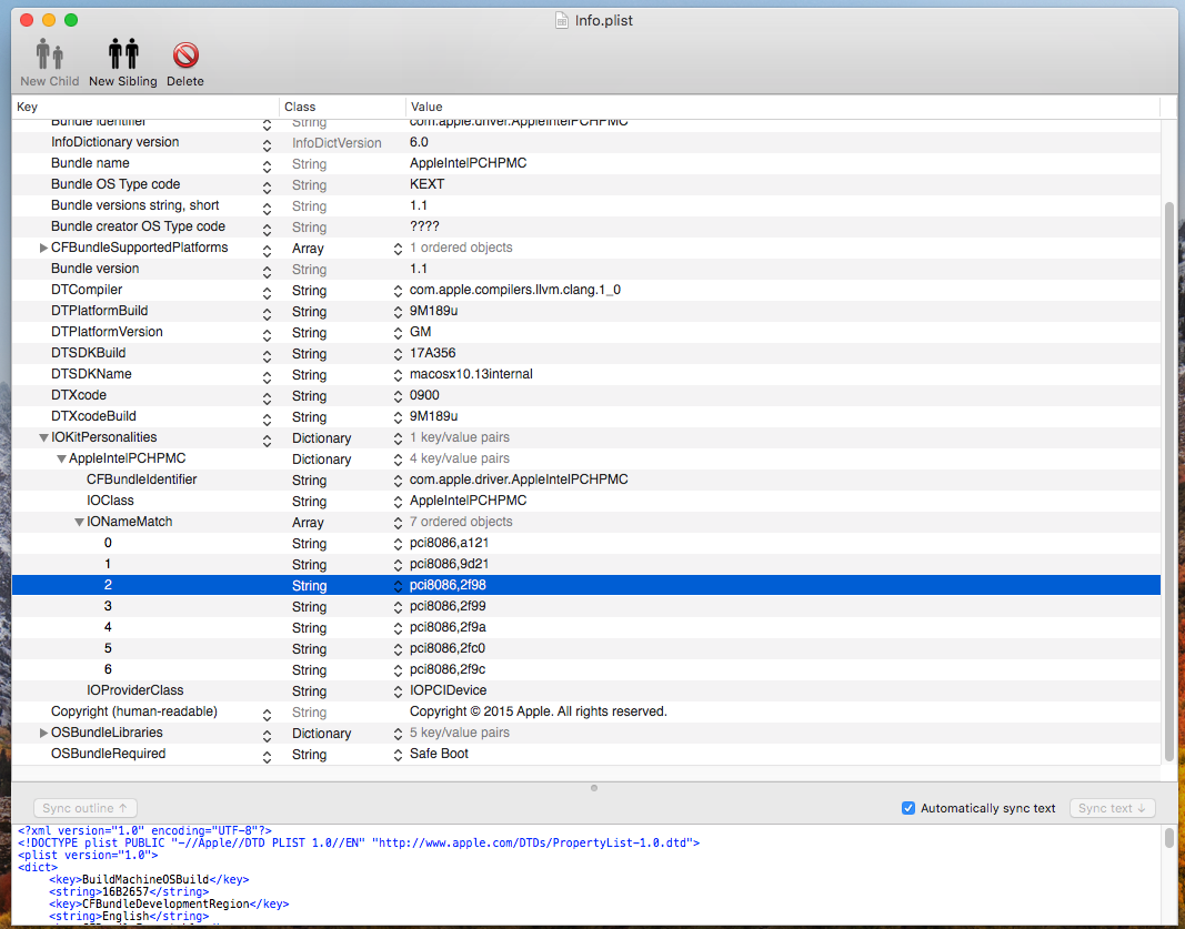

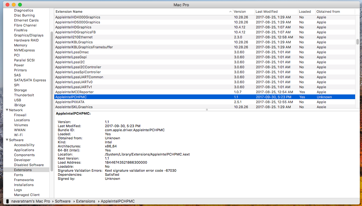

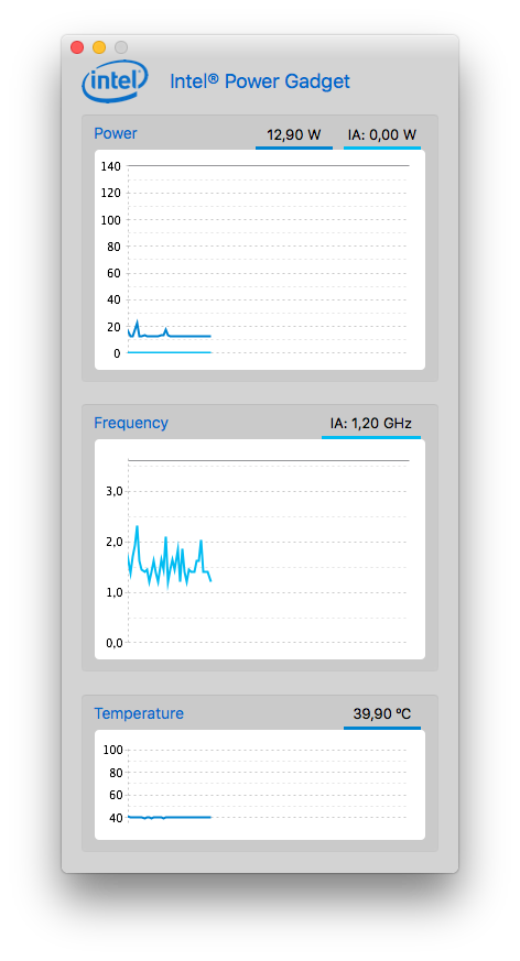

Last login: Thu Jul 27 14:38:58 on console
navaratnams-Pro:~ navaratnam$ sudo chown -R root:wheel /Users/navaratnam/Desktop/AppleIntelInfo.kext
Password:
navaratnams-Pro:~ navaratnam$ sudo chmod -R 755 /Users/navaratnam/Desktop/AppleIntelInfo.kext
navaratnams-Pro:~ navaratnam$ sudo kextload /Users/navaratnam/Desktop/AppleIntelInfo.kext
navaratnams-Pro:~ navaratnam$ sudo cat /tmp/AppleIntelInfo.dat
AppleIntelInfo.kext v2.0 Copyright © 2012-2016 Pike R. Alpha. All rights reserved
enableHWP................................: 0
Settings:
logMSRs..................................: 1
logIGPU..................................: 0
logCStates...............................: 1
logIPGStyle..............................: 1
InitialTSC...............................: 0xe512306e128e (8395 MHz)
MWAIT C-States...........................: 8480
Processor Brandstring....................: Intel(R) Core(TM) i7-5960X CPU @ 3.00GHz
Processor Signature..................... : 0x306F2
 - Family............................... : 6
 - Stepping............................. : 2
 - Model................................ : 0x3F (63)
Model Specific Registers (MSRs)
MSR_CORE_THREAD_COUNT............(0x35)  : 0x1E
 - Core Count........................... : 8
 - Thread Count......................... : 16
MSR_PLATFORM_INFO................(0xCE)  : 0x80C3BF3811E00
 - Maximum Non-Turbo Ratio.............. : 0x1E (3000 MHz)
 - Ratio Limit for Turbo Mode........... : 1 (programmable)
 - TDP Limit for Turbo Mode............. : 1 (programmable)
 - Low Power Mode Support............... : 1 (LPM supported)
 - Number of ConfigTDP Levels........... : 1 (additional TDP level(s) available)
 - Maximum Efficiency Ratio............. : 12
 - Minimum Operating Ratio.............. : 8
MSR_PMG_CST_CONFIG_CONTROL.......(0xE2)  : 0x7E000403
 - I/O MWAIT Redirection Enable......... : 1 (enabled, IO read of MSR(0xE4) mapped to MWAIT)
 - CFG Lock............................. : 0 (MSR not locked)
 - C3 State Auto Demotion............... : 1 (enabled)
 - C1 State Auto Demotion............... : 1 (enabled)
 - C3 State Undemotion.................. : 1 (enabled)
 - C1 State Undemotion.................. : 1 (enabled)
 - Package C-State Auto Demotion........ : 1 (enabled)
 - Package C-State Undemotion........... : 1 (enabled)
MSR_PMG_IO_CAPTURE_BASE..........(0xE4)  : 0x10414
 - LVL_2 Base Address................... : 0x414
 - C-state Range........................ : 1 (C6 is the max C-State to include)
IA32_MPERF.......................(0xE7)  : 0x2308028639
IA32_APERF.......................(0xE8)  : 0x26137394DB
MSR_FLEX_RATIO...................(0x194) : 0xE0000
MSR_IA32_PERF_STATUS.............(0x198) : 0x280400000C00
 - Current Performance State Value...... : 0xC00 (1200 MHz)
MSR_IA32_PERF_CONTROL............(0x199) : 0xFF00
 - Target performance State Value....... : 0xFF00 (25500 MHz)
 - Intel Dynamic Acceleration........... : 0 (IDA engaged)
IA32_CLOCK_MODULATION............(0x19A) : 0x0
IA32_THERM_INTERRUPT.............(0x19B) : 0x0
IA32_THERM_STATUS................(0x19C) : 0x883C0000
 - Thermal Status....................... : 0
 - Thermal Log.......................... : 0
 - PROCHOT # or FORCEPR# event.......... : 0
 - PROCHOT # or FORCEPR# log............ : 0
 - Critical Temperature Status.......... : 0
 - Critical Temperature log............. : 0
 - Thermal Threshold #1 Status.......... : 0
 - Thermal Threshold #1 log............. : 0
 - Thermal Threshold #2 Status.......... : 0
 - Thermal Threshold #2 log............. : 0
 - Power Limitation Status.............. : 0
 - Power Limitation log................. : 0
 - Current Limit Status................. : 0
 - Current Limit log.................... : 0
 - Cross Domain Limit Status............ : 0
 - Cross Domain Limit log............... : 0
 - Digital Readout...................... : 60
 - Resolution in Degrees Celsius........ : 1
 - Reading Valid........................ : 1 (valid)
MSR_THERM2_CTL...................(0x19D) : 0x0
IA32_MISC_ENABLES................(0x1A0) : 0x850089
 - Fast-Strings......................... : 1 (enabled)
 - FOPCODE compatibility mode Enable.... : 0
 - Automatic Thermal Control Circuit.... : 1 (enabled)
 - Split-lock Disable................... : 0
 - Performance Monitoring............... : 1 (available)
 - Bus Lock On Cache Line Splits Disable : 0
 - Hardware prefetch Disable............ : 0
 - Processor Event Based Sampling....... : 0 (PEBS supported)
 - GV1/2 legacy Enable.................. : 0
 - Enhanced Intel SpeedStep Technology.. : 1 (enabled)
 - MONITOR FSM.......................... : 1 (MONITOR/MWAIT supported)
 - Adjacent sector prefetch Disable..... : 0
 - xTPR Message Disable................. : 1 (disabled)
MSR_TEMPERATURE_TARGET...........(0x1A2) : 0x591200
 - Turbo Attenuation Units.............. : 0
 - Temperature Target................... : 89
 - TCC Activation Offset................ : 0
MSR_MISC_PWR_MGMT................(0x1AA) : 0x400000
 - EIST Hardware Coordination........... : 0 (hardware coordination enabled)
 - Energy/Performance Bias support...... : 1
 - Energy/Performance Bias.............. : 0 (disabled/MSR not visible to software)
 - Thermal Interrupt Coordination Enable : 1 (thermal interrupt routed to all cores)
MSR_TURBO_RATIO_LIMIT............(0x1AD) : 0x2B2B2B2B2B2B2B2B
 - Maximum Ratio Limit for C01.......... : 2B (4300 MHz)
 - Maximum Ratio Limit for C02.......... : 2B (4300 MHz)
 - Maximum Ratio Limit for C03.......... : 2B (4300 MHz)
 - Maximum Ratio Limit for C04.......... : 2B (4300 MHz)
 - Maximum Ratio Limit for C05.......... : 2B (4300 MHz)
 - Maximum Ratio Limit for C06.......... : 2B (4300 MHz)
 - Maximum Ratio Limit for C07.......... : 2B (4300 MHz)
 - Maximum Ratio Limit for C08.......... : 2B (4300 MHz)
IA32_ENERGY_PERF_BIAS............(0x1B0) : 0x1
 - Power Policy Preference...............: 1 (highest performance)
MSR_POWER_CTL....................(0x1FC) : 0x21040059
 - Bi-Directional Processor Hot..........: 1 (enabled)
 - C1E Enable............................: 0 (disabled)
MSR_RAPL_POWER_UNIT..............(0x606) : 0xA0E03
 - Power Units.......................... : 3 (1/8 Watt)
 - Energy Status Units.................. : 14 (61 micro-Joules)
 - Time Units .......................... : 10 (976.6 micro-Seconds)
MSR_PKG_POWER_LIMIT..............(0x610) : 0x7FFD00014EA82
 - Package Power Limit #1............... : 3408 Watt
 - Enable Power Limit #1................ : 1 (enabled)
 - Package Clamping Limitation #1....... : 0 (disabled)
 - Time Window for Power Limit #1....... : 10 (2560 milli-Seconds)
 - Package Power Limit #2............... : 4090 Watt
 - Enable Power Limit #2................ : 1 (enabled)
 - Package Clamping Limitation #2....... : 1 (allow going below OS-requested P/T state setting Time Window for Power Limit #2)
 - Time Window for Power Limit #2....... : 3 (20 milli-Seconds)
 - Lock................................. : 0 (MSR not locked)
MSR_PKG_ENERGY_STATUS............(0x611) : 0x628157E
 - Total Energy Consumed................ : 6304 Joules (Watt = Joules / seconds)
MSR_PKG_POWER_INFO...............(0x614) : 0x1280460
 - Thermal Spec Power................... : 140 Watt
 - Minimum Power........................ : 0
 - Maximum Power........................ : 0
 - Maximum Time Window.................. : 0
MSR_PP0_POWER_LIMIT..............(0x638) : 0x14FFD0
 - Power Limit.......................... : 4090 Watt
 - Enable Power Limit................... : 1 (enabled)
 - Clamping Limitation.................. : 0 (disabled)
 - Time Window for Power Limit.......... : 10 (10240 milli-Seconds)
MSR_PP0_ENERGY_STATUS............(0x639) : 0x0
MSR_TURBO_ACTIVATION_RATIO.......(0x64C) : 0x0
MSR_CONFIG_TDP_NOMINAL...........(0x648) : 0x1E
MSR_CONFIG_TDP_LEVEL1............(0x649) : 0x940000001B0460
MSR_CONFIG_TDP_LEVEL2............(0x64a) : 0x94000000000000
MSR_CONFIG_TDP_CONTROL...........(0x64b) : 0x0
MSR_TURBO_ACTIVATION_RATIO.......(0x64c) : 0x0
MSR_PKGC6_IRTL...................(0x60b) : 0x0
MSR_PKG_C2_RESIDENCY.............(0x60d) : 0x1F5349EC84
MSR_PKG_C3_RESIDENCY.............(0x3f8) : 0x1FB600C
MSR_PKG_C6_RESIDENCY.............(0x3f9) : 0x8157003B82
IA32_TSC_DEADLINE................(0x6E0) : 0xE5123B05752C
CPU Ratio Info:
Base Clock Frequency (BLCK)............. : 100 MHz
Maximum Efficiency Ratio/Frequency.......: 12 (1200 MHz)
Maximum non-Turbo Ratio/Frequency........: 30 (3000 MHz)
Maximum Turbo Ratio/Frequency............: 43 (4300 MHz)
P-State ratio * 100 = Frequency in MHz
CPU P-States [ (12) 35 ]
CPU C3-Cores [ 0 4 6 9 11 14 ]
CPU C6-Cores [ 0 2 4 6 8 10 12 14 ]
CPU P-States [ (12) 23 35 ]
CPU C3-Cores [ 0 1 4 6 8 9 11 14 ]
CPU C6-Cores [ 0 2 4 6 8 9 10 12 14 ]
CPU P-States [ (12) 23 32 35 ]
CPU C3-Cores [ 0 1 4 6 8 9 11 14 15 ]
CPU P-States [ 12 23 26 32 35 (43) ]
CPU C3-Cores [ 0 1 4 6 8 9 10 11 14 15 ]
CPU P-States [ (12) 20 23 26 32 35 43 ]
CPU P-States [ (12) 20 23 26 32 35 39 43 ]
CPU P-States [ (12) 20 23 24 26 32 35 39 43 ]
CPU C3-Cores [ 0 1 4 6 7 8 9 10 11 14 15 ]
CPU P-States [ 12 20 23 24 (25) 26 32 35 39 43 ]
CPU P-States [ (12) 20 23 24 25 26 27 32 35 39 43 ]
CPU C6-Cores [ 0 1 2 4 6 8 9 10 12 14 ]
CPU P-States [ (12) 20 23 24 25 26 27 32 34 35 39 43 ]
CPU C6-Cores [ 0 1 2 4 6 8 9 10 12 14 15 ]
CPU C3-Cores [ 0 1 4 5 6 7 8 9 10 11 14 15 ]
CPU P-States [ (12) 20 23 24 25 26 27 31 32 34 35 39 43 ]

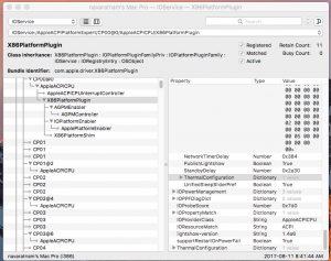

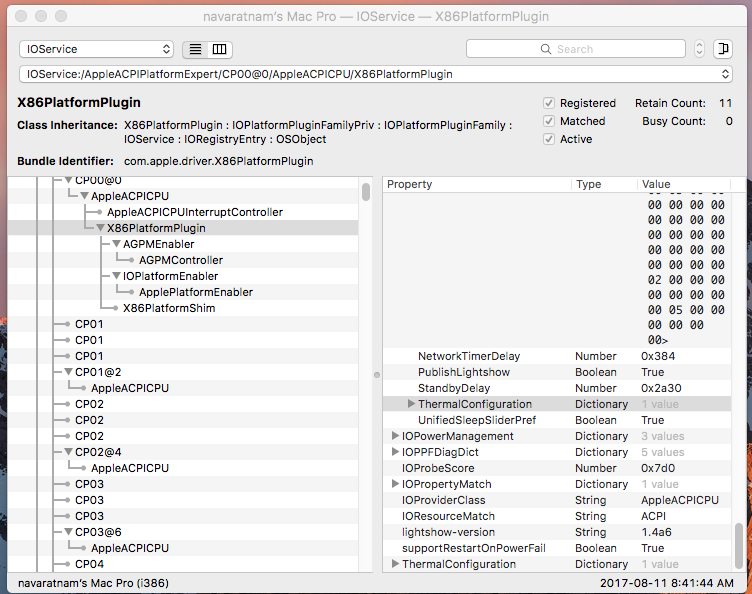

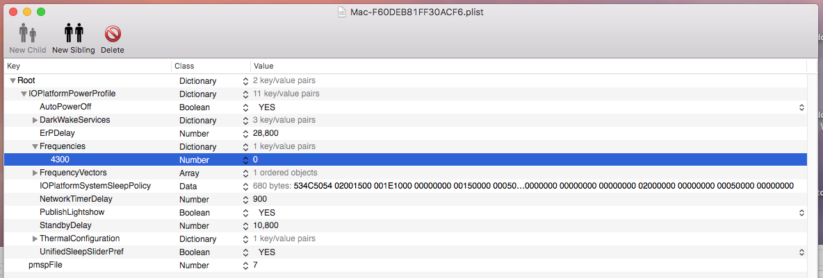

XCPM
I add some missing data for FrequencyVectors. (ThermalConfiguration,IOPlatformSystemSleepPolicy)
just replace in IOPlatformPluginFamily.kext
its worked well No panic 10.12 and 10.13
change your Frequencies I made 4300
XCPM_enabler.zip

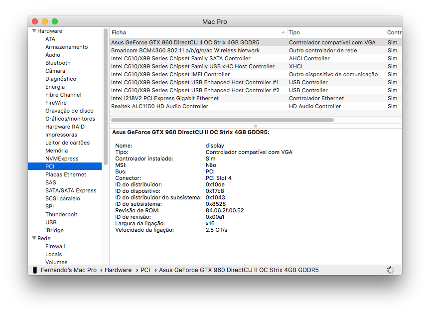

I apologize for not being able to confirm sooner but I have encountered some problems and it took more time for the tests.
As far as AppleALC is concerned, it works perfectly after changing the id leyout in 0x01
The tricky part is that after installing Nvidia Webdriver, the sound stops working, but it appears to be active in the sound manger.
Do you have any idea what I should do to make AppleALC, Realtek ALC1150, work with the Video Driver installed?
Or if anyone here knows what to do? Any advice is welcome.

One issue left is, in my AppleIntelInfo.data output, the IA32_ENERGY_PERF_BIAS is  0. pikeralpha says it should be [1,15].
Did you have similar issue?
Can someone please help me, I cant seem to get my osx to boot correctly anymore. I lost my usb that contained my efi folder. I tried to rebuild the efi folder but it doesn't seem like it wants to boot.
My set up is the i7 MSI x99a in my signature.
EFI.zip
Try without Fake Cpu ID
Leave empty
  • 2 weeks later...
I was working for 4 days trying to understand and fixing this but it's quite hard without some can guide you through your problem so I just decided to ask here maybe someone will help me.
I have a C612 running High Sierra DP7. with dual engineering sample processors E5-2690v4 and VEGA FE
I just wanna know is there any different xnu power management scheme in my case?
I add  FakeCPUID 0x040674 then run FreqEditVectors.sh to inject the missing data. I used one of the plists of the iMac17,1 and I knew it's not recommended to use max turbo patches from okrasit but I just test how the performance will be and it was quite higher on both my CPU and GPU. but the moment I disable the patch the performance drops again.
I also spoke with pikeralpha and he pointed that its not normal to have iMac17,1 but IA32_ENERGY_PERF_BIAS is 5 and not 1 so that doesn’t appear to work, I tried several things to make this work but I couldn't change it to what he suggested.
- So I wanna know a couple of things is it my power management looking good?
- what can I actually do to get a better result?
- How I can make IA32_ENERGY_PERF_BIAS be .(0x1B0) : 0x1 (highest performance) ?
​update: using latest clover r4200 seem to fix the problem now I have A32_ENERGY_PERF_BIAS be .(0x1B0) : 0x1 that mean highest performance. but I still struggling to reach my max turbo freq any help will be appreciate it.
I add my latest working EFI folder.

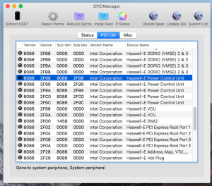

X99 Haswell-E power control Unit worked with AppleIntelPCHPMC.kext 10.13
AppleIntelPCHPMC.kext 10.13_X99.zip
What is this kext good for nmano ?
I m still trying to get C -states but now in High sierra same thing
Power control unit my guess support for HWSensors and FakeSMC.
Hi,@nmano
​I tried several solution to have a proper power management with my CPUs. Like Brumbaer's PMDrvr.kext but its not optimized to my motherboard and cpus config, I am always on the high range frequencies even on idle is there anything I can do to enhance the speed stepping of my cpus?
​I am at HS final release and I have a dual Broadwell-EP cpus.
I wanna mention that when I change in the bios the CPU HWPM STATE CONTROL to HWPM OOB MODE I can have a really fantastic CPU power management performance, but I can never reach the max performance even if I used performance fix from oarksit in clover patch section. but when I disable this option in the bios I can reach the highest frequency but with poor power management.

Hi,@nmano

Check my EFI folder XCPM_config_kexts.
10.13_X99 Final_EFI.zip
I check it out, and I noticed that you have a kext to make your AppleLPC.kext Load. So I thought this is maybe the reason for not making my power management working well, I add a patch to my DSDT file and its worked fine. I mean the AppleLPC.kext.
Still with no different result in my cpus power management. I also checked several things but with no luck. by the way no one with Broadwell-EP cpus have proper power management performance under HS 10.13  I checked and I asked several people with the same cpus and I can say no result, its really frustrating.
I attached also my EFI file can you check it out? maybe I missed something.
EFI c612 10.13.zip
