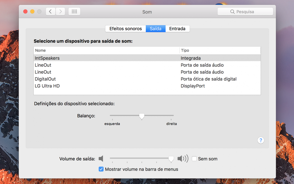

I have 3 installations of Sierra, and it´s always the same. I can boot with AppleALC when i use InsanelyRepairPermission befor.
This works fine, but when macOS changes something and rebuild caches it self, i can´t boot.
Tested this with ONYX and delete & rebuild caches. System don´t boot. I have to use -alcoff and it boots fine.
Now running InsanelyRepairPermission, and it boots again.
I have no idea, with 10.11.6 i never had this problems.
I had an issue with 10.12.1 and AppleALC too. On my ASRock Z170 Fatal1ty ITX (Realtek ALC1150) caused kernel panic every time I rebuilt kernel cache. Even after unistall it, the behavior never stopped. Tried a fresh install with no audio at all, and everithing is fine. Back to PikeRalpha/Toleda's method. Still not sure about AppleALC relation, though.
Tested a few minutes ago again with 10.12.1 and AppleALC. System hangs at boot. When i use -alcoff my system boots.
So back to patched AppleHDA and it boots every time.
I download a new 10.12.1 Sierra installer from App Store and make a complete fresh and clean install this weekend.
And i hope i can boot with nv_disable=1 to installer and login.
With EC i never had any issues or problems
Being curious, I again tested the patch Toleda
Everything appears fine but no sound
So back to AppleACL
Surprising
For information, be aware that the majority of the patch in AppleACL.kext are Toleda
look here AppleALC.kext/Contents/PlugIns/PinConfigs.kext/Contents/Info.plist

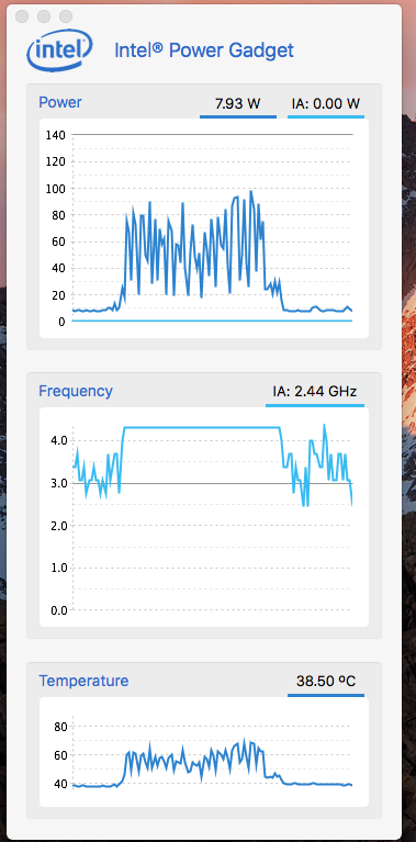

I am happy with XCPM.
My config and bios setting
XMP: profile 1
C1E: Disabled
C6/C7: Enable
CPU Thermal Monitor: Enabled
C3: Enable
EIST: Disable
IA32_MISC_ENABLES................(0x1A0) : 0x850089
MSR_POWER_CTL....................(0x1FC) : 0x21040059
 - C1E Enable............................: 0 (disabled)

IA32_MPERF.......................(0xE7)  : 0x1E520E3971
IA32_APERF.......................(0xE8)  : 0x2942B9076B
MSR_FLEX_RATIO...................(0x194) : 0xE0000
MSR_IA32_PERF_STATUS.............(0x198) : 0x27F500002B00
 - Current Performance State Value...... : 0x2B00 (4300 MHz)
MSR_IA32_PERF_CONTROL............(0x199) : 0x3200
 - Target performance State Value....... : 0x3200 (5000 MHz)
 - Intel Dynamic Acceleration........... : 0 (IDA engaged)
IA32_CLOCK_MODULATION............(0x19A) : 0x0
IA32_THERM_STATUS................(0x19C) : 0x88380000
 - Fast-Strings......................... : 1 (enabled)
 - Automatic Thermal Control Circuit.... : 1 (enabled)
 - Performance Monitoring............... : 1 (available)
 - Processor Event Based Sampling....... : 0 (PEBS supported)
 - Enhanced Intel SpeedStep Technology.. : 1 (enabled)
 - MONITOR FSM.......................... : 1 (MONITOR/MWAIT supported)
 - CFG Lock............................. : 0 (MSR not locked)
MSR_TEMPERATURE_TARGET...........(0x1A2) : 0x591200
 - Turbo Attenuation Units.............. : 0
 - Temperature Target................... : 89
 - TCC Activation Offset................ : 0
MSR_MISC_PWR_MGMT................(0x1AA) : 0x400001
 - EIST Hardware Coordination........... : 1 (hardware coordination disabled)
 - Energy/Performance Bias support...... : 1
 - Energy/Performance Bias.............. : 0 (disabled/MSR not visible to software)
 - Thermal Interrupt Coordination Enable : 1 (thermal interrupt routed to all cores)
MSR_TURBO_RATIO_LIMIT............(0x1AD) : 0x2B2B2B2B2B2B2B2B
 - Maximum Ratio Limit for C01.......... : 2B (4300 MHz)
 - Maximum Ratio Limit for C02.......... : 2B (4300 MHz)
 - Maximum Ratio Limit for C03.......... : 2B (4300 MHz)
 - Maximum Ratio Limit for C04.......... : 2B (4300 MHz)
 - Maximum Ratio Limit for C05.......... : 2B (4300 MHz)
 - Maximum Ratio Limit for C06.......... : 2B (4300 MHz)
 - Maximum Ratio Limit for C07.......... : 2B (4300 MHz)
 - Maximum Ratio Limit for C08.......... : 2B (4300 MHz)
IA32_ENERGY_PERF_BIAS............(0x1B0) : 0x1
 - Power Policy Preference...............: 1 (highest performance)
MSR_RAPL_POWER_UNIT..............(0x606) : 0xA0E03
 - Power Units.......................... : 3 (1/8 Watt)
 - Energy Status Units.................. : 14 (61 micro-Joules)
 - Time Units .......................... : 10 (976.6 micro-Seconds)
MSR_PKG_POWER_LIMIT..............(0x610) : 0x7FFD00014EA82
 - Package Power Limit #1............... : 3408 Watt
 - Enable Power Limit #1................ : 1 (enabled)
 - Package Clamping Limitation #1....... : 0 (disabled)
 - Time Window for Power Limit #1....... : 10 (2560 milli-Seconds)
 - Package Power Limit #2............... : 4090 Watt
 - Enable Power Limit #2................ : 1 (enabled)
 - Package Clamping Limitation #2....... : 1 (allow going below OS-requested P/T state setting Time Window for Power Limit #2)
 - Time Window for Power Limit #2....... : 3 (20 milli-Seconds)
 - Lock................................. : 0 (MSR not locked)
MSR_PKG_ENERGY_STATUS............(0x611) : 0x10F20D8E
 - Total Energy Consumed................ : 17352 Joules (Watt = Joules / seconds)
MSR_PKG_POWER_INFO...............(0x614) : 0x1280460
 - Thermal Spec Power................... : 140 Watt
 - Minimum Power........................ : 0
 - Maximum Power........................ : 0
 - Maximum Time Window.................. : 0
MSR_PP0_POWER_LIMIT..............(0x638) : 0x14FFD0
 - Power Limit.......................... : 4090 Watt
 - Enable Power Limit................... : 1 (enabled)
 - Clamping Limitation.................. : 0 (disabled)
 - Time Window for Power Limit.......... : 10 (10240 milli-Seconds)
MSR_PP0_ENERGY_STATUS............(0x639) : 0x0
MSR_TURBO_ACTIVATION_RATIO.......(0x64C) : 0x0
MSR_CONFIG_TDP_NOMINAL...........(0x648) : 0x1E
MSR_CONFIG_TDP_LEVEL1............(0x649) : 0x940000001B0460
MSR_CONFIG_TDP_LEVEL2............(0x64a) : 0x94000000000000
MSR_CONFIG_TDP_CONTROL...........(0x64b) : 0x0
MSR_TURBO_ACTIVATION_RATIO.......(0x64c) : 0x0
MSR_PKGC6_IRTL...................(0x60b) : 0x0
MSR_PKG_C2_RESIDENCY.............(0x60d) : 0x195D174B216
MSR_PKG_C3_RESIDENCY.............(0x3f8) : 0x18ACFE
MSR_PKG_C6_RESIDENCY.............(0x3f9) : 0x204F75C468C
IA32_TSC_DEADLINE................(0x6E0) : 0x734841C043E
CPU Ratio Info:
Base Clock Frequency (BLCK)............. : 100 MHz
Maximum Efficiency Ratio/Frequency.......: 12 (1200 MHz)
Maximum non-Turbo Ratio/Frequency........: 30 (3000 MHz)
Maximum Turbo Ratio/Frequency............: 43 (4300 MHz)
P-State ratio * 100 = Frequency in MHz
CPU P-States [ 37 (43) ]
CPU C3-Cores [ 1 2 7 8 10 12 15 ]
CPU C6-Cores [ 0 2 4 7 8 10 12 14 ]
CPU P-States [ 27 37 (43) ]
CPU C3-Cores [ 1 2 6 7 8 10 12 14 15 ]
CPU C6-Cores [ 0 2 3 4 6 7 8 10 12 14 ]
CPU P-States [ (12) 27 28 37 43 ]
CPU C3-Cores [ 0 1 2 6 7 8 10 12 14 15 ]
CPU C6-Cores [ 0 1 2 3 4 6 7 8 10 12 14 ]
CPU P-States [ 12 27 28 37 39 (43) ]
CPU P-States [ 12 27 28 31 37 39 (43) ]
CPU C6-Cores [ 0 1 2 3 4 6 7 8 9 10 12 14 ]
CPU P-States [ 12 27 28 31 33 37 39 (43) ]
CPU C6-Cores [ 0 1 2 3 4 6 7 8 9 10 11 12 14 ]
CPU C6-Cores [ 0 1 2 3 4 5 6 7 8 9 10 11 12 14 ]
CPU C6-Cores [ 0 1 2 3 4 5 6 7 8 9 10 11 12 13 14 ]
CPU P-States [ (12) 27 28 31 33 35 37 39 43 ]
CPU P-States [ (12) 27 28 31 33 35 37 39 41 43 ]
CPU P-States [ (12) 27 28 29 31 33 35 37 39 41 43 ]
CPU C3-Cores [ 0 1 2 6 7 8 10 12 13 14 15 ]
CPU P-States [ (12) 25 27 28 29 31 33 35 37 39 41 43 ]
CPU C3-Cores [ 0 1 2 3 6 7 8 10 11 12 13 14 15 ]
CPU C6-Cores [ 0 1 2 3 4 5 6 7 8 9 10 11 12 13 14 15 ]
CPU P-States [ (12) 23 25 27 28 29 31 33 35 37 39 41 43 ]
CPU P-States [ (12) 23 25 27 28 29 30 31 33 35 37 39 41 43 ]
CPU P-States [ 12 23 25 27 28 29 30 31 33 34 35 37 39 41 (43) ]
CPU P-States [ 12 23 25 27 28 29 30 31 33 34 35 37 38 39 41 (43) ]
CPU P-States [ 12 23 25 26 27 28 29 30 31 33 34 35 37 38 39 41 (43) ]
CPU P-States [ 12 23 25 26 27 28 29 30 31 33 34 35 36 37 38 39 41 (43) ]
manoranjans-Pro:~ manoranjan$

And I finally managed to get sound from the ALC1150 through original AppleHDA.
Bye bye voodooHDA and thanks for everything :P
