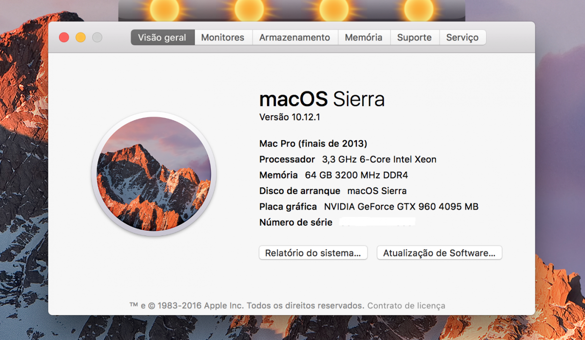

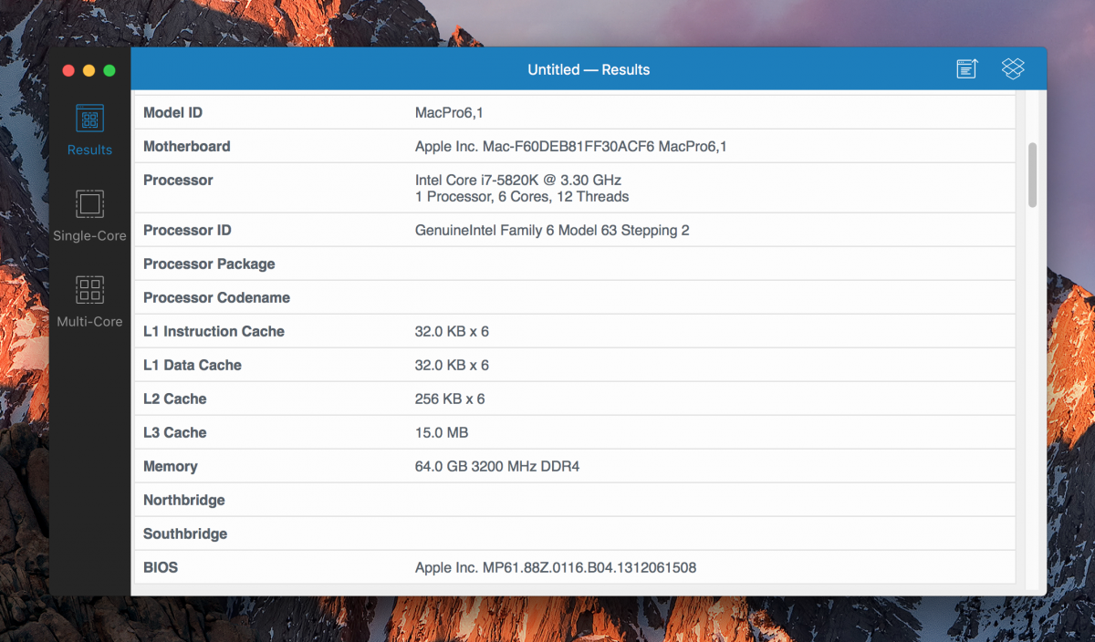

I do not usually use (Intel® XMP) or overclock cause I do not feel the need to do it and prefer to work with the lowest possible temperature. But if i select XMP Profile 1, in the "About This Mac" the correct speed of the RAM automatically appears, in my case 3200Mhz and it works stably and with more score, but as I said I do not feel the need to use it.

are you sure that ram work at 3200 in osx???? I don't think osx could support that speed!!

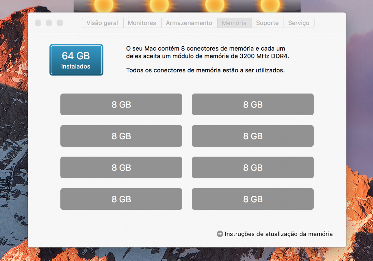

The only thing that proves what I said is these prints. Whether OSX supports it or not, it seems to me it supports. And as I said, it takes the maximum RAM speed and increases the GB score if I select XMP in Profile 1. With XMP disabled, it shows only the base speed 2333Mhz and the GB obviously decreases!
Doubts? :P
Doubts? :P
Can you post your extended GB changes pre and post XMP?
I have always been curious about the impact.
Doubts? :P
In system preferences I've that screen too...in my case is 3000 because my ram is so. But if I set in bios auto or 3000 at frequency speed OS X hangs. That is only "cosmetic" it sees your hardware specs and it doesn't mean that your ram runs at 3200

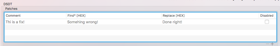

Can't it be patched in the ACPI tab of clover configurator? like:
it would be awesome!
Well if it's really just cosmetic I do not know! GB also says the same information...
