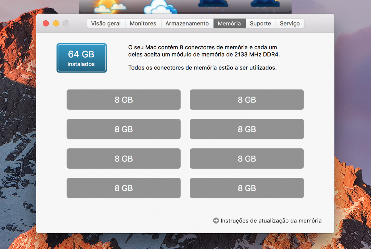

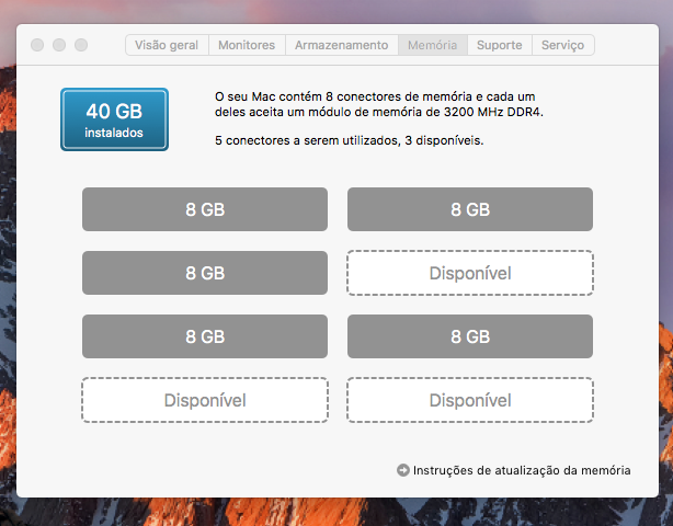

OS X doesn't like 48GB of RAM (only recognizes 40), I gave him 64GB and is happy now... yeah
​Edit: Now OS X waits for the perfect plist with the perfect patches made by pikeralpha findings, SammlerG, nmano and other users variations :D
