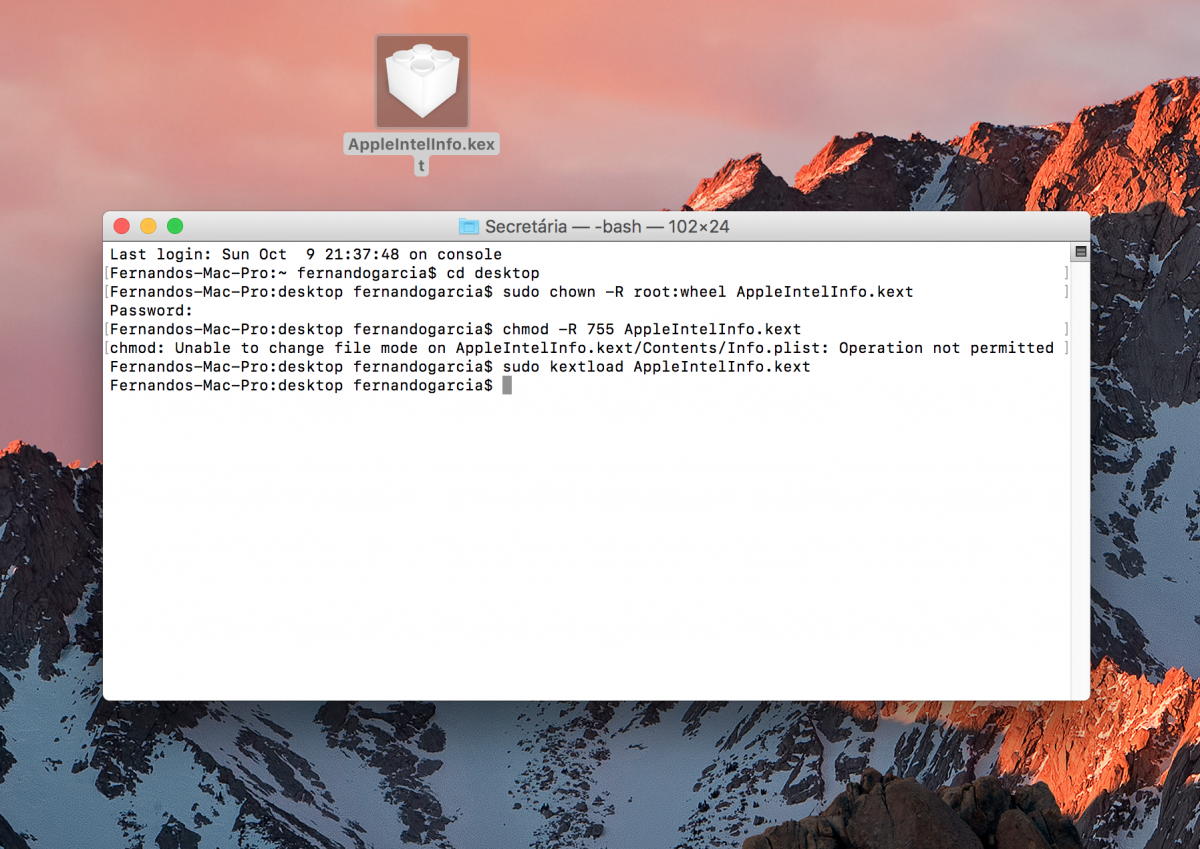

Fergarth Posted October 9, 2016 Share Posted October 9, 2016 delete all Appleintelinfo.kext in kext clover or in S/L/E if you have copy it on your desktop before then open terminal cd desktop sudo chown -R root:wheel AppleIntelInfo.kext chmod -R 755 AppleIntelInfo.kext sudo kextload AppleIntelInfo.kext if it starts check msr 0XE2 value PS. during this writing my system reboots one time.. and restart without USB 2 only 3 working i have to investigate and maybe delete some line of the config.plist of nmano/SammlerG I used:-) edit added kext if you need it Thanks Fabio, this one not reboot the system, but not run... Link to comment https://www.insanelymac.com/forum/topic/313296-guide-mac-osx-1012-and-1013-with-x99-broadwell-e-family-and-haswell-e-family/page/11/#findComment-2296764 Share on other sites More sharing options...
Fergarth Posted October 9, 2016 Share Posted October 9, 2016 Try this without Fake ID Hi boss, With this your .plist, i does not have restarts, open and runs stable as a good boy. I tested with IEST active and inactive and behavior in Power Gadget looks the same and performance is the same also. But it works without errors and is stable. I can not test with appleintelinfo, cause not run on my system and I do not know why... Should I use IEST disable or enable? Now I´m using disable. At this point i dont use any SSDT for PM. Should I use or with this patchs is not need? And one more innocent question: How can I confirm that my BIOS is unlocked? This because AppleIntelInfo not run on my system, and I don´t know why...any alternatives? Thanks. 1 Link to comment https://www.insanelymac.com/forum/topic/313296-guide-mac-osx-1012-and-1013-with-x99-broadwell-e-family-and-haswell-e-family/page/11/#findComment-2296771 Share on other sites More sharing options...

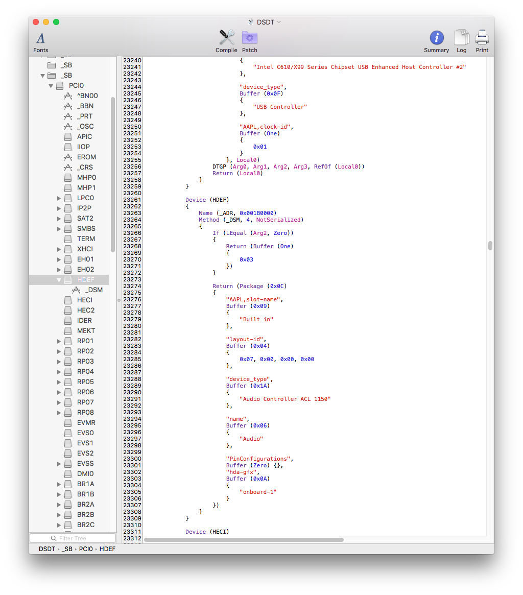

Fljagd Posted October 10, 2016 Share Posted October 10, 2016 Hi, Fljagd : Thanks for your EFI and setup info for Asus X99A MB. I'm using GTX-960 display card. Just want to know whether internal ALC-1150 audio and HDMI audio from AMD 7950 working or not. Or you have disabled ALC-1150 and applied VoodooHDA ? Also in your DSDT.aml there is no PEGP or HDAU patching. How many display ports working from AMD 7950 ? Hello, ALC1150 works well with VoodooHDA 2.8.9 or AppleACL All video ports (2DP, 1 DVI, 1 HDMI) works well (HD 7950) HDMI Audio is not working My DSDT is iGPU HDAU AND HDEF H000 re name iGPU H001 re name HDAU 2 Link to comment https://www.insanelymac.com/forum/topic/313296-guide-mac-osx-1012-and-1013-with-x99-broadwell-e-family-and-haswell-e-family/page/11/#findComment-2296881 Share on other sites More sharing options...

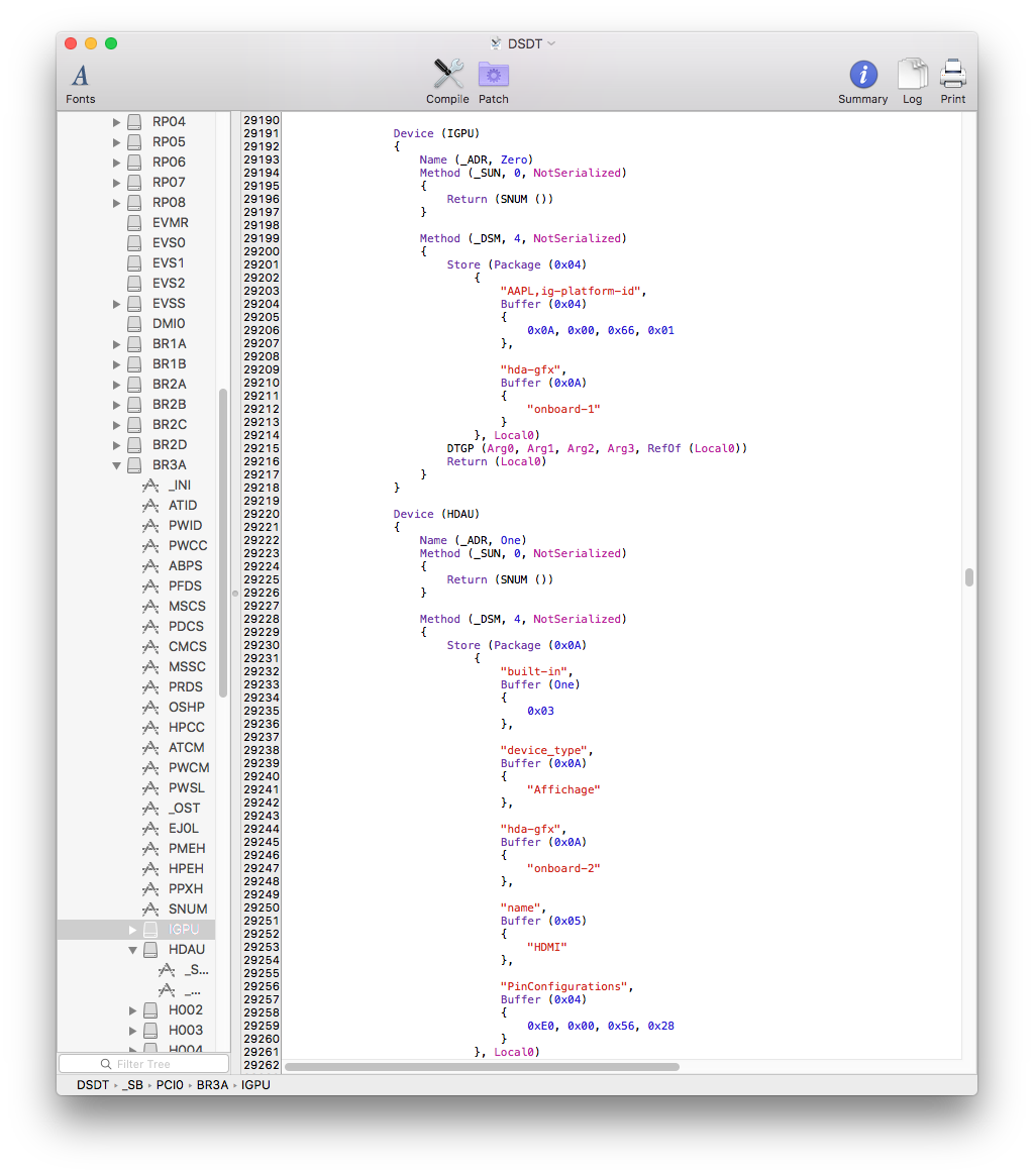

jsl Posted October 11, 2016 Share Posted October 11, 2016 Hello, ALC1150 works well with VoodooHDA 2.8.9 or AppleACL All video ports (2DP, 1 DVI, 1 HDMI) works well (HD 7950) HDMI Audio is not working My DSDT is iGPU HDAU AND HDEF H000 re name iGPU H001 re name HDAU Thanks for your kind help and prompt reply. I'll try to edit it to fit my Nvidia GTX-960 display card and make its HDMI audio working without HDMIAudio.kext currently used. Link to comment https://www.insanelymac.com/forum/topic/313296-guide-mac-osx-1012-and-1013-with-x99-broadwell-e-family-and-haswell-e-family/page/11/#findComment-2297493 Share on other sites More sharing options...

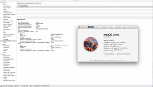

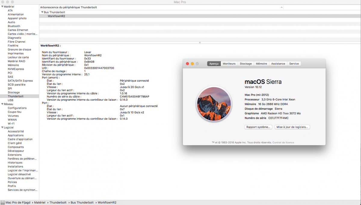

Fljagd Posted October 11, 2016 Share Posted October 11, 2016 What happiness !!!The thunderbolt is operational on my X99-A 2 Link to comment https://www.insanelymac.com/forum/topic/313296-guide-mac-osx-1012-and-1013-with-x99-broadwell-e-family-and-haswell-e-family/page/11/#findComment-2297622 Share on other sites More sharing options...
thenightflyer Posted October 11, 2016 Share Posted October 11, 2016 What happiness !!! The thunderbolt is operational on my X99-A To show active status did you attach a peripheral? If so what peripheral, hd? sound card? Link to comment https://www.insanelymac.com/forum/topic/313296-guide-mac-osx-1012-and-1013-with-x99-broadwell-e-family-and-haswell-e-family/page/11/#findComment-2297641 Share on other sites More sharing options...
Fljagd Posted October 11, 2016 Share Posted October 11, 2016 (edited) To show active status did you attach a peripheral? If so what peripheral, hd? sound card? Yes my peripheral is plug Hdd -SSD- SD card I use https://www.amazon.fr/Lexar-Professional-Workflow-lecteurs-Thunderbolt/dp/B00L3JYATO/ref=sr_1_1?ie=UTF8&qid=1476194583&sr=8-1&keywords=lexar+thunderbolt Edited October 11, 2016 by Fljagd Link to comment https://www.insanelymac.com/forum/topic/313296-guide-mac-osx-1012-and-1013-with-x99-broadwell-e-family-and-haswell-e-family/page/11/#findComment-2297647 Share on other sites More sharing options...
thenightflyer Posted October 11, 2016 Share Posted October 11, 2016 Yes my peripheral is plug Hdd -SSD- SD card I use https://www.amazon.fr/Lexar-Professional-Workflow-lecteurs-Thunderbolt/dp/B00L3JYATO/ref=sr_1_1?ie=UTF8&qid=1476194583&sr=8-1&keywords=lexar+thunderbolt Did you try to compress and uncompresso, copy move small file size? I use a Lacia Big Disk raid TB2 and sometimes when using unrar or moving/copying big or small files it hangs and disconnect and gives me I/O Error. Same with another TB disk...maybe it's because of allocation problems. Link to comment https://www.insanelymac.com/forum/topic/313296-guide-mac-osx-1012-and-1013-with-x99-broadwell-e-family-and-haswell-e-family/page/11/#findComment-2297649 Share on other sites More sharing options...
Fljagd Posted October 11, 2016 Share Posted October 11, 2016 I did some testing with multiple filesJ have make a copy of, multiple file of 4.6 GBAll went well I have not tested the compressionAlso I have disassembled the map it was a test, I mounted a deluxe X99I can take the test on the deluxe Link to comment https://www.insanelymac.com/forum/topic/313296-guide-mac-osx-1012-and-1013-with-x99-broadwell-e-family-and-haswell-e-family/page/11/#findComment-2297655 Share on other sites More sharing options...
thenightflyer Posted October 11, 2016 Share Posted October 11, 2016 I did some testing with multiple files J have make a copy of, multiple file of 4.6 GB All went well I have not tested the compression Also I have disassembled the map it was a test, I mounted a deluxe X99 I can take the test on the deluxe It would be appreciated if you could post screenshots of thunderbolt device menu in your bios...X99 A and Deluxe have the same bios and bios menu. Link to comment https://www.insanelymac.com/forum/topic/313296-guide-mac-osx-1012-and-1013-with-x99-broadwell-e-family-and-haswell-e-family/page/11/#findComment-2297656 Share on other sites More sharing options...
Fljagd Posted October 11, 2016 Share Posted October 11, 2016 works well also with the compressed file (zip) It would be appreciated if you could post screenshots of thunderbolt device menu in your bios...X99 A and Deluxe have the same bios and bios menu. here for deluxe For X99-A it is the same principle Deluxe.zip 1 Link to comment https://www.insanelymac.com/forum/topic/313296-guide-mac-osx-1012-and-1013-with-x99-broadwell-e-family-and-haswell-e-family/page/11/#findComment-2297658 Share on other sites More sharing options...
