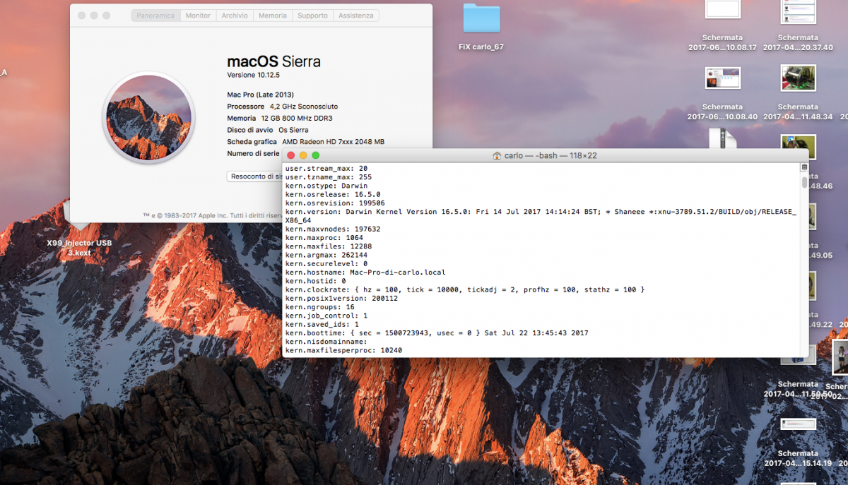

carlo_67 Posted July 22, 2017 Share Posted July 22, 2017 Can someone test this please Good 10.12.5 Try updating 10.12.6 1 Link to comment https://www.insanelymac.com/forum/topic/312714-amd-macos-1012x-sierra-kernel-testing-release-for-help-use-the-help-topic/page/28/#findComment-2467348 Share on other sites More sharing options...

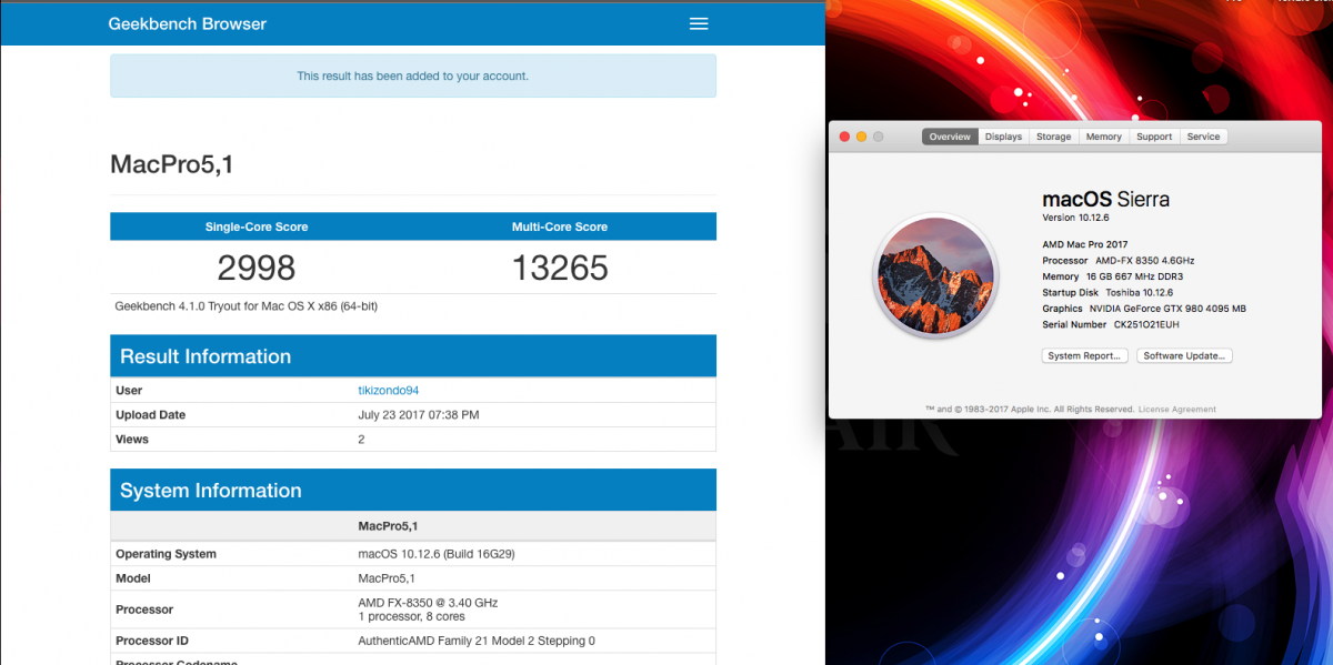

tikizondo94 Posted July 23, 2017 Share Posted July 23, 2017 Good 10.12.5 Try updating 10.12.6 I updated fine to 10.12.6. Used your "Fix Carlo_67" files and all is working normal for me. I use USBv3 Fix for El captian to get my USB working properly. Machine is smooth as butter 1 Link to comment https://www.insanelymac.com/forum/topic/312714-amd-macos-1012x-sierra-kernel-testing-release-for-help-use-the-help-topic/page/28/#findComment-2467898 Share on other sites More sharing options...

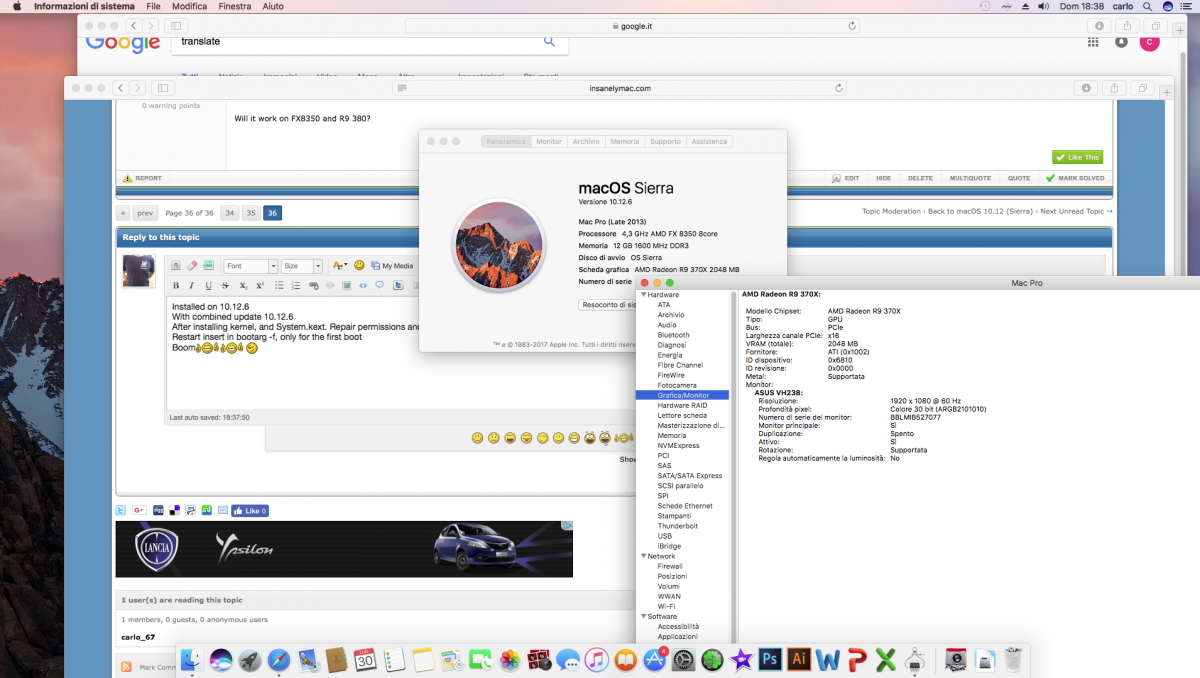

carlo_67 Posted July 30, 2017 Share Posted July 30, 2017 Installed on 10.12.6 With combined update 10.12.6After installing kernel, and System.kext. Repair permissions and cachesRestart insert in bootarg -f, only for the first bootBoom 2 Link to comment https://www.insanelymac.com/forum/topic/312714-amd-macos-1012x-sierra-kernel-testing-release-for-help-use-the-help-topic/page/28/#findComment-2471815 Share on other sites More sharing options...

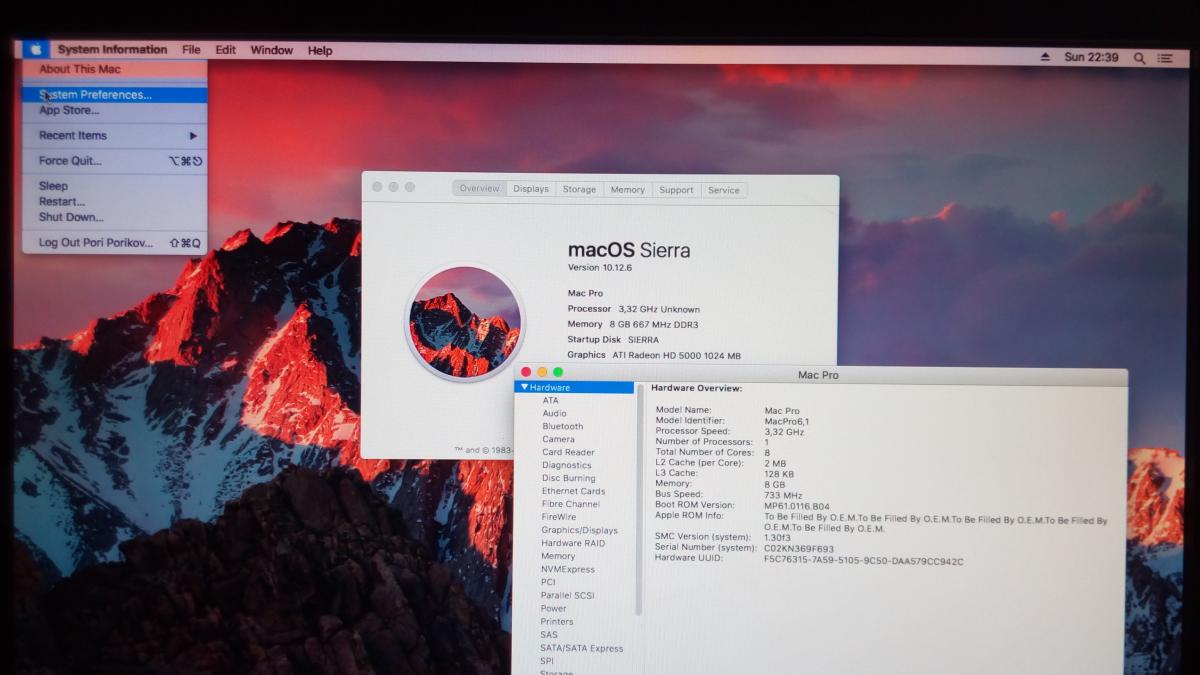

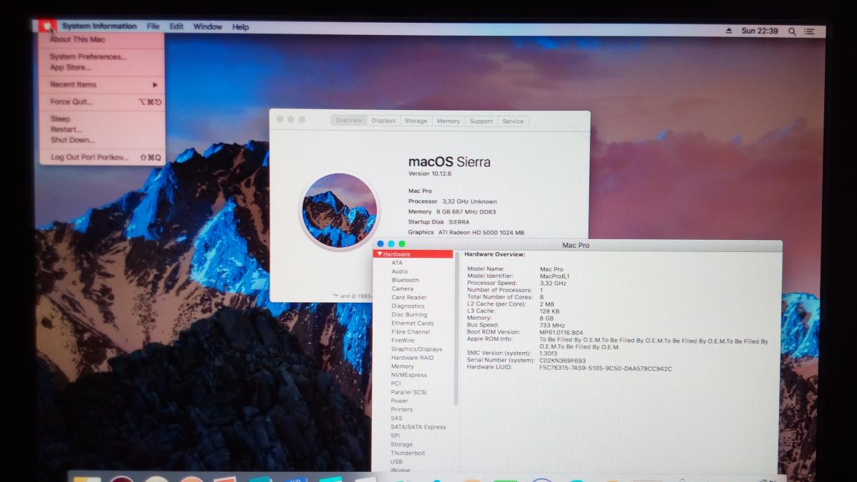

skillz33 Posted August 12, 2017 Share Posted August 12, 2017 Hey! just used the fix from Carlos - boot into the installer and type in the args Carlos type in his post. The installation writes on black background and white font many things and on the end "PCI configiration begins" after that line there is a message of the ram single bank - here the installer stops, after 30sec the pc shut down. Can anyone help? CPU: FX 8320 Eight core Board: MSI 970 Gaming Link to comment https://www.insanelymac.com/forum/topic/312714-amd-macos-1012x-sierra-kernel-testing-release-for-help-use-the-help-topic/page/28/#findComment-2478247 Share on other sites More sharing options...
spakk Posted August 13, 2017 Share Posted August 13, 2017 Hey! just used the fix from Carlos - boot into the installer and type in the args Carlos type in his post. The installation writes on black background and white font many things and on the end "PCI configiration begins" after that line there is a message of the ram single bank - here the installer stops, after 30sec the pc shut down. Can anyone help? CPU: FX 8320 Eight core Board: MSI 970 Gaming If the system stops at "PCI configilation begins" then one of these bootflags is missing: npci=0x2000 or npci=0x3000 Link to comment https://www.insanelymac.com/forum/topic/312714-amd-macos-1012x-sierra-kernel-testing-release-for-help-use-the-help-topic/page/28/#findComment-2478559 Share on other sites More sharing options...
