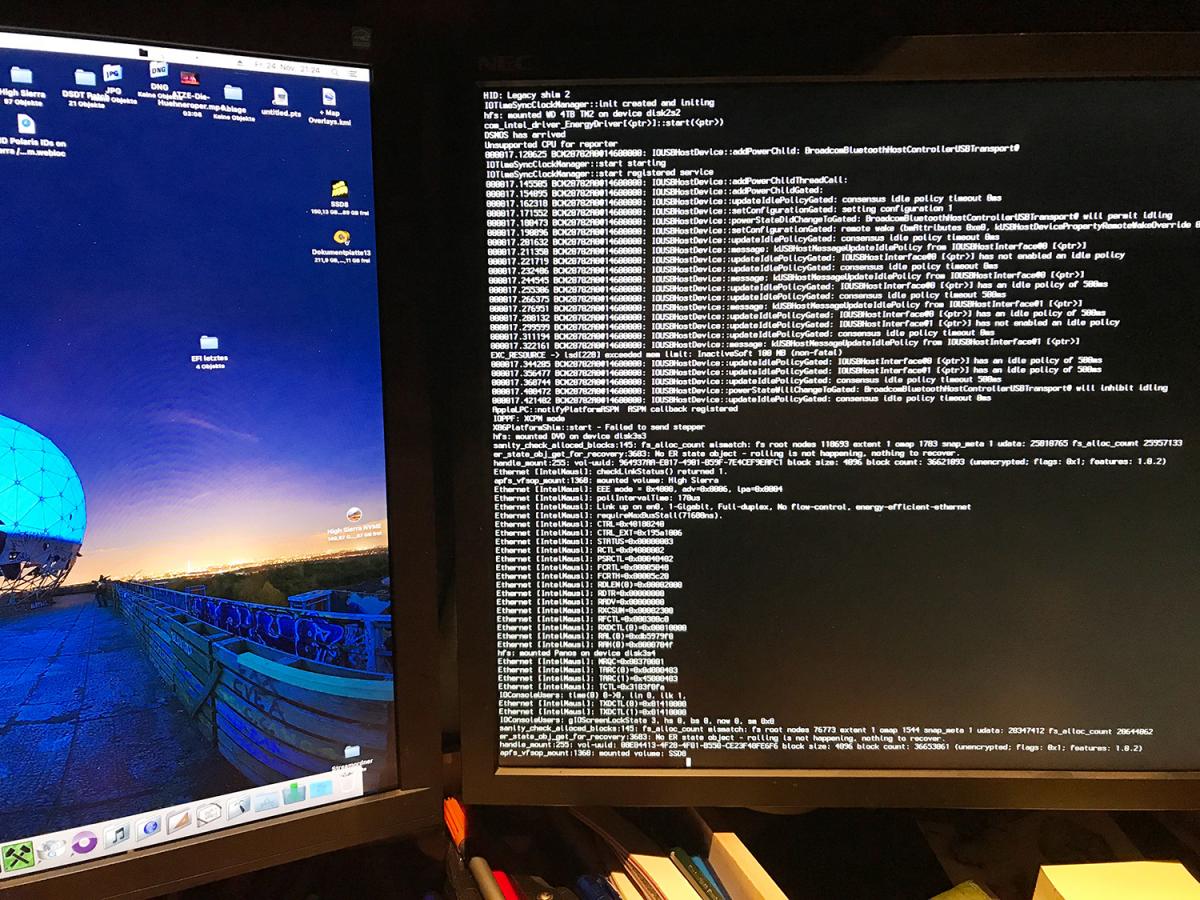

Pavo Posted November 24, 2017 Share Posted November 24, 2017 Hi Pavo, something happened to the upload. My Firefox isn´t uploading any more, I had to change the browser. Here is my reduced EfI folder with the 580 SDDT, minus themes and apple stuff. Leads to one working display and second display with frozen verbose text. Thanks in advance! screens.jpg Try this EFI, please test using as USB drive without changing or adding anything to it. EFI.zip Link to comment https://www.insanelymac.com/forum/topic/312582-amd-polaris-ids-on-sierra-high-sierra/page/29/#findComment-2539172 Share on other sites More sharing options...

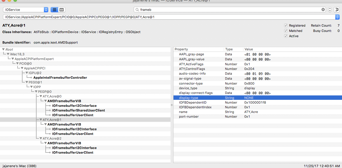

pinktank Posted November 25, 2017 Share Posted November 25, 2017 Just doesn't make any sense, can you screenshare into it and pull some logs? I made my own SSDT from scratch once again and it works to inject the framebuffer (confirmed via Ioregistryexplorer). But it did no good whatsoever for hdmi.. *edit updated file, it was the wrong one. For some reason, it doesn't inject the properties without device id and vendor. Anyhow, I tried ubuntu and it boots triple displays natively. Can one change the display type under a framebuffer? I see that Acre injects 'none' on hdmi as opposed to LCD on others *edit, with whatevergreen it does inject ld as display type, but that doesn't get hdmi either. Can somebody send me the 9500Controller kext from 10.3.2? SSDT-RX-560.zip Link to comment https://www.insanelymac.com/forum/topic/312582-amd-polaris-ids-on-sierra-high-sierra/page/29/#findComment-2539264 Share on other sites More sharing options...

Pavo Posted November 25, 2017 Share Posted November 25, 2017 I made my own SSDT from scratch once again and it works to inject the framebuffer (confirmed via Ioregistryexplorer). But it did no good whatsoever for hdmi.. *edit updated file, it was the wrong one. For some reason, it doesn't inject the properties without device id and vendor. Anyhow, I tried ubuntu and it boots triple displays natively. Can one change the display type under a framebuffer? I see that Acre injects 'none' on hdmi as opposed to LCD on others *edit, with whatevergreen it does inject ld as display type, but that doesn't get hdmi either. Can somebody send me the 9500Controller kext from 10.3.2? Looks to me that you still iGPU enabled Link to comment https://www.insanelymac.com/forum/topic/312582-amd-polaris-ids-on-sierra-high-sierra/page/29/#findComment-2539390 Share on other sites More sharing options...
