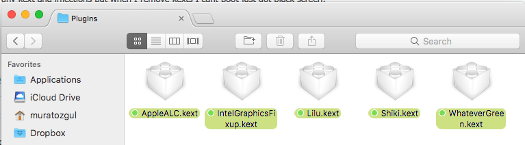

truemac Posted April 13, 2018 Share Posted April 13, 2018 (edited) 9 minutes ago, telepati said: Thank you so much. And I deleted it. Can I ask you one thing could you please check my config.plist; Many people saying RX560 working OOB without any kext and injections but when I remove kexts I cant boot just got black screen; config.plist is the boot problem solved? yes I can look at it which kext you are using? do you can boot if you disable KernelPM patch? Edited April 13, 2018 by truemac Link to comment https://www.insanelymac.com/forum/topic/312582-amd-polaris-ids-on-sierra-high-sierra/page/34/#findComment-2609590 Share on other sites More sharing options...

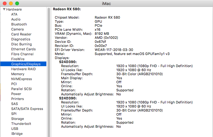

telepati Posted April 13, 2018 Share Posted April 13, 2018 (edited) 9 minutes ago, truemac said: is the boot problem solved? yes I can look at it I think yes boots now in 14 sec after clover boot screen. FakeSMC and Ethernet kexts inside of Clover/Others L/E USBInjectAll.kext and LiluFriend.kext Inside of LiluFriend; Another question; With this code HEVC video will work; Or this just for Airplay; 'cause when I try HEVC video with Quicktime I am getting this error; <dict> <key>IOGVAHEVCDecode</key> <string>1</string> <key>IOGVAHEVCEncode</key> <string>1</string> </dict> Edited April 13, 2018 by telepati 1 Link to comment https://www.insanelymac.com/forum/topic/312582-amd-polaris-ids-on-sierra-high-sierra/page/34/#findComment-2609592 Share on other sites More sharing options...
truemac Posted April 13, 2018 Share Posted April 13, 2018 (edited) please test this config.plist and delete shiki intelgraphicsfixup and Whatevergreen and Lilufriend and Put Usbinjectall Lilu and appleALC to clover repair permissions and rebuild kernel cache then reboot make sure you have a backup USB to boot from it if this don't work config.plist.zip Edited April 13, 2018 by truemac 1 Link to comment https://www.insanelymac.com/forum/topic/312582-amd-polaris-ids-on-sierra-high-sierra/page/34/#findComment-2609594 Share on other sites More sharing options...

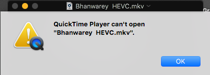

truemac Posted April 13, 2018 Share Posted April 13, 2018 (edited) 18 minutes ago, telepati said: Another question; With this code HEVC video will work; Or this just for Airplay; 'cause when I try HEVC video with Quicktime I am getting this error; <dict> <key>IOGVAHEVCDecode</key> <string>1</string> <key>IOGVAHEVCEncode</key> <string>1</string> </dict> no Quicktime don't support mkv files use other player like IINA Edited April 13, 2018 by truemac 1 Link to comment https://www.insanelymac.com/forum/topic/312582-amd-polaris-ids-on-sierra-high-sierra/page/34/#findComment-2609598 Share on other sites More sharing options...

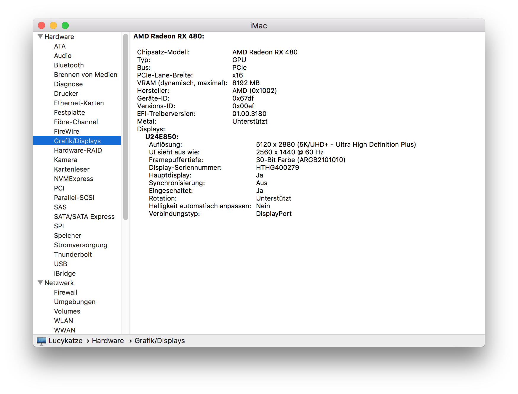

Mieze Posted April 24, 2018 Share Posted April 24, 2018 As the prices for Radeon cards have been dropping during the last weeks I finally decided to buy a Sapphire Radeon Nitro+ RX570 8GB and received the card this afternoon. With 10.13.4 Apple added a number of new framebuffer personalities to the AMD9500Controller.kext and as the framebuffer personality "Orinoco" matches the connector layout of my card (DP, DP, HDMI, HDMI, DVI) I decided to give it a try and got an instantly working system. No framebuffer patch is needed anymore. See for yourself: Mieze 2 Link to comment https://www.insanelymac.com/forum/topic/312582-amd-polaris-ids-on-sierra-high-sierra/page/34/#findComment-2611360 Share on other sites More sharing options...
Cyberdevs Posted April 25, 2018 Share Posted April 25, 2018 6 hours ago, Mieze said: As the prices for Radeon cards have been dropping during the last weeks I finally decided to buy a Sapphire Radeon Nitro+ RX570 8GB and received the card this afternoon. With 10.13.4 Apple added a number of new framebuffer personalities to the AMD9500Controller.kext and as the framebuffer personality "Orinoco" matches the connector layout of my card (DP, DP, HDMI, HDMI, DVI) I decided to give it a try and got an instantly working system. No framebuffer patch is needed anymore. See for yourself: As you can see the macOS is detected your GPU as RX 480 instead of RX 570 because those GPUs have the same device id which is not a big deal and it won't affect the performance but in my experience if I don't select the framebuffer and if I select InjectATI, the card will be detected correctly, the down side is that I lose the DP connectivity (Black Screen) only the HDMI ports work without a problem, however with the Board-ID patch all ports work ok, no more black screen on none of the ports. I don't use WhateverGreen in this scenario. Spoiler Kernel and Kext Patches:Name: com.apple.driver.AppleGraphicsDevicePolicyFind: BA050000 00Replace: BA000000 00Comment: Disable board-id check to prevent no signal © lvs1974, Pike R. Alpha, vit9696 I just thought you might be interested in this. 1 Link to comment https://www.insanelymac.com/forum/topic/312582-amd-polaris-ids-on-sierra-high-sierra/page/34/#findComment-2611386 Share on other sites More sharing options...
Mieze Posted April 25, 2018 Share Posted April 25, 2018 (edited) @Cyberdevs: Personally I don't care for the device name but the advantage to have a card which: is working out OOB has all ports working doesn't need any patches which may break after the next update is obvious and can't be overestimated. By the way, why do you have this ridiculous copyright notice in the comment of the patch? Looks like some of these so called "creators" haven't noticed yet, that you can't claim any copyright on a patch. Edited April 25, 2018 by Mieze Link to comment https://www.insanelymac.com/forum/topic/312582-amd-polaris-ids-on-sierra-high-sierra/page/34/#findComment-2611393 Share on other sites More sharing options...

Mieze Posted April 26, 2018 Share Posted April 26, 2018 @Cyberdevs: Unfortunately 10.13.4 isn't as comfortable as expected, at least not for users with 4k displays using DP. Although the board-id check is now obsolete, which is the good news, there is also bad news, as the wakeup issue has returned, at least with displays connected via DP. Now AGDC is enabled by default and with it MST support is active too which means that both DPs are combined in order to drive a 5k display. This is also the reason why my 4k display is recognized as a 5k display (see screenshot above). This change might be welcome for users with 5k display but effectively kills wakeup from sleep in my case because the framebuffer controller waits for the second link of the display to become active on it's second DP connector but as there is nothing connected, it times out in most cases leaving you with a black screen after wakeup. There are two ways to resolve the issue, use Whatevergreen or patch AMDSupport.kext to disable AGDC, which is what I did. So still no 100% RX5x0 support without patches. Mieze Link to comment https://www.insanelymac.com/forum/topic/312582-amd-polaris-ids-on-sierra-high-sierra/page/34/#findComment-2611637 Share on other sites More sharing options...

Mieze Posted April 27, 2018 Share Posted April 27, 2018 (edited) 10 hours ago, Cyberdevs said: Update: iMac18,1 detects my GPU correctly without any patching or injection or DSDT/SSDT patches, wake from sleep works normally with the exception of the sound. I assume the reason is that the iMac18,1 only has Intel Iris Plus Graphics 640. This suggests that MST activation mainly depends on the system definition because the 21.5" iMacs all have SST displays and only the 27" iMacs with their 5K display need MST. In case this theory is correct my machine should wakeup with iMac18,2 without having AGDC disabled as these machines also use SST displays. Well that makes sense and would explain the behavior. I'll run some tests as soon as possible. Mieze Edited April 27, 2018 by Mieze Link to comment https://www.insanelymac.com/forum/topic/312582-amd-polaris-ids-on-sierra-high-sierra/page/34/#findComment-2611723 Share on other sites More sharing options...
