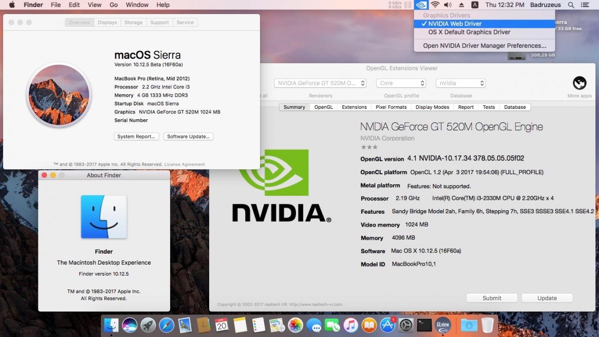

Badruzeus Posted April 20, 2017 Share Posted April 20, 2017 New version is out: https://images.nvidia.com/mac/pkg/378/WebDriver-378.05.05.05f02.pkg crash Done! Link to comment https://www.insanelymac.com/forum/topic/312525-nvidia-web-driver-updates-for-macos-sierra-update-sept-27-2019/page/33/#findComment-2407922 Share on other sites More sharing options...

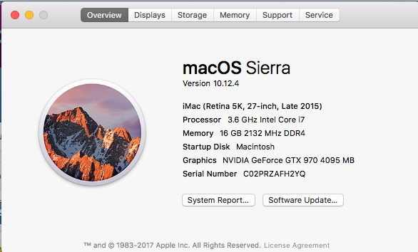

debauchery1st Posted April 20, 2017 Share Posted April 20, 2017 Confirmed Working ! Thanks to c_frio for pointing me to this thread. i7 Kaby Lake Gigabyte z270XP-SLI BIOS version f5 iMac 17,1 profile GTX-970 make sure that EmuVariableUefi.efi is installed in your EFI (I had to manually copy it... Clover didn't install the file when I upgraded regardless of it being selected) activate the driver from a terminal. $ sudo nvram nvda_drv=1 I was greeted with a black screen once the driver kicked in. To Fix the black screen: 1. unplug the monitor for a few seconds. 2. plug the monitor back in. Hope this tip helps someone out. 1 Link to comment https://www.insanelymac.com/forum/topic/312525-nvidia-web-driver-updates-for-macos-sierra-update-sept-27-2019/page/33/#findComment-2408693 Share on other sites More sharing options...
