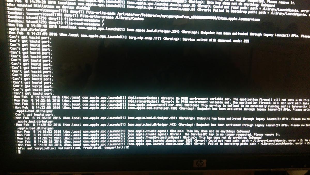

shaggymane Posted February 8, 2016 Share Posted February 8, 2016 I get a usbehci start stop error with these kernels Link to comment https://www.insanelymac.com/forum/topic/311245-help-topic-amd-os-x-el-capitan-1011/page/10/#findComment-2214120 Share on other sites More sharing options...

Kaya80 Posted February 8, 2016 Share Posted February 8, 2016 Now i'm stuck like my installation process can someone help me please? Link to comment https://www.insanelymac.com/forum/topic/311245-help-topic-amd-os-x-el-capitan-1011/page/10/#findComment-2214152 Share on other sites More sharing options...

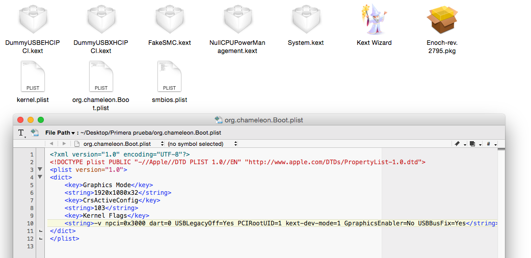

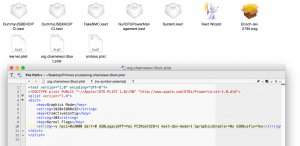

Lacedaemon Posted February 8, 2016 Share Posted February 8, 2016 With this flags i reach finally the GUI with Clover, but the installation doesn't start...if i try -x, the installation seems to start, it types " Using Safe mode", but stuck there, the hdd light stops and the process doesn't start, what else can i try? I'm stuck at the exact same thing Kaya. Your best bet for now is Enoch, until someone else can provide a solution. In the meantime, I'll keep trying, I don't want to give up on Clover just yet. With Enoch, make sure you boot with CsrActiveConfig=103. I've found that -f and npci=0x3000 are essential too. 1 Link to comment https://www.insanelymac.com/forum/topic/311245-help-topic-amd-os-x-el-capitan-1011/page/10/#findComment-2214255 Share on other sites More sharing options...
Kaya80 Posted February 8, 2016 Share Posted February 8, 2016 I'm stuck at the exact same thing Kaya. Your best bet for now is Enoch, until someone else can provide a solution. In the meantime, I'll keep trying, I don't want to give up on Clover just yet. With Enoch, make sure you boot with CsrActiveConfig=103. I've found that -f and npci=0x3000 are essential too. Ok, thanks Lacedaemon, i'll try again with Enoch, never flagged that option...can you tell me how to add this flag on Enoch? Edit: Problem with USB error, stop and restart repeatedly and the RTC causes me teethe same problem, and i have to reset CMOS...:(kernel seems to load fine, have to disable USB 3.0 in bios settings? Here is my Extra folder Extra.zip Link to comment https://www.insanelymac.com/forum/topic/311245-help-topic-amd-os-x-el-capitan-1011/page/10/#findComment-2214256 Share on other sites More sharing options...
Lacedaemon Posted February 8, 2016 Share Posted February 8, 2016 Ok, thanks Lacedaemon, i'll try again with Enoch, never flagged that option...can you tell me how to add this flag on Enoch? According to the files you uploaded, it's already in your org.chameleon.Boot.plist, so you don't have to worry about it. Although, even when I set it in my org.chameleon.Boot.plist, it won't use it for some reason, so I find it better to enter the flag manually. I'm not sure about the RTC problem, it seems you already have a kext for that. Also, change nvda_drv=1 to nv_disable=1 in org.chameleon.Boot.plist. Link to comment https://www.insanelymac.com/forum/topic/311245-help-topic-amd-os-x-el-capitan-1011/page/10/#findComment-2214277 Share on other sites More sharing options...
