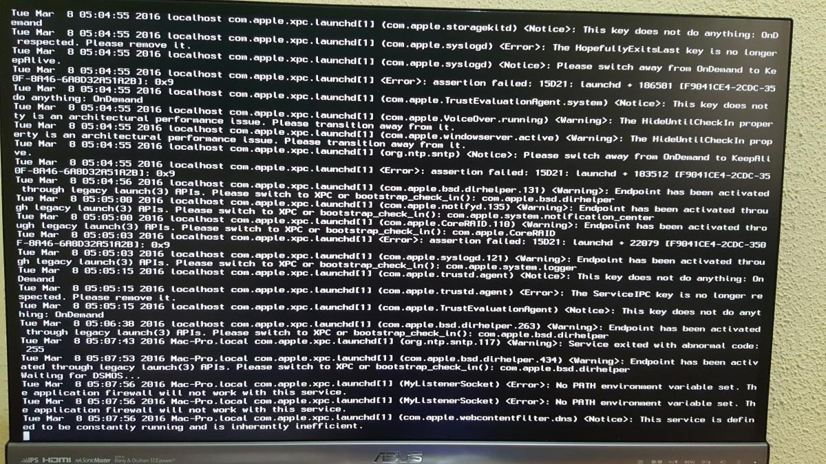

0xPure Posted March 7, 2016 Share Posted March 7, 2016 (edited) Boot loop is still appearing EDIT: I've removed all the kexts in /Extra/Extensions and now I only have: - FakeSMC.kext - NullCPUPowerManagement.kext - DummyUSBEHCIPCI.kext - DummyUSBXHCIPCI.kext Seems that the loop disappeared but now I'm stuck here: I'm gonna continue trying to solve it and will let you know if I got it! Special thanks to Spakk and Shaneee for the big help and patience Edited March 8, 2016 by AlexMnrs Link to comment https://www.insanelymac.com/forum/topic/311245-help-topic-amd-os-x-el-capitan-1011/page/13/#findComment-2221520 Share on other sites More sharing options...

0xPure Posted March 8, 2016 Share Posted March 8, 2016 Uhm, but my problem isn't “....Waiting for DSMOS” or “....DSMOS has arrived”..or .."Iobluetooth...". I don't understand what do you mean EDIT 1: Before the last image which I attached above, I can see many times an error like "__kernel__ couldn't find symbol" but it goes very fast so I can't see the full error. And then the boot gets stuck. EDIT 2: With the '10.11.2_AMD_6' kernel by Spakk I don't see any "__kernel__ couldn't find symbol" error but the boot is still getting stuck like the last image posted above. Link to comment https://www.insanelymac.com/forum/topic/311245-help-topic-amd-os-x-el-capitan-1011/page/13/#findComment-2221708 Share on other sites More sharing options...
spakk Posted March 8, 2016 Share Posted March 8, 2016 This loop also occurs with my kernel, too : "__kernel__ couldn't find symbol........... " to prevent/ suppress the loop, use the System.kext from the kernel package. I think, the seventh line from the bottom, may be an indication of graphics drivers problem. Link to comment https://www.insanelymac.com/forum/topic/311245-help-topic-amd-os-x-el-capitan-1011/page/13/#findComment-2221724 Share on other sites More sharing options...

spakk Posted March 8, 2016 Share Posted March 8, 2016 but why these line? No Path environment variable set the application firewall dont will work with this service ... AppleIntelCPUPowerManagement and AppleTyMCEDriver ... cause problems with amd cpu Link to comment https://www.insanelymac.com/forum/topic/311245-help-topic-amd-os-x-el-capitan-1011/page/13/#findComment-2221727 Share on other sites More sharing options...
0xPure Posted March 8, 2016 Share Posted March 8, 2016 but why these line? No Path environment variable set the application firewall dont will work with this service ... AppleIntelCPUPowerManagement and AppleTyMCEDriver ... cause problems with amd cpu I wish to know why, but I have no idea... Yes, I have removed them at the beginning. Only these two. Link to comment https://www.insanelymac.com/forum/topic/311245-help-topic-amd-os-x-el-capitan-1011/page/13/#findComment-2221729 Share on other sites More sharing options...
spakk Posted March 8, 2016 Share Posted March 8, 2016 ..waiting for Dsmos..possible cause by your GeForce GTX 970? remove all graphic drivers as described and boats again. Link to comment https://www.insanelymac.com/forum/topic/311245-help-topic-amd-os-x-el-capitan-1011/page/13/#findComment-2221731 Share on other sites More sharing options...
0xPure Posted March 8, 2016 Share Posted March 8, 2016 ..waiting for Dsmos..possible cause by your GeForce GTX 970? remove all graphic drivers as described and boats again. I don't think so... Because as I said, with USB Fix v3 package I can reach the installer without any graphic problem so... it has no sense, but I'm gonna try removing the graphics drivers. I notice you as soon as I check it. Link to comment https://www.insanelymac.com/forum/topic/311245-help-topic-amd-os-x-el-capitan-1011/page/13/#findComment-2221734 Share on other sites More sharing options...
