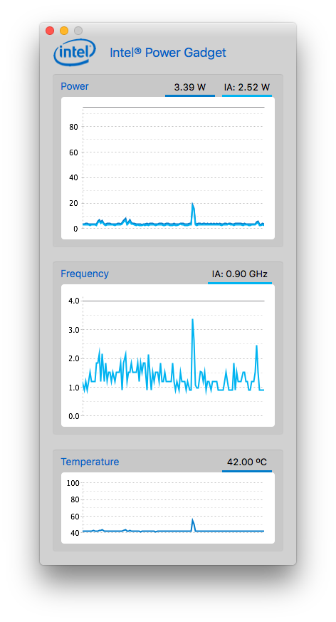

Cyberdevs Posted January 18, 2016 Author Share Posted January 18, 2016 I have found a way to fix SpeedStep problem. I found a kext called AppleIntelCPUPowerManagementInfo.kext and copied it to my clover's kext folder and now everything seems to work. I also found another way to install Intel Power Gadget: I used a software called "Pacifist" Open the "Install Intel Power Gadget.kg" with Pacifist, Select "Contents of Install Intel Power Gadget.pkg" hit Command+S or right click on it and select "Install to Default Location". Click "Use Administrative Privileges" then click Install. Type in your password when prompted, when it's done run the application form "Applications" folder. Cheers! Link to comment https://www.insanelymac.com/forum/topic/309352-el-capitan-on-ga-z170x-gaming-5/page/9/#findComment-2207722 Share on other sites More sharing options...
SavageAUS Posted January 18, 2016 Share Posted January 18, 2016 I have found a way to fix SpeedStep problem. I found a kext called AppleIntelCPUPowerManagementInfo.kext and copied it to my clover's kext folder and now everything seems to work. I also found another way to install Intel Power Gadget: I used a software called "Pacifist" Open the "Install Intel Power Gadget.kg" with Pacifist, Select "Contents of Install Intel Power Gadget.pkg" hit Command+S or right click on it and select "Install to Default Location". Click "Use Administrative Privileges" then click Install. Type in your password when prompted, when it's done run the application form "Applications" folder. Cheers! Can you post the kext plzzz Link to comment https://www.insanelymac.com/forum/topic/309352-el-capitan-on-ga-z170x-gaming-5/page/9/#findComment-2207723 Share on other sites More sharing options...

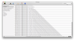

Cyberdevs Posted January 18, 2016 Author Share Posted January 18, 2016 Thanks, That has certainly helped while using AICPUPMI but HWMonitor is still inaccurate (hasn't changed) Although i did get a Single-Core Score of 4310 and a Multi-Core Score of 15977 in geekbench. Good? CPU Package Frequency changes from x0.0 up to x120.0 while system is idle, on full processing power it sticks to x40.0 There is another patch called AICPMPatch which I didn't run it on my computer because I'm not sure what it does and I don't wanna mess my computer up. But will keep searching. That's good enough on 64-bit Single-Core I get 4519 and on Multi-Core I get 17427 and with 32-bit I get 4153 on Single-Core and on Multi-Core get 15627 Link to comment https://www.insanelymac.com/forum/topic/309352-el-capitan-on-ga-z170x-gaming-5/page/9/#findComment-2207743 Share on other sites More sharing options...

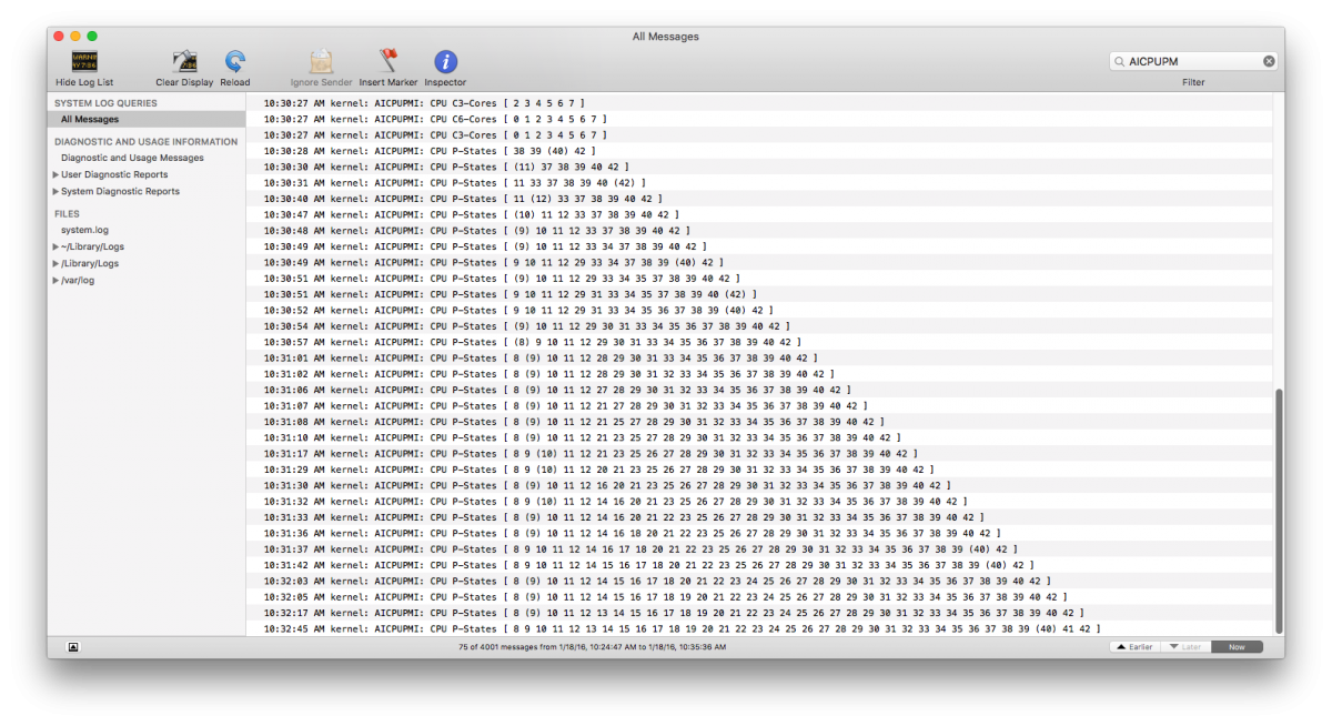

Cyberdevs Posted January 18, 2016 Author Share Posted January 18, 2016 I didn't overclock my computer. But I think if you OC you computer you need to change memory frequency in Kernel and Kext Patches if you already added memory info. But it would be useful if you could post the log or a screenshot of some sort. Link to comment https://www.insanelymac.com/forum/topic/309352-el-capitan-on-ga-z170x-gaming-5/page/9/#findComment-2207844 Share on other sites More sharing options...

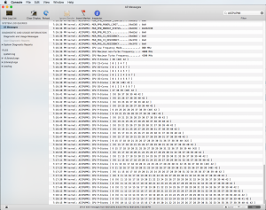

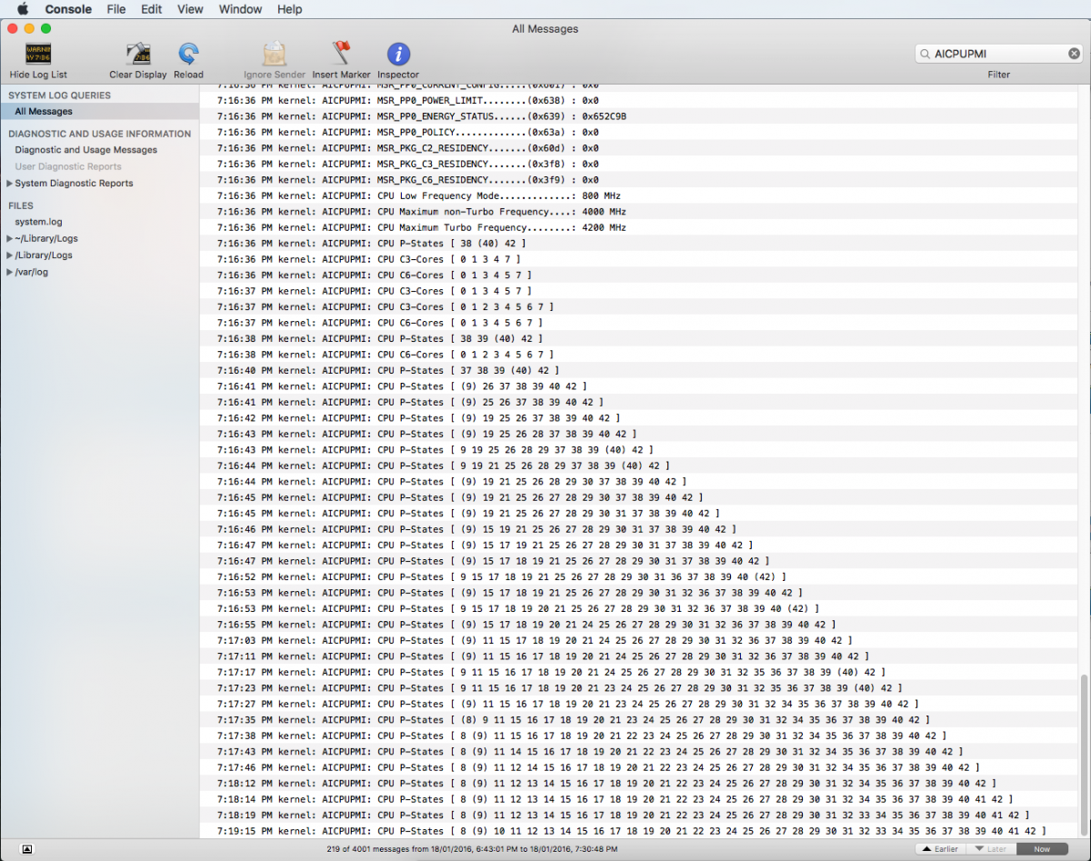

Cyberdevs Posted January 19, 2016 Author Share Posted January 19, 2016 As far as AICPUPM log shows CPU frequency won't be lower than 800 MHz and won't be higher than 4200 MHz here is what the log says: 1/19/16 10:28:41.000 AM kernel[0]: AICPUPMI: CPU Low Frequency Mode.............: 800 MHz 1/19/16 10:28:41.000 AM kernel[0]: AICPUPMI: CPU Maximum non-Turbo Frequency....: 4000 MHz 1/19/16 10:28:41.000 AM kernel[0]: AICPUPMI: CPU Maximum Turbo Frequency........: 4200 MHz I checked the log for another CPU on another machine with 3rd generation intel CPU and it says: 1/19/16 10:28:41.000 AM kernel[0]: AICPUPMI: CPU Low Frequency Mode.............: 1600 MHz 1/19/16 10:28:41.000 AM kernel[0]: AICPUPMI: CPU Maximum non-Turbo Frequency....: 3200 MHz 1/19/16 10:28:41.000 AM kernel[0]: AICPUPMI: CPU Maximum Turbo Frequency........: 3200 MHz Link to comment https://www.insanelymac.com/forum/topic/309352-el-capitan-on-ga-z170x-gaming-5/page/9/#findComment-2208073 Share on other sites More sharing options...
