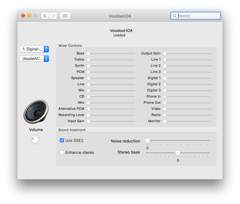

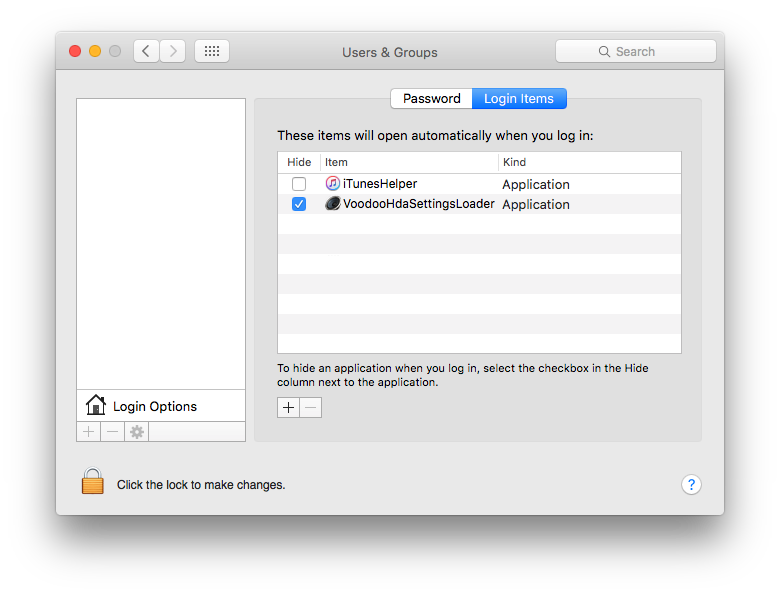

Cyberdevs Posted January 13, 2016 Author Share Posted January 13, 2016 Which option for the z170x gaming 5 would I choose from in 2.8.8 v3? Here is the Settings I use with VoodooHDA 2.8.8 I haven't installed the V3 version yet but there are no fundamental changes. Link to comment https://www.insanelymac.com/forum/topic/309352-el-capitan-on-ga-z170x-gaming-5/page/8/#findComment-2206269 Share on other sites More sharing options...

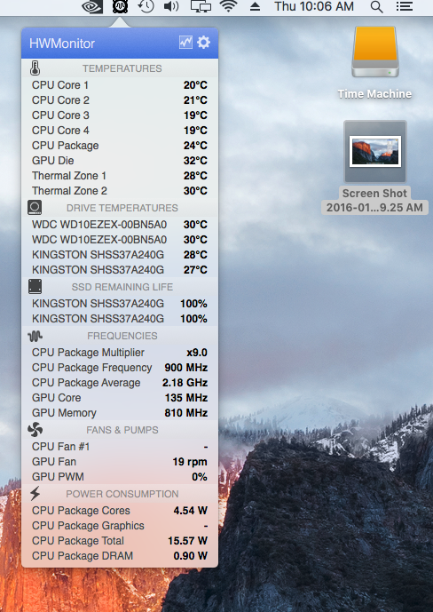

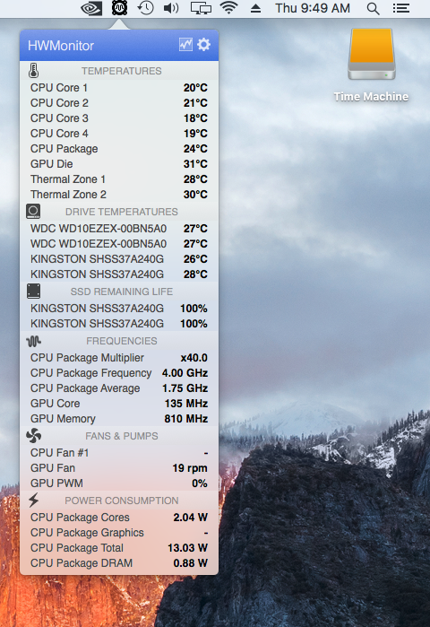

SavageAUS Posted January 13, 2016 Share Posted January 13, 2016 Please excuse if images are too large unsure how to upload correctly. HWInfo is only showing 2 frequencies for my CPU x9 and x40 does not seem right for a i7-6700k. Please help. I have run ssdtprgn and put the ssdt in efi -> clover -> acpi -> patched. Disabled all ssdt in clover and dropped oem but those settings won't boot to osx I just get the black screen with the O with a / through it. Link to comment https://www.insanelymac.com/forum/topic/309352-el-capitan-on-ga-z170x-gaming-5/page/8/#findComment-2206445 Share on other sites More sharing options...

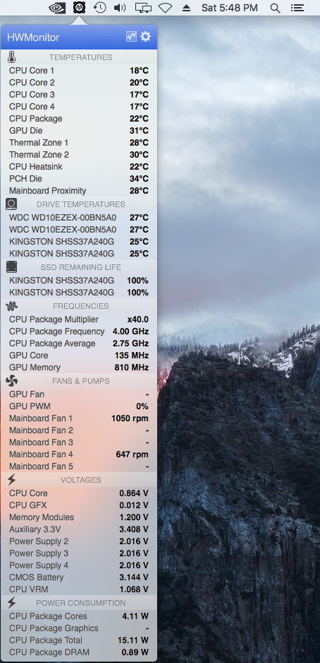

Cyberdevs Posted January 16, 2016 Author Share Posted January 16, 2016 Hey Guys, I came across a post regarding HWMonitor and it's working great. This was posted by Allan at: http://www.insanelymac.com/forum/topic/310288-which-fakesmc/?p=2204791 All the sensors are working and the version on RehabMan's FakeSMC.kext is flawless. All you have to do is to download the FakeSMC.kext from the link and follow these instructions. 1. Right click on FakeSMC.kext and click "Show Package Contents" 2. Create a new folder under "Contents" folder and rename it to "Plugins" 3. Copy these files to Plugins folder: (You can rename these files and remove the "FakeSMC_" part) FakeSMC_ACPISensors.kext or ACPISensors.kext FakeSMC_CPUSensors.kext or CPUSensors.kext FakeSMC_GPUSensors.kext or GPUSensors.kext FakeSMC_LPCSensors.kext or LPCSensors.kext 4. Replace your old FakeSMC.kext under clover's EFI folder with the new one 5. Reboot and lunch the HWMonitor and see the magic Thanks to RehabMan and Allan Link to comment https://www.insanelymac.com/forum/topic/309352-el-capitan-on-ga-z170x-gaming-5/page/8/#findComment-2207146 Share on other sites More sharing options...
SavageAUS Posted January 16, 2016 Share Posted January 16, 2016 Hey Guys, I came across a post regarding HWMonitor and it's working great. This was posted by Allan at: http://www.insanelymac.com/forum/topic/310288-which-fakesmc/?p=2204791 All the sensors are working and the version on RehabMan's FakeSMC.kext is flawless. All you have to do is to download the FakeSMC.kext from the link and follow these instructions. 1. Right click on FakeSMC.kext and click "Show Package Contents" 2. Create a new folder under "Contents" folder and rename it to "Plugins" 3. Copy these files to Plugins folder: (You can rename these files and remove the "FakeSMC_" part) FakeSMC_ACPISensors.kext or ACPISensors.kext FakeSMC_CPUSensors.kext or CPUSensors.kext FakeSMC_GPUSensors.kext or GPUSensors.kext FakeSMC_LPCSensors.kext or LPCSensors.kext 4. Replace your old FakeSMC.kext under clover's EFI folder with the new one 5. Reboot and lunch the HWMonitor and see the magic Thanks to RehabMan and Allan Good looking out, works a treat for me. Still having speed set issues though, cpu is either @ 4ghz or 900mhz Link to comment https://www.insanelymac.com/forum/topic/309352-el-capitan-on-ga-z170x-gaming-5/page/8/#findComment-2207150 Share on other sites More sharing options...

dreamcat4 Posted January 16, 2016 Share Posted January 16, 2016 All the sensors are working and the version on RehabMan's FakeSMC.kext is flawless. All you have to do is to download the FakeSMC.kext from the link and follow these instructions. 3. Copy these files to Plugins folder: (You can rename these files and remove the "FakeSMC_" part) FakeSMC_ACPISensors.kext or ACPISensors.kext FakeSMC_CPUSensors.kext or CPUSensors.kext FakeSMC_GPUSensors.kext or GPUSensors.kext FakeSMC_LPCSensors.kext or LPCSensors.kext Do you mean this .zip file dated 30th December 2015(or newer)? RehabMan-FakeSMC-2015-1230.zip 2.6 MB Link to comment https://www.insanelymac.com/forum/topic/309352-el-capitan-on-ga-z170x-gaming-5/page/8/#findComment-2207170 Share on other sites More sharing options...
Cyberdevs Posted January 16, 2016 Author Share Posted January 16, 2016 Yeah that one. RehabMan-FakeSMC-2015-1230.zip Do you mean this .zip file dated 30th December 2015(or newer)? RehabMan-FakeSMC-2015-1230.zip 2.6 MB Link to comment https://www.insanelymac.com/forum/topic/309352-el-capitan-on-ga-z170x-gaming-5/page/8/#findComment-2207171 Share on other sites More sharing options...
SavageAUS Posted January 17, 2016 Share Posted January 17, 2016 Look here I already posted my settings here http://www.insanelymac.com/forum/topic/309352-el-capitan-on-ga-z170x-gaming-5/?p=2205266 Does your speedstep (speed shift) work with your 6700k? Link to comment https://www.insanelymac.com/forum/topic/309352-el-capitan-on-ga-z170x-gaming-5/page/8/#findComment-2207419 Share on other sites More sharing options...
Cyberdevs Posted January 17, 2016 Author Share Posted January 17, 2016 yes it does, it changes the value up to 4.0 GHz You don't use a FakeCPUID in your config.plist by any chance do you? Link to comment https://www.insanelymac.com/forum/topic/309352-el-capitan-on-ga-z170x-gaming-5/page/8/#findComment-2207425 Share on other sites More sharing options...
SavageAUS Posted January 17, 2016 Share Posted January 17, 2016 yes it does, it changes the value up to 4.0 GHz You don't use a FakeCPUID in your config.plist by any chance do you? I don't think so but I'll check tomorrow and post back.I'll also check which kexts I have in clover folder. Link to comment https://www.insanelymac.com/forum/topic/309352-el-capitan-on-ga-z170x-gaming-5/page/8/#findComment-2207458 Share on other sites More sharing options...

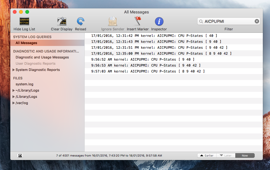

SavageAUS Posted January 17, 2016 Share Posted January 17, 2016 No i do not use any FakeCPUID and i have no CPU kexts. This is the result of test. Link to comment https://www.insanelymac.com/forum/topic/309352-el-capitan-on-ga-z170x-gaming-5/page/8/#findComment-2207666 Share on other sites More sharing options...
Cyberdevs Posted January 18, 2016 Author Share Posted January 18, 2016 After monitoring my CPU frequencies for couple of minutes I realized my CPU Package multiplier only changes between x9.0 and x40.0 too but CPU package average changes from 1.25 GHz Up to 4.0 GHz I launched the following commands in terminal: curl -o ssdtPRGen.sh https://raw.githubusercontent.com/Piker-Alpha/ssdtPRGen.sh/master/ssdtPRGen.sh chmod +x ./ssdtPRGen.sh ./ssdtPRGen.sh and here is the result: Error: Unknown processor model ... Visit http://ark.intel.comto gather the required data: Processor Number TDP Low Frequency Mode (use AppleIntelInfo.kext) Base Frequency Max Turbo Frequency Cores Threads Aborting ... Done. When I eariler said my speedstep is working I tought it does because of the changes in the CPU frequencies but I guess I was wrong about that. My Bad! I also can't install Intel Power Gadget, and I don't know why. Link to comment https://www.insanelymac.com/forum/topic/309352-el-capitan-on-ga-z170x-gaming-5/page/8/#findComment-2207716 Share on other sites More sharing options...
