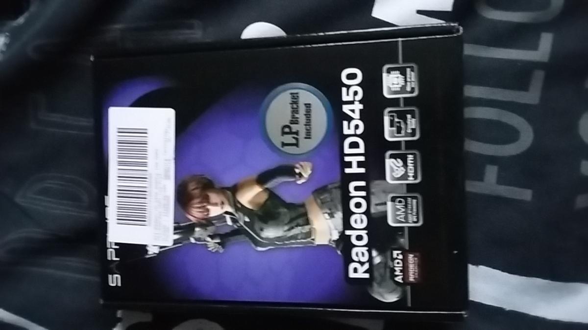

polyzargone Posted October 19, 2015 Share Posted October 19, 2015 This is NOT an AMD Radeon HD 5450… ATI (0x1002)Identifiant du périphérique : 0x6779 This serie is managed OOB by the AMD6000Controller.kext and AMDRadeonX3000.kext so it's completely normal that the DSDT fails and also that a Niresh distro succeed because the card is native under OS X . Please, run this in a terminal : ioreg | grep AMD Well, the good news is that it's a better Radeon HD model than the 5450. Now, using the Generic DSDT should work since it has no specific device/vendor ID for any particular models… 1 Link to comment https://www.insanelymac.com/forum/topic/308097-guide-el-capitan-1011x-dell-optiplex-780-760-755-790-990/page/10/#findComment-2179655 Share on other sites More sharing options...
jakeyg1 Posted October 19, 2015 Share Posted October 19, 2015 This is the box and I've ordered two and both do it and whys it say hd 5450 on box I'm confused lol Link to comment https://www.insanelymac.com/forum/topic/308097-guide-el-capitan-1011x-dell-optiplex-780-760-755-790-990/page/10/#findComment-2179663 Share on other sites More sharing options...
jakeyg1 Posted October 19, 2015 Share Posted October 19, 2015 OMG I ACTUALLY LOVE YOU IT WORKS WITH THE GENERIC DSDT still confused why the box has hd5450 on it lol 2 Link to comment https://www.insanelymac.com/forum/topic/308097-guide-el-capitan-1011x-dell-optiplex-780-760-755-790-990/page/10/#findComment-2179684 Share on other sites More sharing options...

polyzargone Posted October 19, 2015 Share Posted October 19, 2015 OMG I ACTUALLY LOVE YOU IT WORKS WITH THE GENERIC DSDT still confused why the box has hd5450 on it lol I had the same "problem"… well sort of . The HD 5450 appeared to be an AMD Radeon HD 6300M which is basically the same chipset but re-branded. Fortunately, vendor/device ID was pretty much the same too so the DSDT worked on it. That said, I'm not sure it was a good deal for me since it's a mobile GFX and not a desktop class. But who cares, I wasn't expecting to play GTA V with it anyway . Link to comment https://www.insanelymac.com/forum/topic/308097-guide-el-capitan-1011x-dell-optiplex-780-760-755-790-990/page/10/#findComment-2179712 Share on other sites More sharing options...
