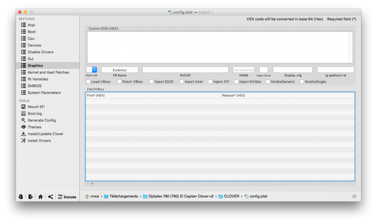

polyzargone Posted October 10, 2015 Share Posted October 10, 2015 Well, if you use the config.plist from the .zip file, you should have things (which shouldn't be there by default IMHO) like Dual Link set to 1, FB Name Shrike, NVCAP, VRAM, Video ports, etc. full of 0… Just remove everything and that's it… Link to comment https://www.insanelymac.com/forum/topic/308097-guide-el-capitan-1011x-dell-optiplex-780-760-755-790-990/page/5/#findComment-2175988 Share on other sites More sharing options...

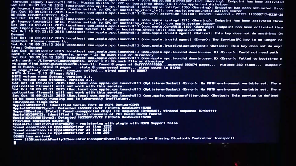

jakeyg1 Posted October 10, 2015 Share Posted October 10, 2015 okay done that and i will try and install now on my dell BRB Okay did same thing and got this in attachment Link to comment https://www.insanelymac.com/forum/topic/308097-guide-el-capitan-1011x-dell-optiplex-780-760-755-790-990/page/5/#findComment-2175992 Share on other sites More sharing options...
polyzargone Posted October 10, 2015 Share Posted October 10, 2015 What type of display/video port ? Also, you should wait a little bit. It can take a moment before the installer launch… Link to comment https://www.insanelymac.com/forum/topic/308097-guide-el-capitan-1011x-dell-optiplex-780-760-755-790-990/page/5/#findComment-2176004 Share on other sites More sharing options...
jakeyg1 Posted October 10, 2015 Share Posted October 10, 2015 I'm using the HDMI port on my radeon HD5450 card and after that in the attachment all that happens is that i get a no signal icon on monitor so wait about 5 mins and still nothing Link to comment https://www.insanelymac.com/forum/topic/308097-guide-el-capitan-1011x-dell-optiplex-780-760-755-790-990/page/5/#findComment-2176007 Share on other sites More sharing options...
polyzargone Posted October 10, 2015 Share Posted October 10, 2015 Set Eulemur in FB Name in Graphics. Link to comment https://www.insanelymac.com/forum/topic/308097-guide-el-capitan-1011x-dell-optiplex-780-760-755-790-990/page/5/#findComment-2176012 Share on other sites More sharing options...
jakeyg1 Posted October 10, 2015 Share Posted October 10, 2015 what with all of the other graphics options removed ? Link to comment https://www.insanelymac.com/forum/topic/308097-guide-el-capitan-1011x-dell-optiplex-780-760-755-790-990/page/5/#findComment-2176014 Share on other sites More sharing options...
polyzargone Posted October 10, 2015 Share Posted October 10, 2015 Just add Eulemur in FB Name. That's it. Link to comment https://www.insanelymac.com/forum/topic/308097-guide-el-capitan-1011x-dell-optiplex-780-760-755-790-990/page/5/#findComment-2176020 Share on other sites More sharing options...

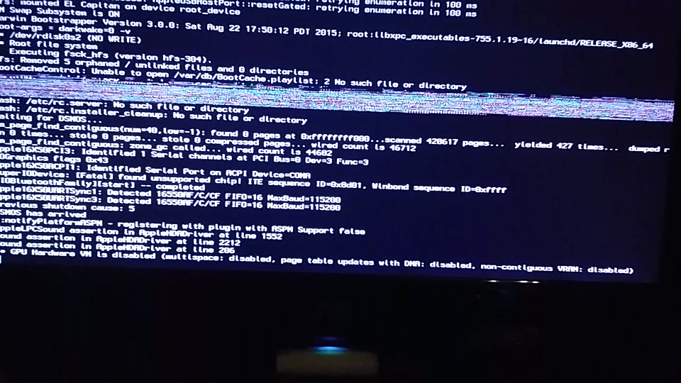

jakeyg1 Posted October 10, 2015 Share Posted October 10, 2015 I get this in attachment when I connect after install of osx and ill have to check the windows thing tomorrow as my brother is using the windows pc for college so therefore can't create a windows usb installer Link to comment https://www.insanelymac.com/forum/topic/308097-guide-el-capitan-1011x-dell-optiplex-780-760-755-790-990/page/5/#findComment-2176182 Share on other sites More sharing options...
polyzargone Posted October 10, 2015 Share Posted October 10, 2015 Actually, everything looks good for me. Those "glitches" on the screen also appears on my system, just before I reach the desktop. So your problem is that when you reach this step, monitor turns off and there's no signal anymore ? Right ? At first, I thought it was the HDMI video port the culprit but now, I'm wondering if it's not something else like incorrect monitor's EDID recognition by OS X which is another and much more annoying issue… You could try this if possible : Remove the Radeon, boot OS X and enable VNC remote control. Looks like this in french localization : Then shut down the Optiplex, put the Radeon Back and let the OS boot until it reaches the desktop. You won't see anything but you could remote control the Optiplex on another Mac/Hack/PC with built-in remote access in OS X or VNC viewer software on Windows. That way, you could check if the Radeon is correctly enabled in System Profiler with full VRAM. Else, you could check EDID option in Graphics in Clover Configurator and check InjectATI. Sorry but right now, that's my best . Link to comment https://www.insanelymac.com/forum/topic/308097-guide-el-capitan-1011x-dell-optiplex-780-760-755-790-990/page/5/#findComment-2176185 Share on other sites More sharing options...
