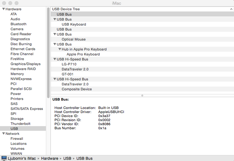

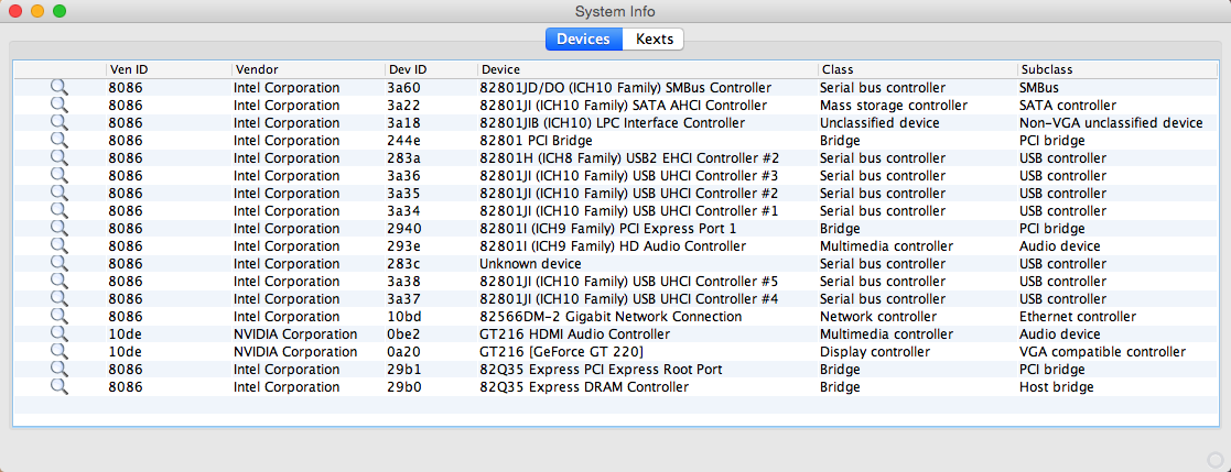

I've learned, at least, one thing - ICH naming in SystemReport has nothing to do with usb ports working or not... :blush:
From Yosemite
Same as in El Capitan... :whistle:
@owbp
You shouldn't rely too much on what System Profiler shows you. ICH9 or ICH10 are just cosmetic "issues" and you're correct, they have no influence on USB ports at all.
The point here is that El Capitan managed this in a different way than Yosemite and that's why, the DSDT has no influence on this either. Yosemite just doesn't care of what is what and what is where, it just ignore it and manage USB device "normally".
I don't know why Apple suddenly decided this has to change and it's probably due to upcoming Macs with USB-C type connector or something like that… :unsure:
Now you have Yosemite installed and running, you could connect a USB device in all ports and post an IOReg like Morpheousman did so we could try to build a new USB_Injector.kext that works on your system.
Maybe they are making preparation for expelling some old(er) Macs from compatibility lists in their next release... :bye:

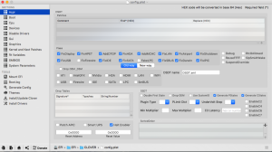

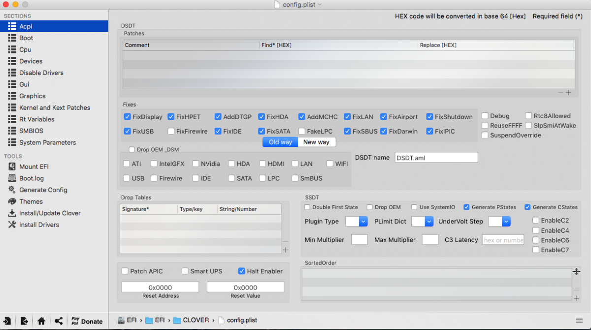

@owbp
I've looked into your IOReg and can't figure why it's not working on your system… Note that I hardly understand how this damn USB port injection actually works :P.
Are you sure you are using the DSDT patch in config.plist ?
Should look like this in CC :
Well in that case you are 100% more qualified than i am! :yes:
I'm using DSDT that you gave me few pages earlier, without Radeon injection.
Now I'm scared, it will turn out that i messed up config.plist somehow... Here it goes
Be gentle, please :blush:
Should i enter those two patches in my config.plist?
_______________________________________________________
EDIT: Thanks polyzargone, you the man! All USB ports are working!!!
P.S. But none did with that DSDT patch and without USB_Injector.kext...  :hysterical:  :blush:
