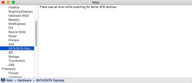

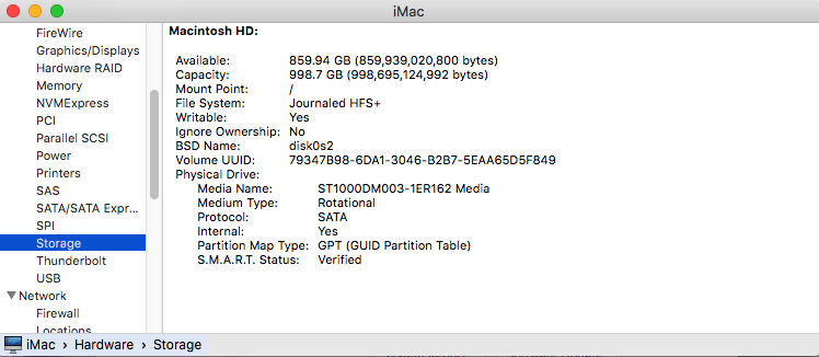

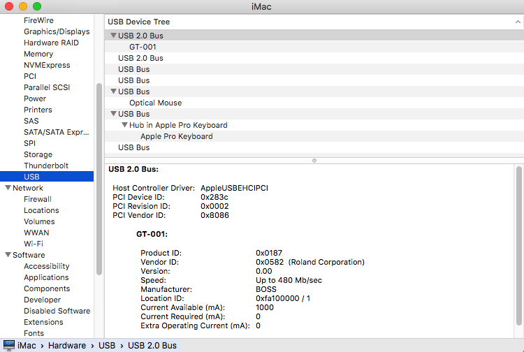

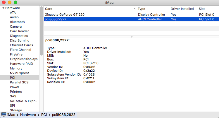

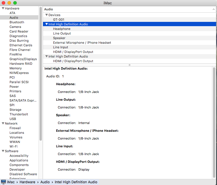

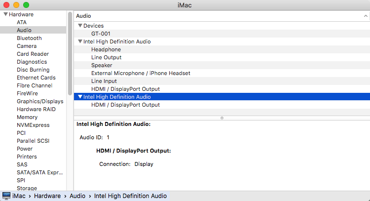

owbp Posted October 11, 2015 Share Posted October 11, 2015 @jakeyg1, i had the same problem, but using CLOVER folder from the attachment fixed it. You said earlier that you copied folder so why just don't buy Core2Duo for few bucks? Optiplex 755 update So i deleted Yosemite and am using only El Capitan, the only way to completely focus myself on it. Have FakeSMC and Intel82566MM in EFI/CLOVER/kexts/10.11 and AppleHDA (v3), HDAEnabler1 and USB_Injector in S/L/E installed (repaired permissions and rebuilt cache). I still don't have HDA in System Preferences/Sound, but it is not important for me, since I'm using USB Audio Interface. It would be nice to fix it for some other folks who rely on integrated sound though. And still, 3 USB ports on the back are not working. Pictures as evidence USB ports that are not working are red, working are green Audio options showing only in System Report Never had this before, suppose its due to DSDT fix to see my internal drives But there is always this error in SATA controllers I can see HD in Storage only All in all, it is working 100% as far as i am concerned, but if anyone haven idea how to fix those problems I'm here as a test subject. Ill try to get my own DSDT patched for all ICH9s to be recognized as ICH10, but it will take some time... P.S. How do i delete Recovery partition from my previous Test HD partition that is still showing in Clover boot menu, since Disk Utility still doesn't have debug option? Link to comment https://www.insanelymac.com/forum/topic/308097-guide-el-capitan-1011x-dell-optiplex-780-760-755-790-990/page/6/#findComment-2176414 Share on other sites More sharing options...

polyzargone Posted October 11, 2015 Share Posted October 11, 2015 Little recap : @owbp Well, that's too bad you removed Yosemite since USB ports issue should have been easier to fix . It's likely because Optiplex 755 has a different port mapping than 760/780 (don't know for 790) series. Now, you could use this app from this thread to fix it by yourself. But you'll need Windows for that… For audio issues, as Morpheousman said, 755 models seems also different on this and AppleHDA patch never worked. As he also said, you can still use VoodooHDA.kext but not HDAEnabler.kext which is useless when using it. By contrast, you have to use AppleHDADisabler.kext which is strongly recommended to avoid kernel panic due to conflicts between AppleHDA.kext and VoodooHDA.kext. Sorry, I read too fast the last post of Morpheousman @jakeyg1 upgrading from DDR2 to DDR3 won't fix your graphic problem at all. The same goes for changing Pentium Dual Core to Core2Duo processor. In a last attempt, you may try to set FB Name to Radeon which is the default one and should work for any AMD Radeon HD series… Also, try with and w/o InjectATI. BTW, you can change almost every settings in Clover before it boots OS X. Just type O like Options in Clover boot menu and go to Graphics Injector Menu. Most of the settings you see in Clover Configurator are here too . Ultimately, you could try with an NVIDIA card or another AMD model. This is a cheaper way than buying a new computer. Link to comment https://www.insanelymac.com/forum/topic/308097-guide-el-capitan-1011x-dell-optiplex-780-760-755-790-990/page/6/#findComment-2176429 Share on other sites More sharing options...
