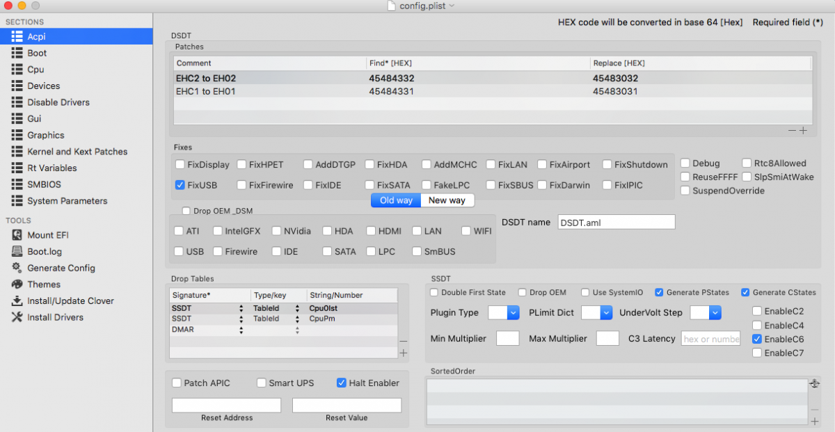

Ok, I'm attaching it!
config.plist.zip

Just checked your config.plist. Looks OK but I did some clean up. Feel free to compare yours and my attached one to see what I've changed/removed/set.
Anyway, here they are :
• Removed fixes in ACPI > fixes > New way
• Removed kext-dev-mode=1 in Boot > Arguments (this arg is useless on El Capitan but mandatory on Yosemite so you may have to set it again in case you're still using OS X 10.10)
• Device > Audio > added 1 to enable AppleHDA and also removed HighCurrent in USB (not sure about this one. If you have problems with USB devices saying they need more power, you may want to add it again)
• Deleted useless entries in GUI > Hide Volume
• Deleted Asus AICPUPM in Kernel and Kexts patches (as the name states, it's for Asus mobos)
• Deleted Backight Level entries in System Parameters and set Inject Kexts to Yes
That's it.
config.plist_ owbp.zip

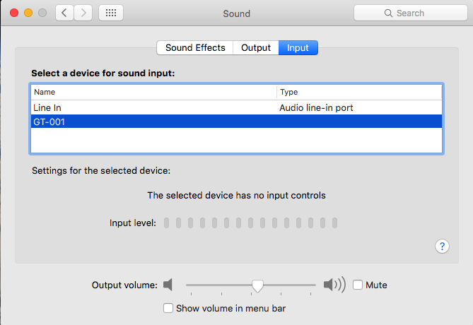

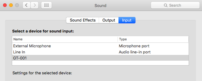

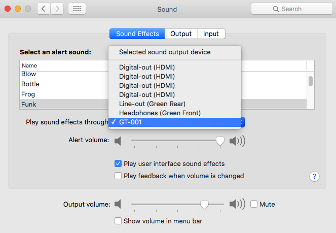

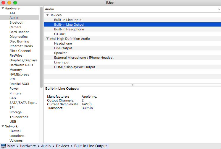

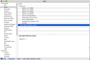

Regarding Apple HDA, I've tried now with new DSDT and this config.plist to enable it with both AppleHDA v3 and AppleHDA v3 with HDAEnabler1 and no luck.
Then i tried VoodooHDA v2.8.8. and it works. I cannot test HDMI, but all Dell's audio ports are ok.
post-1517990-0-23994000-1444770312_thumb.pngpost-1517990-0-80742200-1444770322_thumb.png
post-1517990-0-91179200-1444770332_thumb.pngpost-1517990-0-51119000-1444770343_thumb.png

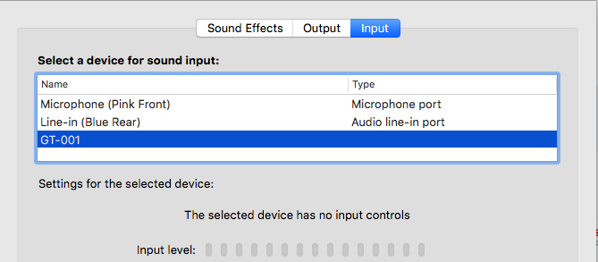

Ok, will do it right now. I have done that already but used kext wizard to rebuild caches and fix permissions.
Btw, only one thing confuses me:
Second, make sure you have 1 in Device > Audio.
You mean this
Nothing, same as before VoodooHDA.
UseIntelHDMI wasn't checked on the first run in CC so i tried again with it and the result is the same.
Downloaded AppleHDA version 3 from the first post of this topic and followed your instructions to every word.
P.S. I have written before, I have USB audio interface, this is just for the topic. AFAIK El Cap works 100% for me, after USB fix.

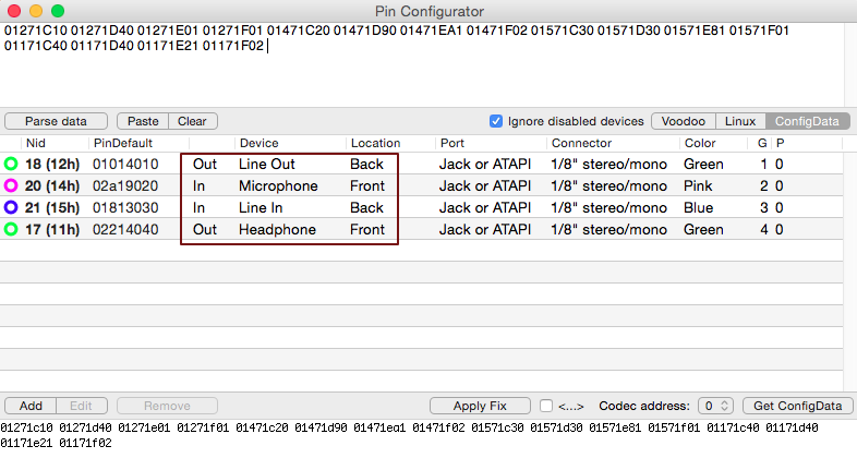

@MacPet,
As soon as i find my Linux Live CD, give me few minutes!
Edit:
I extracted nVidia HDMI too, just in case...
codec-dump#0-755MT-AD1984.txt.zip
codec-dump#1-755MT-nVidiaHDMI.txt.zip

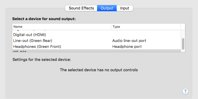

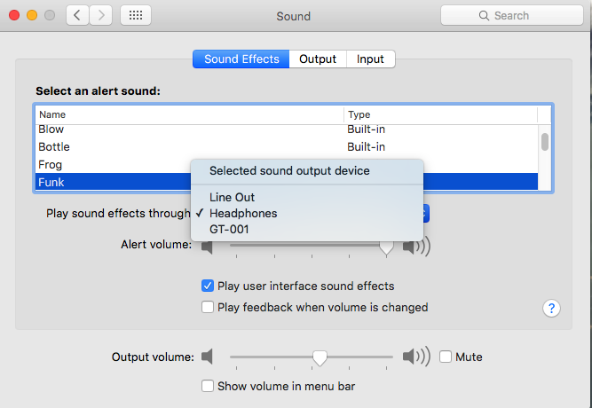

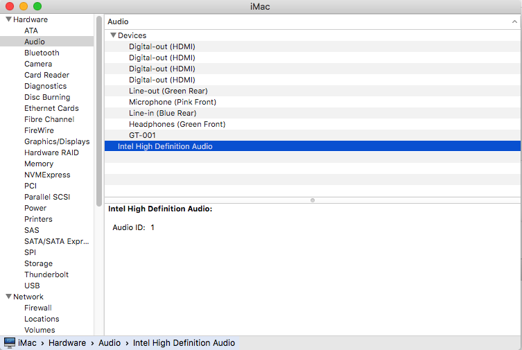

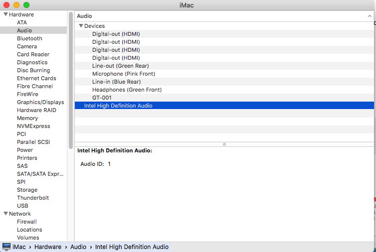

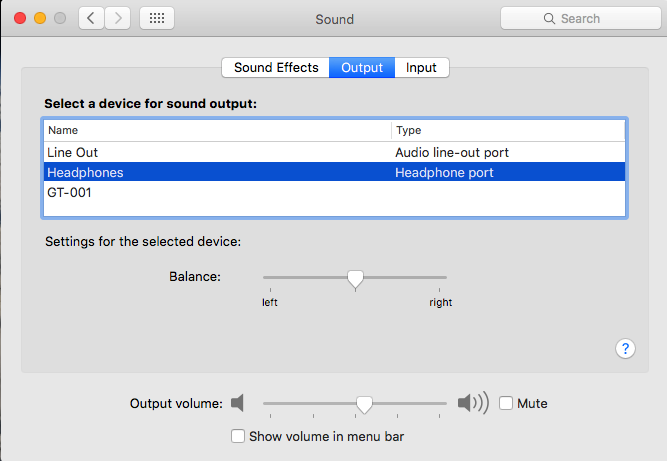

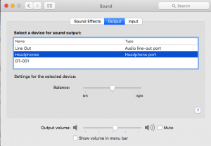

 You the man! :dance_24:  B)
Line Out and Headphones are working, clean and clear!
I cannot test Line Ins since i only have full size jacks and XLR mics at my house, but ill try to get or borrow desktop mic or something to test it soon as i can.
If other users with Optiplex 755, then please report if Mic and LineIn also work well and are regulated  :construction: ???
