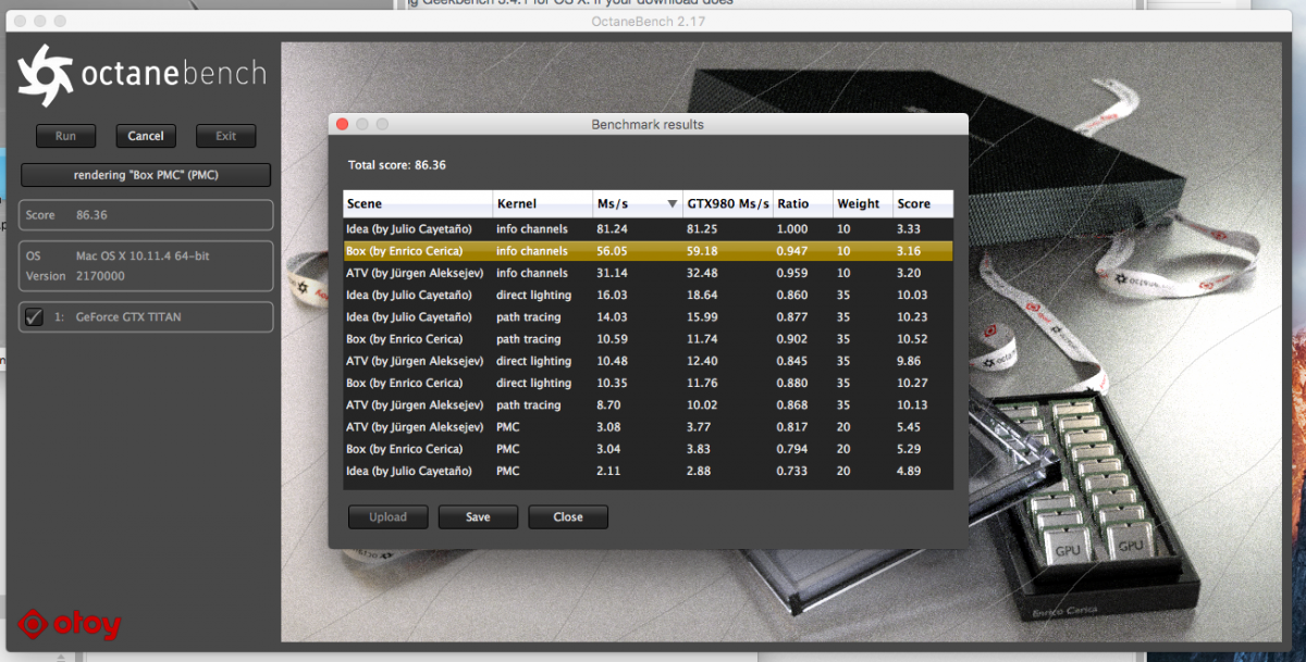

this is some low number for open gl on titan?  I get that on ati 7970?  I was thinking of upgrading to 980 ti or titan

i have simmilar results about 50fps in cinebench
next week i will try gtx 580 and gtx 980 and i will post the three results
my friend has 980ti and his score was around 48 for cinebench and that surprised me ... because in windows i saw 70-80 from other people.  Maybe osx is not using open gl right.  Also it would be nice to see how the cuda performas if you have DaVinci resolve with candle test ?  I am asking all this because i have ATI 7970 it is older card but i am surprised to see similar results in realworld tests. I want to upgrade so I get surprised that the scores are so low for 980ti and titan under osx

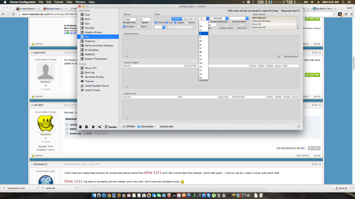

I was able to install using Clover for El Capitan, but it is in French. I did not see the choice of either US or UK English.
Everyone, i see what jaymack was talking about when he said the installer was in french.  I too faced the same thing too. I used the EFI El Capitan installer to create the usb and then i just used the zipped files from post #166 from Kif.007 above and I finally got to the installer with this pack but it's in french.. Why is it in french? Idk, it's beyond me.  Shed some light please anyone.
The completed El Capitan install was in French. I was not even given the choice of US or UK English. They were not listed. I finished the install just to see if it would work. I now to need to start over, and try to figure out how this happened so that I can have a working install in the English Language.        I might add that I too used all the files from post #166.

EL Capitan installed in French not English.
I found the language problem jaymack, it all lies in the config.plist.  You must open the pilst with clover configurator first and then change the language from fr to en like here:
Thankyou, I suspected it had to be in one of the files but had not yet looked. Can you upload the edited plist?

config.plist edit post 188
