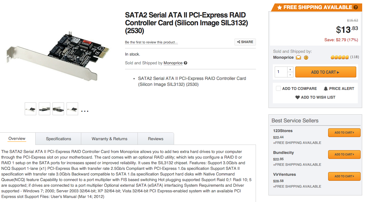

djfremen Posted February 9, 2016 Share Posted February 9, 2016 hi djfremen did you connect a separate sata controller SiliconImage3132? Yes. initially I used this card: It's disconnected now though. Use whatever tool is free to get 10.11.3 installed on your target. A real mac would work perfect too. Will try to make a compete write soon but Enoch is the key. Link to comment https://www.insanelymac.com/forum/topic/307064-hp-z400z600z800-workstations-os-x-1010x1011x-installation/page/3/#findComment-2214519 Share on other sites More sharing options...
